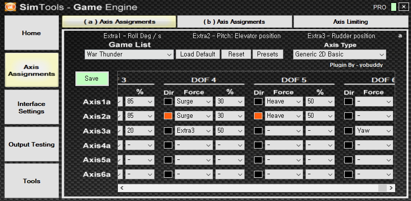

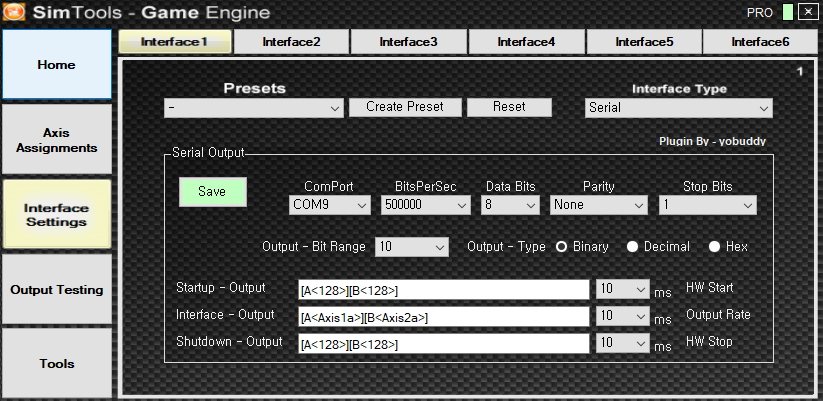

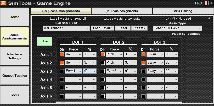

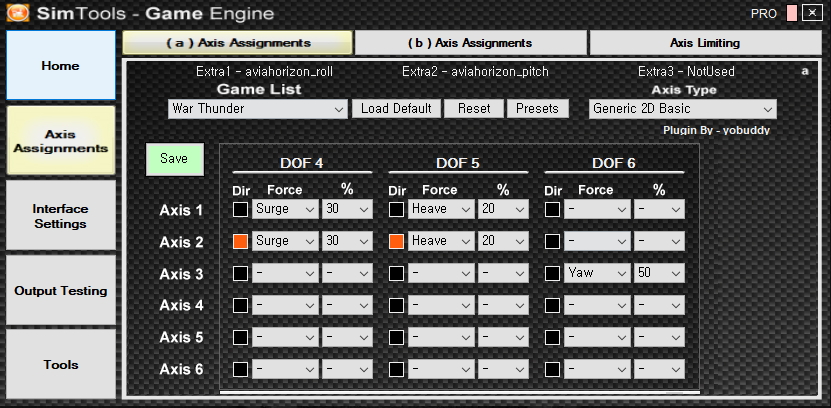

    Normally the DIR setting for sway would be the opposite of roll.
    Start by disabling allocations and do one at a time, starting with roll, then when it is correct turn it off and do pitch and so on: https://www.xsimulator.net/community/faq/steps-to-create-a-motion-profile.228/

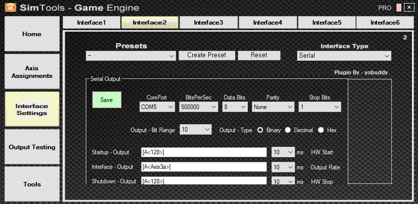

    For now do away with Startup and Shutdown settings in the Interface Settings.
    You only have 2 axis defined in the Interface settings but there are axis allocations for 3, not sure what your rig is.

    I use Dof Reality V3 which is 3dof. :(

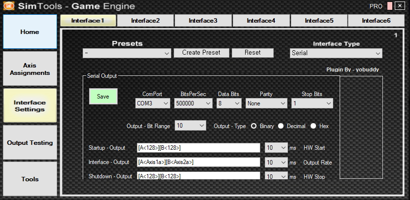

    Hi, I am using 2dof and im want to play War Thunder. Problem is that 2dof makes strange movements in logging like 1 second move, same in menus, so the game is communicating with simtools. But in a flight simulator isn't moving whathovewer, do you know where problem is?
    22,230
    154,849Coins
    +11,229 / 57 / -2
    You will need to give far more detail, like posting pictures of all of your settings.
    Have you gone through each of the steps to refine the motion profile, one axis at a time: https://www.xsimulator.net/community/faq/steps-to-create-a-motion-profile.228/
    And does SimTools behave correctly in Output Testing, this is what SimTools expects in terms of axis configuration: https://www.xsimulator.net/community/faq/which-way-to-set-simtool-axis-movements.230/

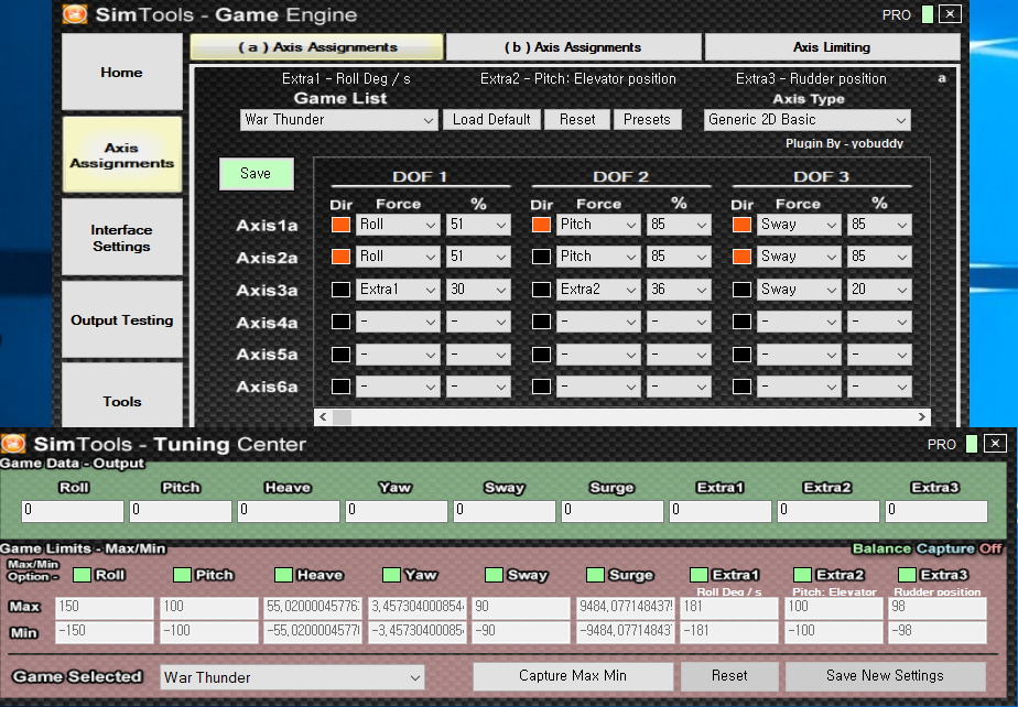

    I have followed the tuning center adjustment steps, I have modified the values of both surge and heave but I do not notice any change and of course I have saved after each change
    22,230
    154,849Coins
    +11,229 / 57 / -2
    You need to properly tune your Surge vales to feel the kick of guns, particularly cannons.
  15. polybasss
    polybasss Member Gold Contributor
    Sep 26, 2018
    100
    Burgos Spain
    155Coins
    +16 / 0 / -0
    @noorbeast ,I got it!!! the problem was that I did not have the added arises in the axis, I did not know that in a 2dof you can add more forces dof than 2, I thought that was done by adding axis

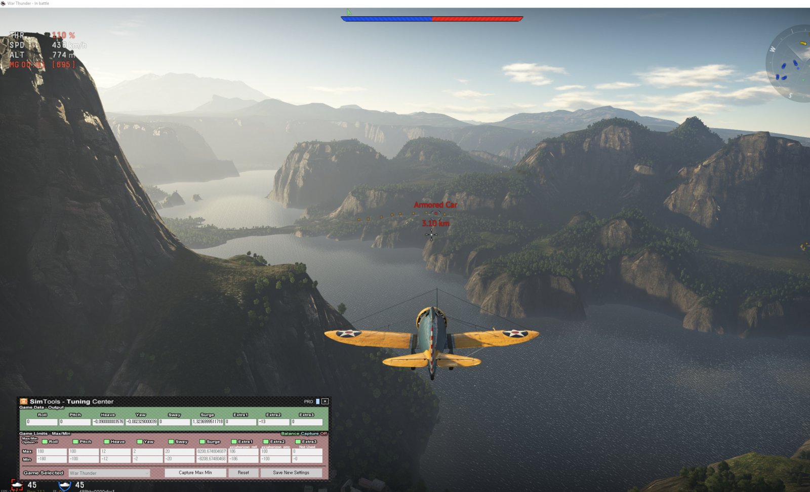

    Please post pictures of all off your setting.
    My guess is that your motion profile needs refining, this is what a crash should look like:

    Your rig's movement looks super normal. my rig moves like a really crazy horse.
    by the way I found that sway value is abnormal. it is way too big. please check this.
    DOF Reality V3 I use
