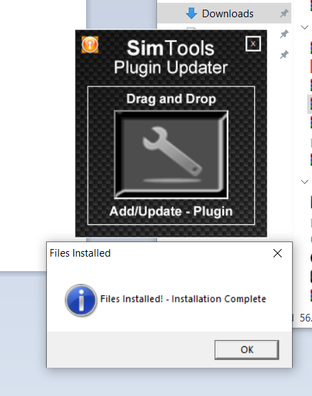

    In that case is SimTools activated?
    Perhaps @yobuddy has some other ideas.
  3. yobuddy
    51,781Coins
    +5,206 / 19 / -0
    @ERGUN OZYURT

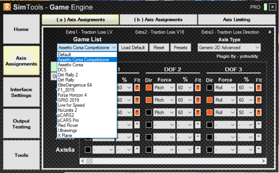

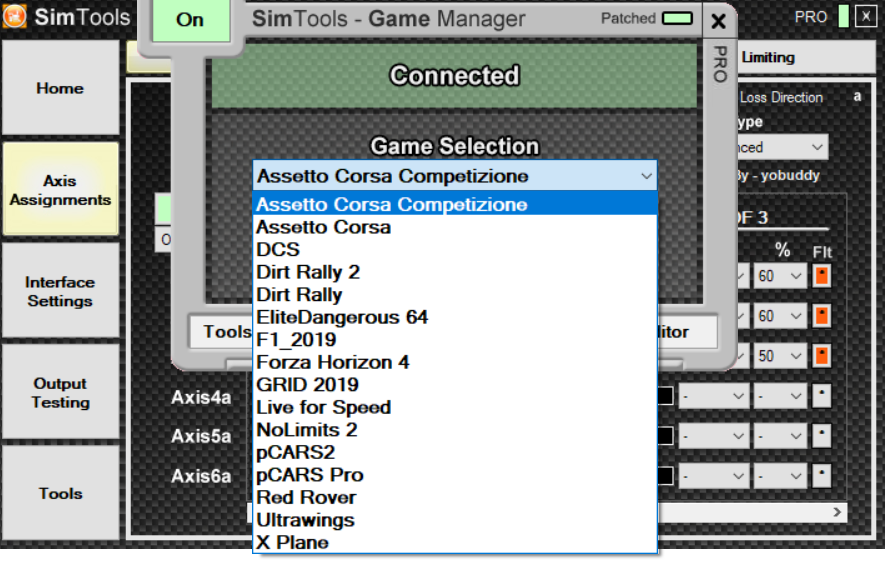

    Will you post a screen shot of the game manger drop down list of games?
    Thanks man,
  4. ERGUN OZYURT
    ERGUN OZYURT erguno
    Nov 29, 2019
    17
    Turkey
    - 246Coins
    2DOF, 3DOF
    Thanks for help.
    22,230
    154,849Coins
    +11,229 / 57 / -2
    Try temporarily turning off programs that could interfere with the patching, like anti-virus and firewall, un-patch and then re-patch WT.

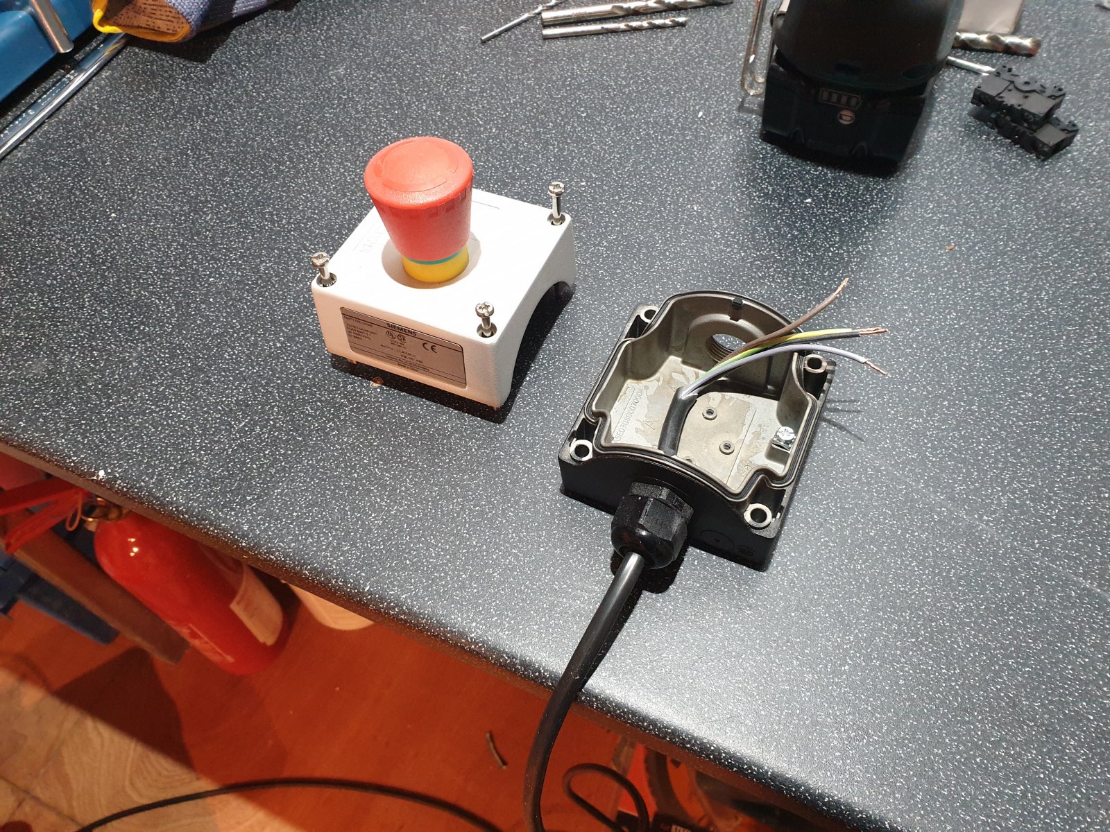

    In my case I have a kill switch next to me to switch off power supply to the motors. It works well with any games.
  7. tomkil192
    tomkil192 Member
    Jun 25, 2015
    81
    Uk. London
    - 24Coins
    +26 / 0 / -0
    one of those
