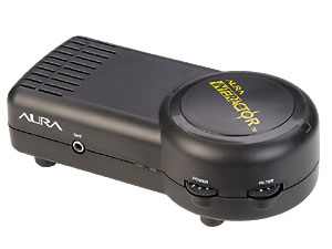

    yes i use the Aura, cause it´s cheap.

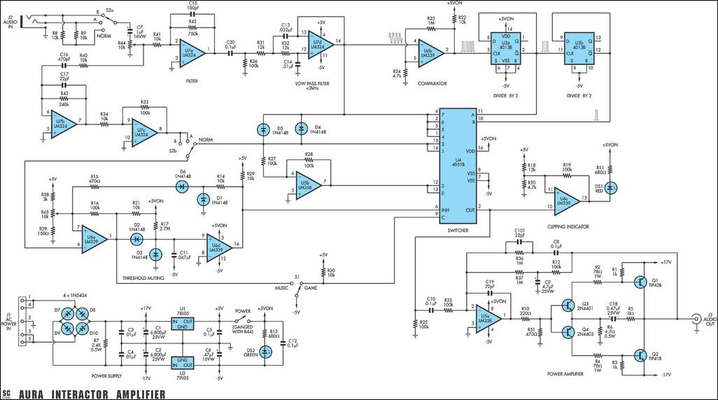

    You need the Aura Power Supply!
    It is very unusual~2x11,5 Volt

    Some weeks ago i catched the Aura vest for 8€:)
    http://www.ebay.de/itm/aura-interac...US_Video_Game_Controllers&hash=item3cd6f589d8
    ( I have some amps but no Power Supply, it´s only to have one in stock. Vest is like new.)
    The bass shaker is not so good cause it is very light.
    I bought some with hausing, it is easily to mount and gives a good vibration.
    Here a link how you can tune the aura
    http://bsfaq.parodarkis.de/
    If you wont spend a lot money this cheap way is a good choice.

    I have 1 buttkicker with its amp
    and I got unused bass shakers (like the picture)
    So i'm looking for amplifiers :)
    I dont understand why is the supply so special?
    11.5V ? (the sketch is about the amp and not the power supply)
    The goal is to make Simtools supporting tactil telemetric feedback! Still under collective brainstorming!

    i have only low electronic skills.
    I search some Forums for Aura Supply i don´t know if you can use any other Supply.
