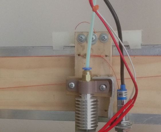

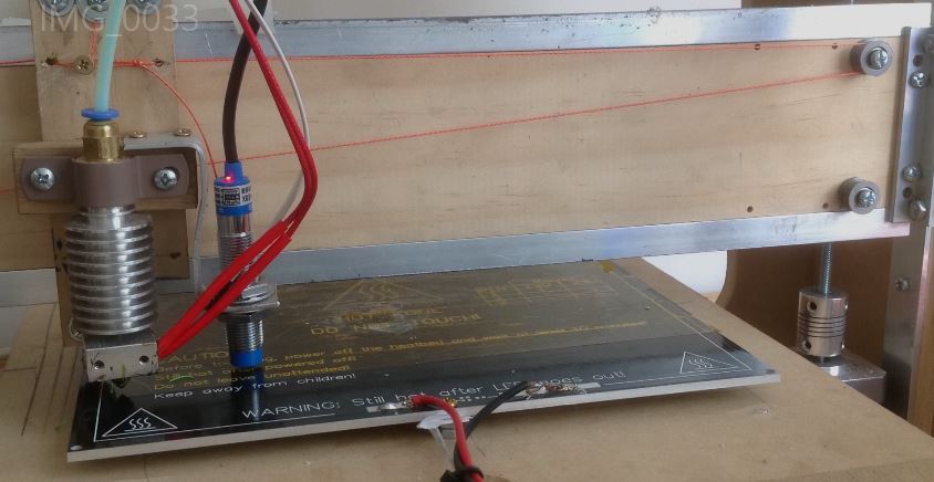

    @Historiker, I built mine from scratch a year or so ago. I went the really DIY route and only used stuff from the shed - no hardened linear rails or bearings. The x-axis was just from a cut up PTFE? cutting board sliding on aluminium extrusion - was smooth and had no noticeable play. All electronics were from china. I did it mostly as an experiment to start with. I was surprised how well it printed given the crude build. (picture below, couldn't find one of the complete unit.)
    I've only ever printed ABS, never got round to buying a roll of PLA so far. The inductive sensor bed levelling worked really well.

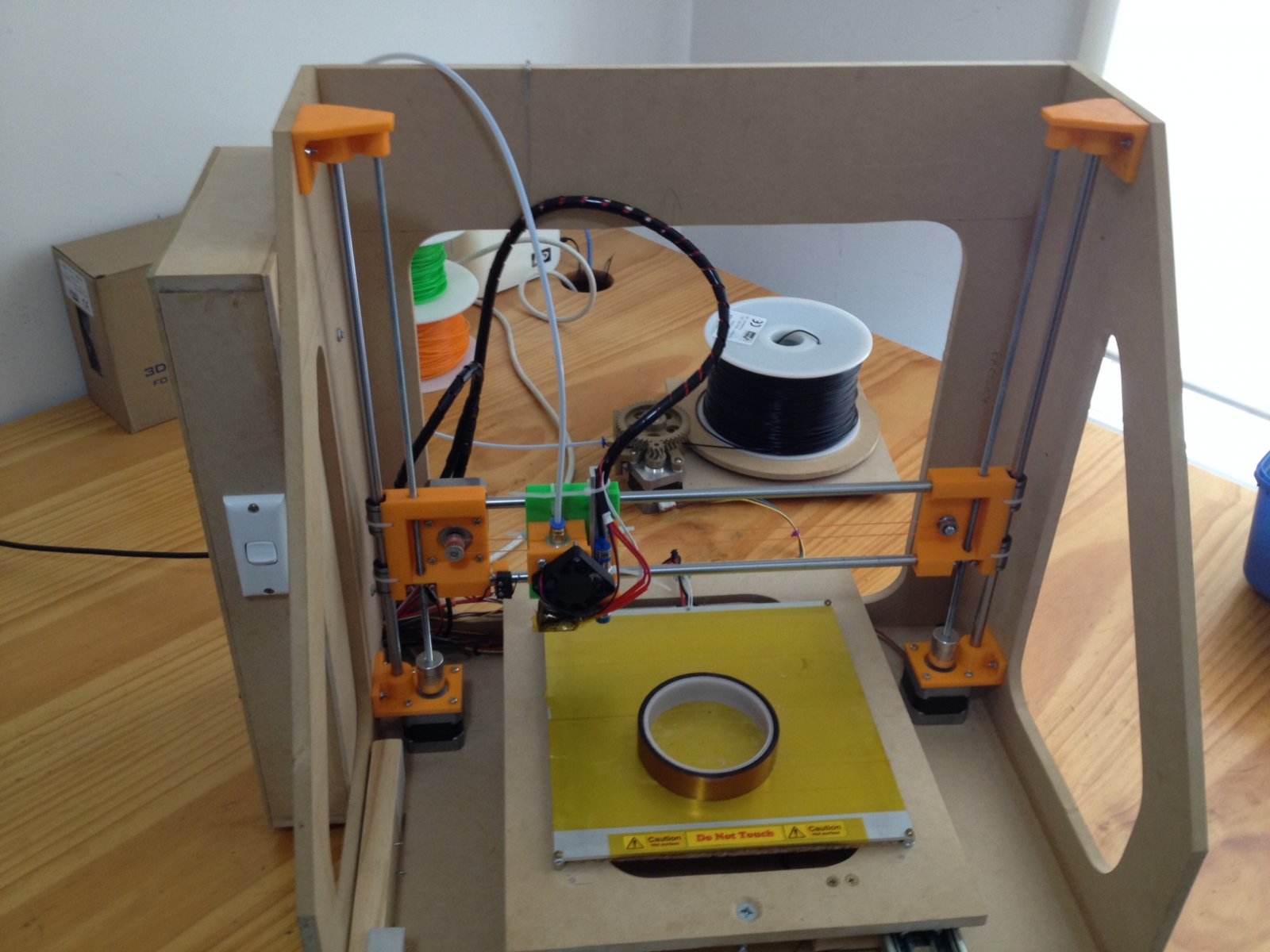

    After about 9 months I decided to print parts to make more of a traditional unit with hardened chrome rails. Revised unit shown below. It is bigger in size than a complete or kit unit but that's not an issue for me.
    Like everything it comes down to your own preferences balancing time, cost, money, etc. Either way having a 3D printer is extremely valuable for the DIYer.

    HaHa, you noticed. It is actually braided fishing line. I had read that it was very flexible and didn't stretch over time.
    When I built the original printer the GT2 timing belt was one of the slowest parts to come from ebay China. I got impatient and went to the local tackle shop to get the fishing line. It worked so well I never bothered to change it and carried it over to the revised design. It is simply tied to a cable/zip tie and then pulled tight for tensioning.

    at least you used coated screw for anti corrosion. top notch.

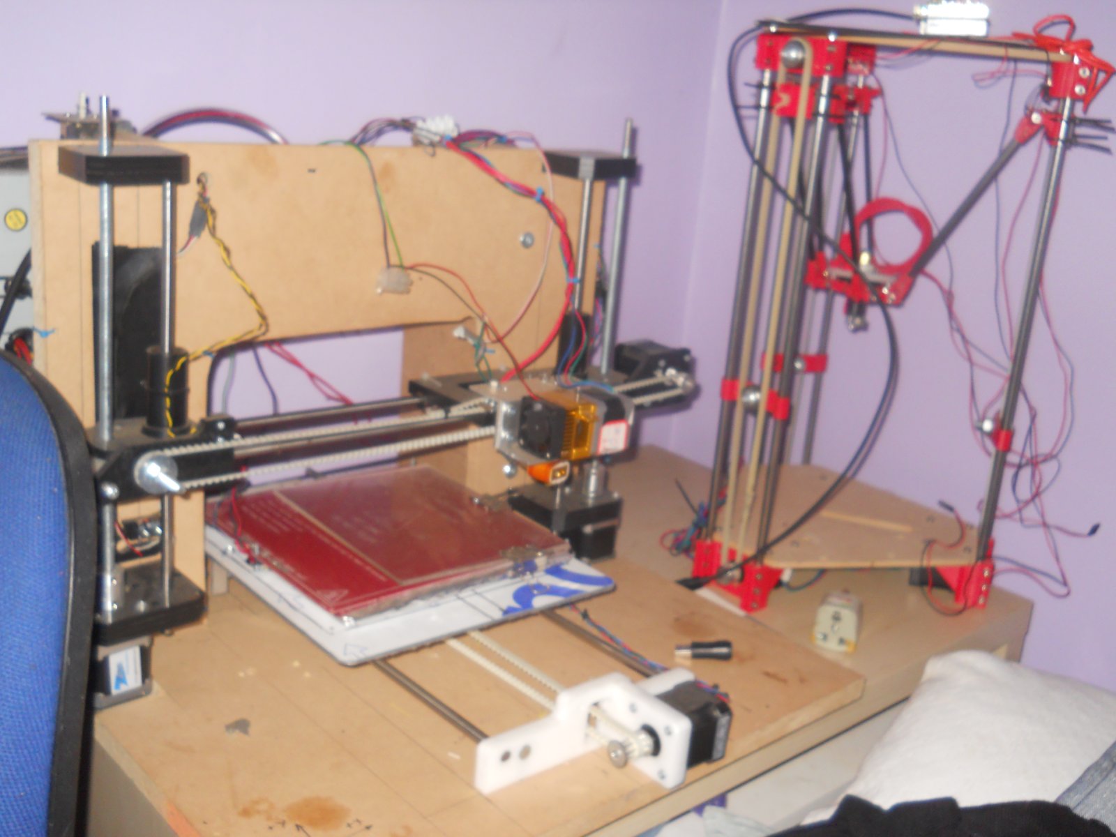

    I started in 2011 with a repstrap made from old inkjet printers and scanners :

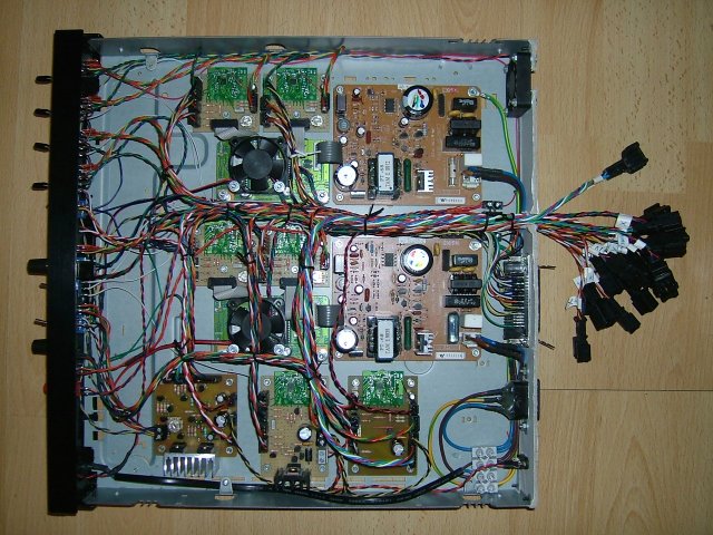

    The electronics was also built around salvaged stepper drivers and power supplies from printers :

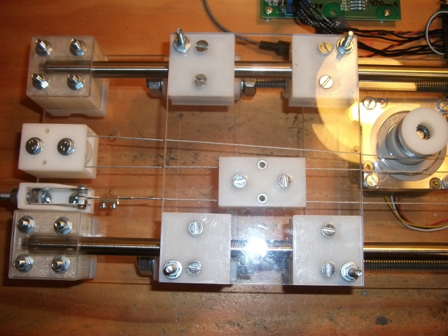

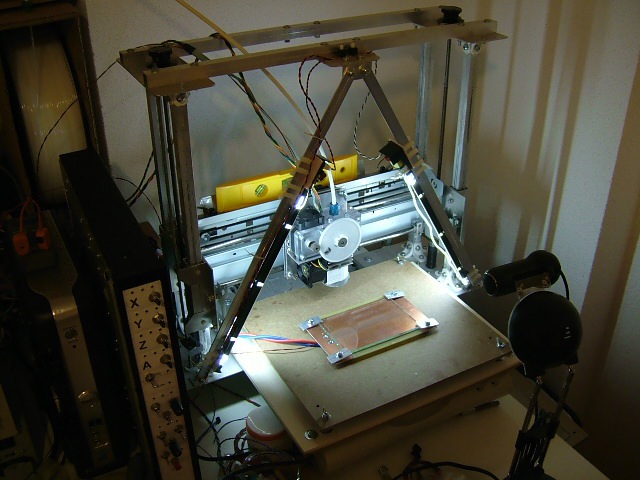

    With this repstrap I printed the plastic parts to make my current 3D printer :
    In this picture I used the electronics from the old printer

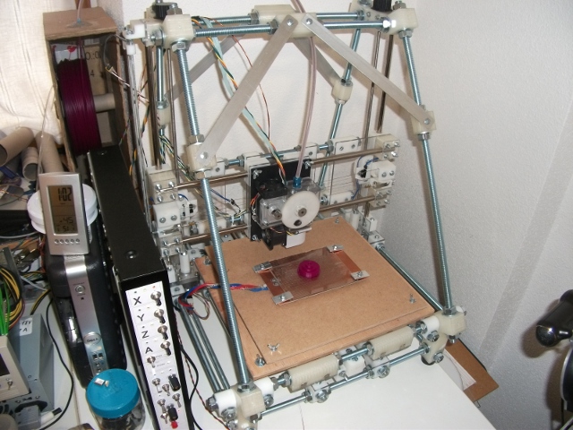

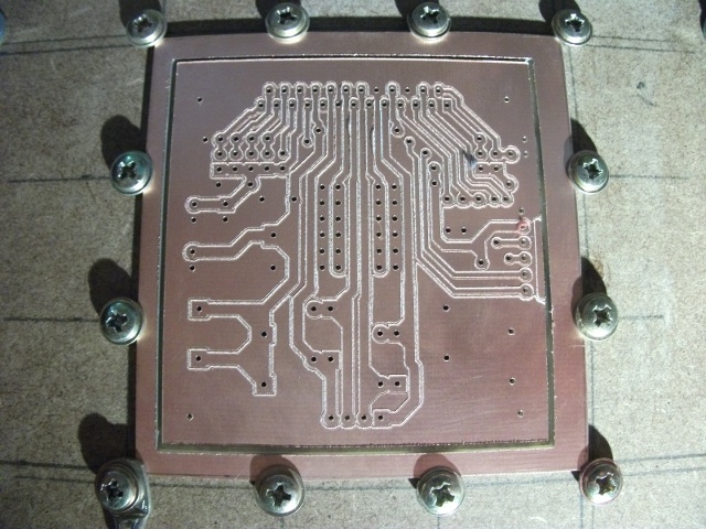

    I designed it to be rigid and powerful enough to move a dual extruder and mill circuit boards :

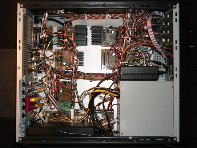

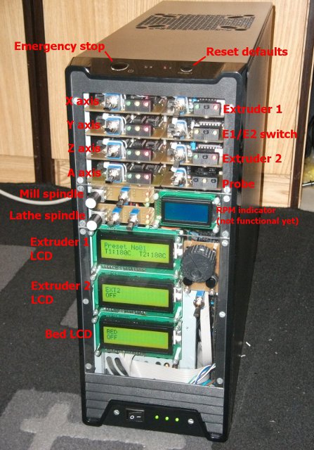

    So I also designed and built the final electronics :
    I made a wiki with all the files to replicate it : http://reprap.org/wiki/Heavy_Mendel
