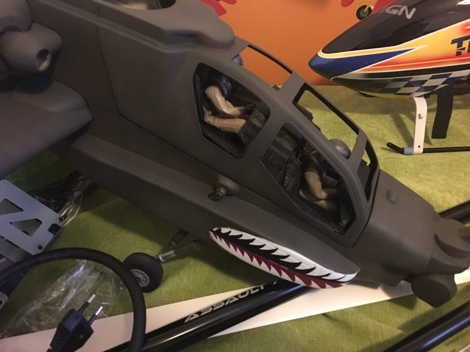

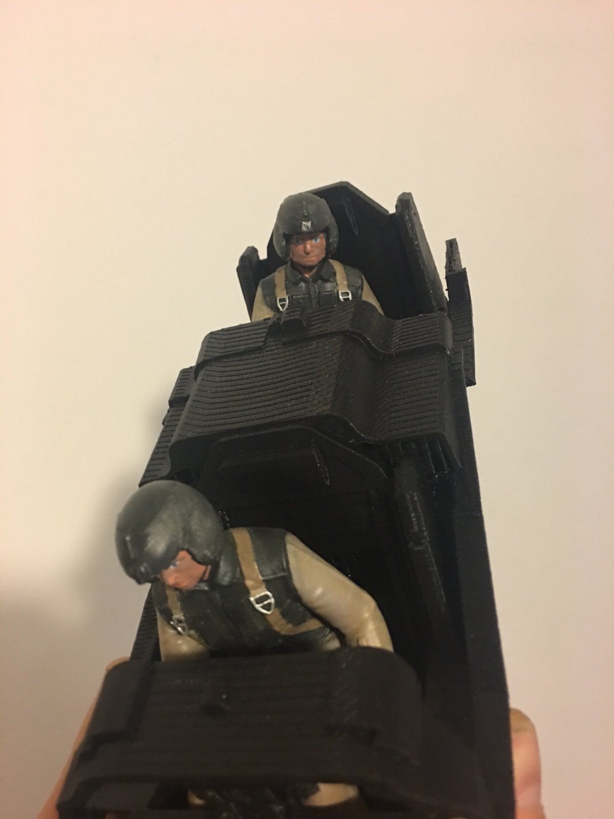

    Nice printings ! Maybe my english is not very fluent - I didn`t understand what is enclosure for ABS - you mean big enclosure of the printer [ for no dust ] or enclosure for Arduino to close a DOF electronics - sorry maybe a misunderstanding :) I wanted enclosure the electronics, but my case only fitted the PSU`s, probably need to find something bigger.
    Here is my more smooth pilots from ABS - they are for 500 AH64 with acetone smooth and painted, but Apache cabin is in 0,2 due to many hours... :)
    In my case I had many clogs when printing from PLA, but for over 3 months since I changed to ABS - nothing... I also changed manufacturer of filament - so maybe this was causing this [ I have a filter also all the time ]

    Crap Filament will clog the nozzle Much more often, So im assuming that must have been it, PLA is VERY printer friendly in general.
    Yes An enclosure for the entire machine. To help with keeping the heat inside and around the Part to prevent any rapid cooling and layer de adhesion issues.

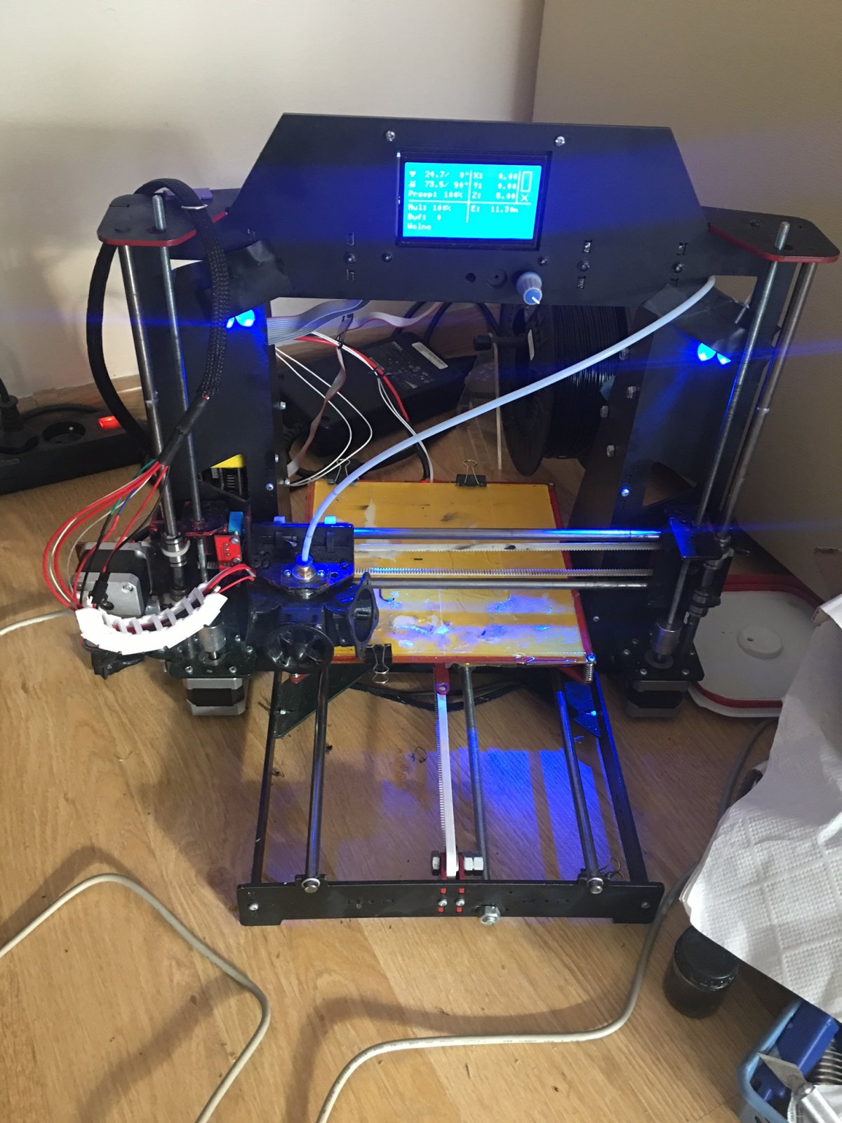

    About proper G-code - I use RepetierHost and CuraEngine for preparation since beginning my adventure of 3D print - what else is good ? [ for ABS / PLA is great ! ]
    My Prusa :)
