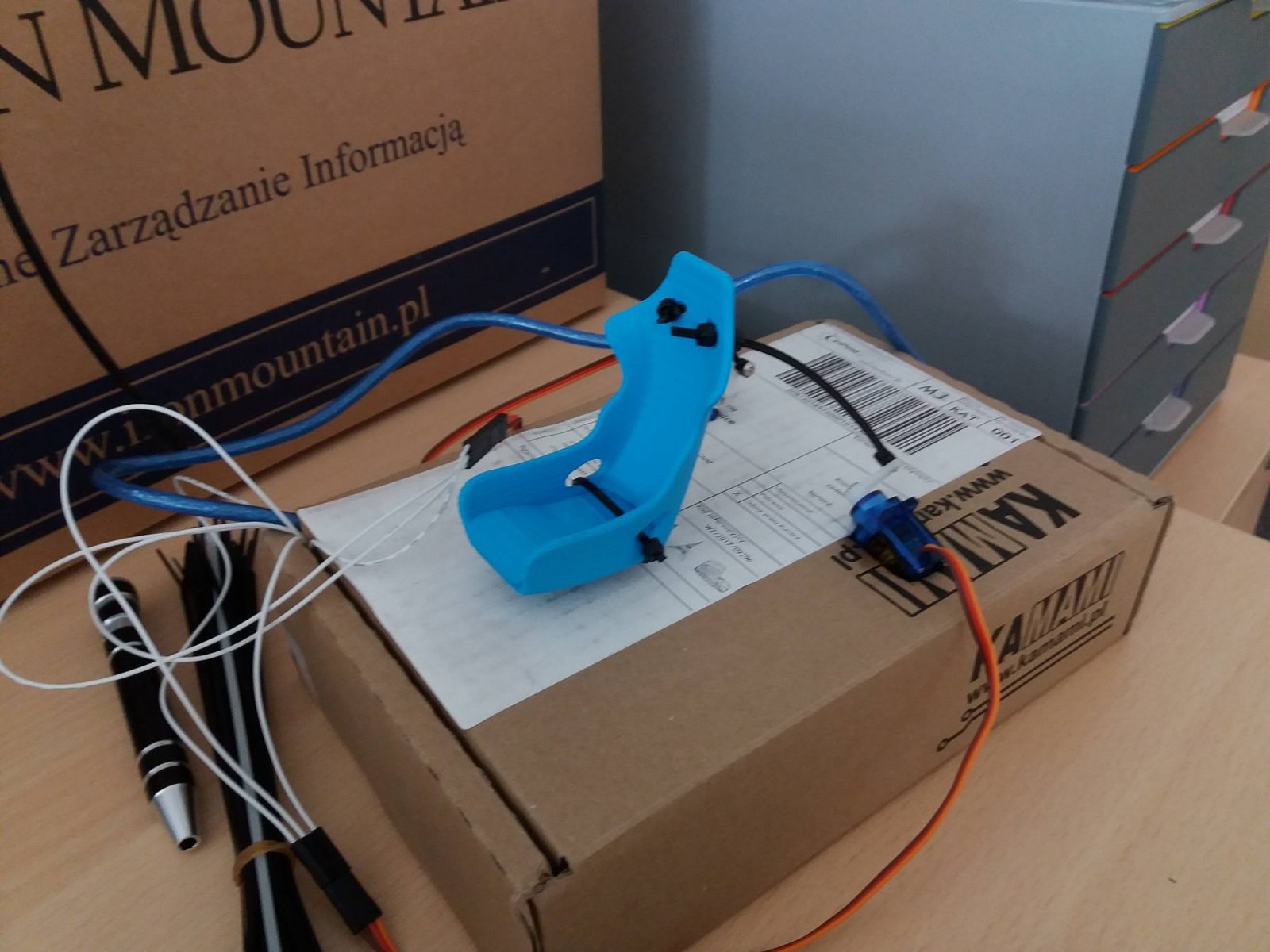

    I'm running XYZ Davinci 1.0 AIO with Simplify3d to generate g-code. Printed Recaro seat yesterday for my test Arduino rig

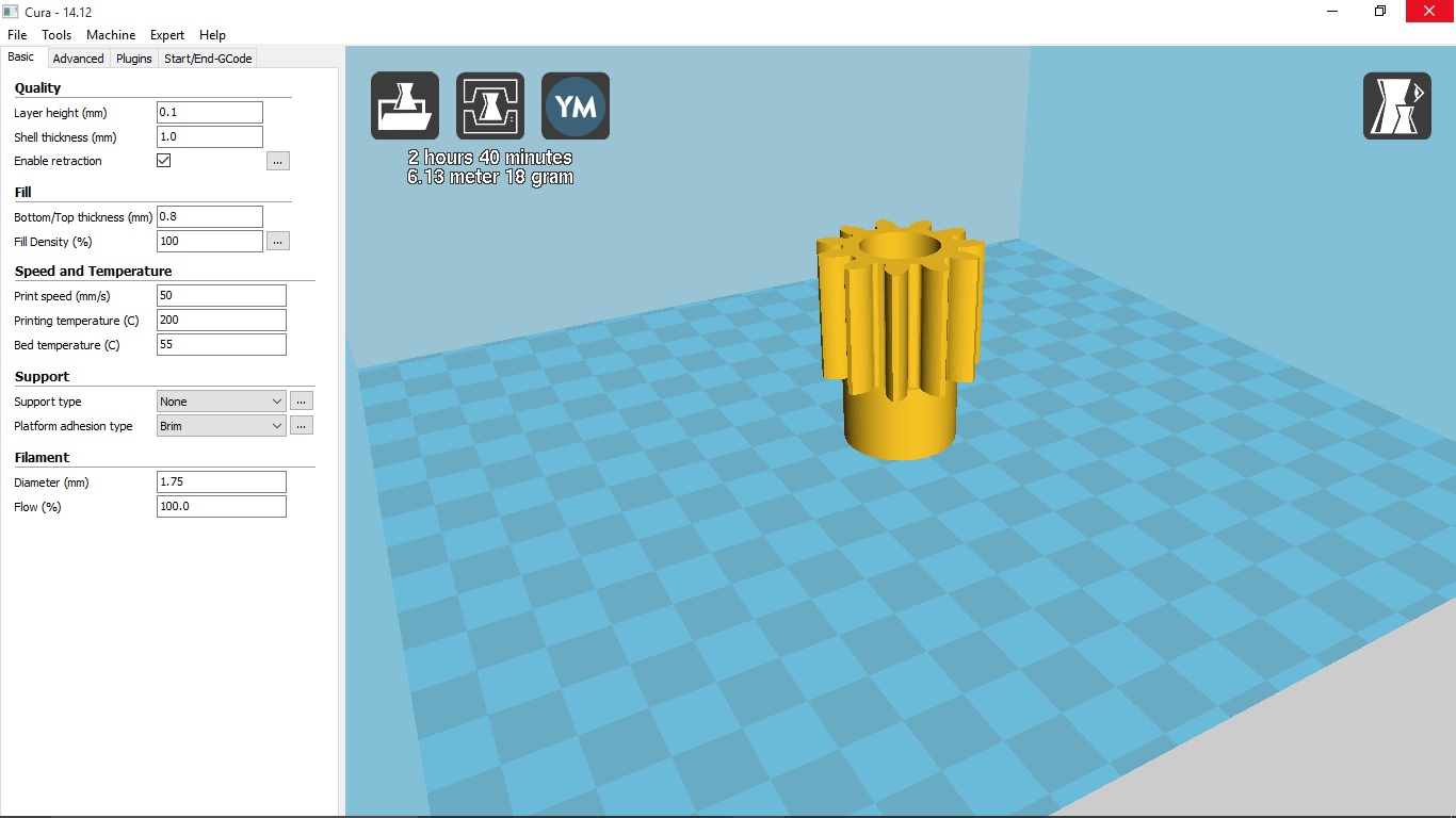

    Ok, printer gurus. Other questions:
    I have succeeded to bring a gear from the web site to Cura (passing by fusion 360), but the gear is upside down. How can I turn it the other way around (in Cura or fusion 360). For me, who's been working in 3D for more than 10 years, not being able to do such a basic thing is outrageously frustrating, to say the least. I'm not even thinking to change any measures, as I am not there yet.
    Other question. To print with a SD card, what's the pipeline? What is the file format to use? So far, my attempts simply provide me an 'No SD card' result.
    You know good tutorials for Fusion 360? I am all ears!

    Not being a Cura User i cant help you there but in Fusion just click on the body, click "m" on your keyboard and make sure your playing with the Bodies and not a sketch or anything else, Then use the Arrows on the Screen to Flip the part, Save it and then back to Cura, You need a gcode from Cura to load on the SD card, the printer reads gcodes, NOT .stl files.

    Thanks. Works in fusion, but changes nothing in cura.
    When everything fail, read the instructions. :(

    If you click on the part you should see another button appear on bottom left of the screen that has options to rotate the object.

    Thank you so much. It was so simple, no wonder I missed it completely.
