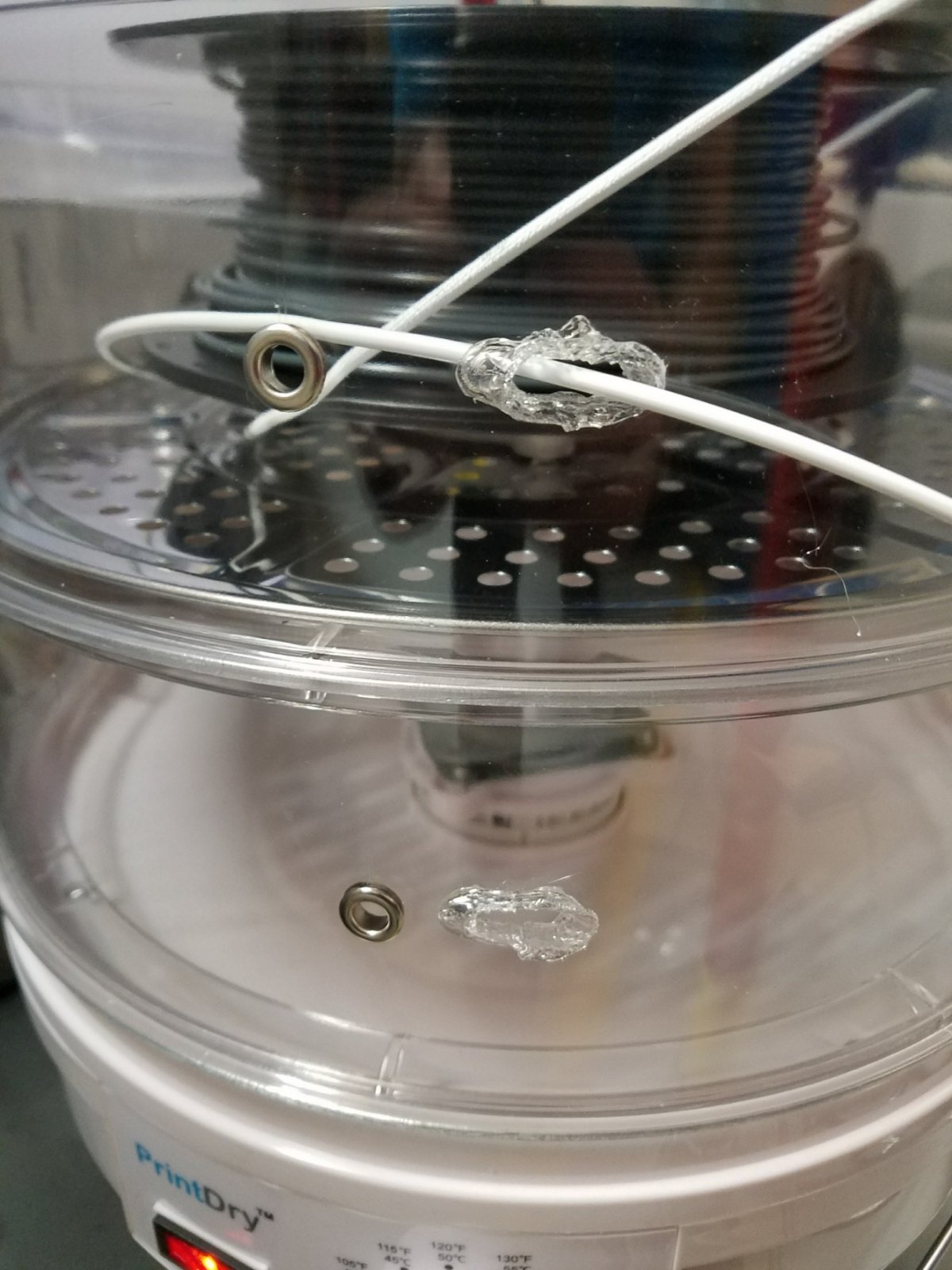

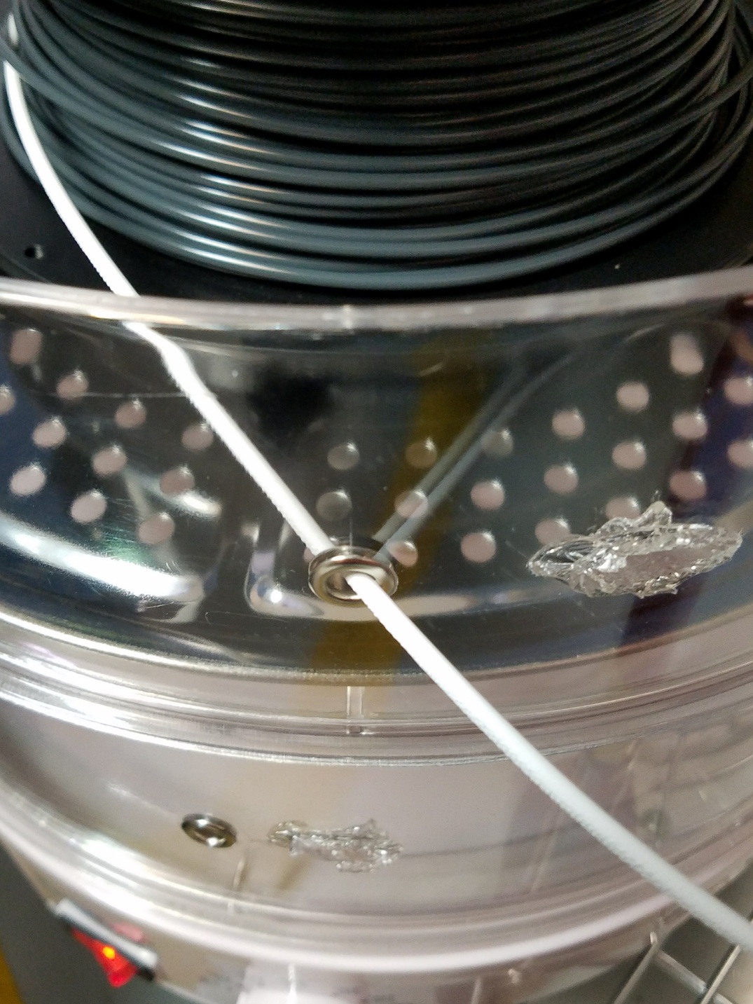

    Well, i got the print dry device, but I don't like the position of the holes for the filament to dry while print. The filament comes out in angle and has resistance. I melted my own "angled feeding holes" to help it.

    Alll you have to do is turn the holes to match the angle your printer is pulling at. If you twist the walls you will see what i mean, the Stock holes are all you need. No melting required.

    I tried that but doesn't work for 3mm filament, it presses against the hole walls. See what i mean below (used a piece of white filament as i was printing with the one in the reel.
    The printer is located above the print dry, so its even worse trying to pull the filament up!
  9. Nick Moxley
    17,057Coins
    +2,507 / 30 / -2
    Ahhhhh, I only run 1,75mm so explains it....... You need a near perfect angle for 1.75, So 3mm would be a no go. Thanks for clearing that up . :thumbs

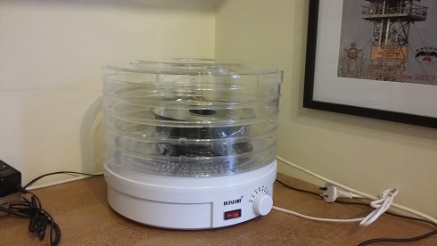

    It arrived - just need to put it together :).
  11. SeatTime
    2,572
    The Drier has arrived. At $40AUD, I'm pretty happy with it :). Would have cost allot more for the 'Print Dry' especially once you add postage to OZ :eek:. Just need to put a 'lazy Susan' like rota-tor in the base so that the spool can turn when I use it with a operating printer.

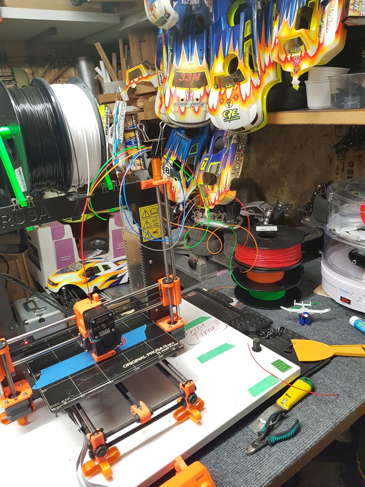

    I REALLY prefer having my extrude on my X axis, I couldn't fathom of dicking around with tubes and feeding it all the way in and having to deal with that. Here's a picture that should show how much i change filament and colors at times, Having a different printer without a direct style feed, I would loose my mind.

    So far, I don't care much about colors. This could change of course, but it takes so much effort to simply load the PLA in my extruder that once loaded, I don't really want to change it.
    You are well set up, and I understand why you want to keep it that way. But it looks like you already change many things on you printers. Is it the case? And I see that you do have an dehydrator, my PLA would sleep into it if I had one.
    I have to be careful that sometimes I want to change stuff just for the sake of messing things around instead of doing it to accomplish real work.
  16. Nick Moxley
    17,057Coins
    +2,507 / 30 / -2
    I honestly haven't added much at all to the printer, I was on the Anti Vibration feet for a while, but have since remove them after a bearing swap after a year's worth of use. (wow fresh bearings are nice)
    Aside from that, All i have printed is a different spool holder and a little Futurama Bender for the filament coming from the Dryer. I often have the Dryer running all day swapping in and out different filaments as i use them. Having 12+ different spools on hand can be a bit much for some, but i print a Variety of things and colors, so its needed for me.

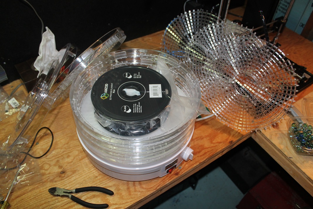

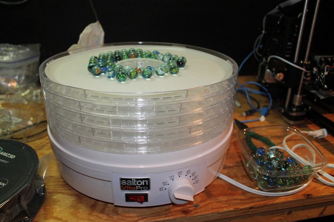

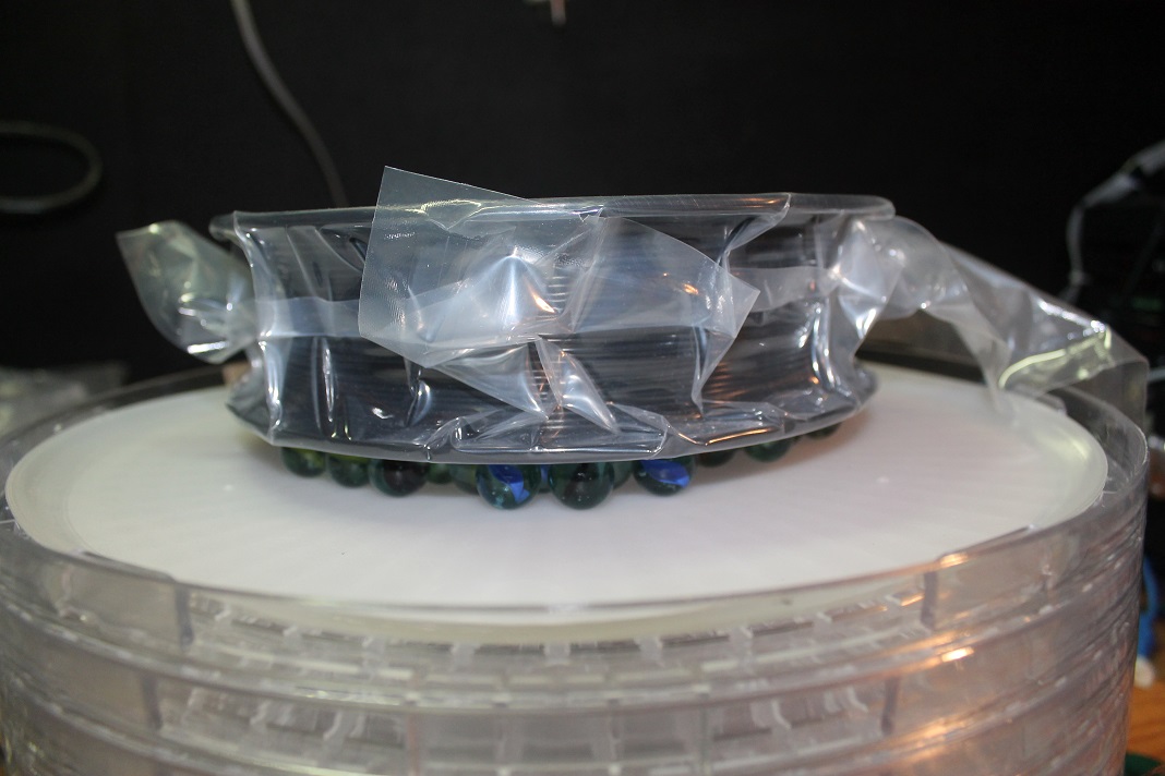

    I could not resist for long.
    I was on sold from 65 to 45$.

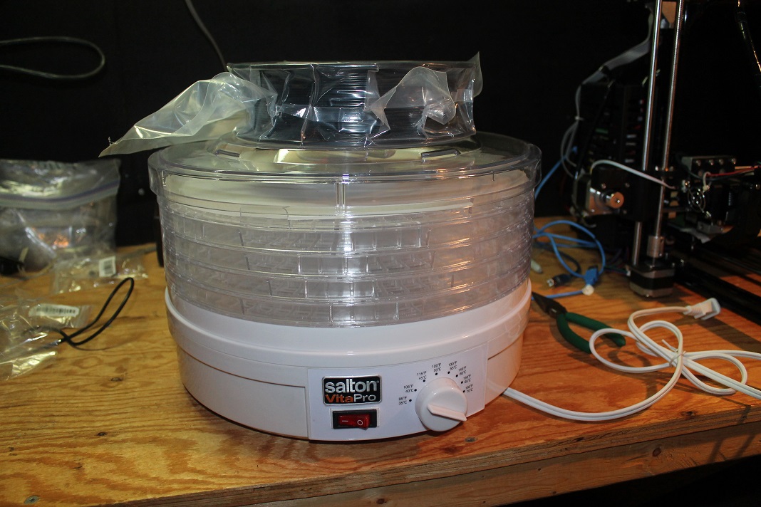

    I checked if it worked first (in case of a return) and then started to remove the center of 3 rows and I could fit my pla roll inside.
    I did a little test by just putting some marbles on it.
    Then I put my roll over it. It turned like a charm. All I need is to learn to design a proper rail for the marble, a carbon tube a the center and I should be able to pull pla out of it easely. But for now, back to lazy vacation.
