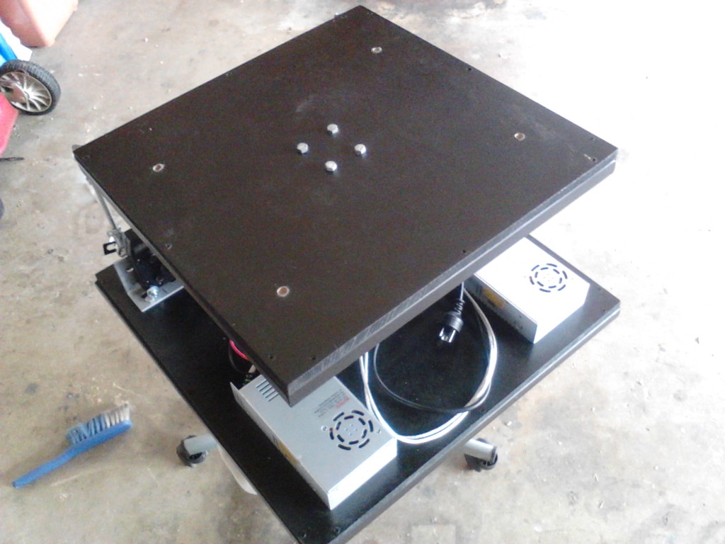

    I think this is a great idea and ive had mass production in mind durring my builds . my next build will be the lightest one so far with adjustable seat and pedals using arduino - moto monster and a new 600w psu just like the one in my pics. i would build these all day long for $1200 plus shipping.

  8. bsft
    cost him $1100 delivered, and its big motors and JRK, sent from Sydney to Singapore
  9. bsft
    Some more photos
    The new owner has had dbox guys play on it and are stunned that their $10k rigs move like this one, in fact, Ive been told this one does just as well , in fact a bit better with motion.
    Scary

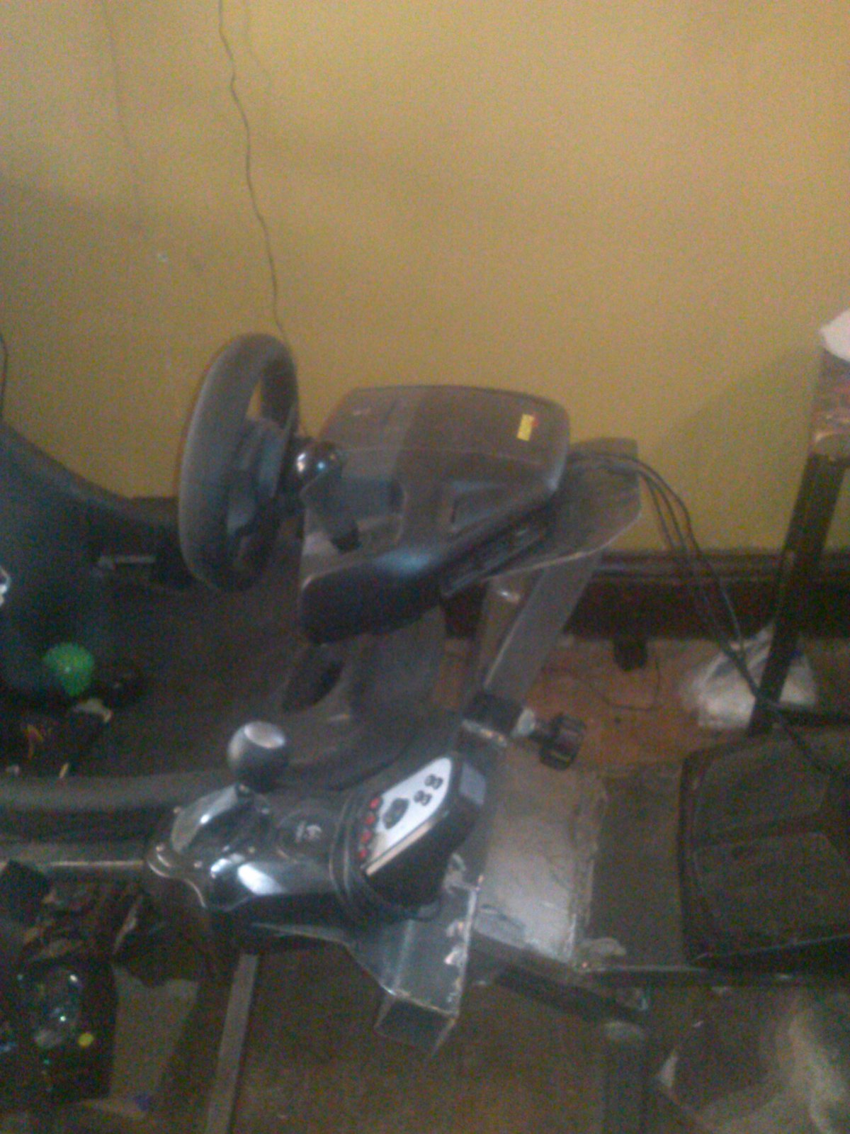

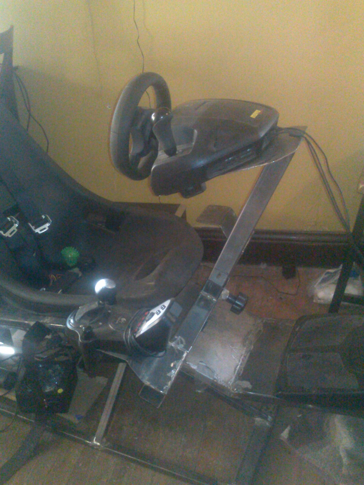

    I think that is a very nice design , ive seen those motors for sell . i havent personaly been on a sim with them though . my rig uses two wiper motors from plymouth mini vans with the long blades. I have a friend that is about 325lbs and he gets throne around in there i personaly think wiper motors work great . i also prefer to have the wheel and pedals move with me . when i play dirt 3 the motion caused by large jumps causes that belly dropping feeling , even without heave, my 6 year old can reach the wheel and pedals on my sim and in less then 30 seconds i can make it fit a guy 6'6'' . it cost me roughly 400 plus labor to build my sim . the next frame i build will be lighter for shipping reasons and few other changes to make it take up less space and some sheet metal to hide everything.

    couple pics of my adjustable steering
