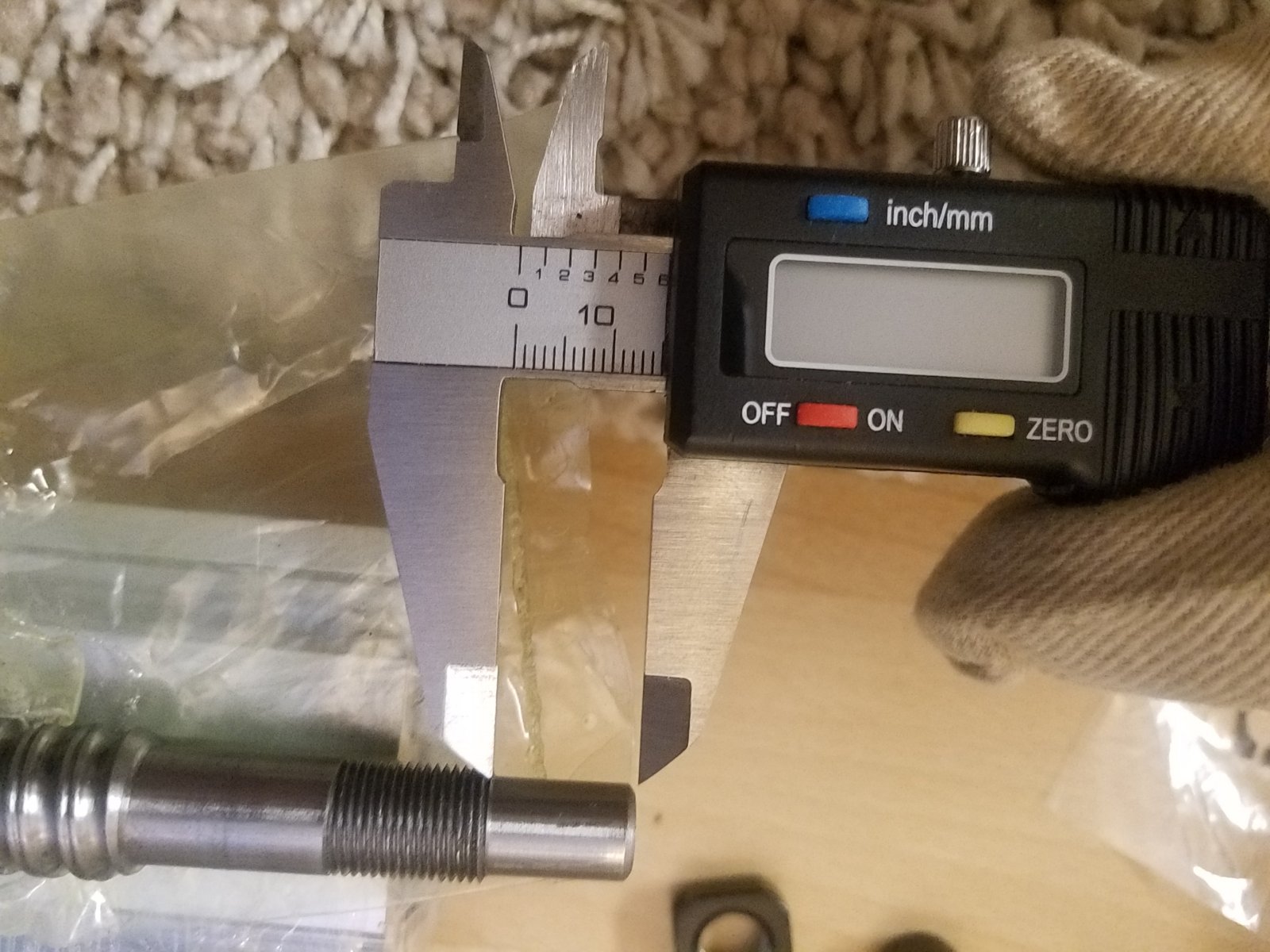

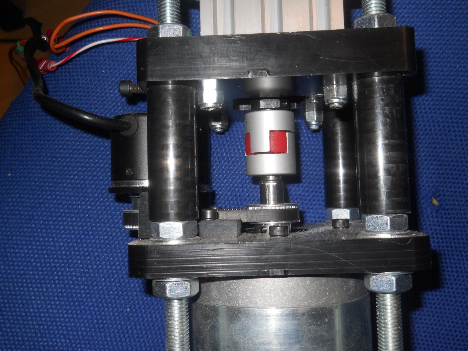

    so i am following most everyone's linear actuator design.
    but i am having trouble with implementing the design / build of my linear actuator using SFU1605...
    so the ball screw shaft has about 15mm of length to mount a 10mm coulper.
    once i assemble the bearing block with the nut, i am left with 11mm of length to mount a coupler..
    i feel this is not right??

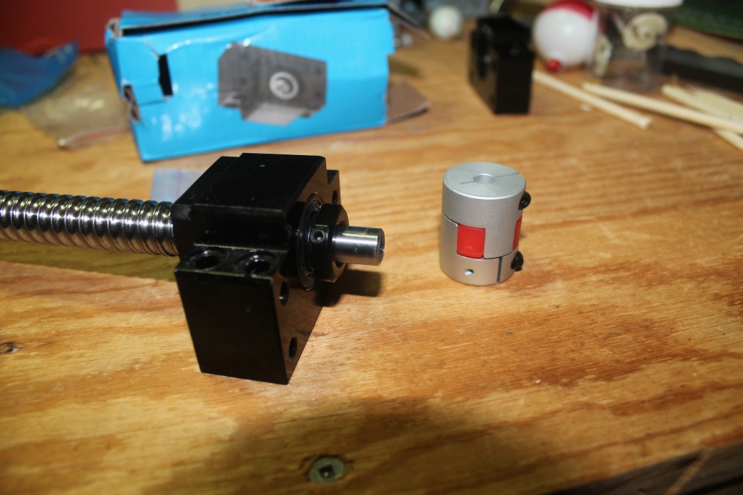

    Yes , it s about that !!
    If you want , you can put a set screw in a coupler ( drill in your couple one side of each ) and try to surfacing one side the 11 mm shaft , like this anything will spinning !
    Don't forget the nut have a sens !

    i dont know about that.
    i feel like the nut with set screw secures the ball screw into the bearing block, so that there is less wobble and play.
    what size coupler do you use?
    i ordered D40L55, which now i realize is too big..
    i thought @Pierre Lalancette 's D30L35 was too small...

  7. Dirty
    Oct 15, 2017
    746
    All the way up front.
    7,977Coins
    +890 / 3 / -0

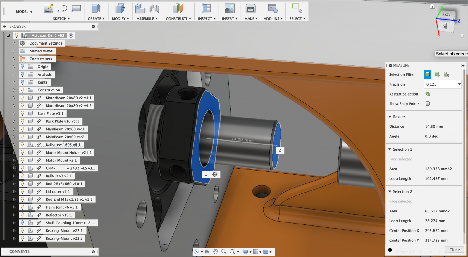

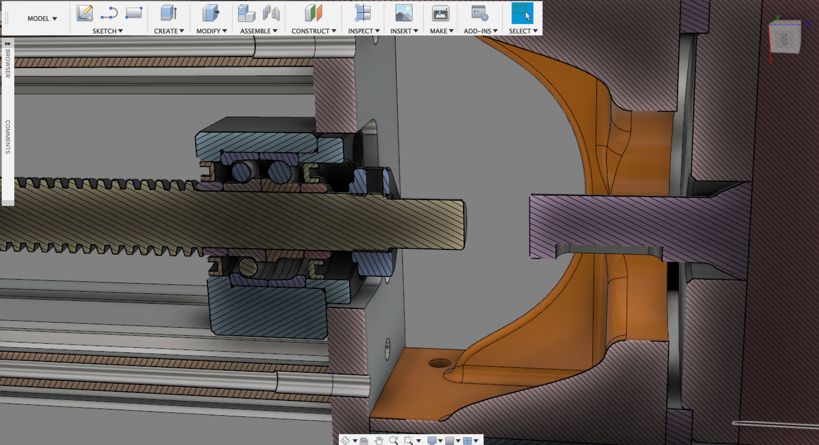

    I remember having that problem as well.
    Are you sure you mounted the bearing block correctly? I think there was a spacer in there somewhere that fell out. I re-inserted it incorrectly (or on the wrong side) and that was why my clearances were way off. I have 14.5mm extension above the top of the nut.
    Bildschirmfoto 2019-03-15 um 09.50.00.png Bildschirmfoto 2019-03-15 um 09.48.26.png
  8. hannibal
    hannibal Active Member
    Sep 29, 2018
    677
    4,492Coins
    +298 / 4 / -0

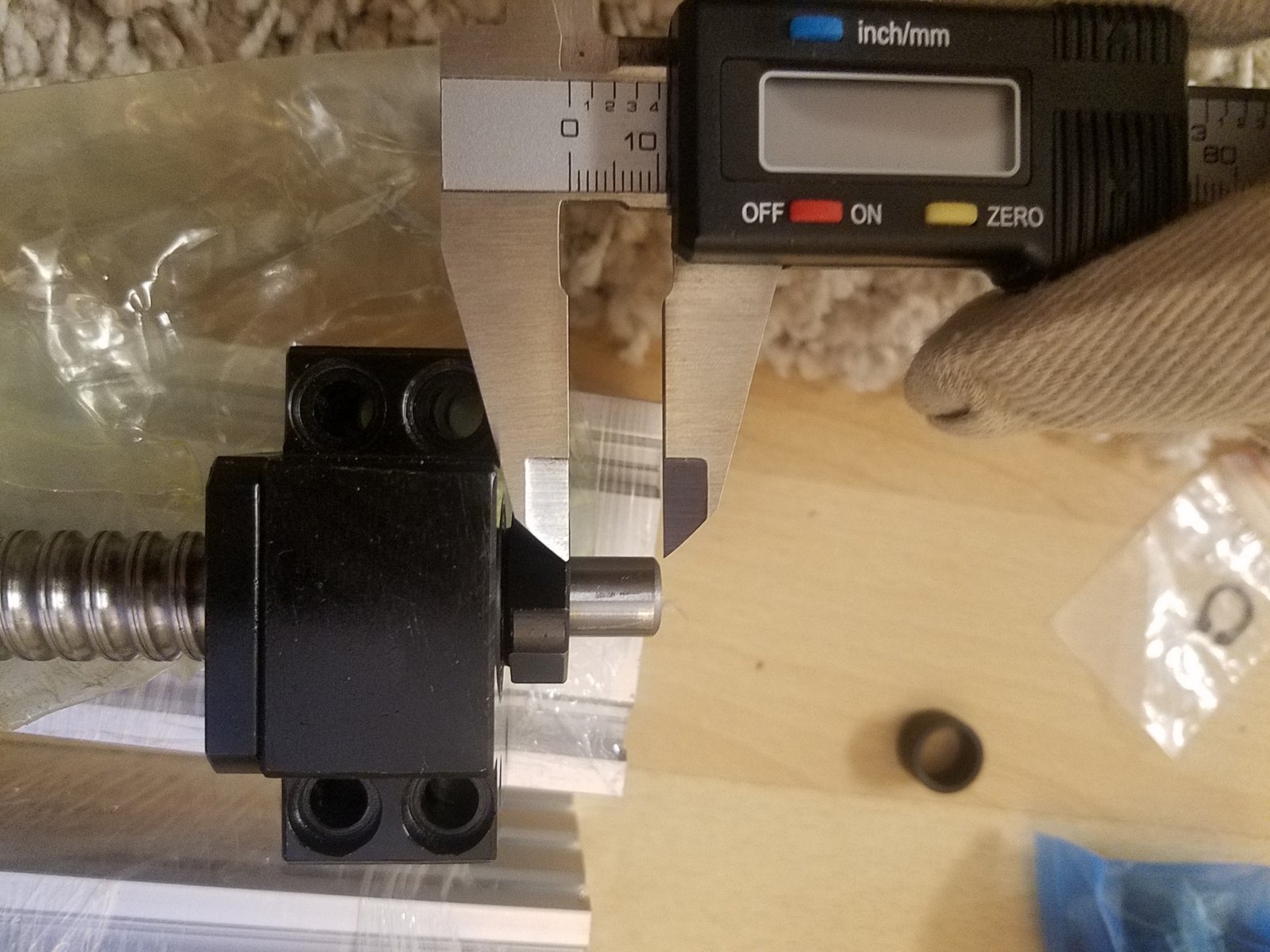

    wow. your the first person i have seen here that actually cut a square hole to mount the bearing block with the seat side towards the motor (impressive!!)..
    so i just checked. the end of the screw ball is about 51mm. the bearing block is 32mm.
    no matter which way i face the screw ball or spaces, i still only get about 11mm of shaft to mount the coupler.
    but i noticed that in you cad picture, the spacer towards the motor looks short than how mine is.. its like i have to find a spacer that is shorter.
    how ever i do see that each bearing block comes with a 9mm (tall) space and a 7mm (short) spacer. if i take a 7mm spacer from another bearing block and place the two 7mm spacers, then i am able to have about 14mm of coupling..
    who else has this problem!!
    ***just ordered some 12mm ID / 16mm OD x 7mm aluminum spacers... i just hope aluminum is as strong as the spacers that came with the Bearing Blocks... they look like carbon.. **

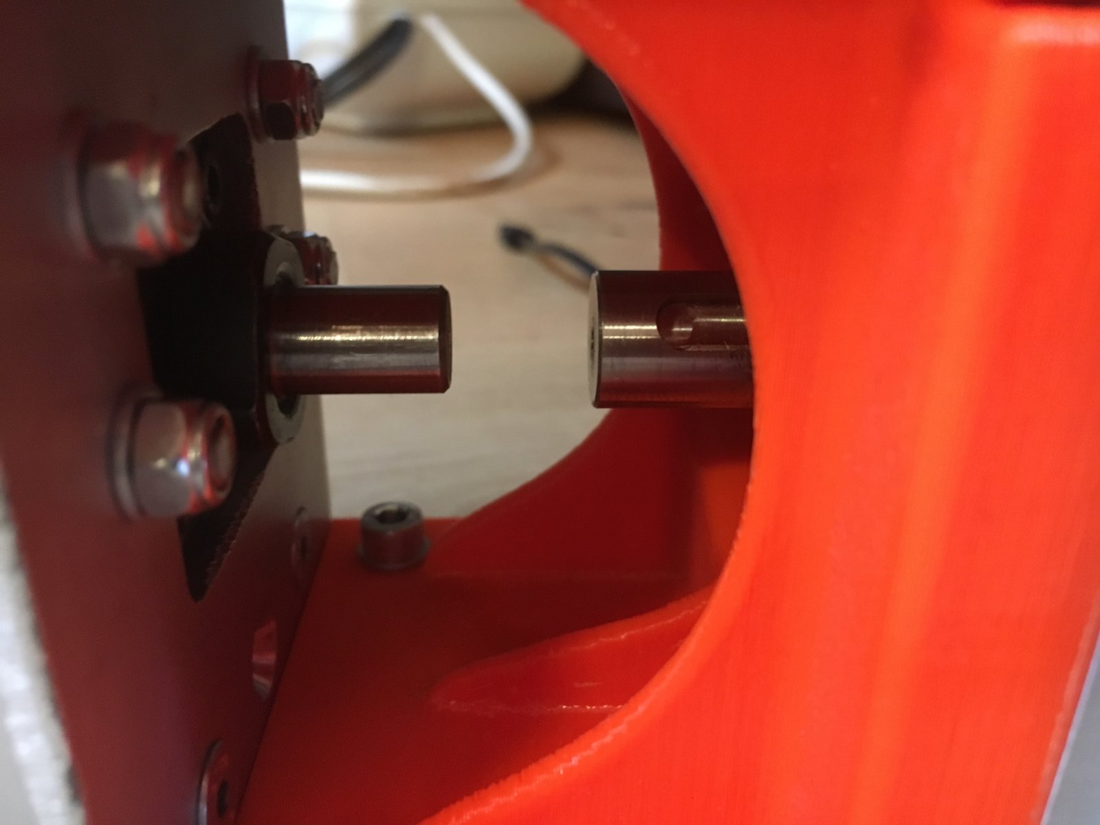

    Hi @hannibal bit late and seems the guys have already answered your Question, For my Actuators the 15mm provided a decent enough clamping surface for the Coupler I used , ( see Pic attached ) I can only say that using these types of Cushdrive couplers also allow you to Pin one half Directly through the Actuator shaft so in effect get maximum security . I have not Needed to do that yet But then again I have not driven the platform for a long time or under full simulation speed and duration , but certainly the pining option would help if required further down the road ,, Cheers

    The side B is flat and the side A have a little bump for spacing with the bearing !
  11. hannibal
    Sep 29, 2018
    677
    4,492Coins
    +298 / 4 / -0
    wow.. so you have the seat side of the bearing block towards the motor as well... hmmmmm
    i have to investigate this more! traveling at the moment
    thanks for replies @Flymen @wannabeaflyer2
    but i still dont see how u guys actually get about 14mm shaft to couple with both the 9mm and 7mm spacers that we included with the bearing block.. i totally understand what everyone has said about the pictures everyone has attached and the lip on the nut (what @Flymen calls "the bumb") goes towards the bearing.. i wish i know what your spacers sizes where on your builds, but obviously your builds are fully assembled!
