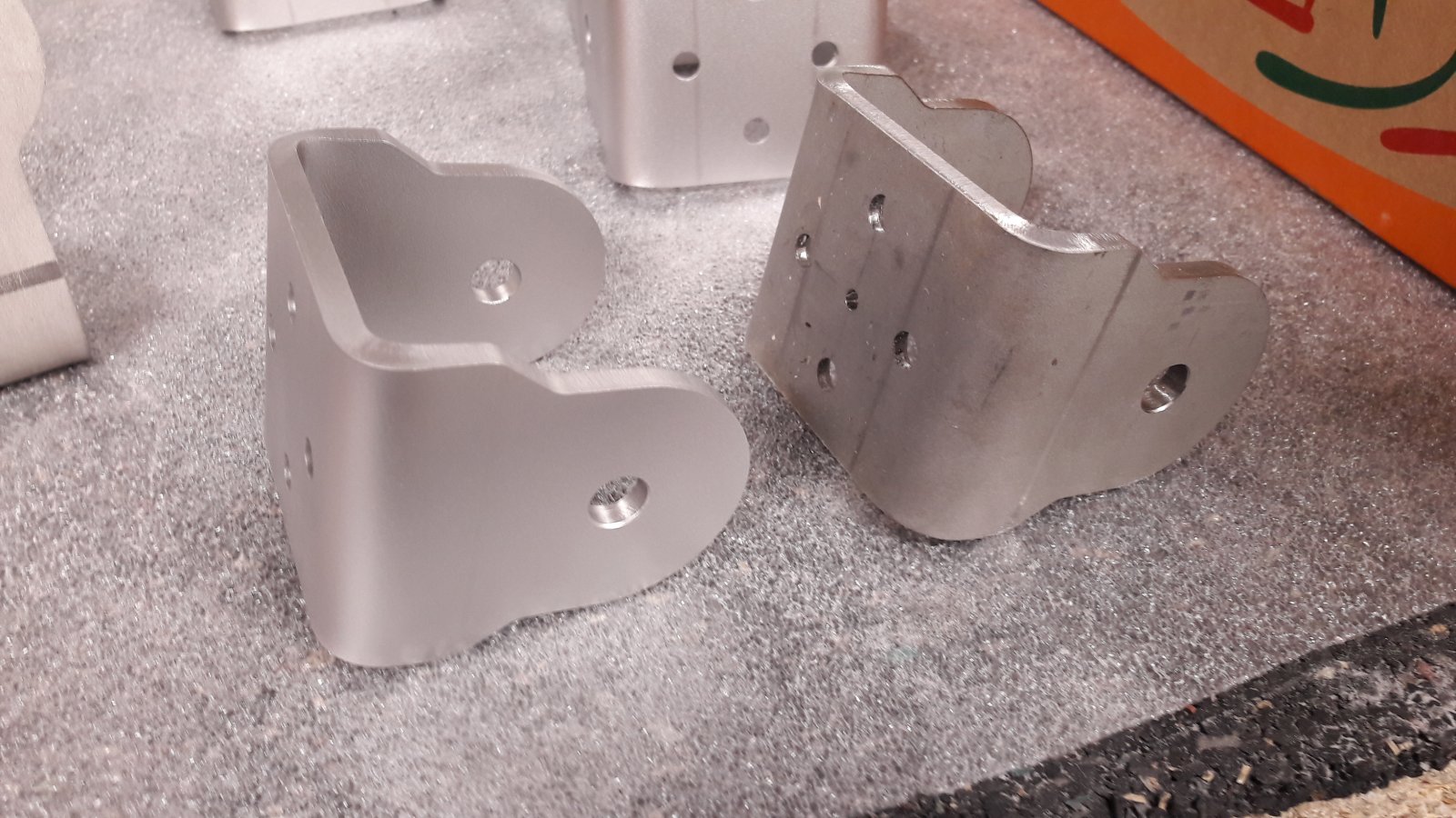

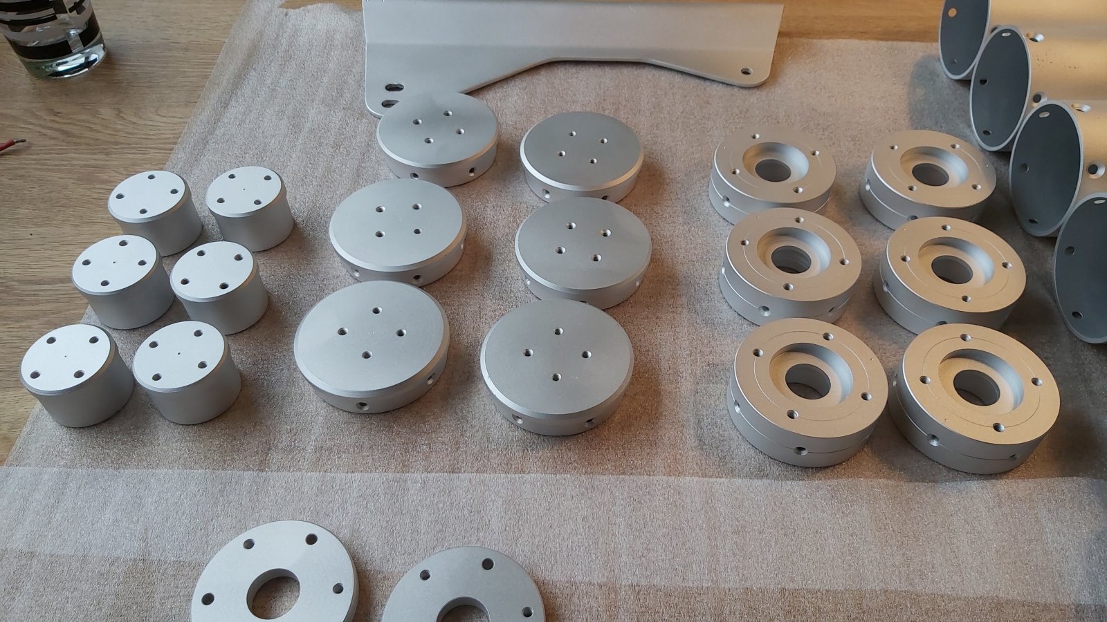

    last week I made the fine finish of my universal-joint-brackets. Here in Munich we have a company where you can rent a cabin for DIY glass shot blasting (https://www.braeuer-sandstrahlerei.de/).
    It was a lot of fun and cost only 20,- € total for all 18 parts. It took about 40 minutes time.
    highly recommendable! :) see picture:
    Wickie

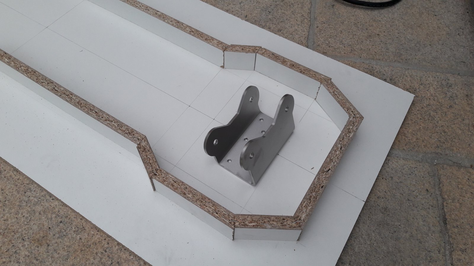

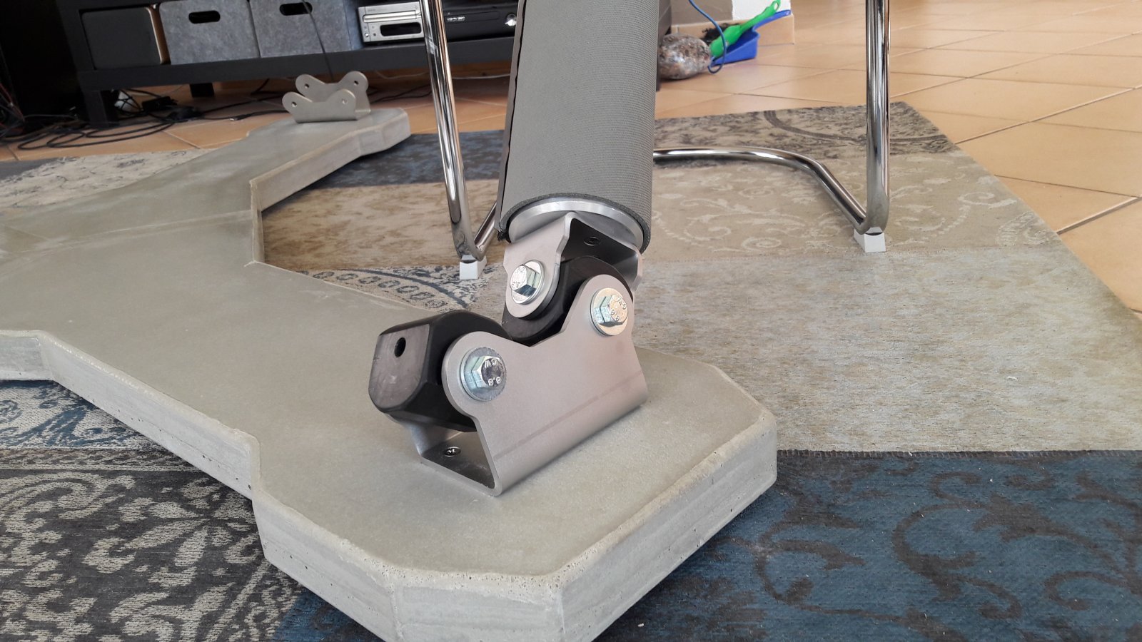

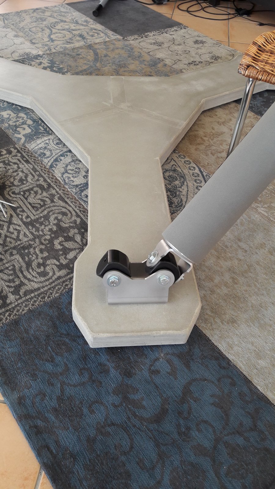

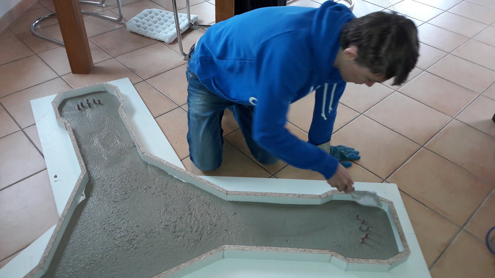

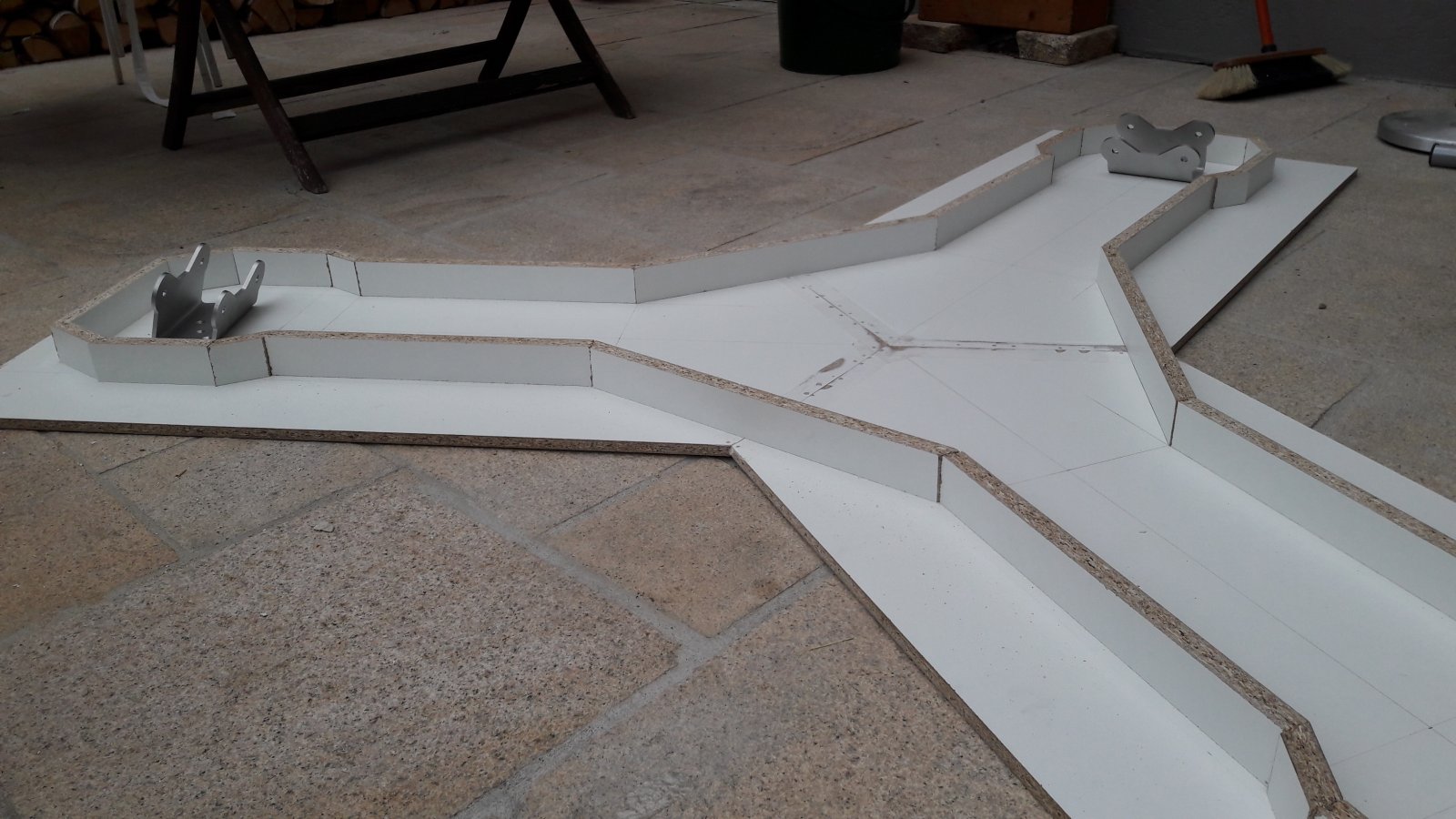

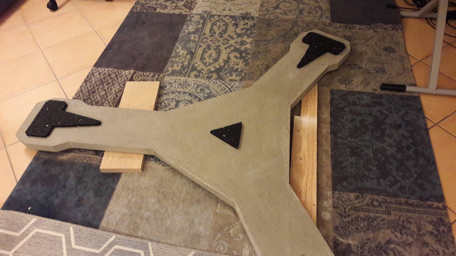

    dear community!
    again some update of my project:

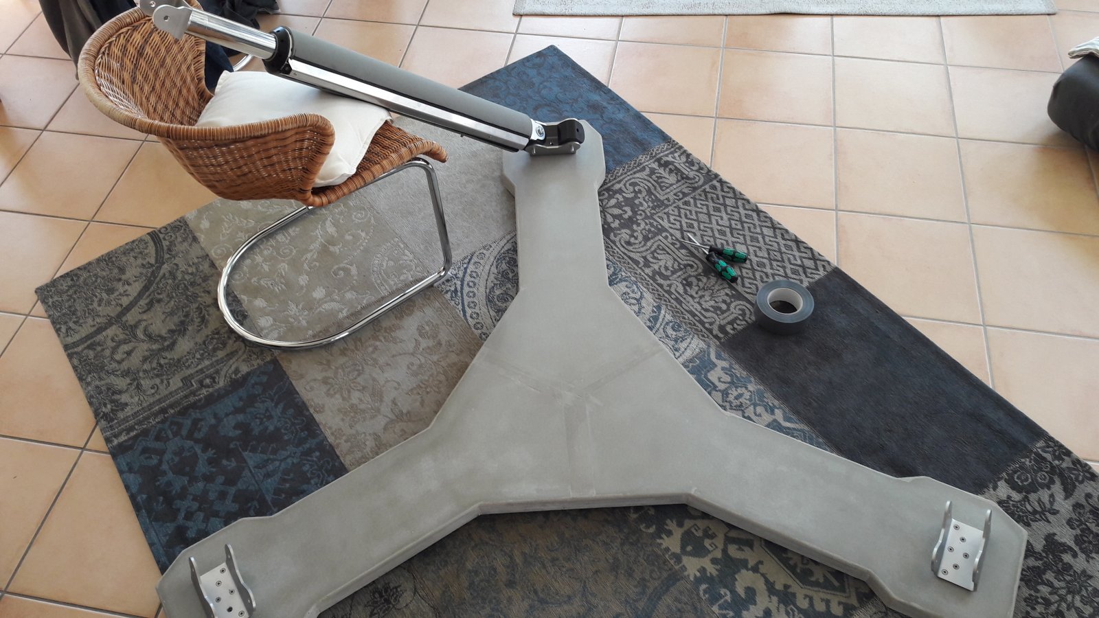

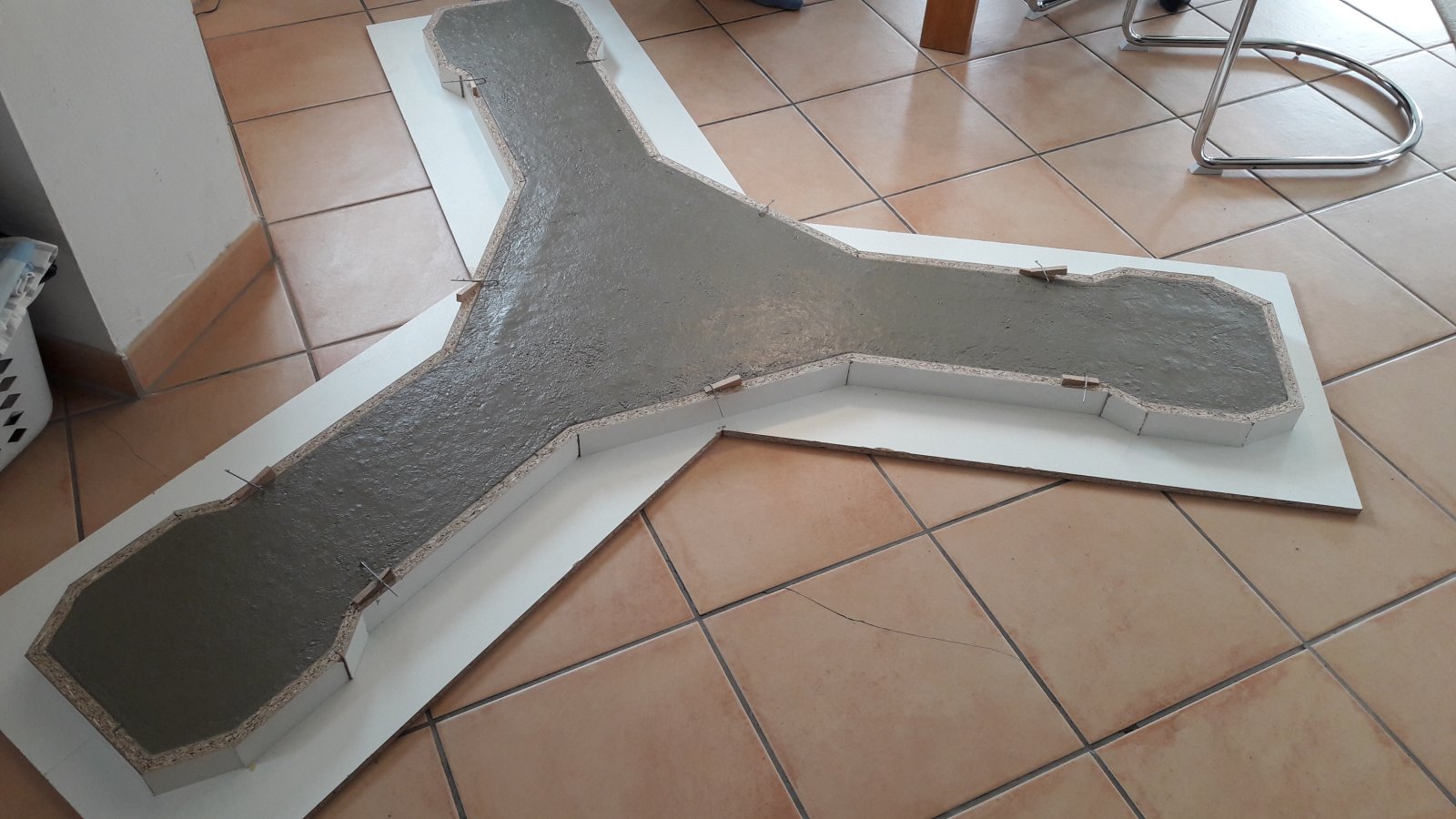

    The last weeks I made more thoughts about the upper part of the platform and the base
    As you can see I changed the design of the base – It was due to a proposal of my son - and what shall I say - we love it!
    For the material of the base I decided to make it from reinforced concrete. The reason for this material is because I wanted to have a stable and heavy base and minimum of vibration noise coming from the actuators.
    And last but not least - I think it will look super cool (at least in my opinion :) ).
    So we started to make a mould from wood and purchased cheap concrete for about 15,- € (for 90kg) - as it turned out it was too cheap !!! so during demoulding our base cracked. I also think we have been too unpatient and didnt wait long enough for hardening.
    So we decided to build a new mold - and due to the lessons we learned so far, the second mold became much better than the first one.
    Also this time the concrete we used was an expensive and special one that is usually used for making concrete furniture. The price was now 117,- (for 75kg). But believe me, it was worth all the money!
    Now the base is finished and we are super happy :)
    The weight of the base including the reinforcement is now about 80kg – so possible to carry with two or three persons.
    attached you can find all pictures
    Wickie

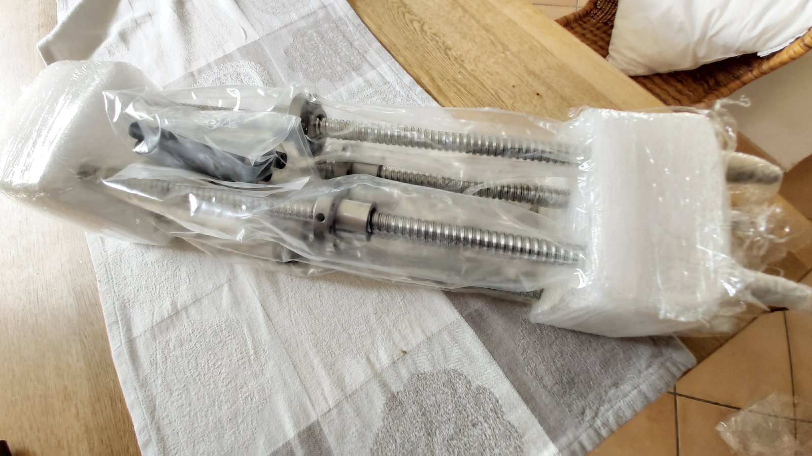

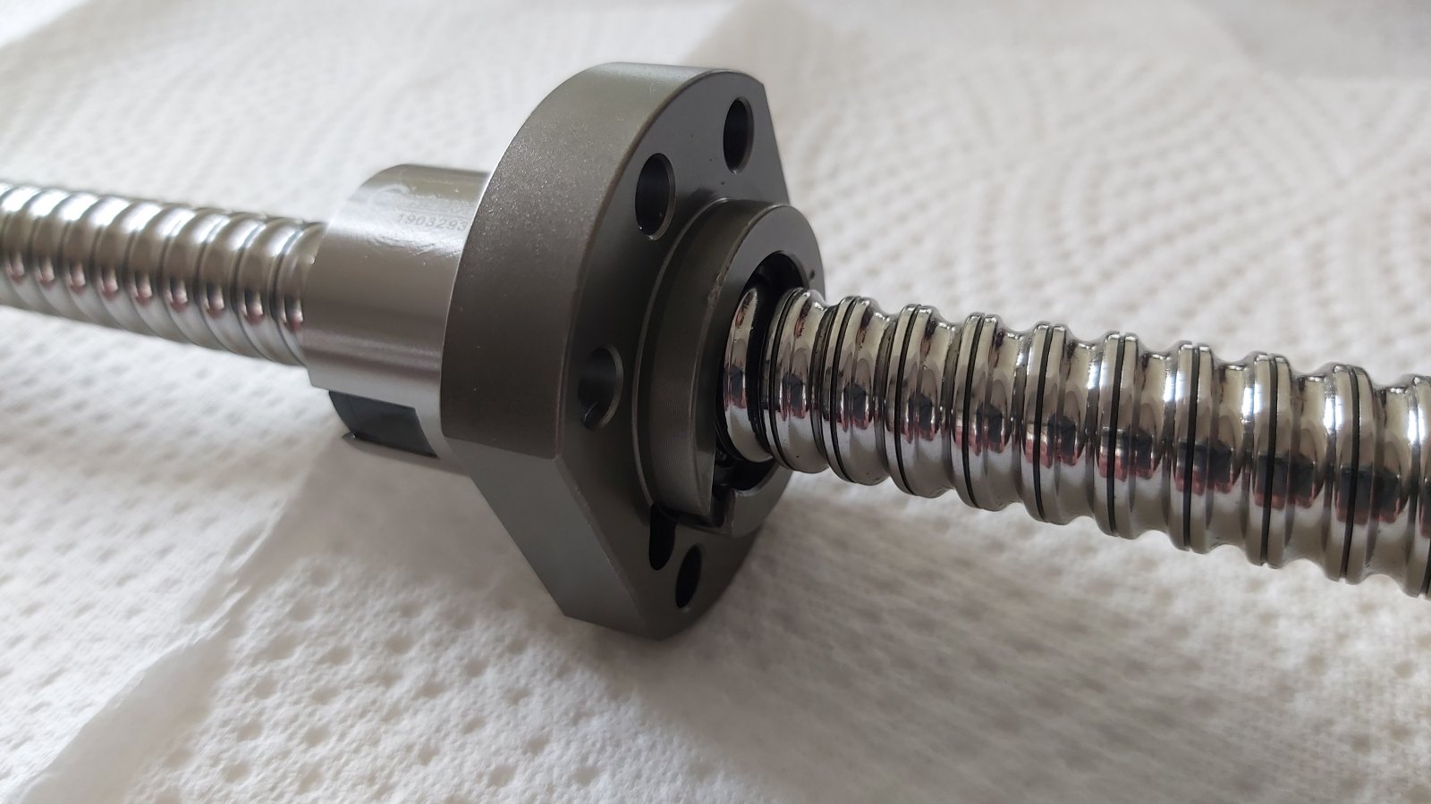

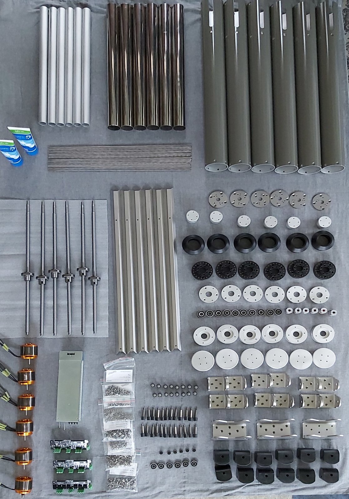

    Hello all!

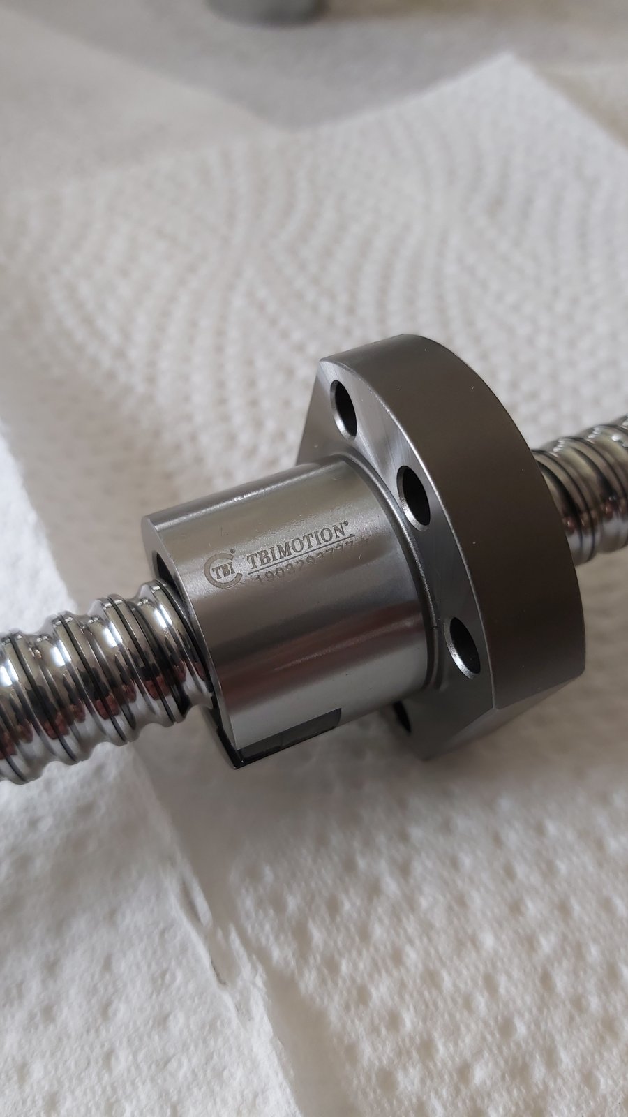

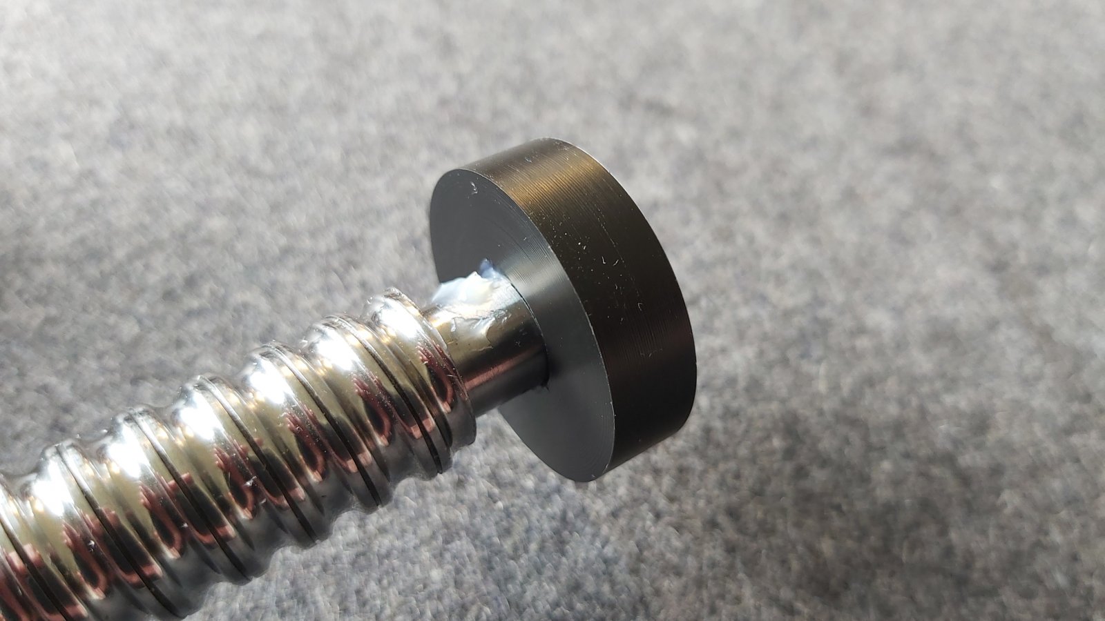

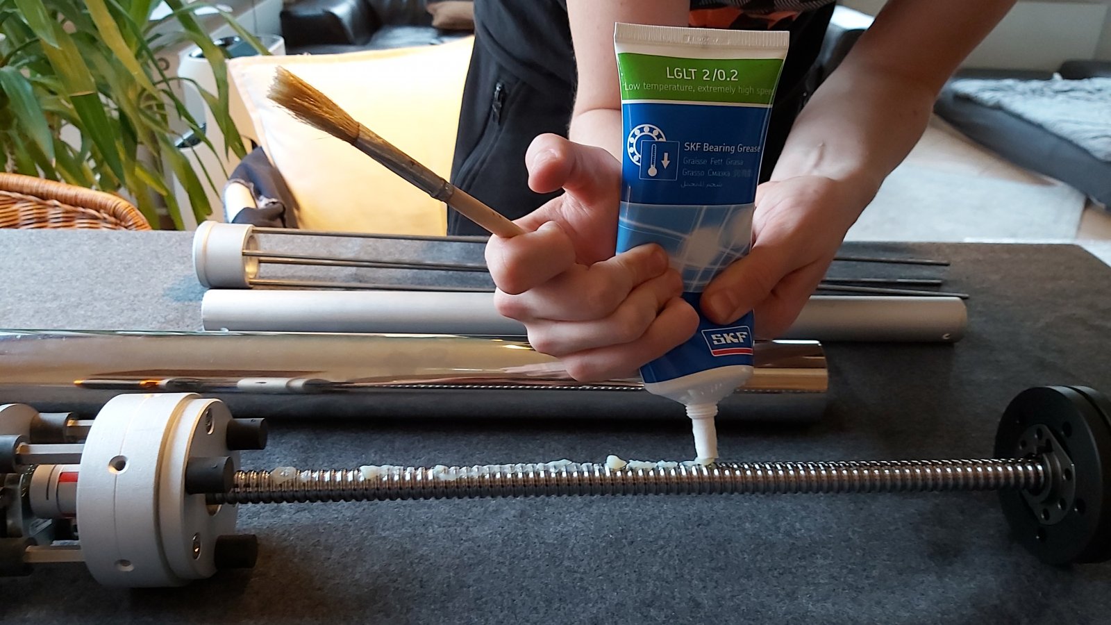

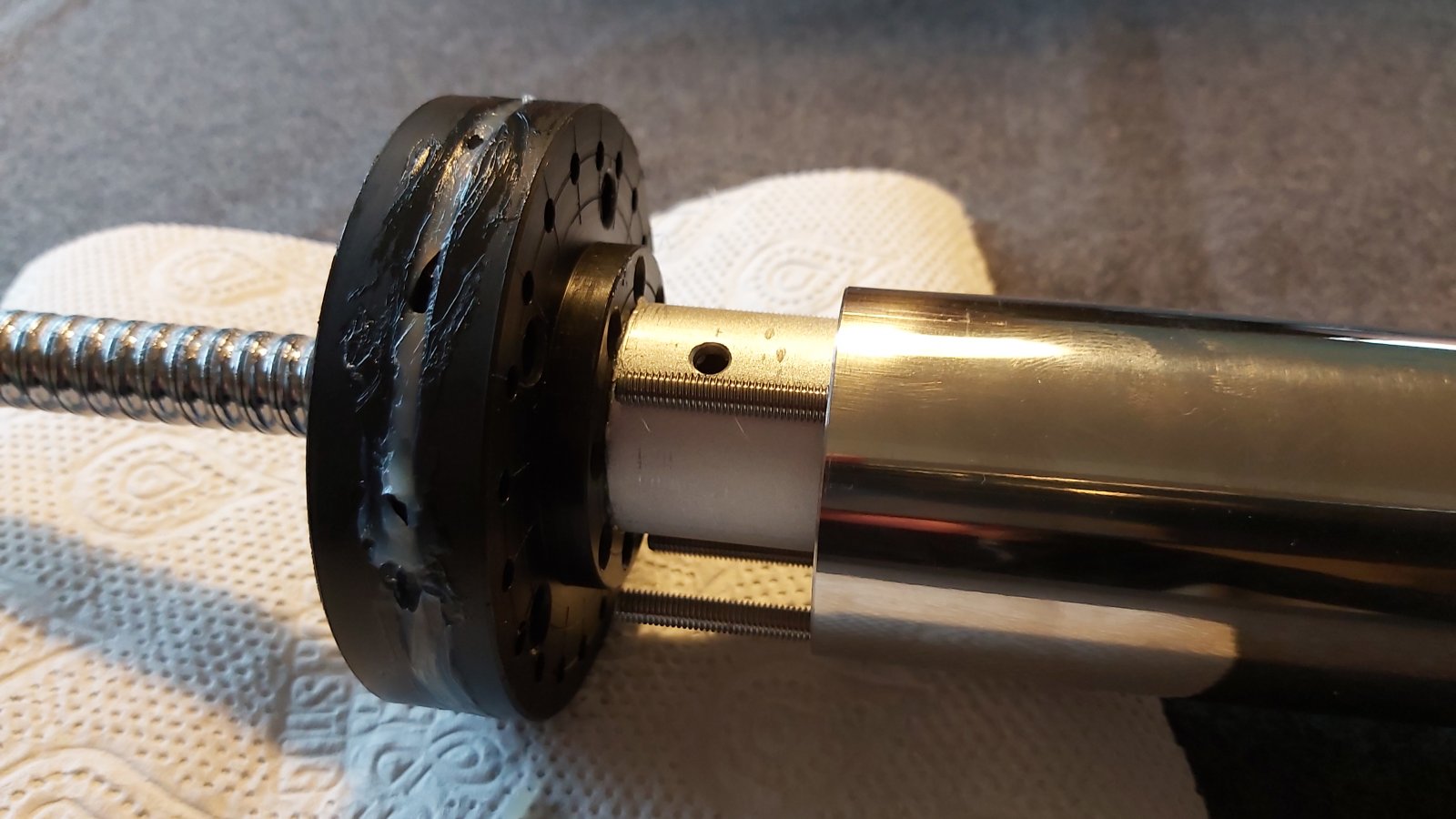

    Last week I received my high-speed quality ball screws from TBI Motion!
    The shop where I bought the ballscrews is called Tuli (https://www.tuli-shop.com/linear-mo...d-nuts/precision-ball-nuts/ball-nuts-sfh.html).
    After the first attempt with cheap China ballscrews (which I had exchanged again because of the running noise), I finally decided for the 10 times (!!) more expensive quality ballscrews - hope they are worth their money and run quietly.
    Since all parts of my actuators are almost finished, I think the final assembly of the actuators can be done in the next weeks! I am sooooo corious.
    Wickie

    Hi Peter does youre new good brand ballscrews give les noice?
    regards Ad
  12. PeterW
    PeterW alias Wickie
    Oct 21, 2018
    230
    Dipl. Ing. Mb (FH)
    1,767Coins
    +428 / 3 / -0
    Hi Adgun
    assembly of my actuators will be aprox in two weeks, so I think we will know it in three weeks
    Wickie
  13. adgun
    adgun Active Member
    Jan 28, 2008
    538
    mechanic
    Netherlands
    5,801Coins
    +138 / 4 / -0
    Hi if you are so far would you be so kind to post pickters from the ballcontact area from booth screws if possible.
    The noice could be visible
    Sorry for the bad english
    regards Ad

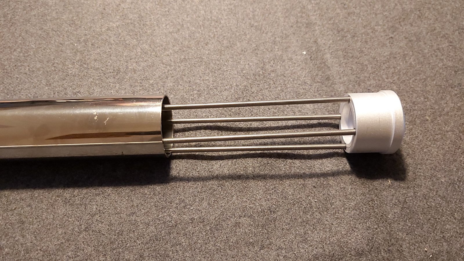

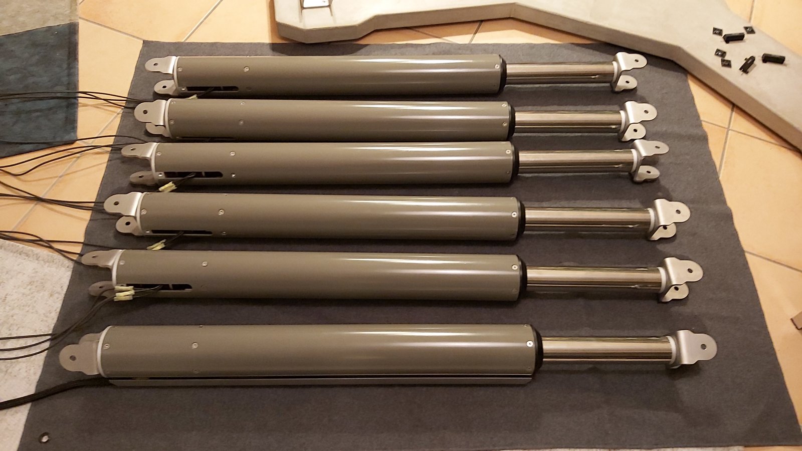

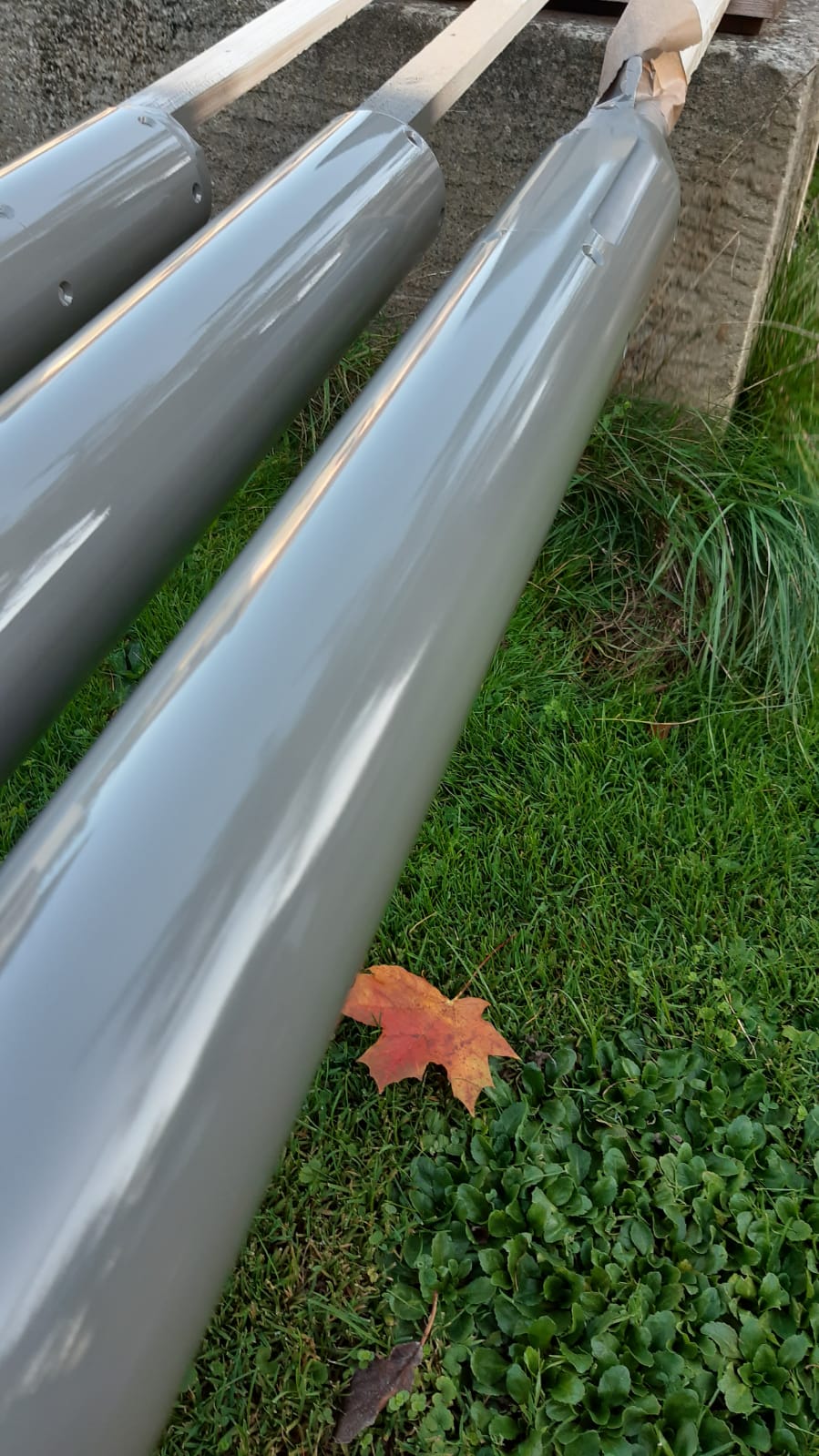

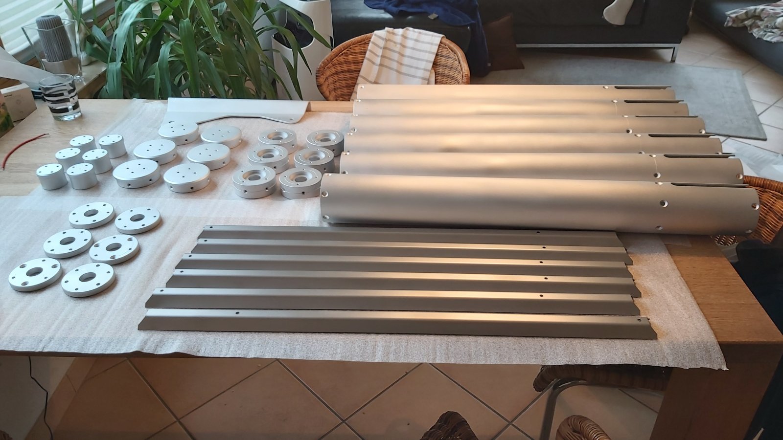

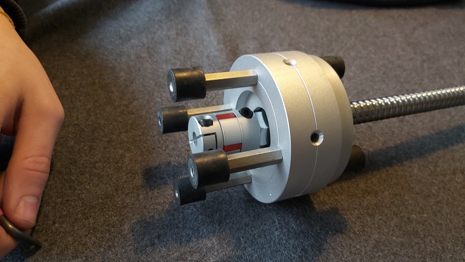

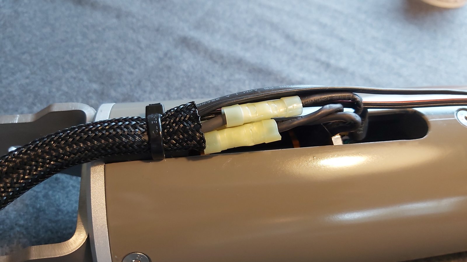

    Hi guys
    some little update on my project. Yesterday I finished the last parts of all my 6 actuators - really all! - I can tell you guys - it was a lot, lot of work! - I think it have been alone more than 200 threads to cut!
    Today I gave the Zylinders some paint (same color than the later rubber-cover - RAL 7039).
    Wickie

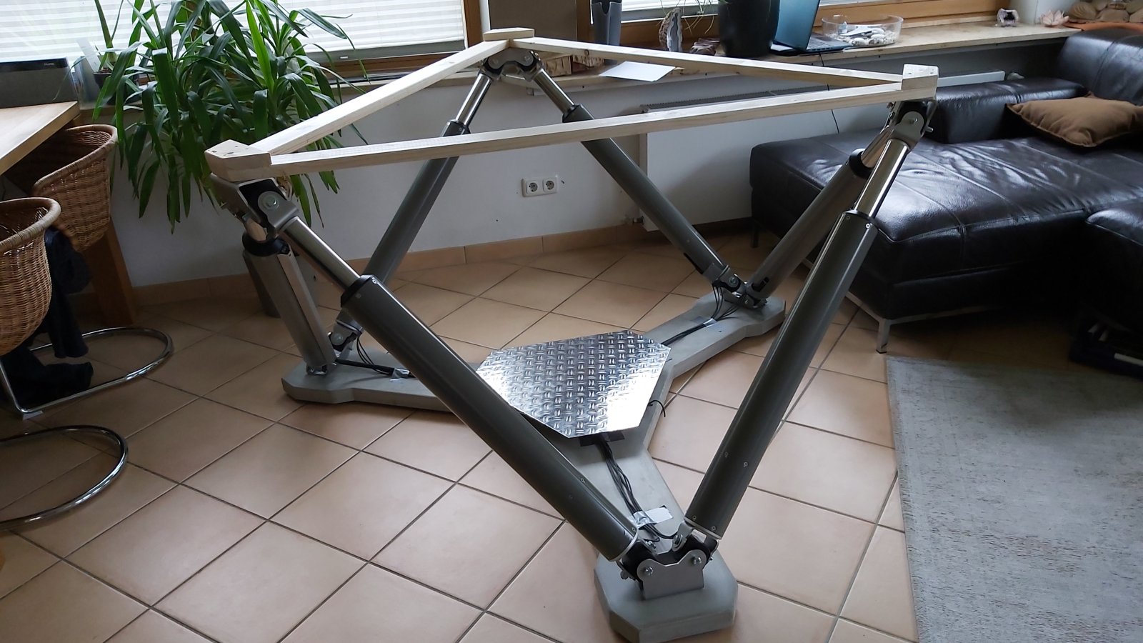

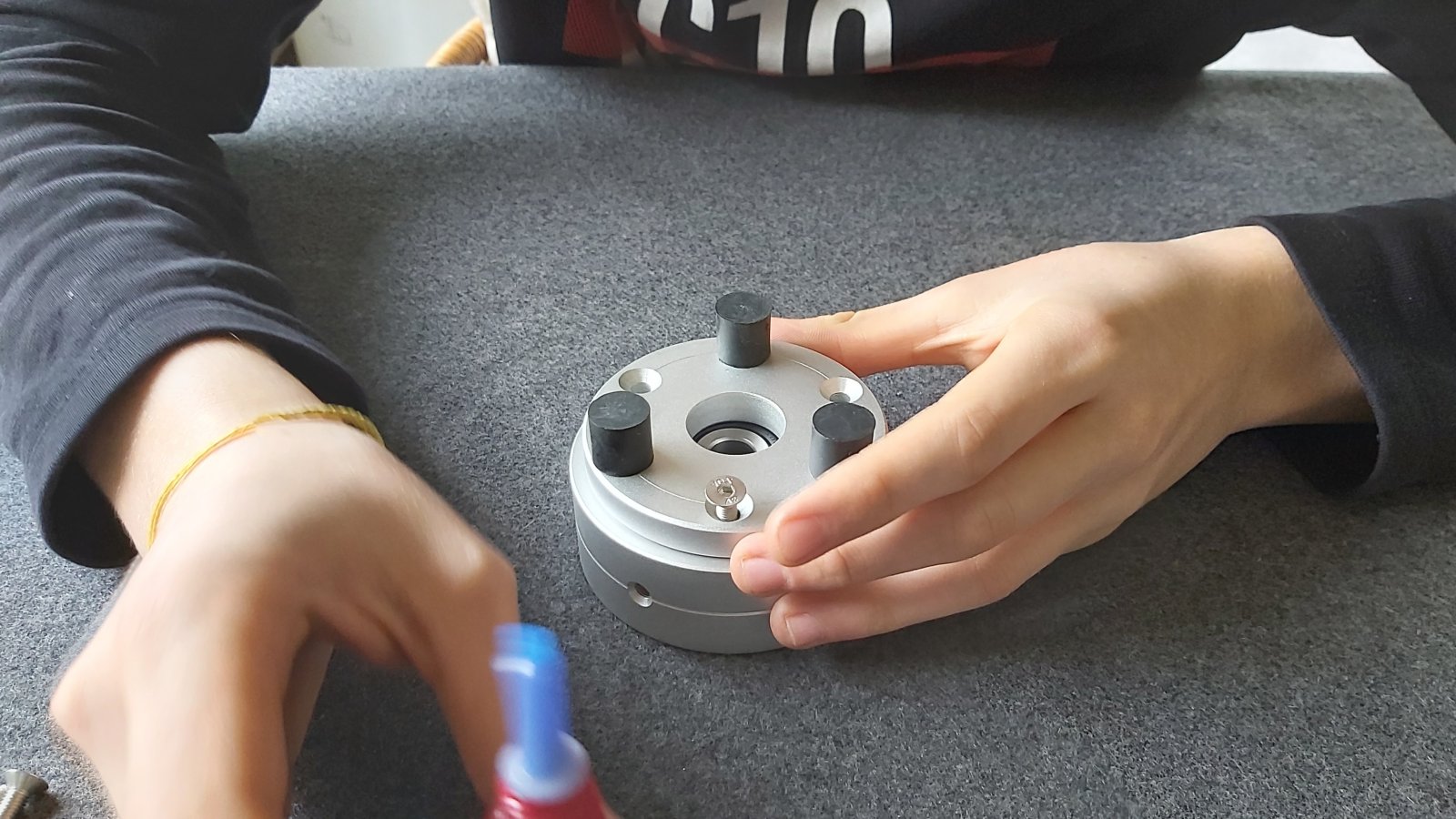

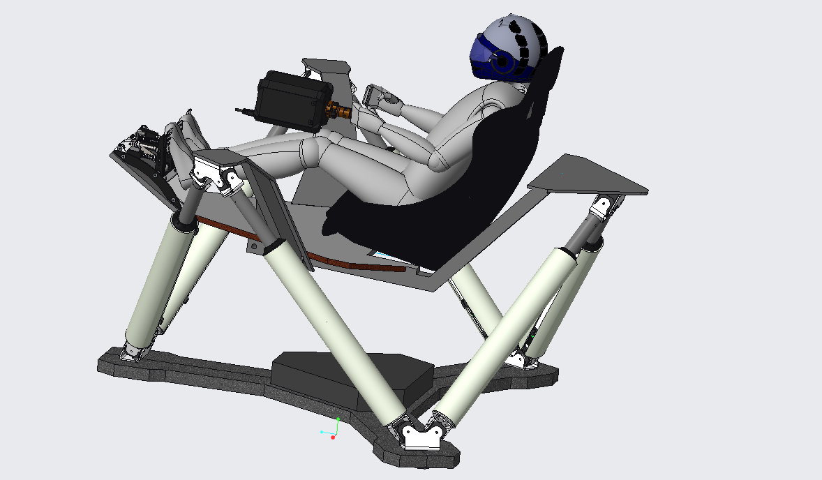

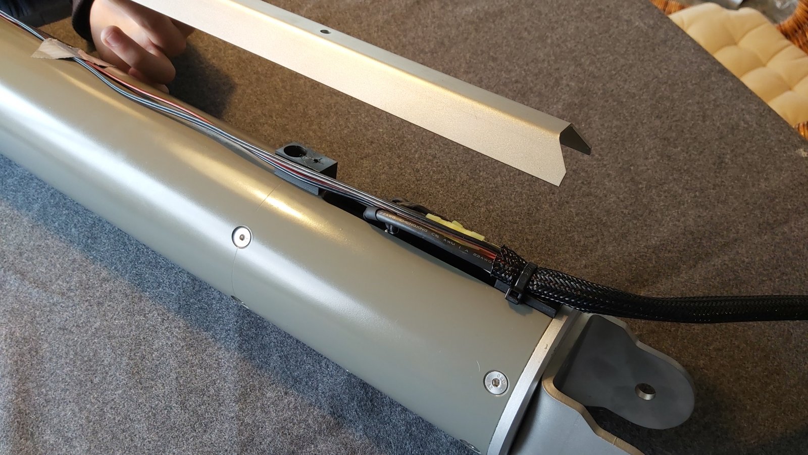

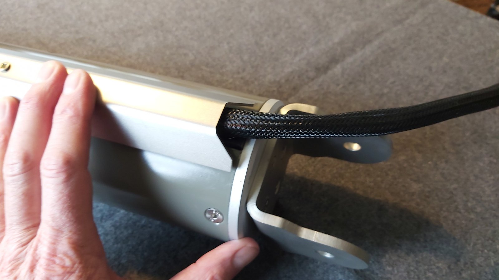

    Hi all,
    some update to my project:
    This week, my son an me started the final assembly of the actuators. And I can tell you its such a good feeling to see the work growing and to see an end of the long tunnel :)
    Today we also built a simple wooden upper frame, just to be able to fix the 6 actuators provisional on the base and see the first time the overall dimensons- I can tell you guys, the simulator is really really huge and looks somehow dominant in my living-room - (luckily I am already divorced - otherwise I would probably still have that in front of me now :grin ).
    Wickie

    PeterW
    liking the rig you have built
    are the top and bottom triangle shapes the same size ?
    what are the lengths of the equilateral triangle ?
    Regards
