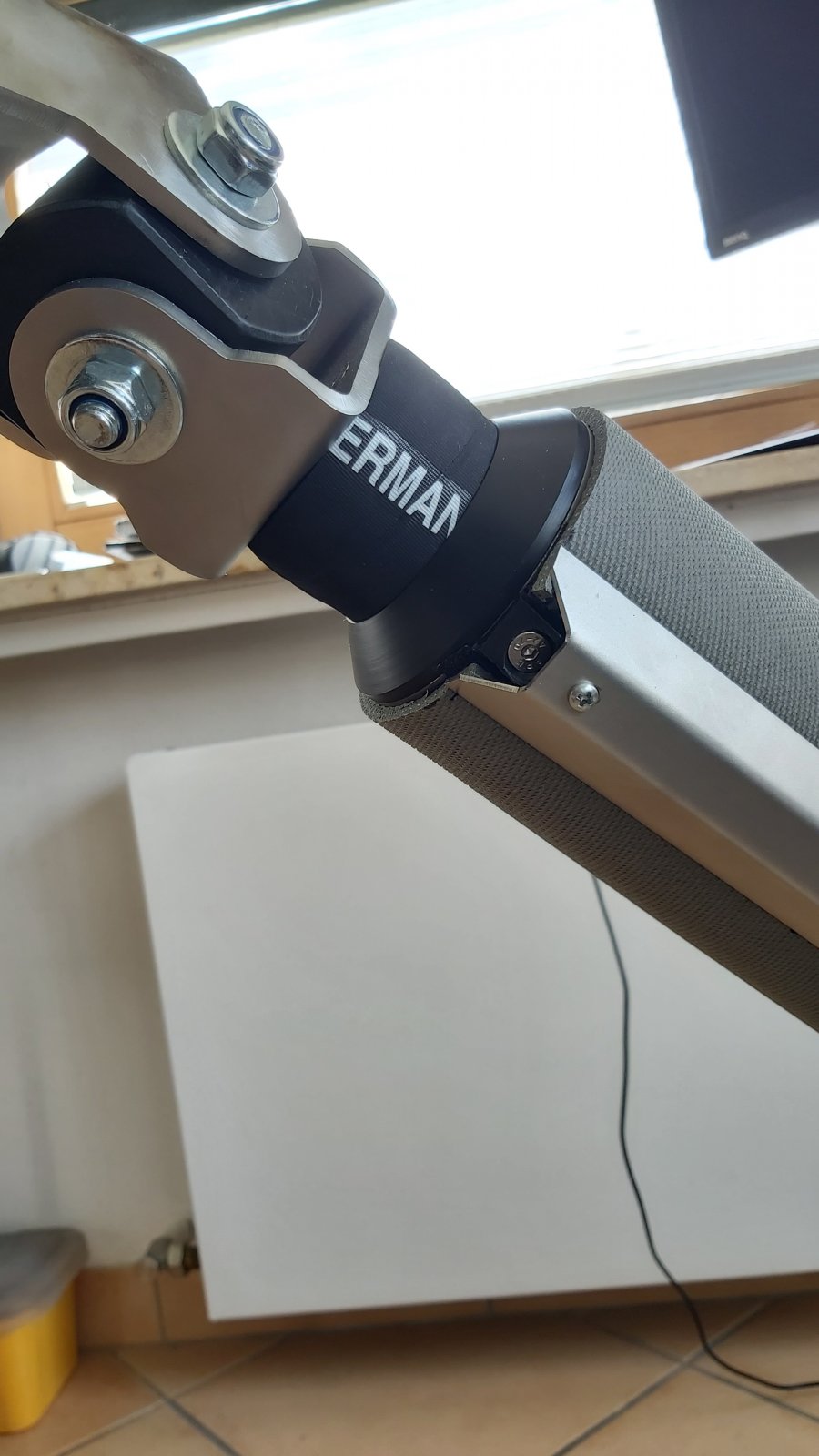

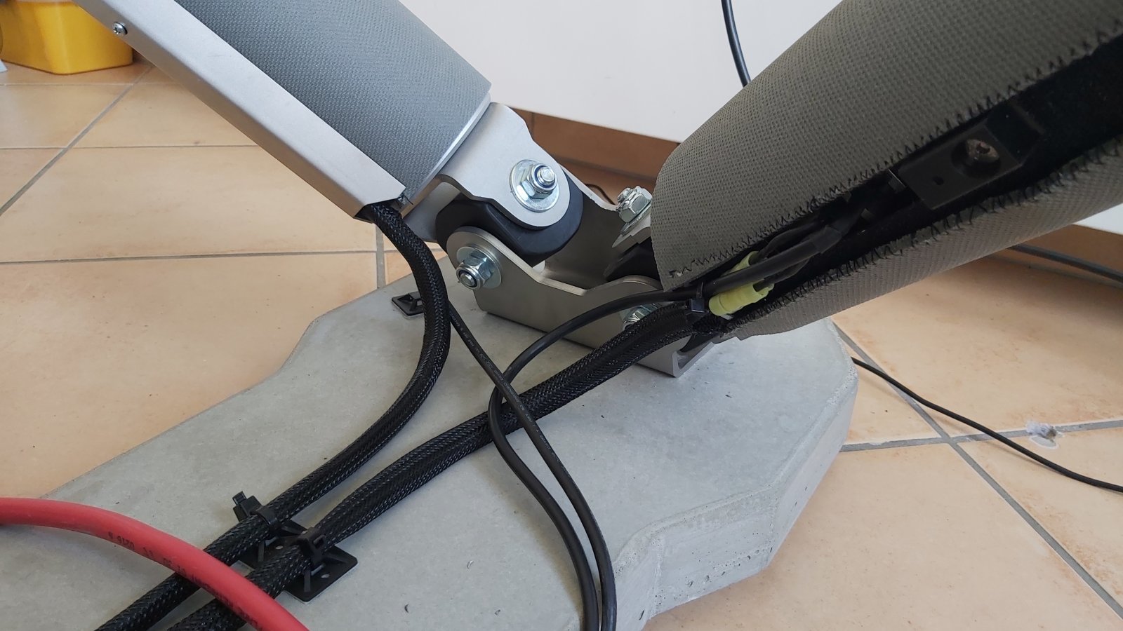

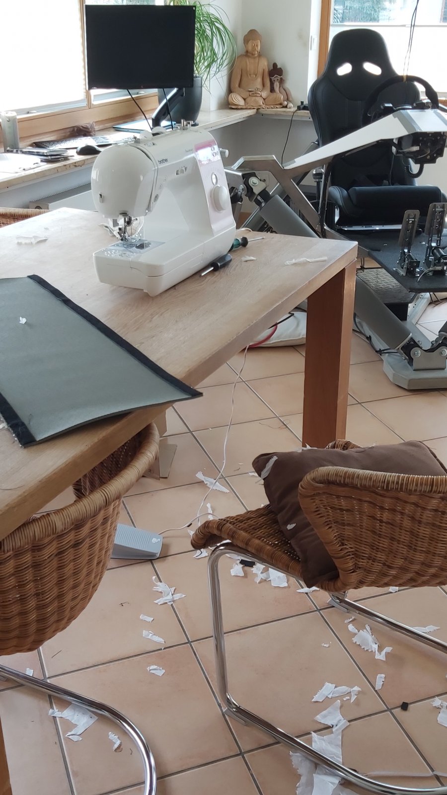

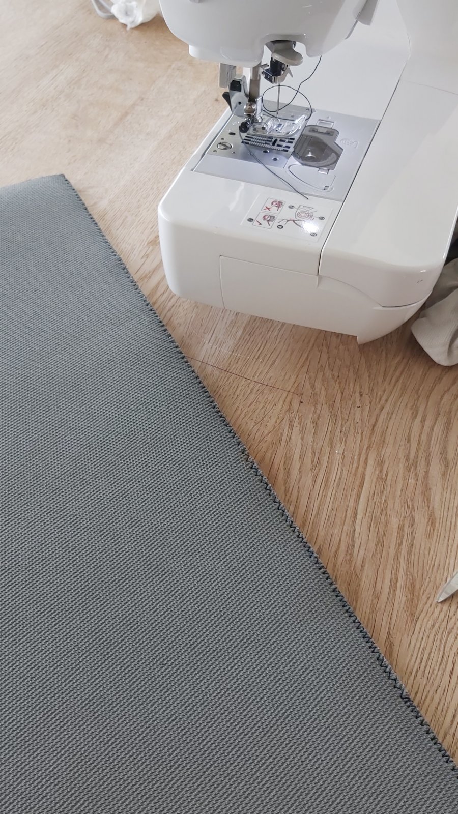

    And also I had time to finish my noise reduction-actuator-covers made from yoga mats.
    And here you can see the fixture on the actuators with a "Klettverschluss" :grin
    The left actuator is ready and the right one is waiting for the cable cover...
    And this is how the top end of the actuators look like. I added also a piece of a rubber hose as a damper..
    Wickie

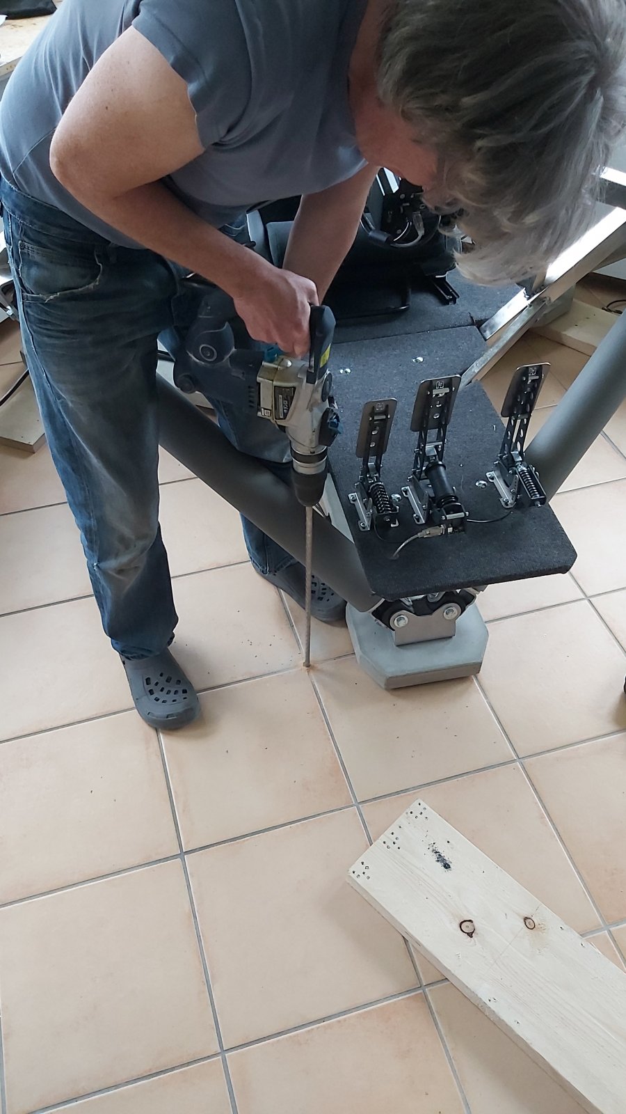

    Ah... I forgot to tell you that I fixed my rig on the floor. This was necessary to avoid lifting off the ground and moving around (aprox. 250 kg !)
    Drilling big holes in my livingroom floor......lol.
    Wickie

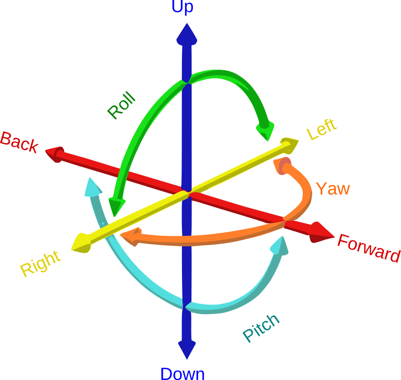

  17. SeatTime
    2,573
    Nice sim :thumbs, just some feedback which you can ignore if you want. IMO the movements did not look right and by looking at your sim/screen/steering movements, some of your forces seem to be backwards (sway) Ie. You turn right and the sim sways to the right - that's not right and others seem to have a mind of their own surge/pitch - were they work well and then sometimes not at all, or even backwards :confused: - maybe too much pitch? Anyway something to look at... have fun.
  18. SeatTime
    2,573
    Likely 200kg + of inertia when in motion and it is siting on tiles.. yep its going to move. My old Stewart Platform use to run into walls until I mounted it to a big heavy rubber mat.
  19. PeterW
    PeterW alias Wickie
    Oct 21, 2018
    228
    Dipl. Ing. Mb (FH)
    1,755Coins
    +426 / 3 / -0
    Hi
    thats an interresting comment and I think you have a ton more experience than me! So this inspires me to make a new thread soon, discussing the correct movements of a motion sim.
    You said: "You turn right and the sim sways to the right - that's not right..."
    Like I told I am not an expert but I can explain my feeling .....
    When I drive a fast right curve:
    In a real car and due to inerta you got pressed to the left side of a seat.
    To simulate this feeling, at the beginning of the curve, the platform has to move fast to the rigt side, so that you can feel the seat on your left. Because the movement is gone after maybe a second (due to the limited travel of the movements) you also have to add something more. In my feeling this is constant roll mixed against clockwise. With help of this both settings, I get the same feeling than in a real car. But thats only my current opinion...we will see
    Regarding the your comment:"..and others seem to have a mind of their own surge/pitch": The tracks that I am driving in the Videos have some hill up and down parts. This is difficult to see on the screen. This Motion may leed to the conclusion that there is some "mind of their own".
    Regarding my huge pitch Settings you are Right !....but it feels so cool when you get pressed into your seat when driving up a hill :)
    So in conclusion I would like to say that I am not interested in justifying and saying what is right and wrong - quite the opposite. I want to find out what is optimal. And for this purpose I will gladly take a closer look at your comments and also test other movement settings - so thanks for your comments!
    Wickie
  20. noorbeast
    21,712
    151,979Coins
    +11,061 / 56 / -2
    This is how SimTools expects a rig to be configured: https://www.xsimulator.net/community/faq/which-way-to-set-simtool-axis-movements.230/
