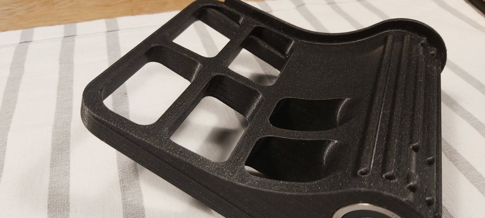

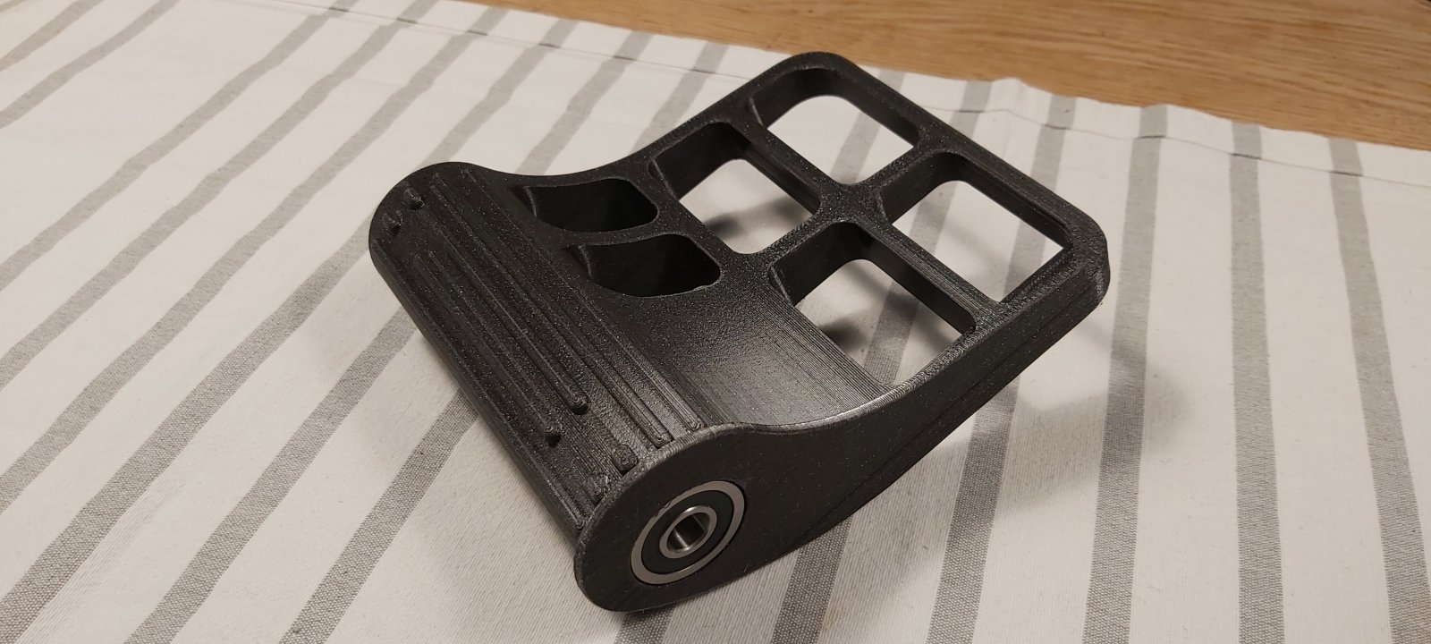

    hi mates
    this is not the larger update I promised, but something I really want to share with you!! This is my new sub-project I started due to the great work of @Historiker with his rudder pedals project. I felt in love with the design of his pedals and decided to print one myself. My Prusa-printer did an extraordinary good job and now I can hold the pedals in my hand - it feels like holding the hand of a girlfriend when I was young.... soooo nice
    Wickie

    Hi Dirty,
    I used the original Prusa-PETG and I think its the same that you used for your universal joints. Yes - I follwed your recommendation .
    Here is the link to the pedal-thread that inspired me for my new sub-project: https://www.xsimulator.net/community/threads/diy-pendular-rudder-pedals.13130/
    But mechanically I will make it little different and with force feedback.
    Wickie

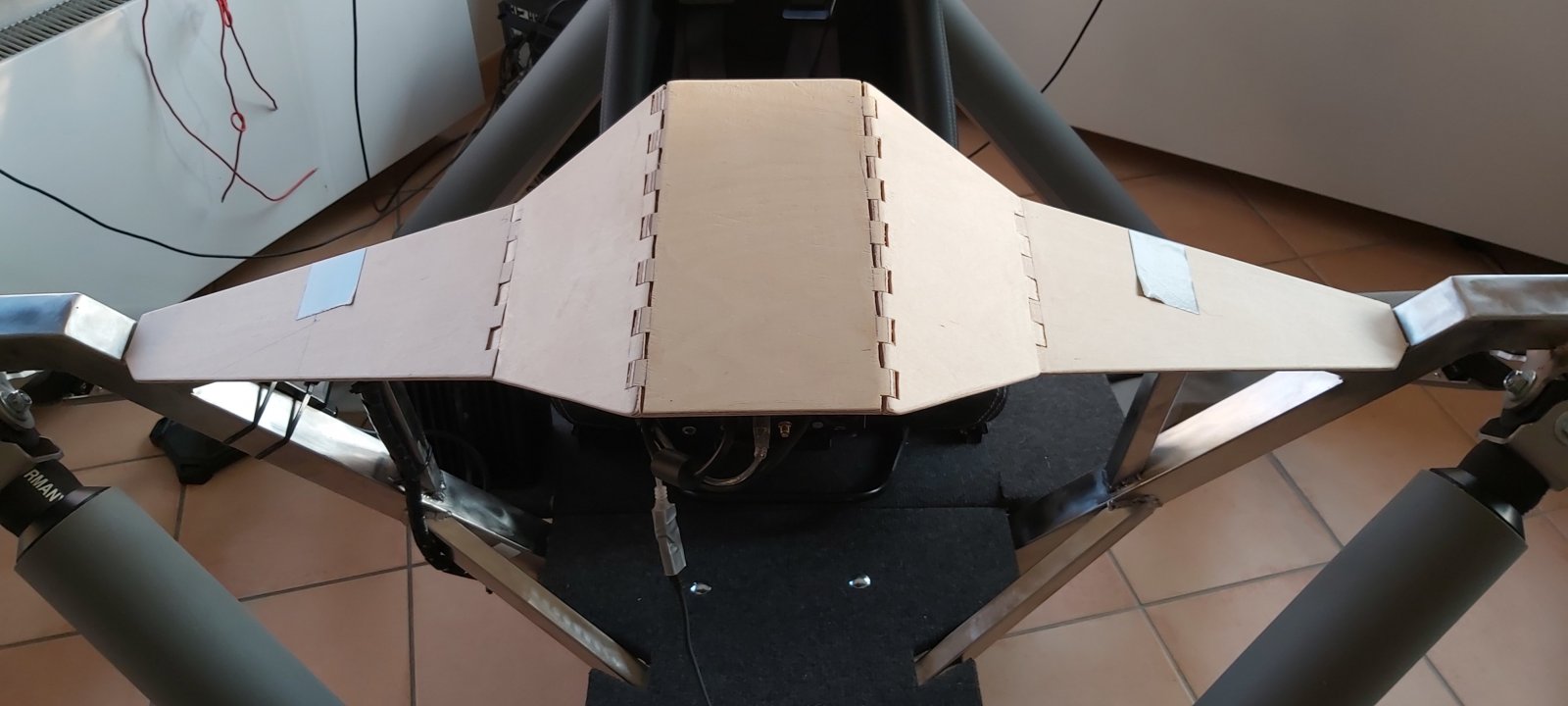

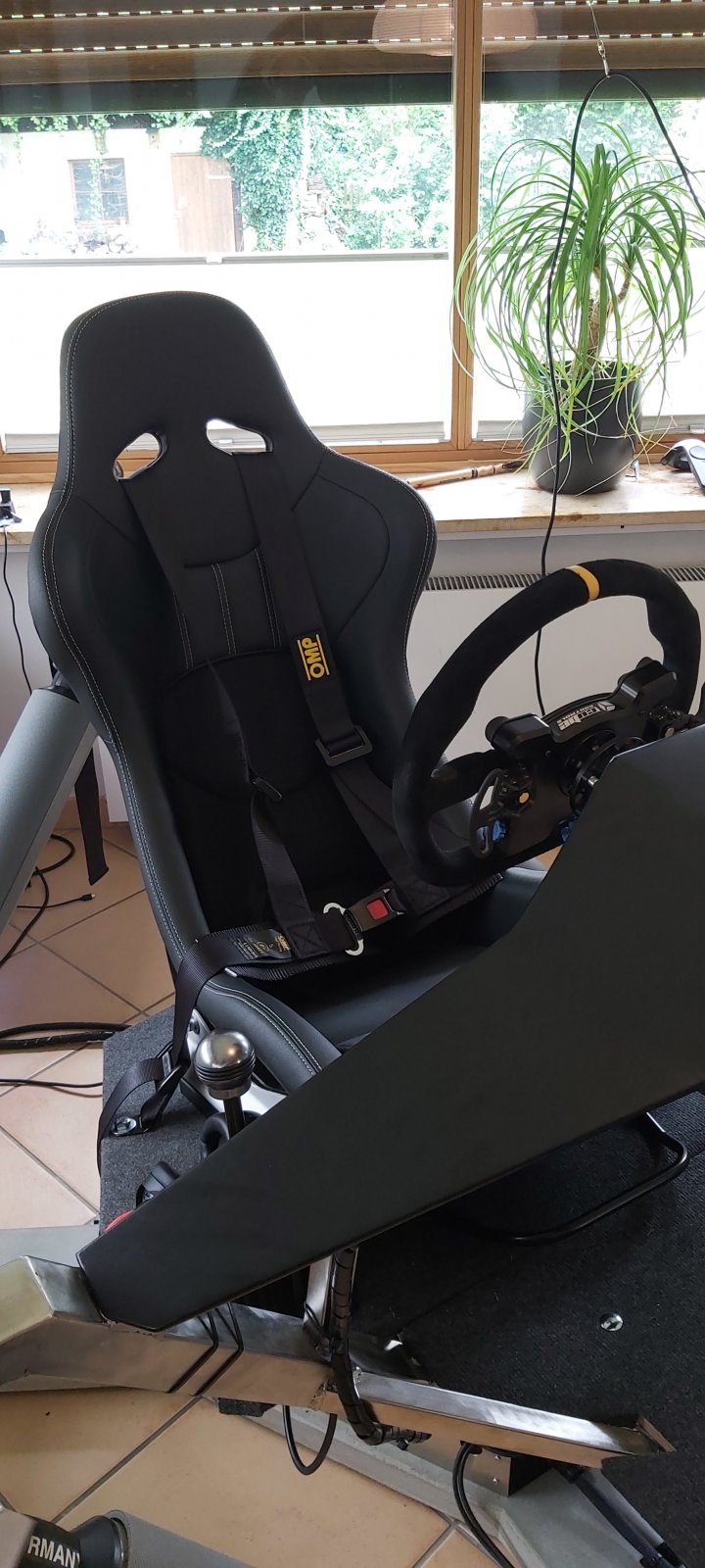

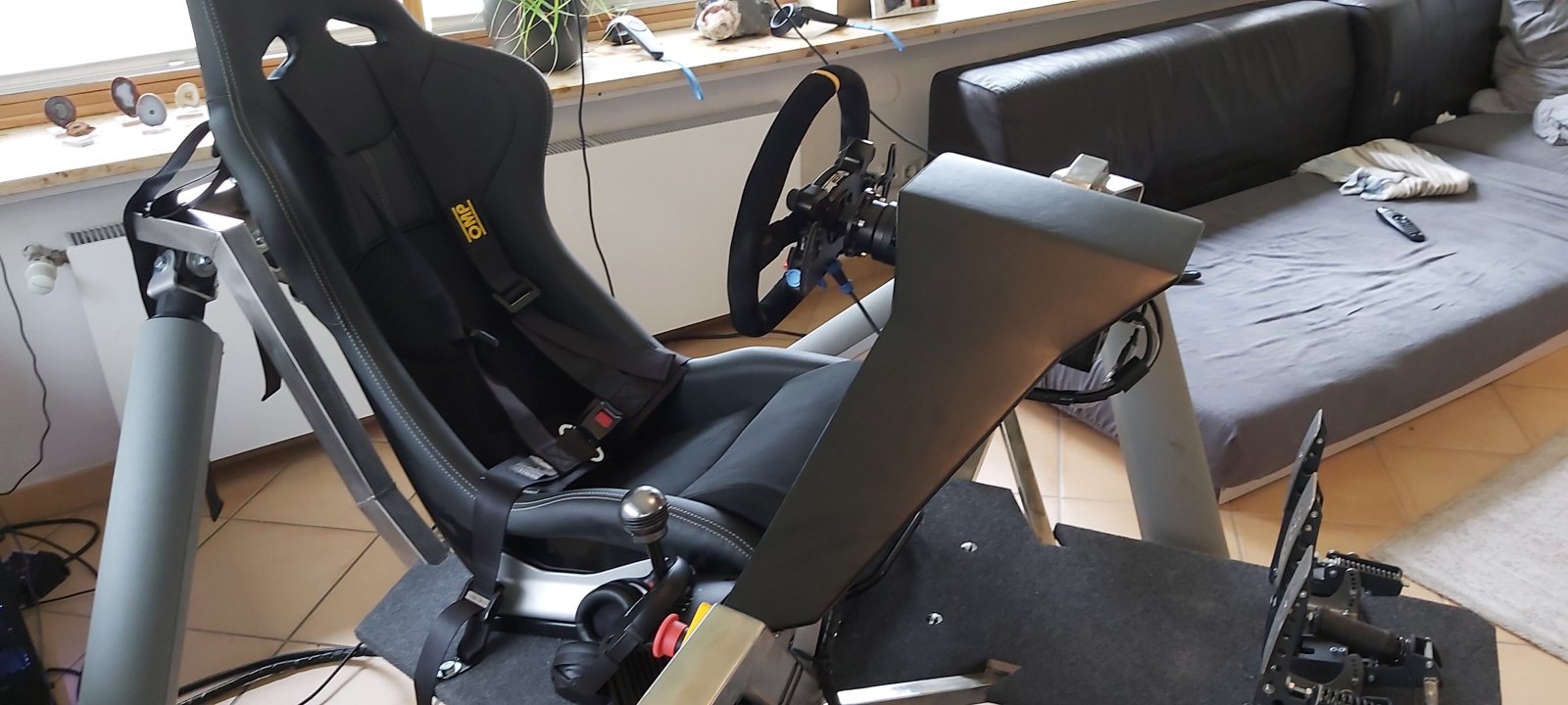

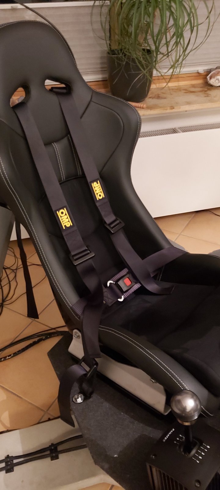

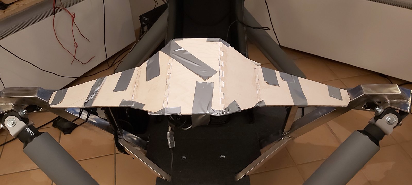

    Hi all!
    Long time passed since the last update....
    I was buisy with renewing my floor and painting my home.....lot, lot of work!
    So time to share some modifications of my sim, I made some months ago.
    This was adding a car dashboard (?) and seat belts.
    The dashboard is made of 6mm plywood.
    The 5 parts are toothed and glued together to improve stability.
    The cover is made of a thin layer fleece (I think it was 5mm) and synthetic lather as top cover. The haptic is like in a luxury- car :).
    The seat belts are from OMP. I love the quality and can highly reccomend them.
    Wickie

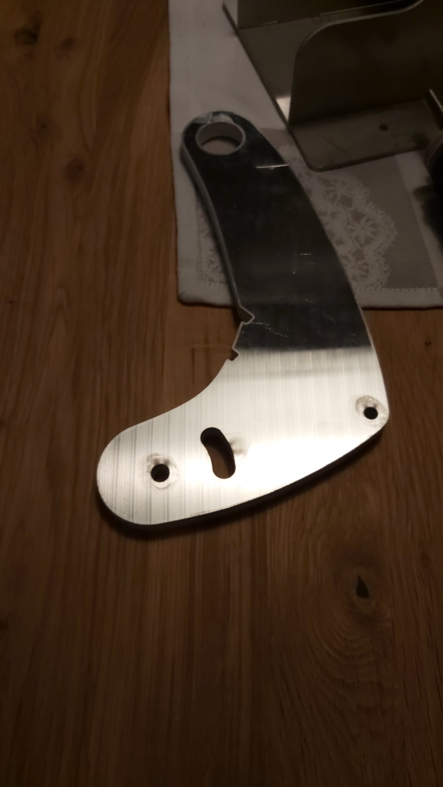

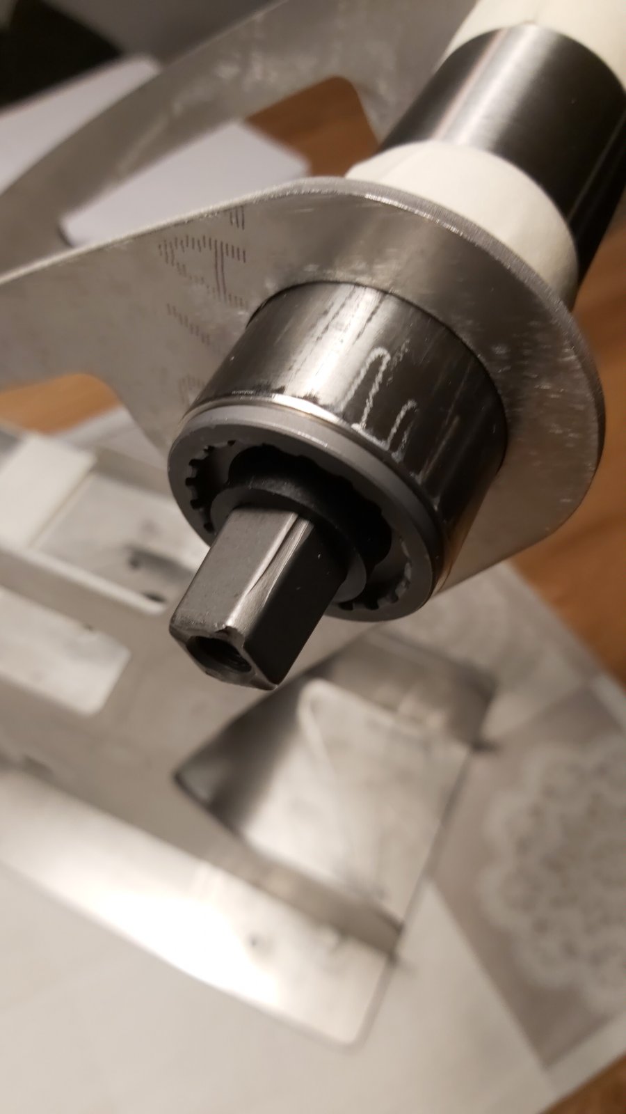

    Hi mates!
    Just a small teaser about my nearly finished rudder pedal and flight equipment project I made the last weeks...... :grin
    I hope I will find some time for a detailed documenation about this in the comming christmas holidays.....
    Wickie

  11. PeterW
    PeterW alias Wickie
    Oct 21, 2018
    229
    Dipl. Ing. Mb (FH)
    1,768Coins
    +427 / 3 / -0
    Hi Dirty,
    yes it is powder coating. Since this summer I have access to a makerspace nearby Munich (www.maker-space.de).
    Yes....makers dreams came true.. :). They have all the machines you would need to build everything. From water-jet-cutting to powder coating, WIG- welding, lathe, CNC-milling, all kind of wood-working, electronic making and measure stuff, sewing, and so on......
    BUT! Its not cheap to make the trainings to get access to the sometimes complex machines. I am in the lucky situation that I need this also for my job and dont have to pay for this.
    Wickie

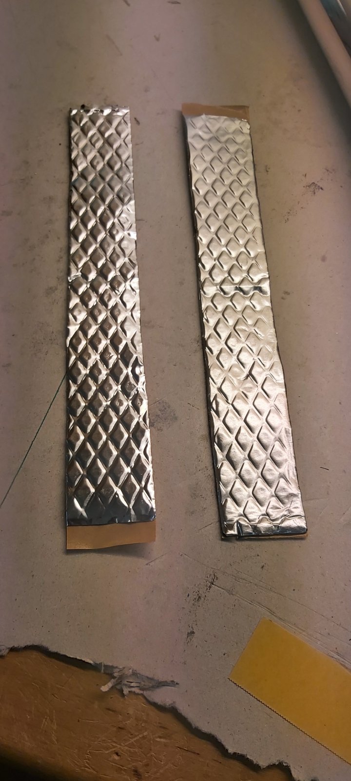

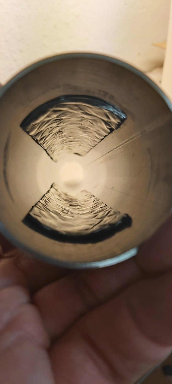

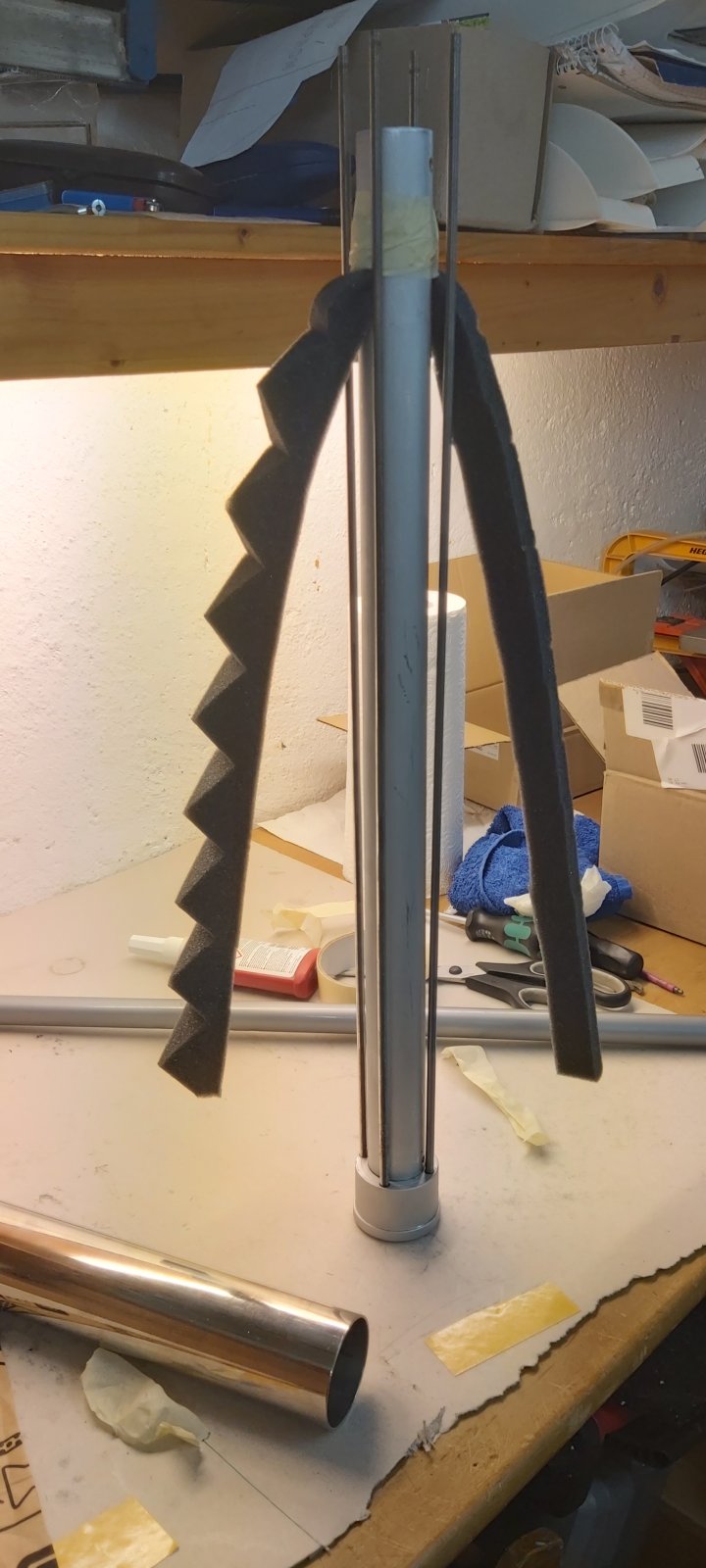

    Hi all!
    Again after long time of silence I want to show you some of my insights regarding noise reduction.
    During my upgrade from 1605 ballscrews to 1610 ballscrews, I tryed and implemented some noise reduction measures at the piston-rod:
    a) I added two stripes of 2mm thin vibration damping mat to the inside of my piston-rod. I found the two stripes are enough and more doesnt perform much better.
    It is important to have a clean surface for good adhesion!
    b) I added two noise foam pieces between my inner and outer piston-rod.
    Assebly is a littl tricky, but worth the work.
    So finally I had the following improvements:
    Left piston-rod => no measures
    Middle piston-rod => measure a)
    Right piston-rod => measure a) and b
    (edit: I dont know why there is a delay between video and sound! - This is the original file from my mobile-phone)
    Wickie
