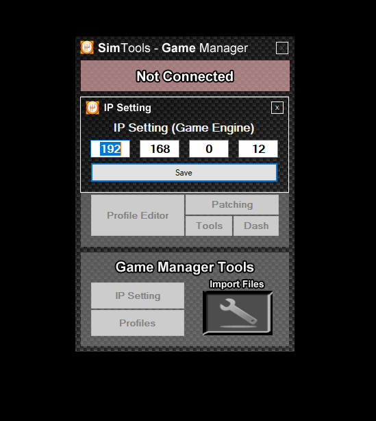

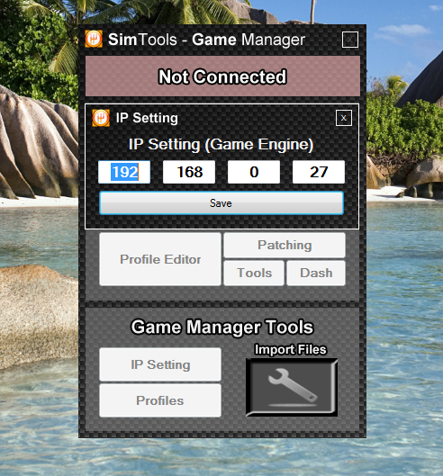

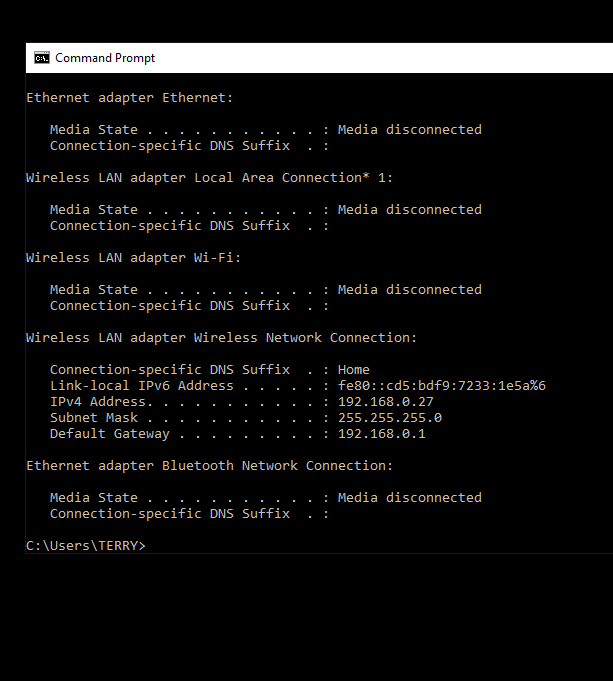

    I recently up graded my simulator game computer from windows 7 to windows 10 and now Iam having problems making the win 7 talk to win 10. I installed sims tools and game patches into win 10 but I think the ip address might be the problem.? The scm3 is working, I have pitch and roll. capture is of the ip address in win 10 as is the capture 1 and capture 2 is from win 7. I am using a cross over cable and this was working when I was running windows 7 on both computers.

    Check if the firewall is interfering by temporarily disabling it, @yobuddy may be able to advise further.
    But that aside dual PC installs are now considered redundant and SimTools v3 does not support it, so in terms of long term compatibility it may be a god time to consider direct install and configuration on the game PC.

    If your doing to 2 pc setup, then you need to set the IP address in both game manager, and game engine.
    (I only see you setting the ip in game manager is all.)
