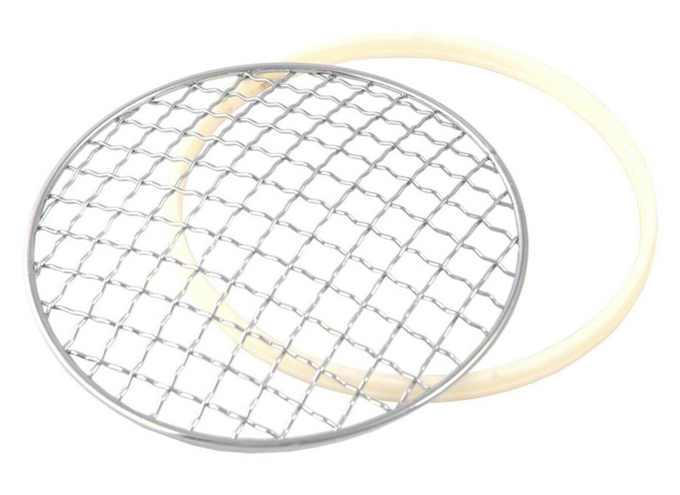

    @lbwski - Nice install! Only thing I would suggest is a finger guard over that fan air inlet especially if there could be children around. The TerraBlooms have sharp blade edges and could possibly even remove a finger or skin/meat. Rally cars use wire screens over headlights to prevent rock damage and those are probably available in a perfect size for that inlet.
    Edit - if you are interested, just search for “headlight stone guard”. There are lots of sizes, styles, mounting lugs, and finishes. Some very cool stuff and probably a good idea for anyone running wind fans if others could get a body part into air inlets. Mine face the floor so less likely to get a hand up in the inlet but not impossible. I’m going to add them to my rig as well.

    Good tip! Was planning on adding some kind of guard but those headlight guards look like they’d make for a really clean fit!

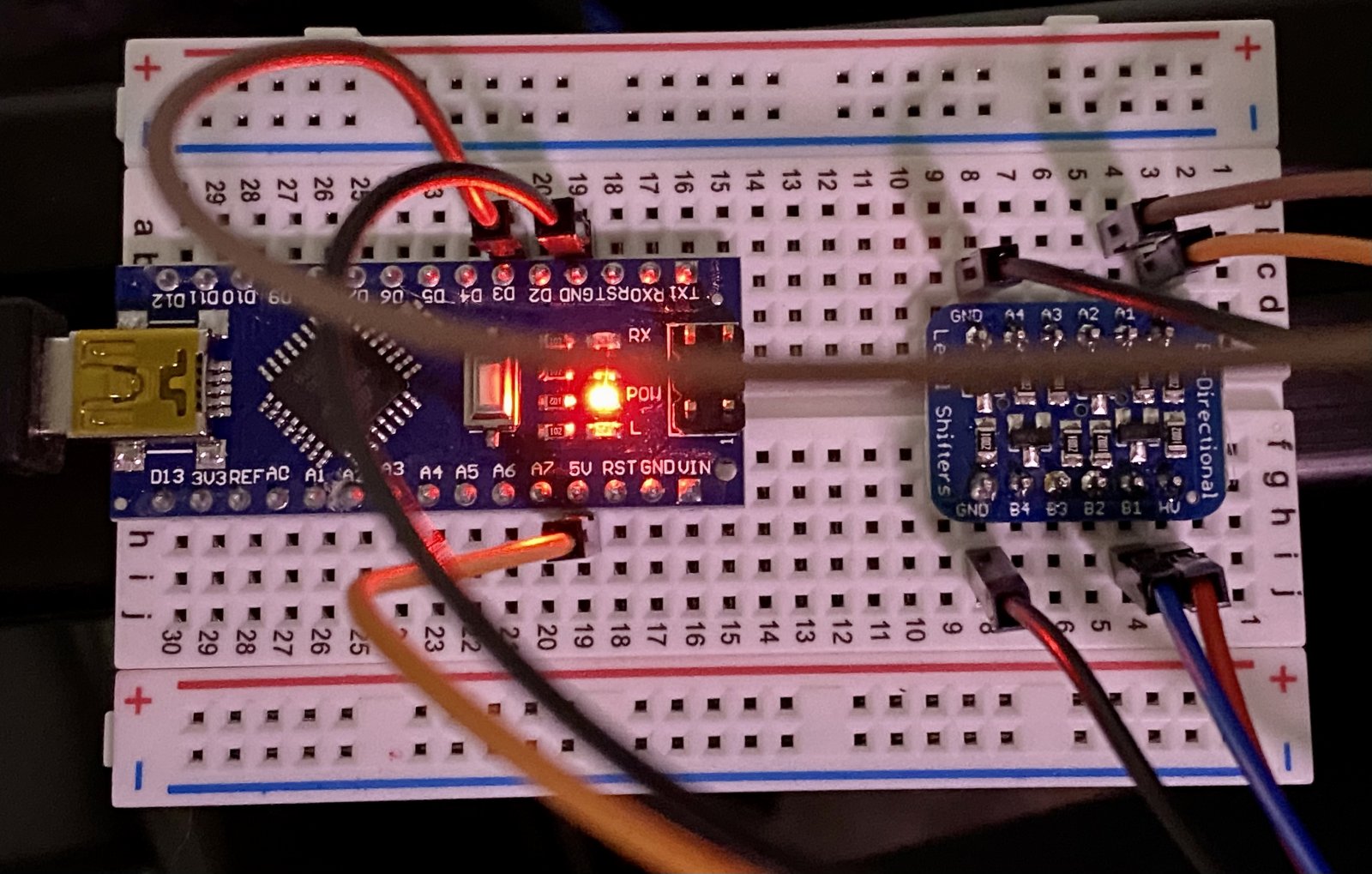

    In case it’s helpful for someone doing a similar project, here’s a closeup of the board I’m using so that you can see the wiring

    And just one level shifter gate needed! I found these since my fans are 150mm OD at the inlet. They are listed as 160mm and others are measuring at the ID of the ring so hopefully a clean fit.
    I was looking at velocity stack screens but photos of these for motorcycles and cars came up. People use them as dress pieces so a number of sizes and styles available. Was thinking about versions with mounting ears but may go for just the circle and mesh (like the earlier post photo) and print my own mounting pieces.
