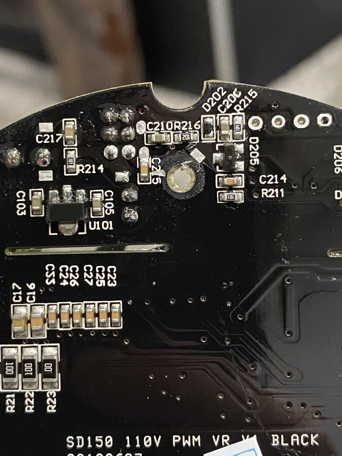

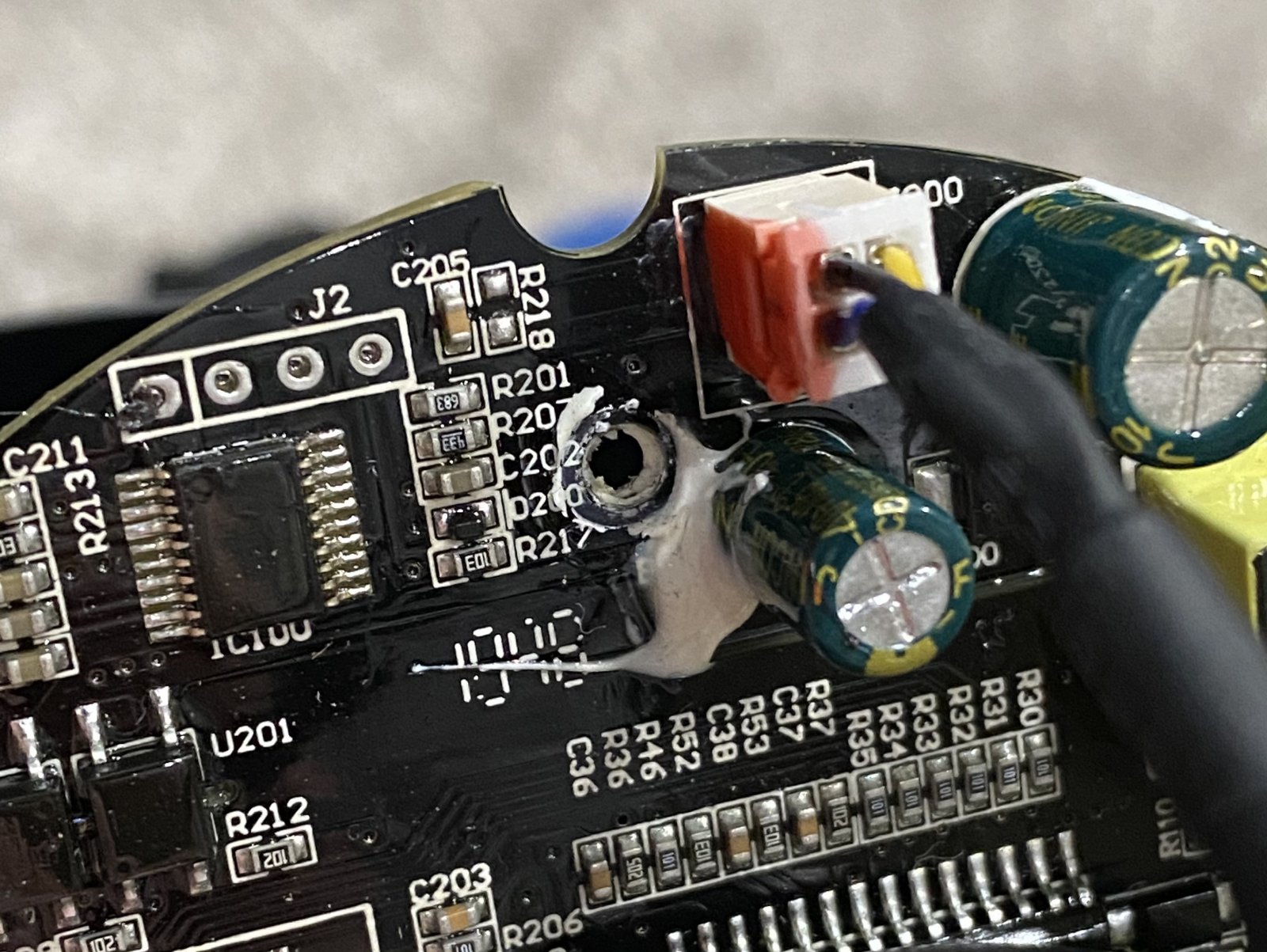

    I opened mine up today while I had some other stuff off the rig. I think I’m in the right area but wasn’t able to figure out exactly which of the extremely tiny surface mount resistors is the one we want.
    I think part of the problem is the probes on my multimeter are kind of big for this application & it’s hard to get any readings - even directly across one resistor... is there some kind of coating on there?
    anyway, if you open yours up and figure it out let me know. Attaching some close up pics of the area in question... I think it might be C210 & R216. 9C75BC31-422B-4749-83E3-ED5E484D3B3C.jpeg E4617F7D-52BC-48F8-8D2E-49FEAED43656.jpeg

    @lbwski - I haven’t had a chance to open mine up but I was thinking the R/C parts were on the top side of the board. Could easily be wrong, though. And there probably is a coating. Since those fans are in the air flow, it wouldn’t surprise me at all if they add a conformal coating. There’s definitely a solder mask but in those shots it looks like there could be a clear conformal coat. Sharp probe tips should pierce it no problem, though.

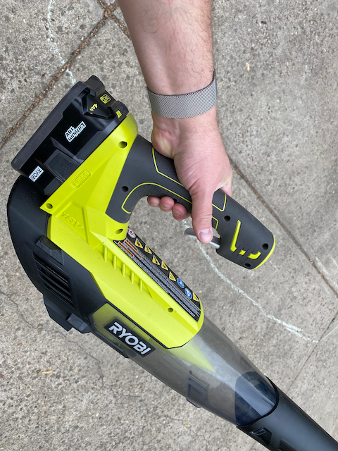

    Was cleaning up the driveway the other day and realized this Ryobi 18v blower would probably make for a great wind sim. Moves a lot of air & you can vary the output anywhere from 0-100% very smoothly. Plus, it can go from nothing to maximum and back in a second or two. A bit of PWM noise at lower speeds, but otherwise checks all the boxes.
    Now... I don't think I'm going to sacrifice my blower any time soon (these things are great for cleaning up the garage, etc!) but thought I'd mention it here in case it gets someone thinking.
