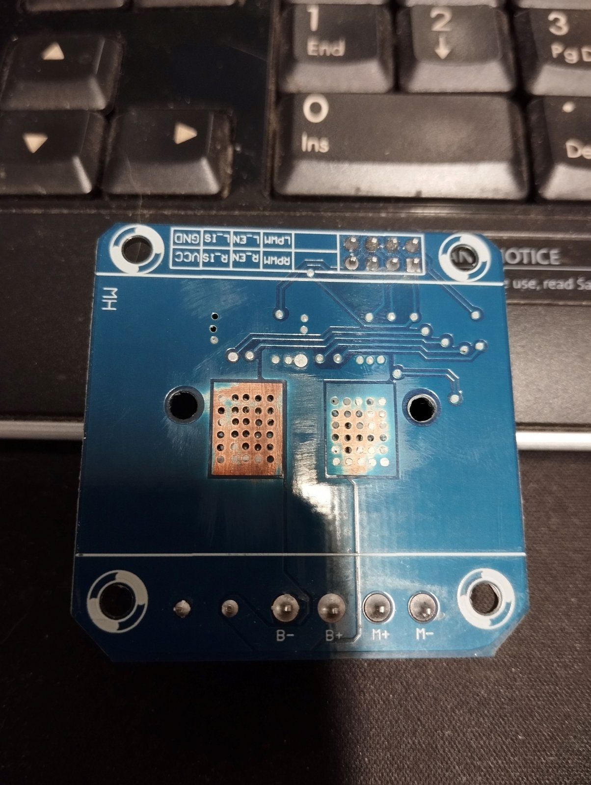

    From my experience with ibt2 can give you a hint:
    1. try to spin the motor arm as little as possible when it is not powered, when the arm is rotated the motors generate reverse current which can damage the IBT2 or the power supply.
    2. unscrew the heatsink from IBT2 and gently sand off the varnish from those two fields I showed in the photo ( 300-400 sandpaper), apply thermal conductive paste on the sanded fields, heat dissipation will be much better.

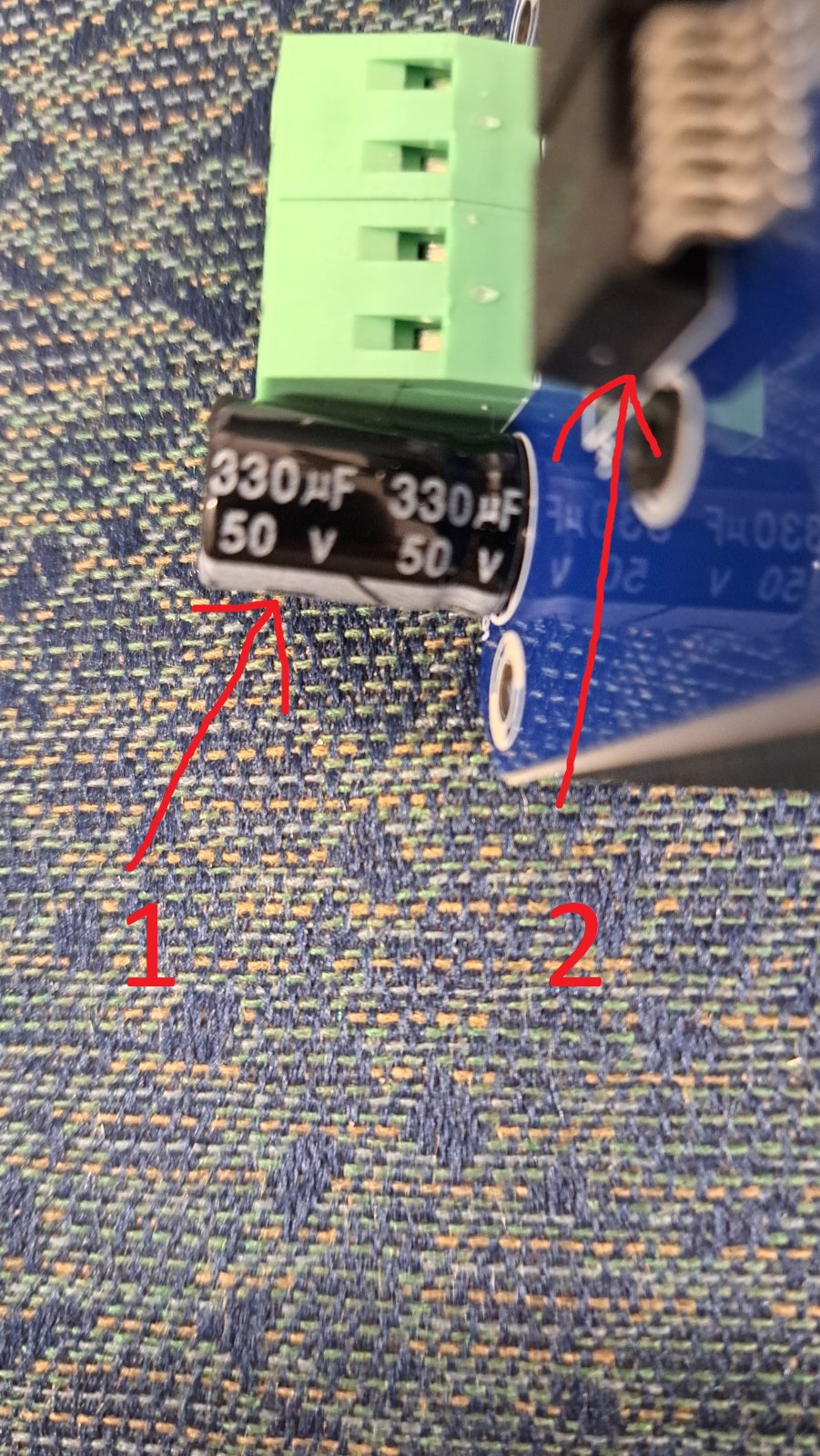

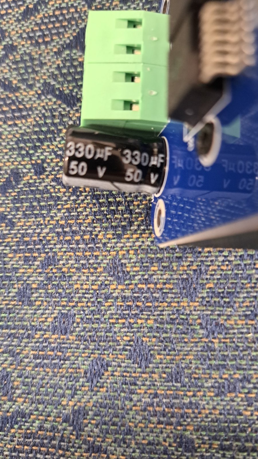

    Thank you. I will remove that coating and paste the sinks. I've probed around the blown units, and I think this is the component that keeps getting fried. Can these be replaced?

    Not quite sure which item you're asking about, I've attached it
    photo :
    1. the capacitor can be replaced if it is damaged.
    2. transistor is rather not so much it requires specialized equipment.
    Don't worry about the IBT-2, I broke 4 pieces before I learned how to handle them, follow the advice from the previous post and give additionally a fan to blow on the IBT-2 bridges.
    It will be OK :)

    The capacitor keeps shorting out. I'll remove it and see if I can replicate the short just to pinpoint the problem. Also, I do have a big fan installed on the box lid. The air coming from the vents is ice cold.

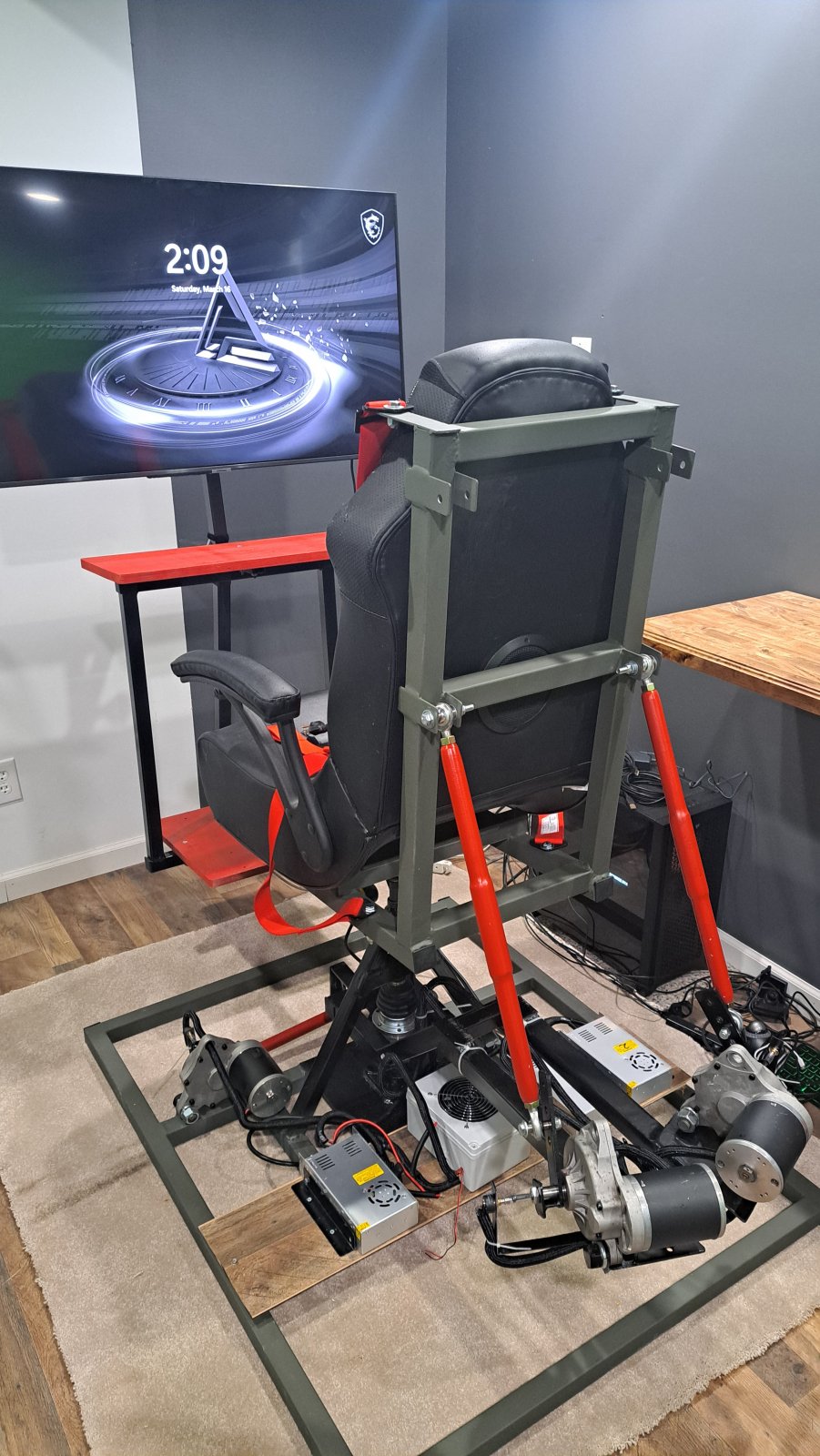

    Show some photo of your motion sim :)

    It's not in the best state for pictures right now. Was working on looming the wiring tonight. Still waiting on IBT2 for motor 3 to come in. Doesn't help we lost power for 2 hours either! Looking to getting the psu's and elec box hard mounted today. Gonna make the brackets for all that at work. Once all that is cleaned up I'll post up another batch of pics.
