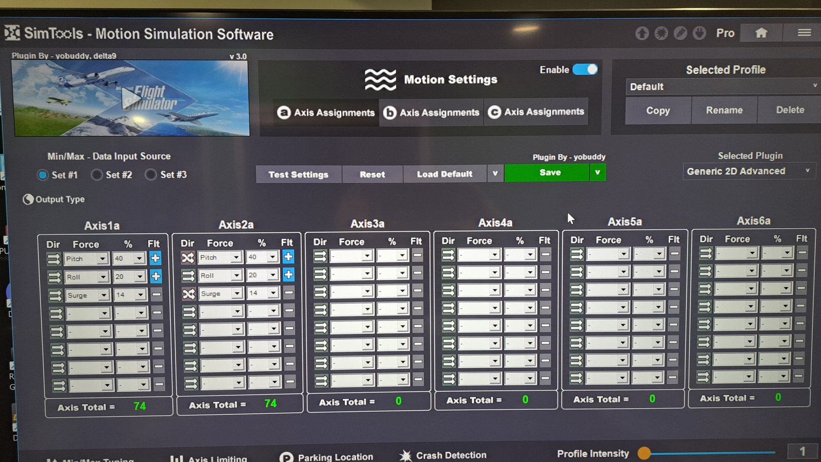

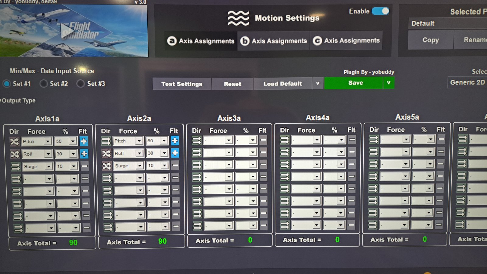

    20240317_201253.jpg 20240317_181210.jpg Got my axis assignments setup and working great in simtools 3 now, however, when trying to fly in msfs2020, the rig is responding in opposite commands. Pitch back, rig goes forward, roll left, the rig rolls right. Its gotta be something so obvious that I'm easily overlooking it. Here's my settings.. anti rollover are checked on in the Flt fields of all pitch and roll assignments. EDIT: Sorted it out. Random direction boxes needed checked for it to work with game. Simtools test settings is now all jacked up, but MSFS2020 works and responds great. The top pic is a working simtools test, but non working msfs2020, the 2nd pic is a nonworking simtools test, but a fully functional msfs2020. Possible plugin issue?

    Is it because you have the Profile Intensity set to 1 in the second Picture!!!
