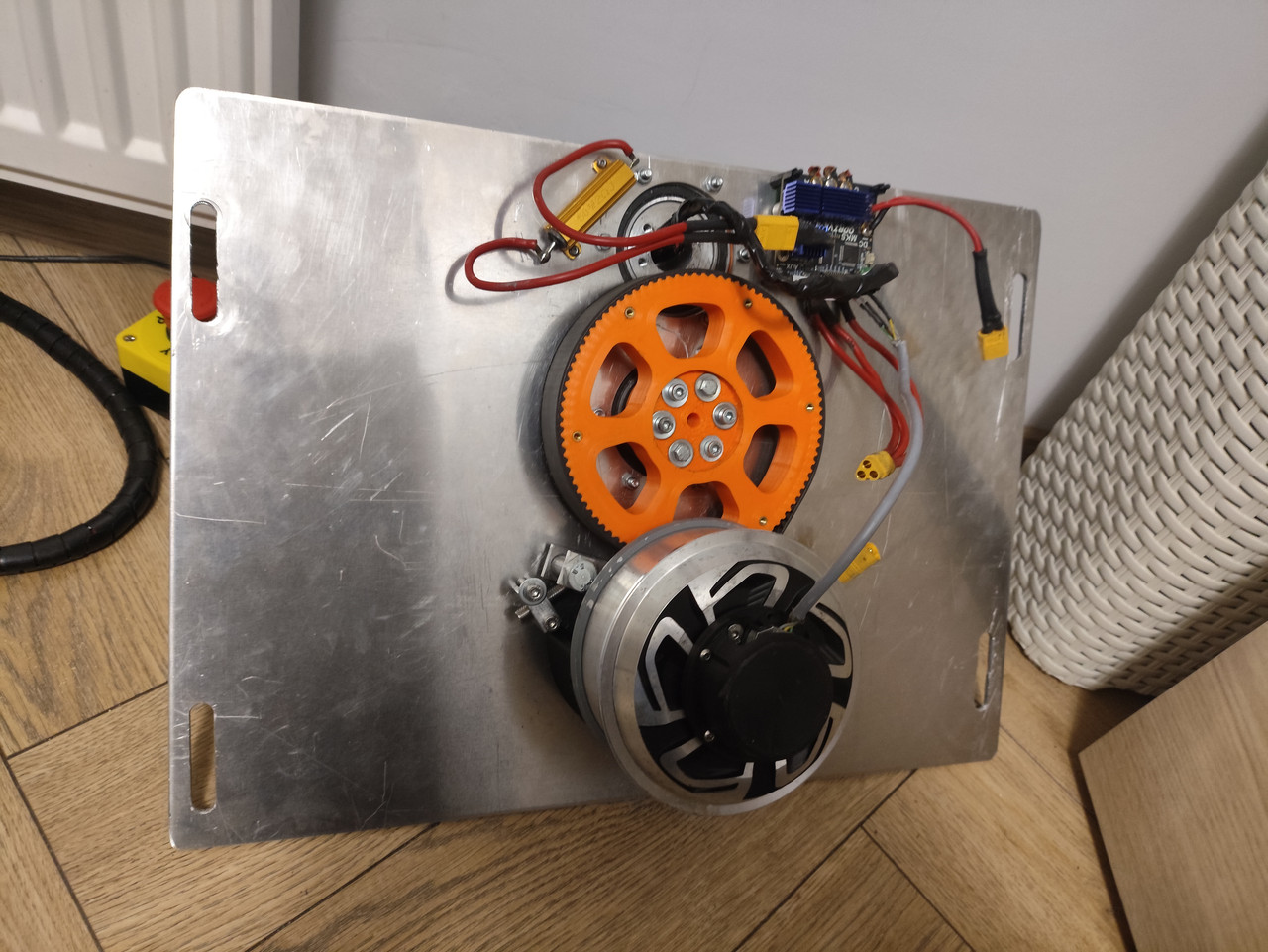

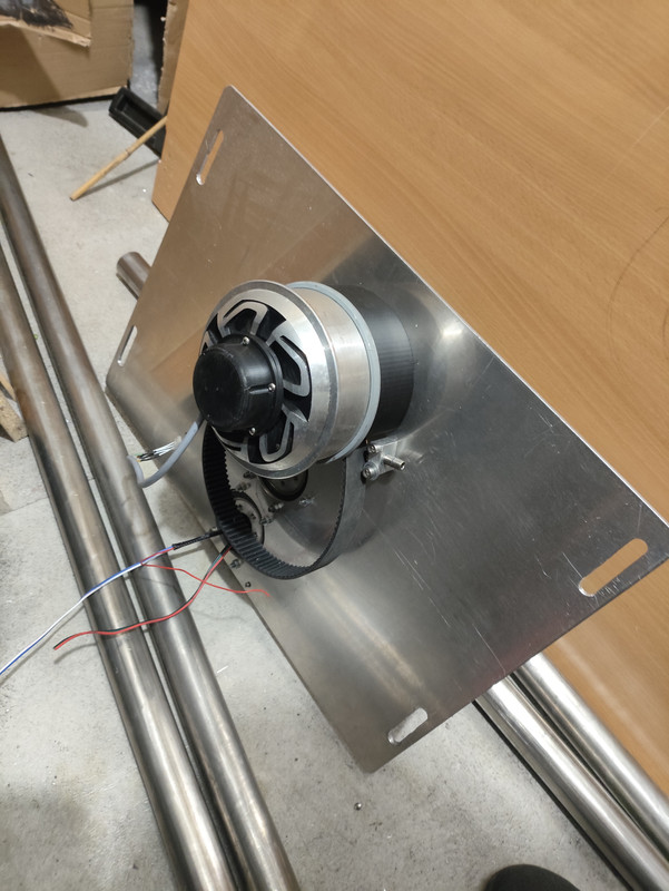

    Feel free to ask anything. ODrives are quite simple to connect, each board has 2 motor outputs and 2 encoder outputs. The only complicated thing is the software setup in console/odrivetool, but there's plenty of information on ODrive wiki.
    https://docs.odriverobotics.com/v/0.5.6/getting-started.html

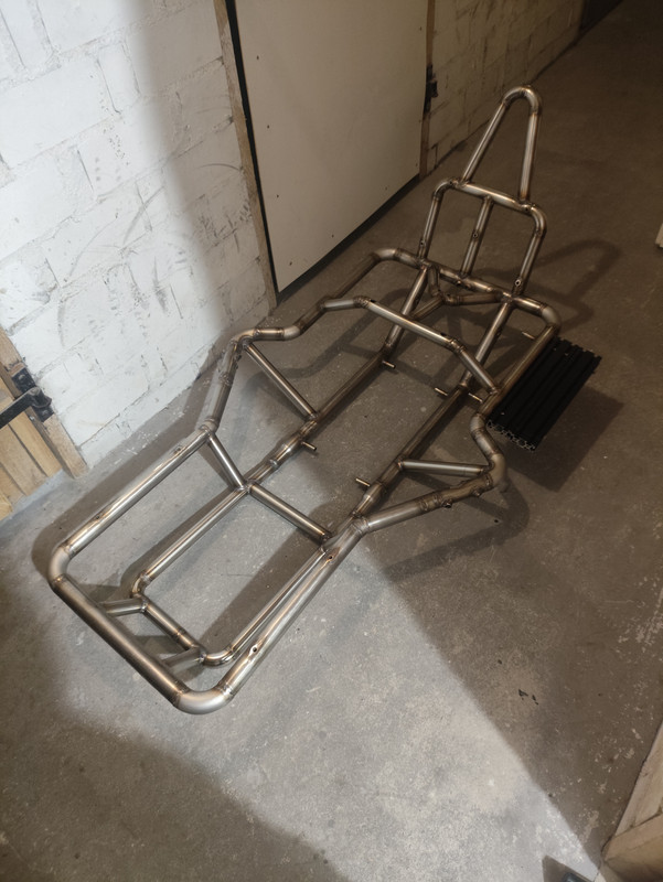

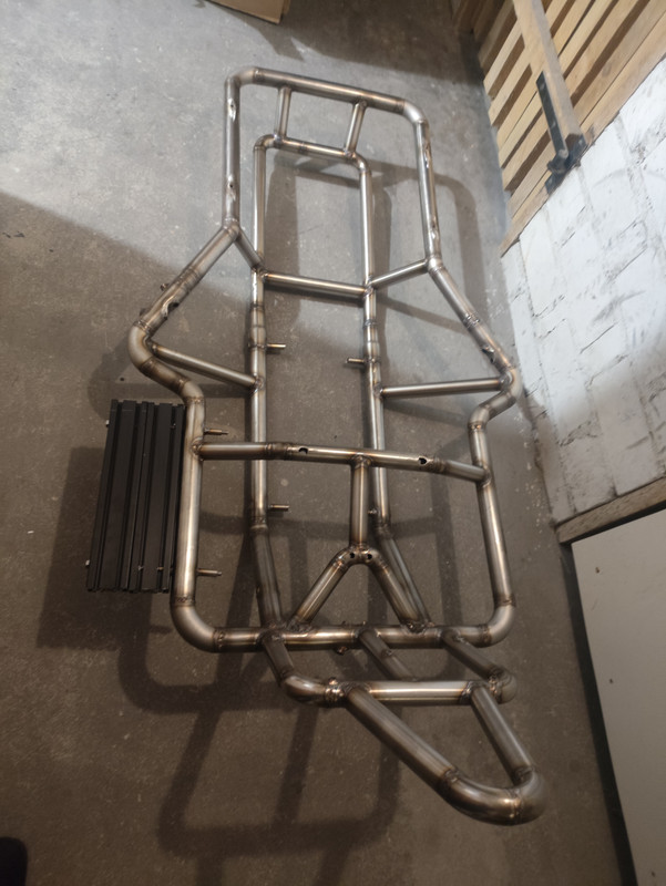

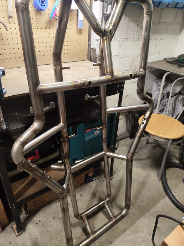

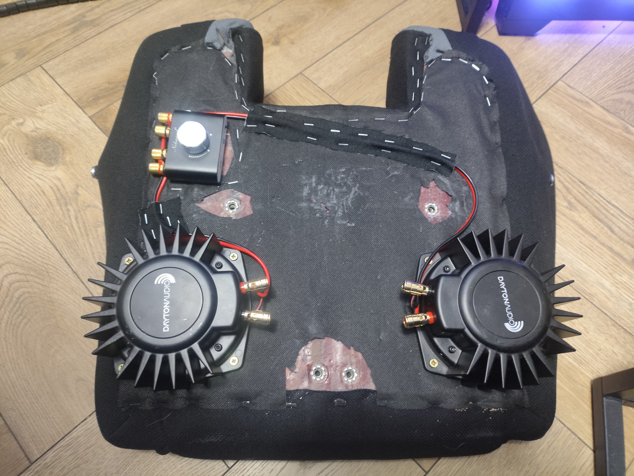

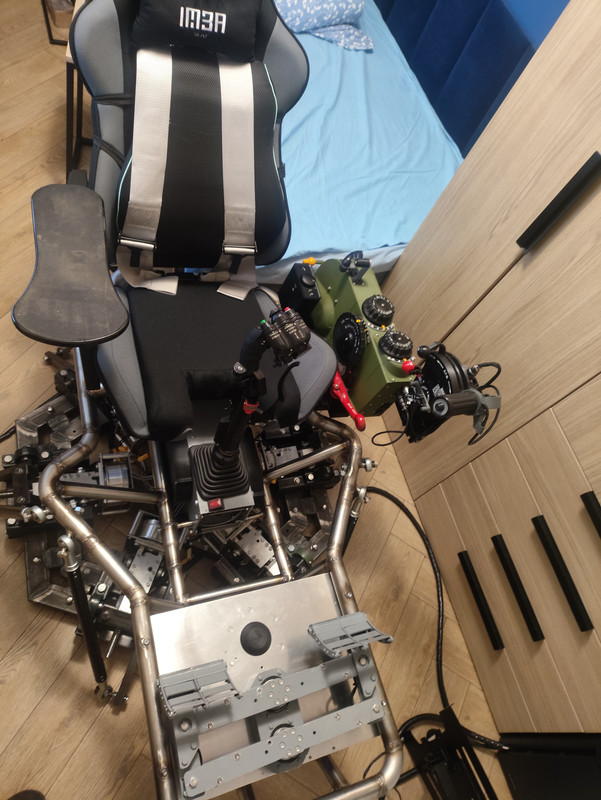

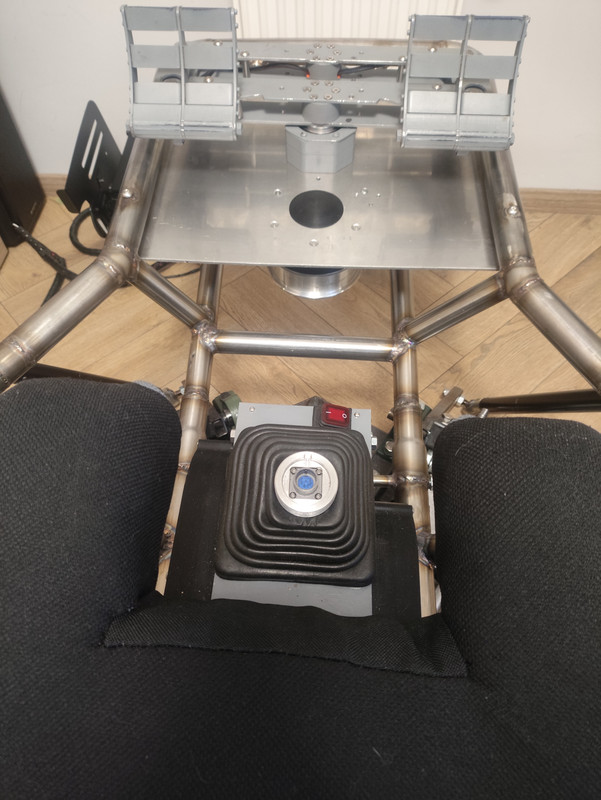

    Now time for update:
    Motion frame is ready. This is the first time I welded something like this complex 3D shape, with stainless steel tubes.
    Some welds looks pretty, some ugly, but I don't care. They hold well. It was hard, but not that hard.
    Whole steel frame weighs only 11,3kg, which is even lighter than my FFBeast joystick base (12,2kg)
    FFB rudder pedals needed some modifications to fit in the frame. Wider base plate, and motor moved to the front and below the floor.
    Lower seat part cut and 50W bass shakers installed.
    To do:
    -Wiring for stick,rudder, throttle, shakers, etc.
    -movement calibration in Mover.
    In the worst case when all of this will not work I have a nice tube frame for a gokart or something :D

    Thats looking pretty cool, great effort on the frame.
    You've already had the base working, so the rest should be plain sailing. :grin
    Look forward to future progress.

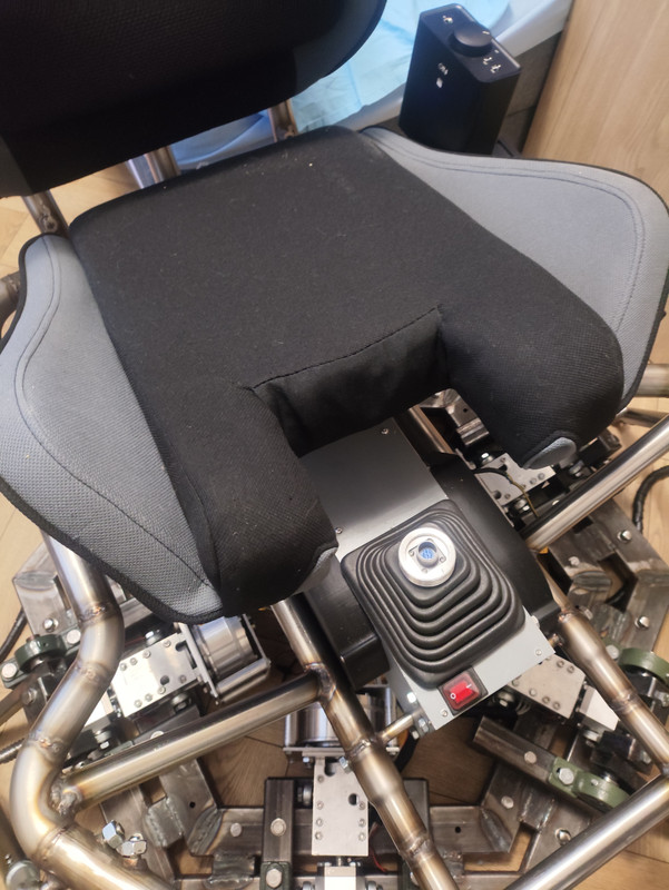

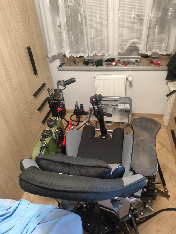

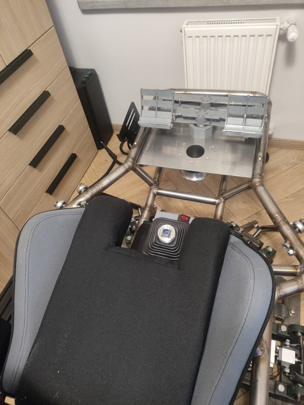

    Really good outcome. I like the mechanical design, looks really well thought out.

    really impressive rig , motion seems good too, what is the tilt noise wecan hear some times?

    Barely noticable, only at full speed full range. Completely silent during play.

    When mine made that noise, I traced it to a loose bolt on the moving platform. I was only testing at the time, so will pay more attention when time for the final assembly arrives.
