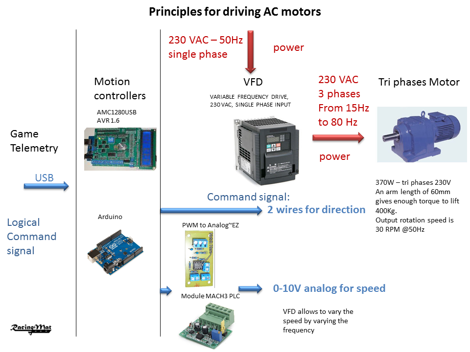

Tutorial WIP How to drive AC motor: principles

    Normal Induction motors are Good choice with simulators and you can use additional fans in the motor back end to handle the heat in low speed/reversing conditions ... a good choice for sure :thumbs .
    But the inverter-duty motors still are the Optimum choice if found in a good price ;)
    A quick comparison between the inverter-duty and normal induction motors .
    http://motors.automationdirect.com/Information/compare.html
    In summary, general purpose motors can be run with drives in many applications; however inverter-duty motors are designed to handle much lower speeds without overheating and they are capable of withstanding higher voltage spikes without their insulation failing. With the increased performance comes an increase in cost. This additional cost can be worth it if you need greater performance.

    2DOF, AC motor, Arduino
    Have you a feedback on the use of Mach3 module?
    • PWM digital signals into analog signals from 0 to 10V.
    • Convert PWM digital signal into 0 to 10 v analog signals.
    • Power Input Range: 12V-30V (Power requirements: more than 100MA)
    • Signal interface switch can be used for PLC or other industrial control board.
    • PWM Reception frequency range: 1 KHZ - 3 KHZ.
    • Current output capacity: 10MA.
    • Resolution: 0.1V.
    • Usage: by adjusting the potentiometer board, can match the calibration of PWM signals of different frequency pulse
      My questions about this adaptation circuit
      Do you have this deck wiring diagram?
      1) PWM frequency range 1 kHz - 3 kHz it is not disturbing because in the audible frequency range?
      2) Resolution 0.1V = 100 not only changes?
      3) What is the component that limits this de0.1v and precision?
      4) This Mach3 plate allows it to have the output 0to 10v if the PWM input only varies from 0V to 3.3V?
      Originally, I wish to find a matching circuit:
      Input 12bits of 0V to 3.3V PWM 20kHz to 40kHz
      OutPut 12bit DAC with 0V to 10V 20kHz to 40kHz

  6. TFOU57
    TFOU57 Member
    Mar 30, 2009
    164
    Thionville - France
    5,723Coins
    +16 / 1 / -0
    @RacingMat
    Thanks for your reply, perhaps others uses this module Mach3 that intrigues me because I'm not sure get the 10V if I have an INPUT in 3.3V maximum PWM ?
    ... and this low low frequency range. … ? Audible frequencies during the piloting of the frequency inverters ?
