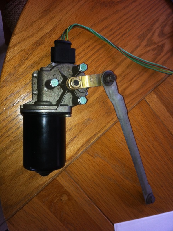

    I thought I might as well post this up to get a few ideas as it's relevant to the title. I went out to the garage this morning and dug out an old wiper mechanism and motor. The idea was to have a basic motor to play with just for testing. Here's the motor below. It's from a VW golf. I'm guessing that this won't be any good as the electrical plug and plastic covers the back of the gearbox where the pot would be attached. Is it possible that there may be some form of pot buried in there already?
  12. bsft
    no, motors dont have a feedback system on them at all. And make sure you earth isolate the motor casing.

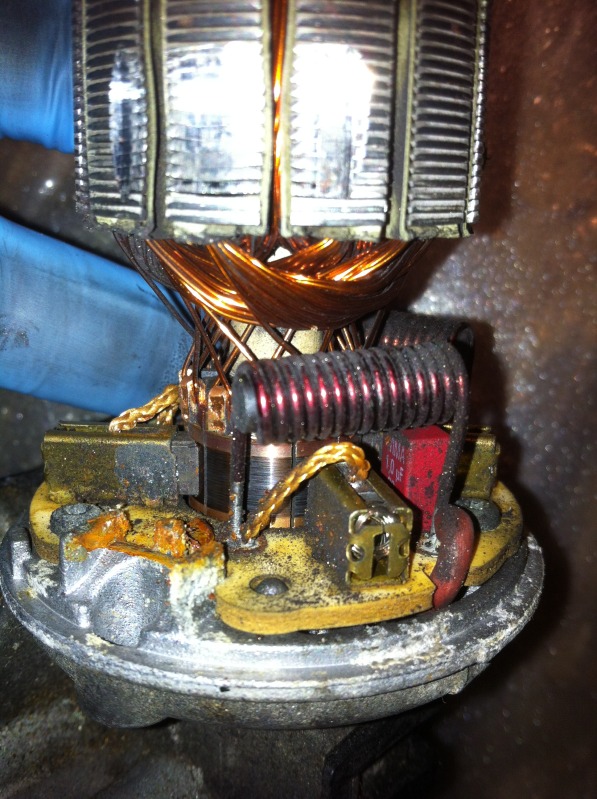

  16. Barry
    Barry Active Member
    Mar 20, 2014
    398
    Web Developer
    Northern Ireland
    3,877Coins
    +251 / 2 / -0

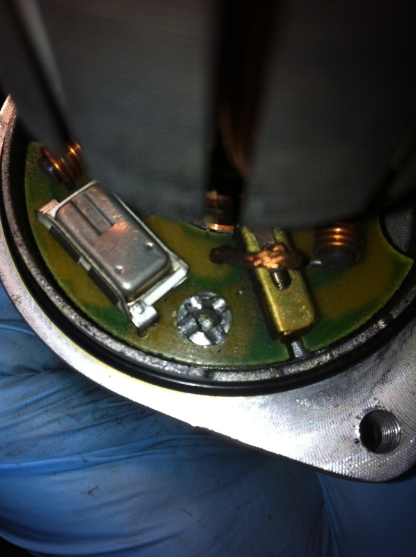

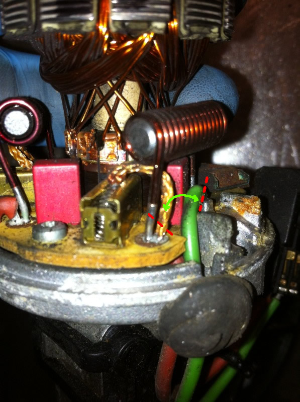

    I opened 2 VW wiper motors last night and I have a few questions about earth isolating them.
    This first one. Are these starhead shapped parts pressed metal to stop people from seperating them?

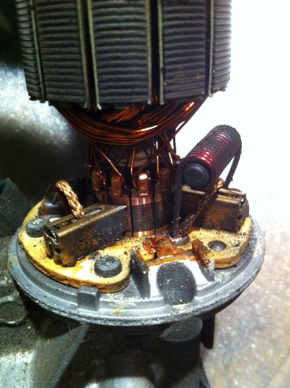

    And on this one. You can see where the brushes are connected to these coils. How would I earth isolate these? What are the coils and are they important? Sorry, I don't know much about these motors yet.

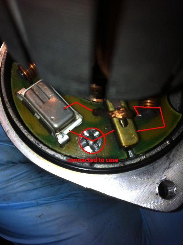

  17. prodigy
    prodigy Burning revs
    Oct 27, 2013
    459
    Croatia
    6,698Coins
    +399 / 4 / -0

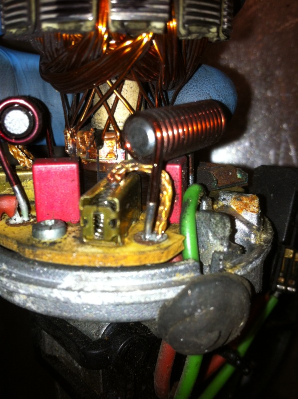

    What I did to my wipers to isolate ground, I first connected the red and green wires directly to brushes, this part of your motors.
    The best is to press the soldering iron where brush wire and coil are connected, it will slowly get loose under heat so you can easily pull brush wire out and leave the coil connected.

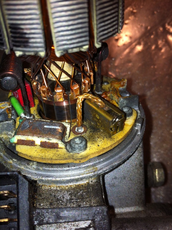

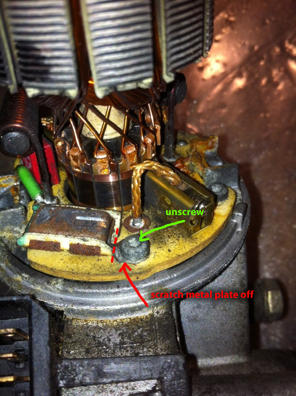

    Then you are left with ground which usually have screw with metal plate which connects it to the wiper body. That connection must be cut or scratched. It can also help if you can see the connected on the bottom of the that board, you can easily track the lines and see where they go. I believe this is the ground where you need to cut off from second wiper:
    And for the first wiper it is pretty much the same thing, this pressed screw is most likely the connection to the wiper base:
    I also did put pieces of isolating tape on the bottom of the board, making sure it doesn't connects to the base somewhere. For that you need to unscrew the srews from the board, pull out the brushes a bit and remove the upper body of the motor, then detach the board. Cut small pieces of the tape and isolate the bottom parts.
  18. Barry
    Barry Active Member
    Mar 20, 2014
    398
    Web Developer
    Northern Ireland
    3,877Coins
    +251 / 2 / -0
    Thanks. Some great advice. On the pic at the bottom - is this an actual screw though or will I have to cut it out? It's no big deal if I break it because I got it for free and I have some more as well.
  19. SilentChill
    2,645
    20,604Coins
    +3,570 / 34 / -0
    Once you have isolated the ground in the pictures above the coils are redundant ? You have bypassed it so there is no point in it being there
