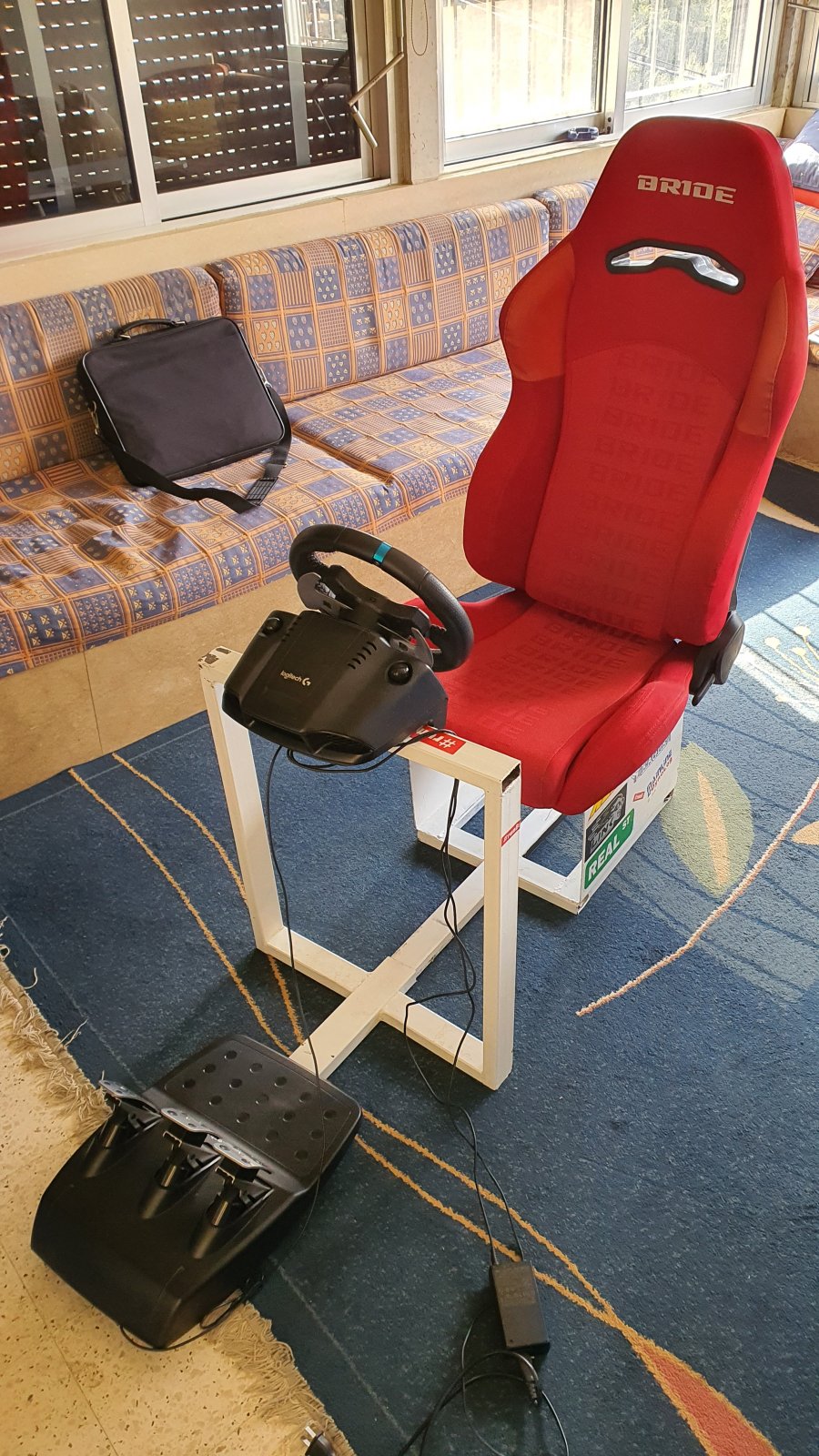

    Just grabed this setup for a really good price.
    Things are getting out of control :grin :sos

    wow thats a great setup.
    so one of your homework been solved right (doesn't need to build a DIY wheel)
    can't wait to see your final setup, and how the motor perform.

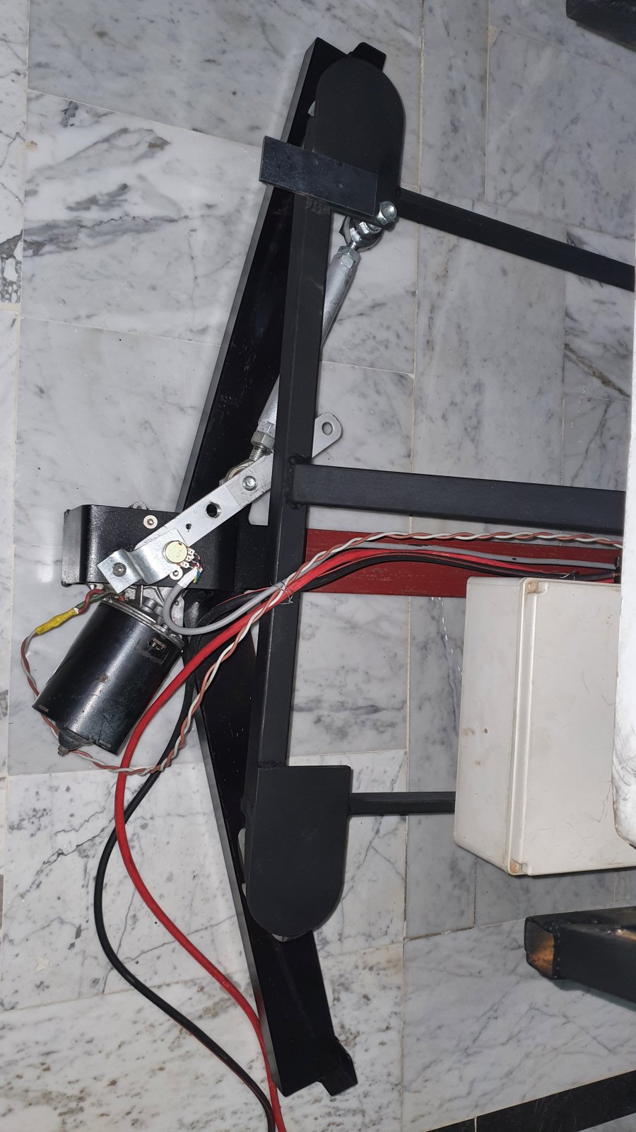

    After some testing, the motors started to be unreliable. And the traction loss motor was burned out.
    So I decided to upgrage to industrial dc motors, and keep it a 2 dof for no.
    I bought 2x 500w 24v motors with worm gearbox, during testing I burned 4 IBT-2 so far :sos
    And repaired my psu 4 times also.
    So now I have 2 options to go for:
    - wire 2 ibt-2 in parallel for each motor (hot some more spares)
    - buy new more powerful dc drivers shown in the post below
    People who tried the first option are satisfied with the results?
    Thanks in advance

    Greetings Sir!
    With parallel double ibt2, they still stall but didn't burn.
    When in motion testing in smc3, they suddenly stop and I should reload the program to make them work again
