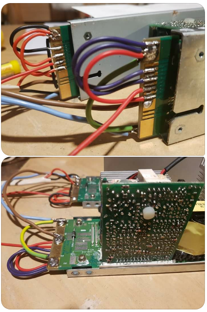

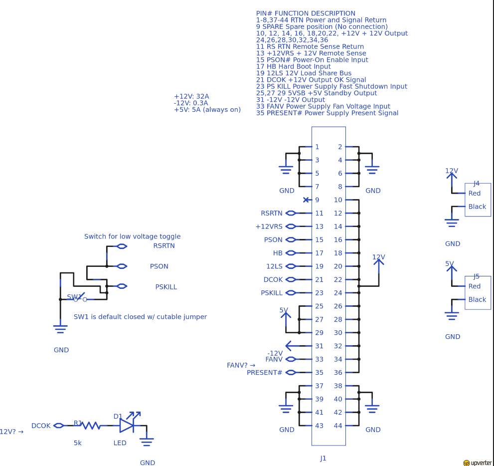

    I've spent the last three days making brackets and actuator arms for the new beefy motors. It also required beefing up my power supply - ended up using two HP 400W server supplies in parallel - pushing out 64Amps.
    Bracket:
    Power supply in parallel:
    Thought I'd post this as others might be interested.
    The load share wire is front - second from bottom. Pin 19 - 12LS

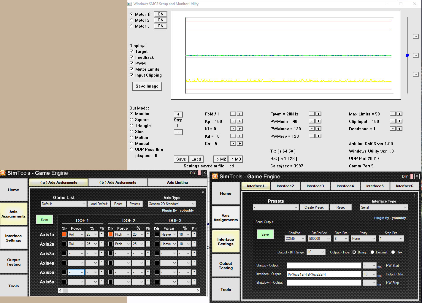

    Hi - I've moved to SMC3. The motors are holding much better now - however I can't get them to move with output testing?
    They seem to do what they should - as I've done a little test by moving them off centre without power and on power up - they reset themselves to the centre position.
    Attached is my configuration - I've spent hours reading through the forums - I'm sure everything is right. Also replaced my UNO and Motomonster just to be sure - no luck. Pulling my hair out - this is getting very frustrating now. Please see the attached images and let me know if I have any configs wrong. Thanks.
    22,086
    154,124Coins
    +11,170 / 57 / -2
    You can't run SMC3 and SimTools at the same time, like in your picture, as that will cause a port conflict.

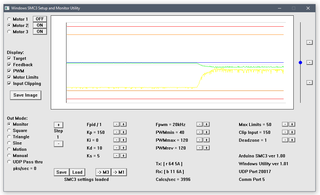

    Ok - swapped the axis controls and power to the other motor. It's definitely something wrong with the config or electronics as the behaviour is the same on the other motor. Works perfectly in one direction - but sluggish and little power in the opposite direction. It seems to get progressively worse with each rotation too. That's really weird and has me totally confused. Surely if it was the H-bridge - it would exhibit this behaviour in both directions? I will try swapping it out - just to be sure. But @noorbeast - if you have any other suggestions, I'm all ears. I've attached a video of the behaviour and a screenshot from the SMC3 utility. It's a relief that I've ruled out a motor problem, but frustrating that my sim is still out of action.
  11. Andrew Eccles
    Andrew Eccles aceinnz Gold Contributor
    Jun 30, 2016
    31
    New Zealand
    - 541Coins
    +8 / 0 / -0
    2DOF, 3DOF, DC motor, Arduino
    Ok - problem solved. Faulty Monster motor bridge (H-bridge). And that was a brand new one :(. Anyhow swapped it out and all is working as it should. It was really strange that it only worked well in one direction (the faulty one.)
