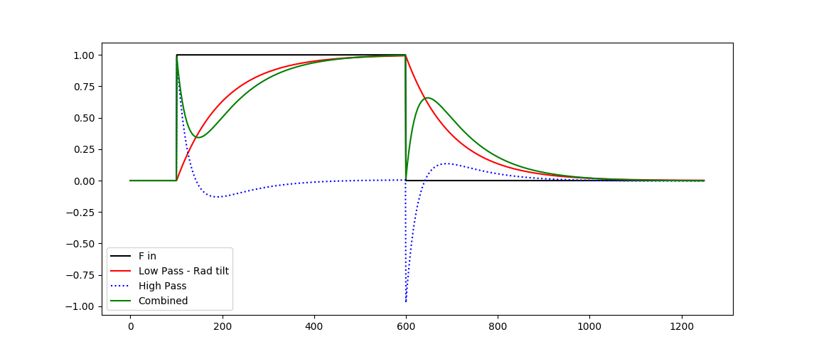

    So I'm at the point with the (simple) MCA I'm doing for my project where all the classical expected output is being produced (yay!)... and I'm trying to wrap my head around "return to neutral" false cues and how to deal with that. (If anyone has any pointers or links - advice is appreciated)
    In any case, I'm going to move forward with this for now and plug in my inverse kinematics next... well, that and fix a sticky solenoid valve, but some silicone lubricant can fix that... ;)
    After that, I'm going to collect some force data from simtools/no limits roller coaster 2 and run it through the software and see how it looks/ performs.
    I might quickly throw a simulated simulator into my python code using pyQTgraph... we'll see.

    Nice curves! Trying to build something like this as well to look at the data in real time. So far, I can only log the data and later visualise it in Excel.
    A question about the highpass signal: How do you create that? It is apparently not being created by subtracting the LP-signal from the original signal. Do you have a code snippet? I'm asking because from the looks of it, it should give exactly the kind of motion response I would like to see for a step input.
    And on top: It looks as if THIS is the kind of signal that would actually work nicely with an integrator instead of another LP filter (you remember our conversation?)
    Thumbs up!! :thumbs

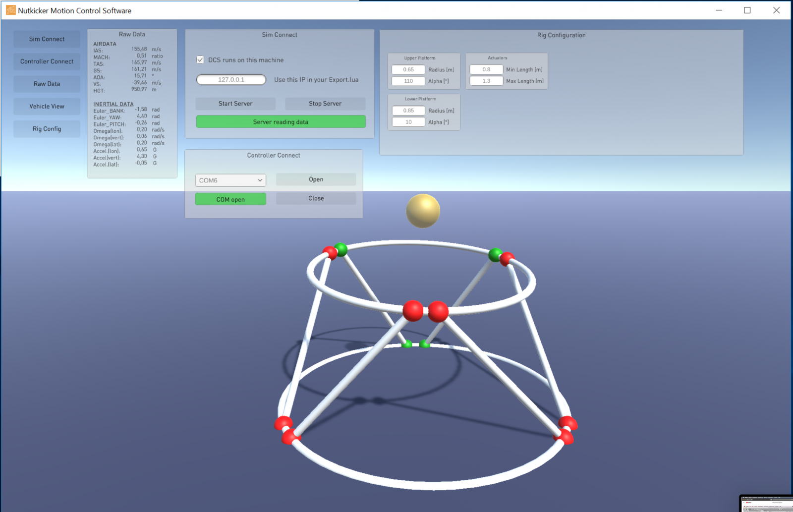

    On another note: I've started to populate the GUI of my software, so that a user can eventually use the software :)
    Up until now, I have made all changes directly in code or inside the Unity editor.

    So, I'm using python to generate that... and a couple of libraries (numpy and scypi) to do the heavy lifting... I'll send you a copy of the code.
    In the mean time - when I want to generate a filter, I use a class (that I stole) that gives me a few functions on top of a filter (init, reset and apply - the last of which is "take this new data value and stuff it in the filter"). To instantiate that class with a specific type of filter, I do this:
    #low pass filter - first order
    def firstlp_filter(w):
    b= [0,w]
    a= [1,w]
    return RealtimeFilter(*signal.bilinear(b,a,fs=FREQ))
    Which translates to omega/(s+omega)... or:
    #high pass filter - second order
    def secondhp_filter(z,w):
    b=[1,0,0]
    a=[1,2*z*w,w**2]
    Which translates to s^2/(s^2+2*zeta*omega*s+omega^2)...
    Here's the fun part... want an integral function?
    #single integrator - 1/s
    def sint_filter():
    b= [0,1]
    a= [1,0]
    ...a double integral?
    #double integrator - 1/s**2
    def dint_filter():
    b= [0,0,1]
    a= [1,0,0]
    ...which I just corrected, so, thanks - posting helped me see where I had a bug. lol

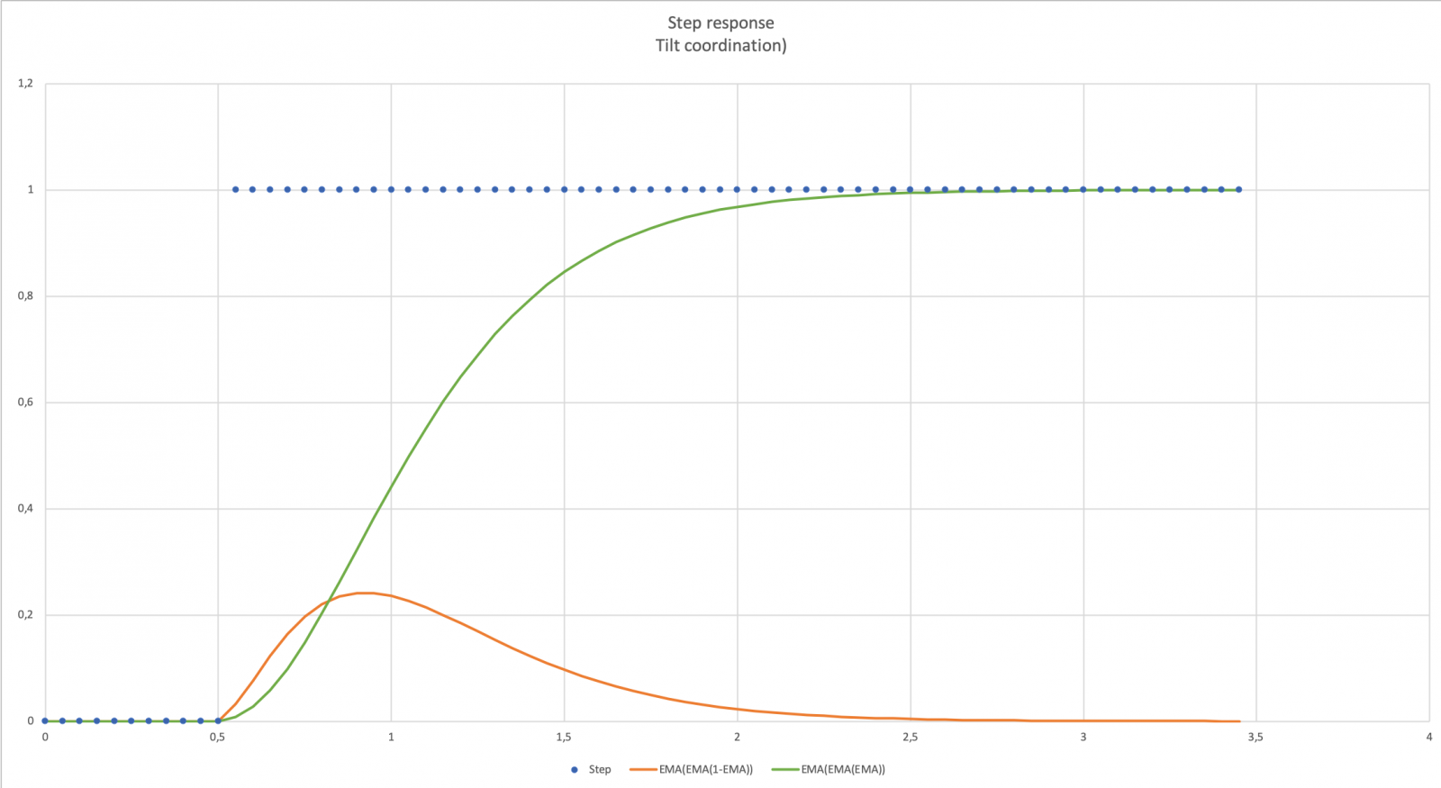

    This is my backup plan:
    Grey for pitch and blue for surge. Assuming that the input step is an acceleration(Lon)
    Dirty :)

    Yeah, the more I look at it, the less I think that worrying about the loss of of G in z axis is worthwhile.
    So, blue is with the double integration and is effectively distance of the travel in the simulator? and grey is with single integration and is the angle of the platform?

    I guess I finally have something to try out for anyone who would like to take a look:
    Nutkicker Motion Control
    It is not pre-alpha or even prototype stage yet. I think "proof of concept" would best describe it. It reads the data from DCS (100% done), processes it (~50% done) and sends the actuator commands via serial connection to a controller (~10% done).
    So far, I only support DCS World but X-Plane and P3D will follow.
    Instructions:
    1. Copy the Export.lua file into your [Saved games folder]/DCS World/Scripts. Please save your existing Export.lua (if present).
    2. Start Nutkicker Motion Control Software.exe and acknowledge the warning.
    3. Click "Start Server"
    4. Start the sim. The data will flow when a mission is running and not paused.
    Keep in mind: There is still a lot to do! This is by no means intended to be actually used for motion cueing at this stage of development. PM me if you want to try it out in VR.
    I have a Mac version as well!
    Dirty :)

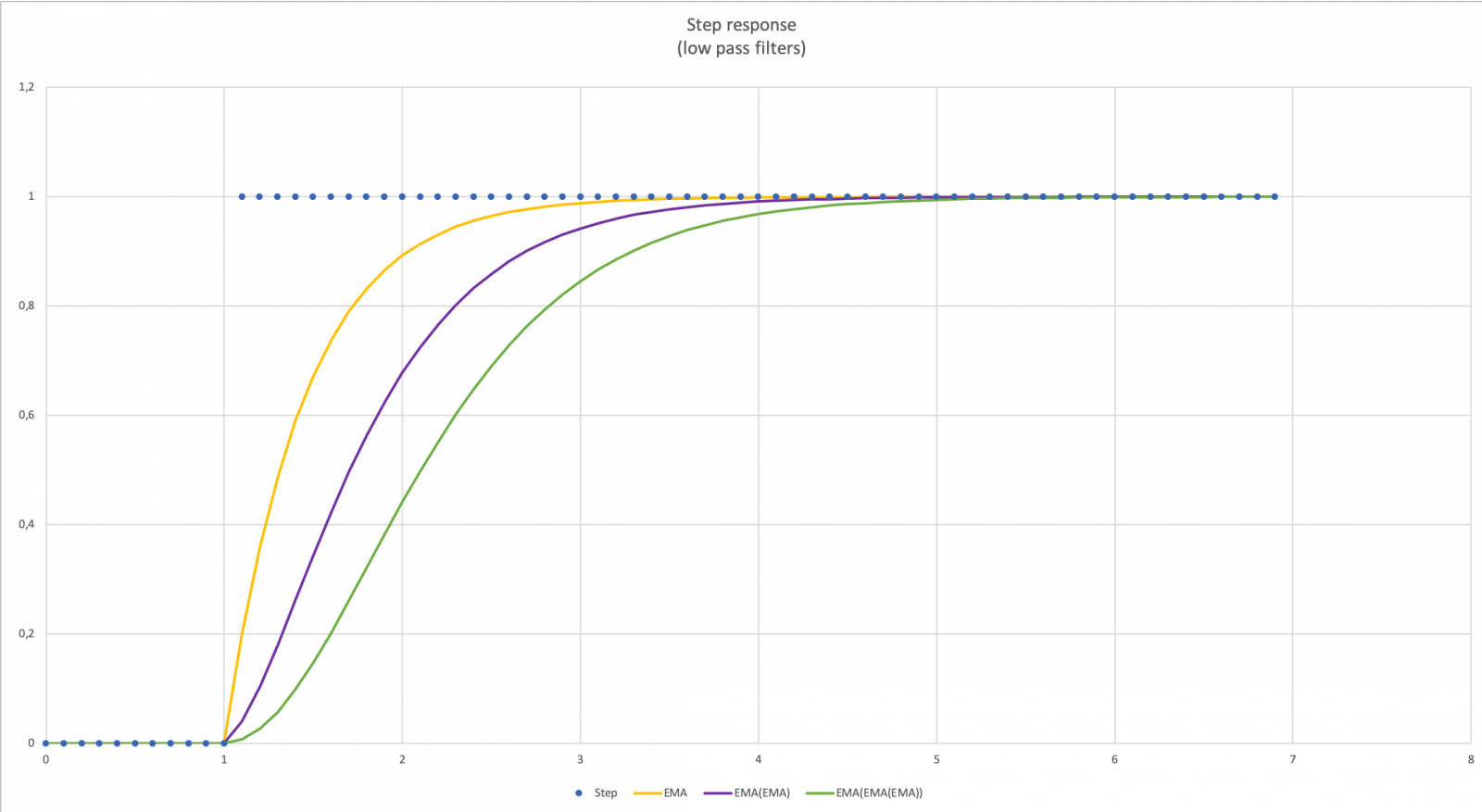

    Here's how a lowpass filter works:
    1. You pick a value between 0 and 1 that describes how much you want to smoothen out the signal. Let's call this value "alpha".
    2. To determine the output of your filter, let's assume that the current output of the filter at start time is 0 (zero).
    3. Whenever a "newInput" arrives, you calculate the "newOutput" of the filter by: newOutput = alpha * newInput + (1- alpha) * currentValue
    ...that's it. Your first Exponential Moving Average (EMA) filter :) basically you compose the newOutput with parts of the currentValue and parts of the newValue. How much of which, is determined by the value alpha. The higher that value, the higher the tendency of the filter to adopt the new value. I use values around 0.01 .
    If you send that signal through another LP filter, you have created a filter of 2nd order.
    If you send that signal through another LP filter, you have created a filter of 3rd order.
    If you send...
    ...you get the idea! :)
    Now, why would anyone want to send a signal, that has just been filtered, through the same filter yet again? Because it changes the characteristics of the signal in a quite important way. Each time, you add one level of "continuity".
    Here's the response to a step input of lowpass filters of different orders:
    The blue dotted line is the step input and please note that it is NOT continuous! It makes a step! Hence the name :) ...I guess.
    If I take that input value and send it through a lowpass filter, I get a LP filtered signal that is G0 continuous. Meaning each value "touches" its neighbour. It is not tangent, and certainly does not have the same curvature in that spot, but at least there are no more gaps.
    If I take that output value and send it through another lowpass filter, I get a LP filtered signal that is G1 continuous. Meaning each value "touches" its neighbour, is tangent in that spot, but does still not have the same curvature in that spot, but at least there are no more corners.
    If I take that output value and send it through yet another lowpass filter, I get a LP filtered signal that is G2 continuous. Meaning each value "touches" its neighbour, is tangent in that spot, and also has the same curvature in that spot. The curvature changes only gradually.
    Take a look at that picture again:
    The yellow line has a corner. Curvature and change of curvature are infinitely high in that spot.
    The violett line has a radius. Curvature is present but moderate. Change of curvature (jerk) is still infinitely high.
    The green line builds up it's curvature gradually. Note that both curvature and the change of curvature are moderate.
    In this picture the gradient of the graph represents velocity, the curvature represents acceleration and the change of the curvature represents jerk. I will write about what humans can and cannot perceive next. So, once that is clear, it will become totally obvious why certain filters are chosen for certain DOFs.
    Basically it all boils down to the question of: "Do I want to make the occupant perceive something, or do I want to keep him from perceiving something"
    I'm gonna let that simmer for while :)
    Dirty :)

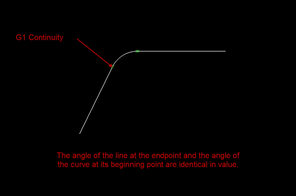

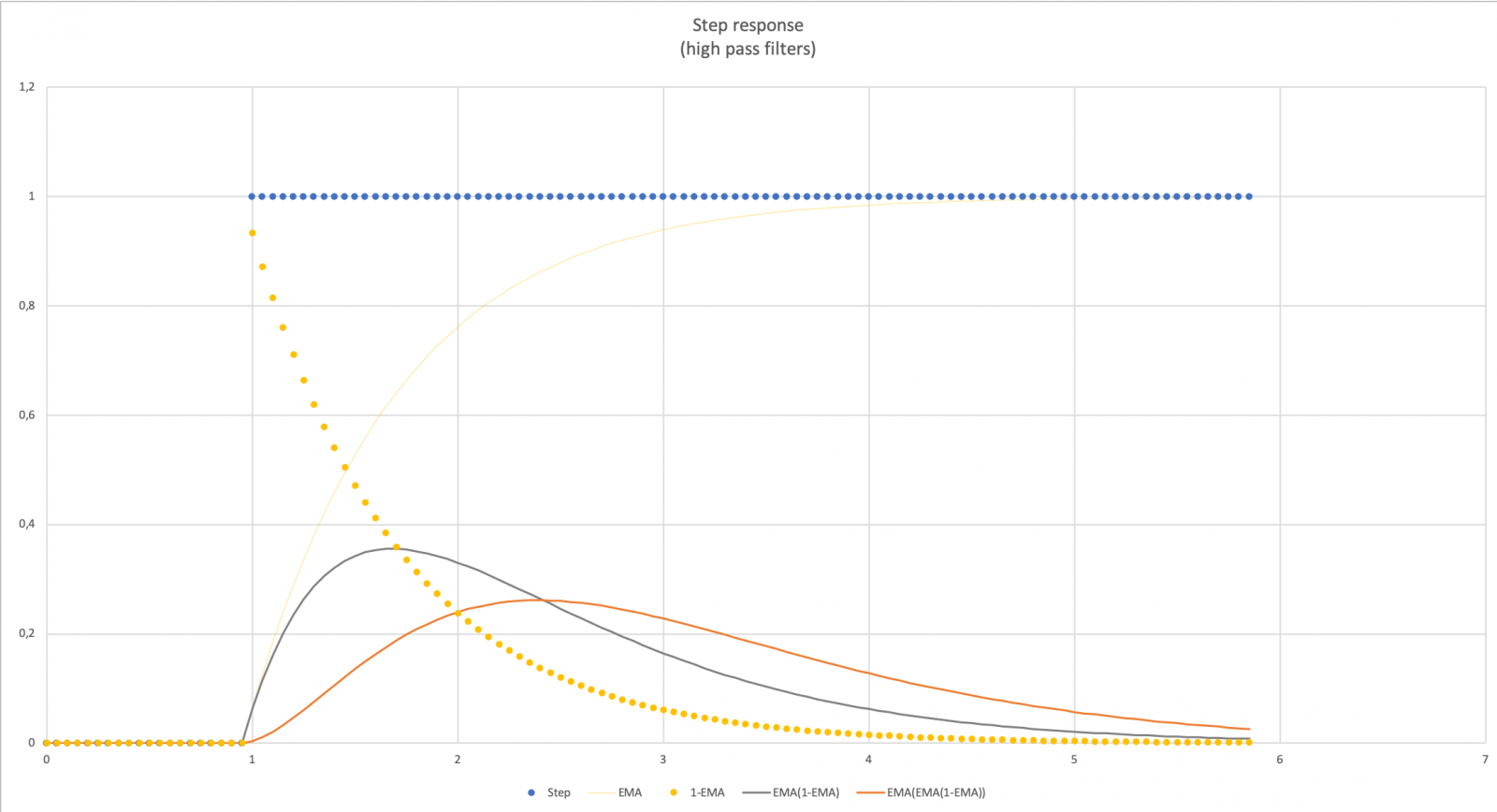

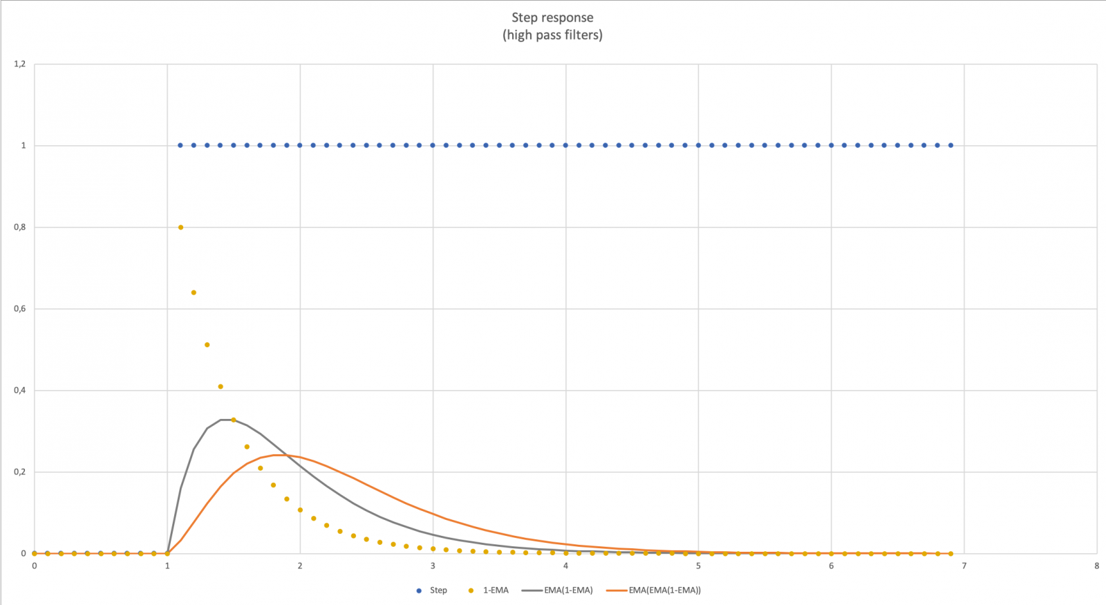

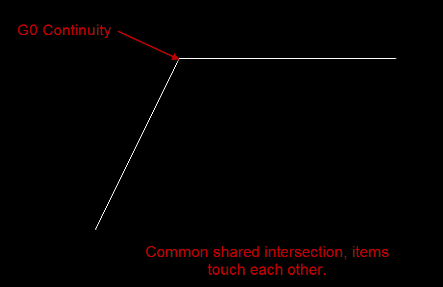

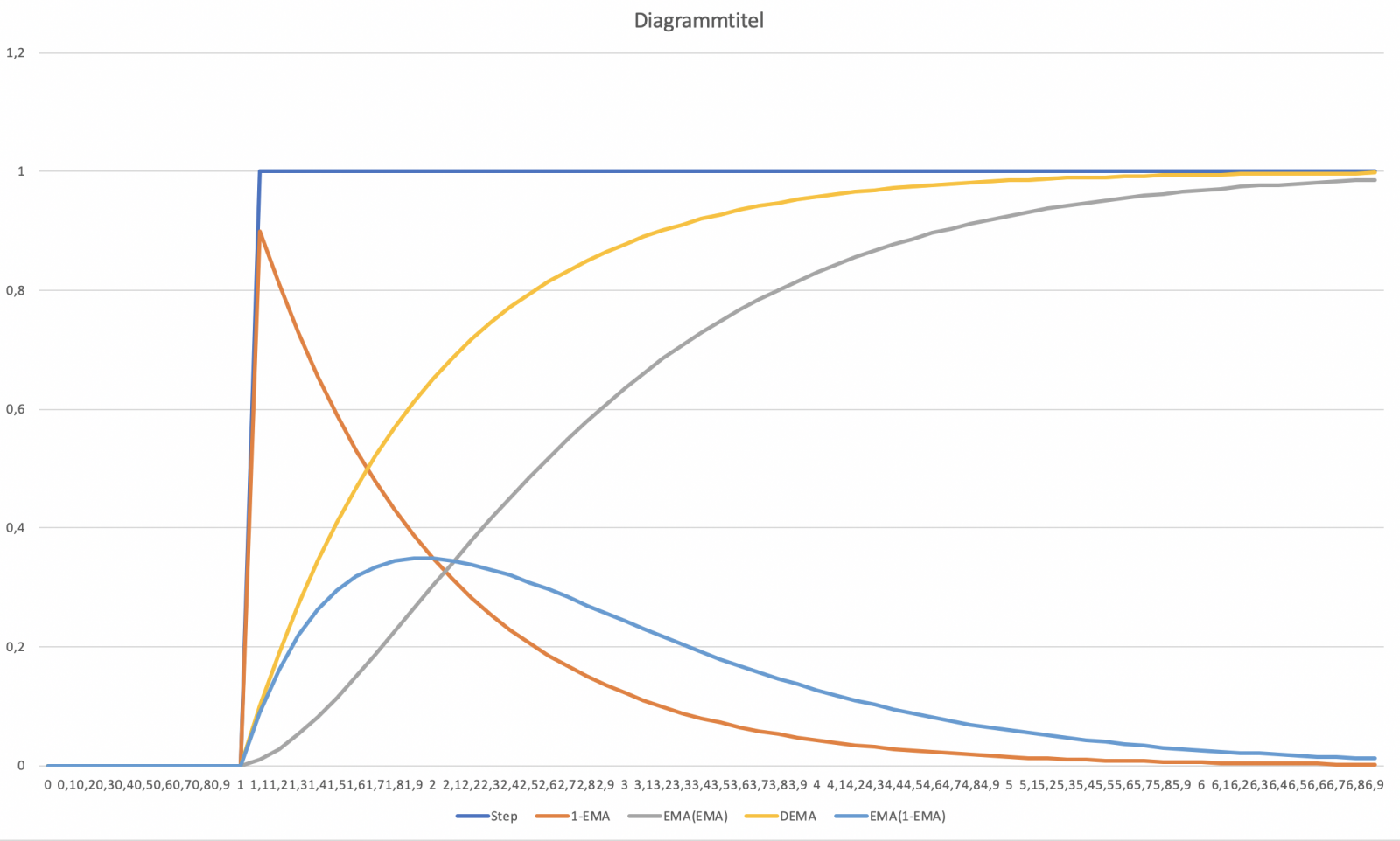

    HighPass filters.
    Let’s talk about high pass filters and how they react to a step input. First of all, I create a HPF by taking a low pass filtered signal and subtract it from the original signal (1-EMA). Whats left then is the high frequency content of that signal. You can still see the low pass filtered signal from the last post in this picture as the thin yellow line:
    The difference between this LP signal and the blue dotted input signal is the yellow dotted line. Note that it is NOT a continuous signal. It makes steps every time the input signal makes a step.
    If we send that signal through one or more low pass filters, we can change the properties of the signal exactly like we did in the previous post. Each time we add one level of continuity:

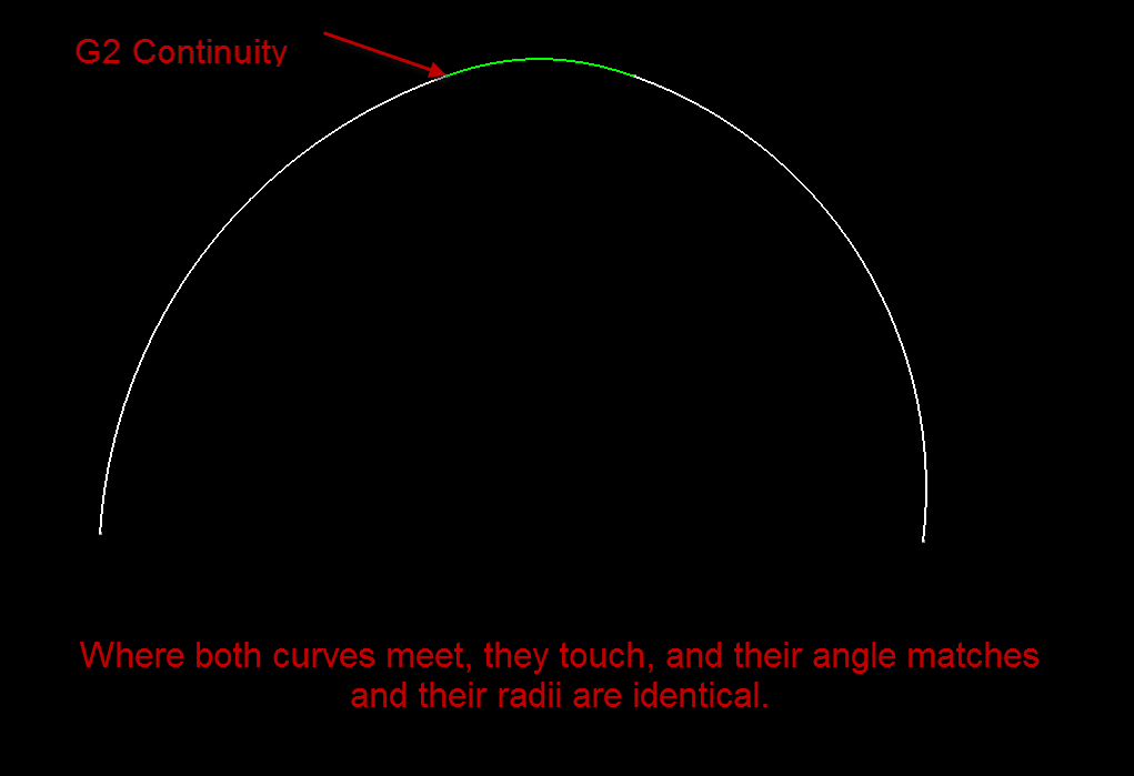

    1. No Continuity (yellow dotted) Signal has steps
    2. G0 continuity (grey) Signal has corners
    3. G1 Continuity (orange) Signals has radii
    4. G2 Continuity (not shown) Signal has curvature continuity
    Like in the last post, the gradient of the output graph still represents velocity, the curvature represents acceleration and the change of the curvature represents jerk.
    Which signal we use to drive which DOF depends on what we want the occupant to feel (or not feel). I will try to illustrate a concrete example in the next post.
    Dirty :)
