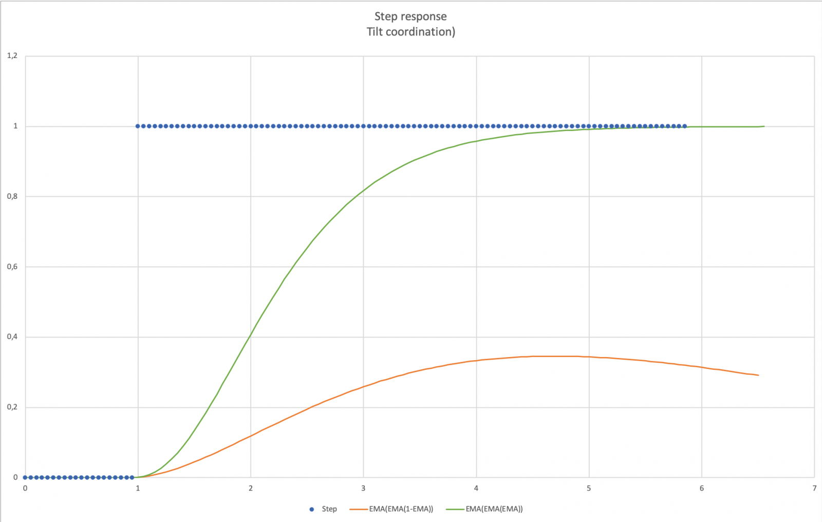

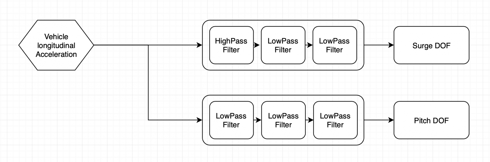

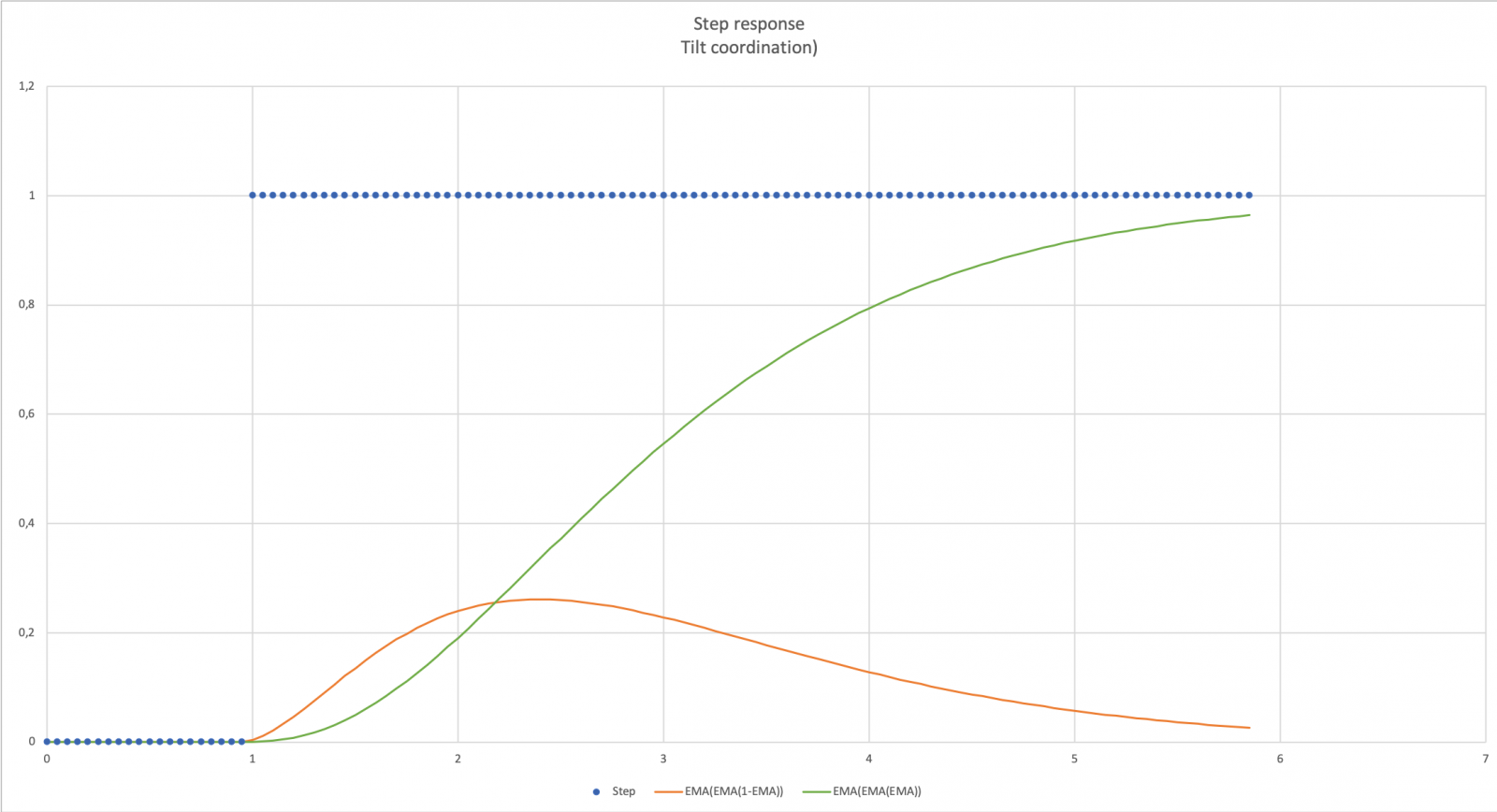

    Here’s a concrete example: Let’s briefly go over what happens with the platform when your vehicle starts to accelerate:
    Forget these block diagrams with their fancy notation, greek letters and hieroglyghic layout!
    Rather, try to get an intuitive understanding of what’s going on by understanding this diagram:
    The blue dotted line is the vehicles longitudinal acceleration. First it’s zero. Vehicle standing still. Then the driver steps on the gas or the pilot slams the thrust levers forward and the acceleration is present instantly. I know that in real life it is not gonna be present instantaneously, but this is a test case. It won’t get any trickier than that.:thumbs
    Now the platform reacts in two different ways:
    1. The Surge DOF will make a jolt forward and then softly return to center.
    2. The Pitch DOF will tilt the platform back to make the occupant feel being pressed back into their seat.
    These two go hand in hand! They belong together like chocolate and brownies. Still there is a key difference:
    • In the Surge DOF we move the platform forward and we actually want the occupant to feel the forward motion. —> The motion itself shall be perceivable.
    • In the Pitch DOF we rotate the platform nose-up, but we don’t want the occupant to feel this rotation. —> The motion itself shall not be perceivable!
    Being IN that tilted position is totally fine, it’s just the „getting there“ that we want to conceal! The rotation itself is a false cue! We need to mitigate those.
    From this diagram I think it’s obvious that we should take the (green) low pass filtered signal to drive the pitch DOF and the (orange) high pass filtered signal to drive the surge DOF. Exactly which order of filter will become clear later in this post.

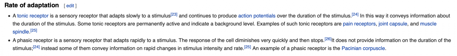

    Human perception:
    I will stay intentionally vague on this as it is not my area of deepest expertise, but at least you should be aware, that in general humans perceive changes of a value a lot better than the constant value itself.
    Example:
    If I could alter gravity and dial up the Earth’s accceleration from 1.0 to 1.05 G (5% increase) )over let’s say 120 seconds, you would probably not even notice it. You would maybe wonder why you all of a sudden felt so weak.
    But if I were to flip a switch and changed it in a single step from 1.0 to 1.01 (only 1% increase) you’d feel it in an instance.
    Similarly, I guess you will not be able to estimate the temperature of a bowl of water to within a few degrees C° when you put your hand in it. But if I had two bowls (20°C and 20.5°C), and you put your hands in one, and then in the other, you would immediately notice the difference.
    You might wanna google „phasic receptor“ and „tonic receptor“
    Applied to motion cueing:
    SURGE: In the vehicle the longitudinal acceleration is present instantaneously (that’s the test case), so let’s show the occupant that by using a filter that…
    1. Gives him the acceleration immediately.
    2. --> Has curvature immediately. Remember, that’s acceleration.
    3. --> Provides tangency, but no curvature continuity.
    That would be a high pass filtered signal that is then smoothened out by a 2nd order LP filter to give us G1 Continuity.
    PITCH: Since the surge DOF has already provided the occupant with 100-500ms of acceleration fun, we have a little time to rotate the platform nose-up. Let’s invest that time into a smoothened-out motion during rotation. We need a filter that…
    1. Achieves the desired rotation with cues that are as little perceivable as possible.
    2. —> May not have abrupt changes in curvature. Those are easiest to perceive.
    3. —> Must provide curvature continuity on the signal.
    That would be a 3rd order low pass filter, which gives us G2 continuity.

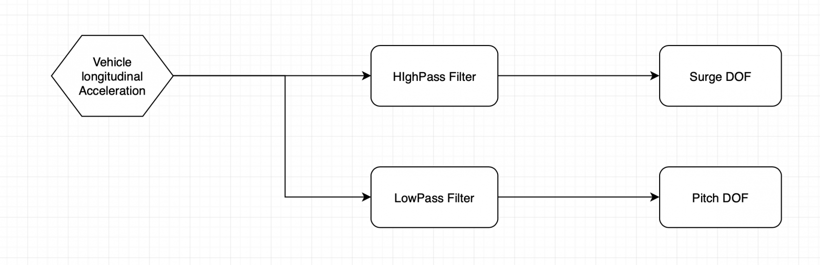

    This is how I intend to process longitudinal and lateral vehicle accelerations to drive DOFs in my software for now. The roll channel from the hieroglyph is being approached with the same "toolset". As with everything, that is until I get (or are being told) a better idea :)
    Eventually the coordination channel is mixed in with the angular rates channel.
    Accel.lon -->Pitch channel
    Accel.lat --> Roll channel
    Cheers, Dirty :)

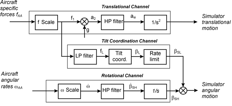

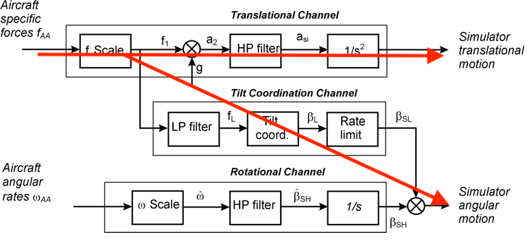

    If you do want to take a look a the hieroglyphs, these are the paths I described in this post:
    The „1/s^2“ in the translational channel is a double integration, which makes total sense if…
    • you use a „1-EMA“ as HP filter
    …and…
    • live in Math-Land where they wouldn’t drift.
    …then the top row would be quasi equivalent to a HP filter followed by a 2nd order LP filter.
    ...thanks a lot to @harwoodr for helping/confirming/puzzling me in just the right amount :thumbs

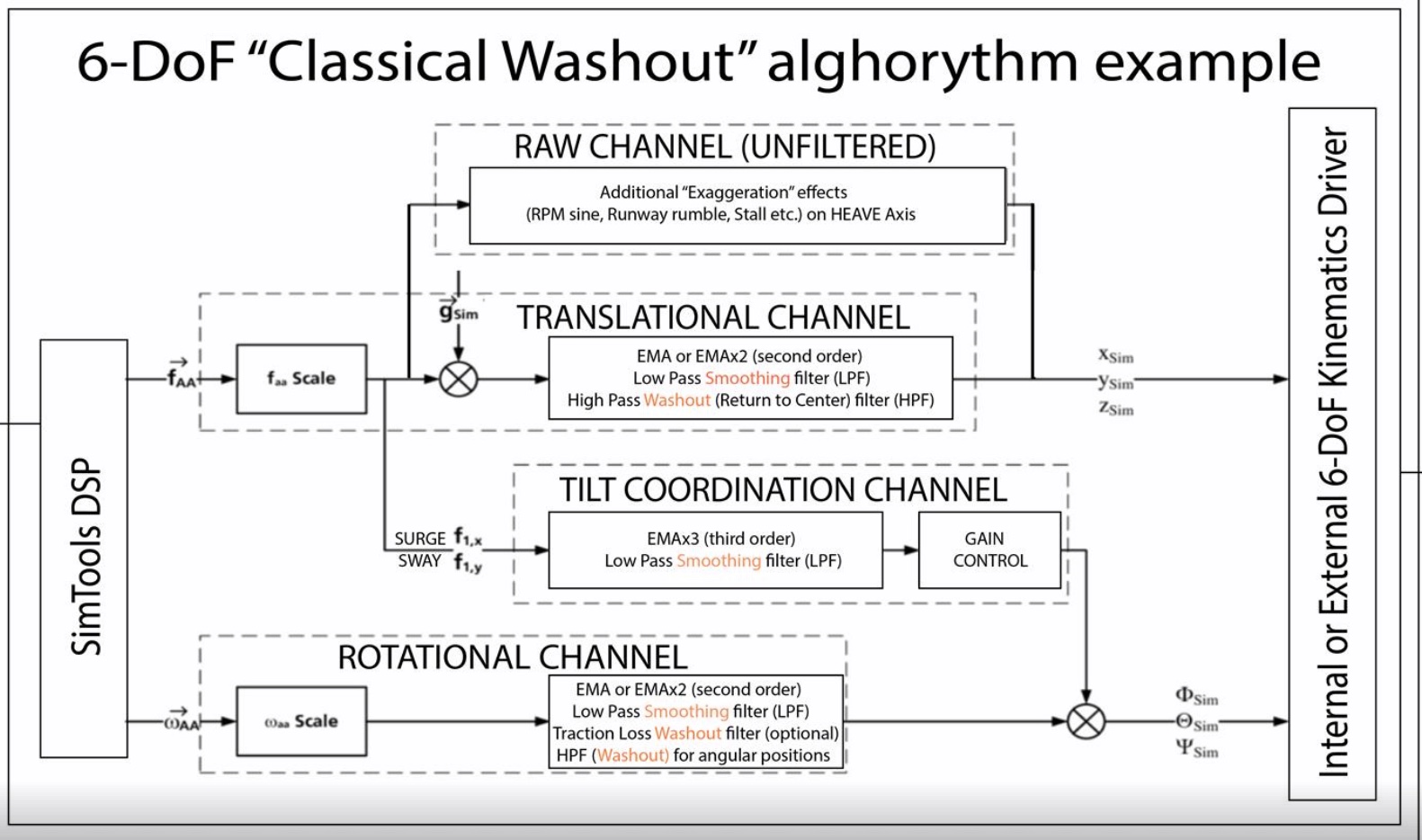

    Tilt coordination:
    Pitch:
    - “Third order” EMA Low Pass (“S2 curve” smoothing)
    Surge:
    - “Second order” EMA Low Pass (“S1 curve” smoothing)
    - “Third order” EMA High Pass (“S2 curve” washout)
    With a bit of luck, we will be able soon to construct this inside the SimTools matrix as well. ;-)
    Cheers

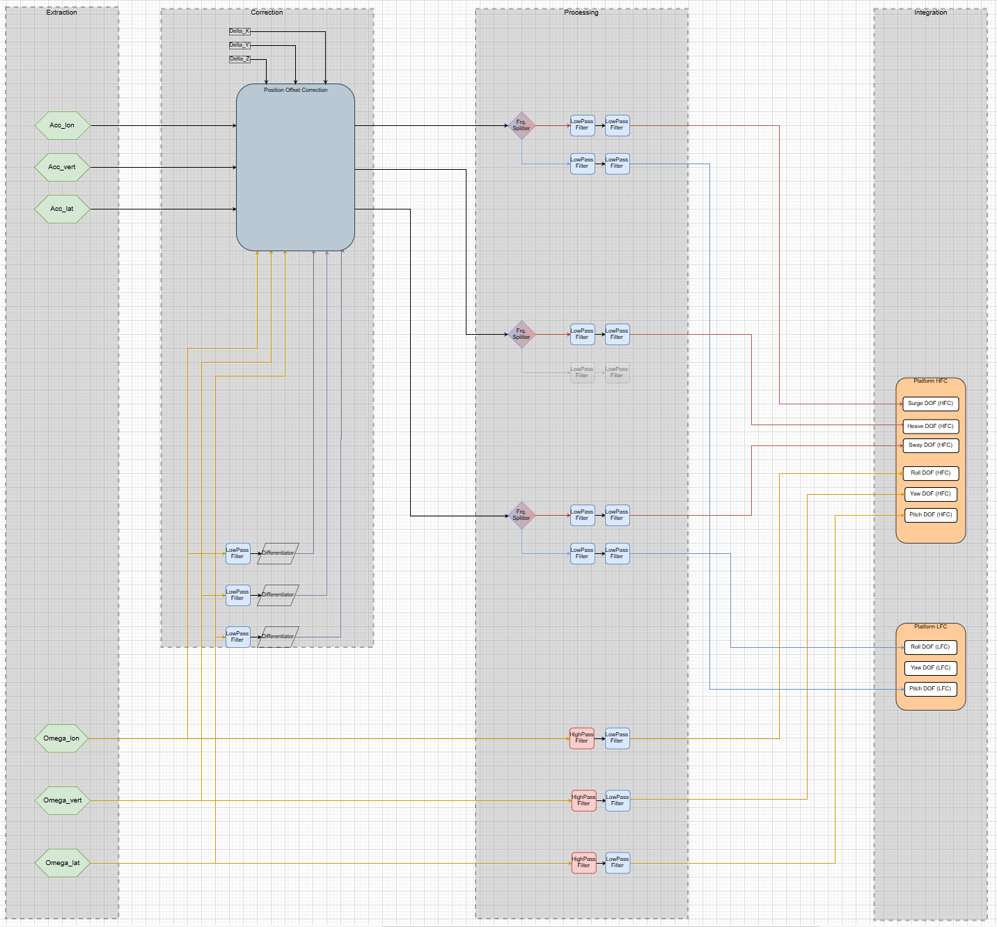

    Just a quick Update:
    I put the project on GitHub: https://github.com/Dirt-e/Nutkicker_Motion_Controller
    Here's a synoptic representation of the data flow in the software.
    I left plenty of space, because there is still a to to be added.
    Certainly a lot clearer than the representation I had before:
    Dirty :)

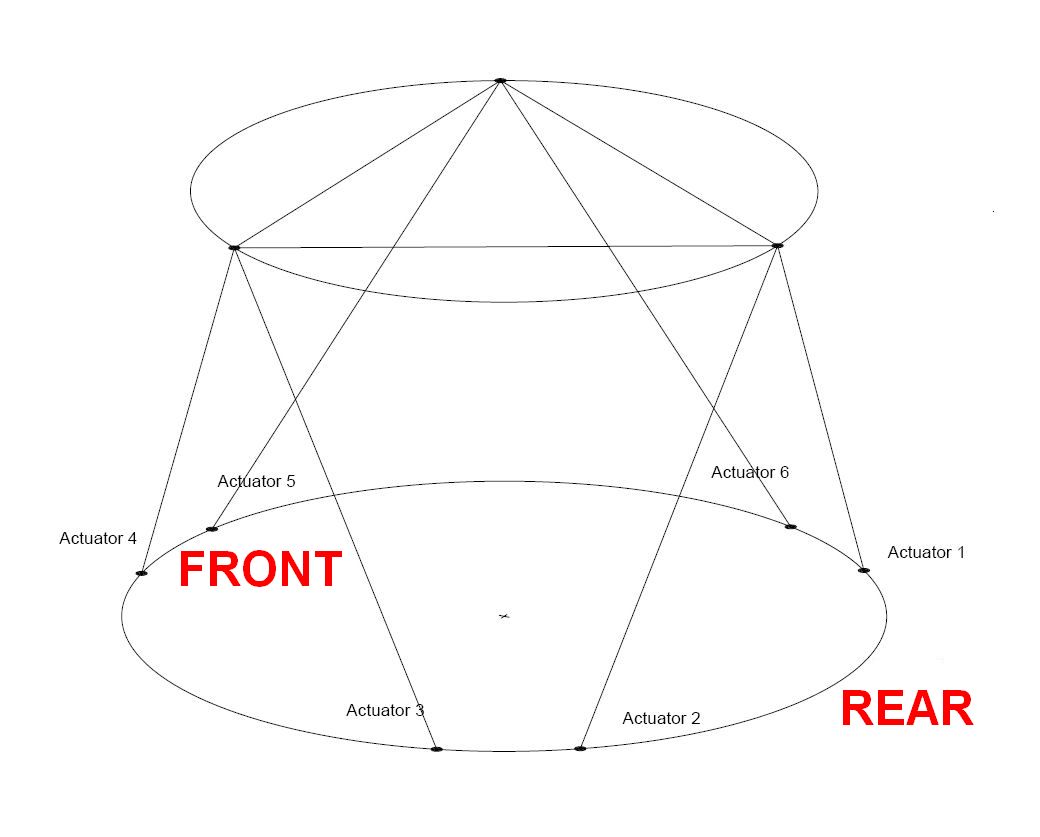

    For the AMC1280, you have to send 20 bytes:
    <255><255><Axis1a><Axis2a><Axis3a><Axis4a><Axis5a><Axis6a><0><0><0><0><10><13>
    All numbers inside <> is the value of the byte
    Axis1a to Axis6a are the axis values in 16 bit format, so 2 bytes for each (0 to 65535).
    The order depends on how you are calculating the rig.
    But I think Thanos uses:
    I think those last zeros are for other axis.

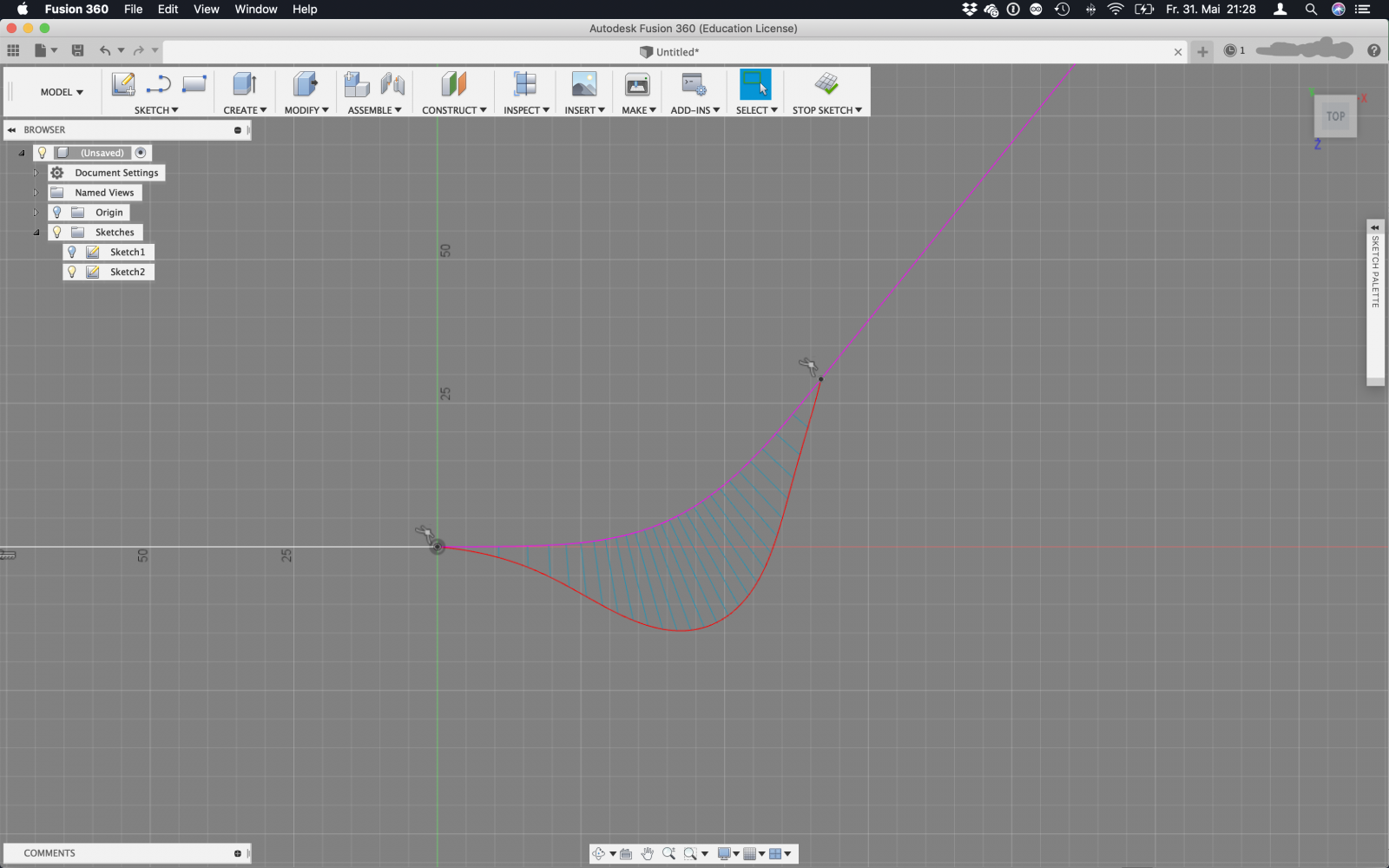

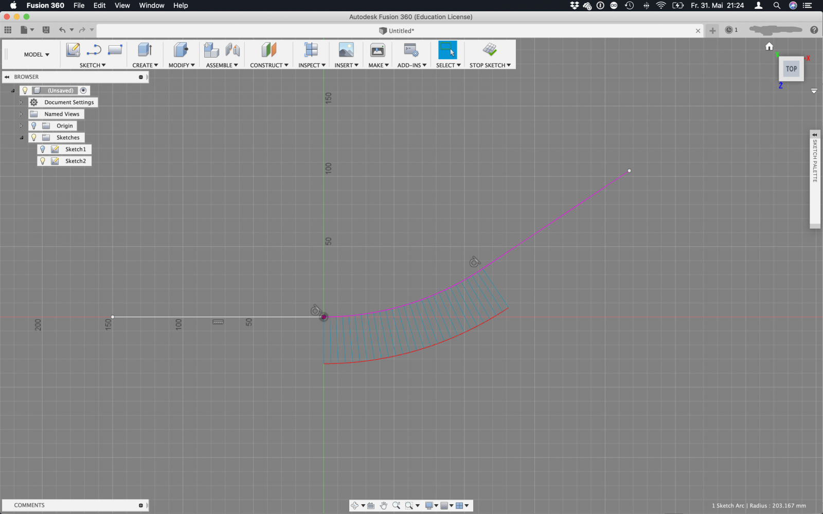

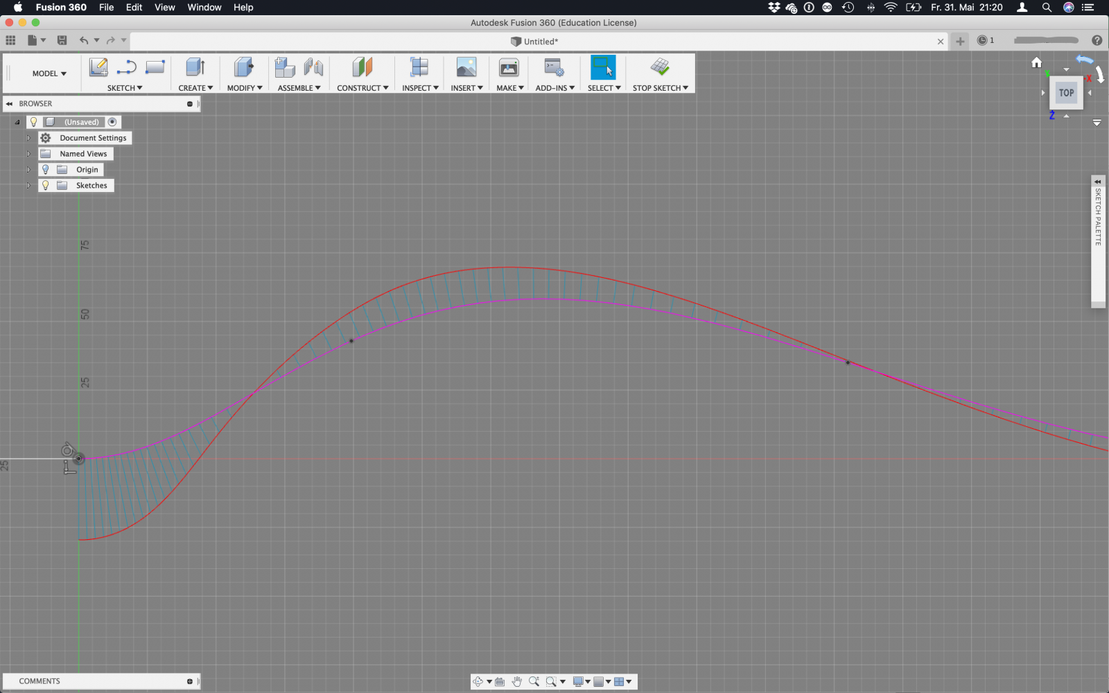

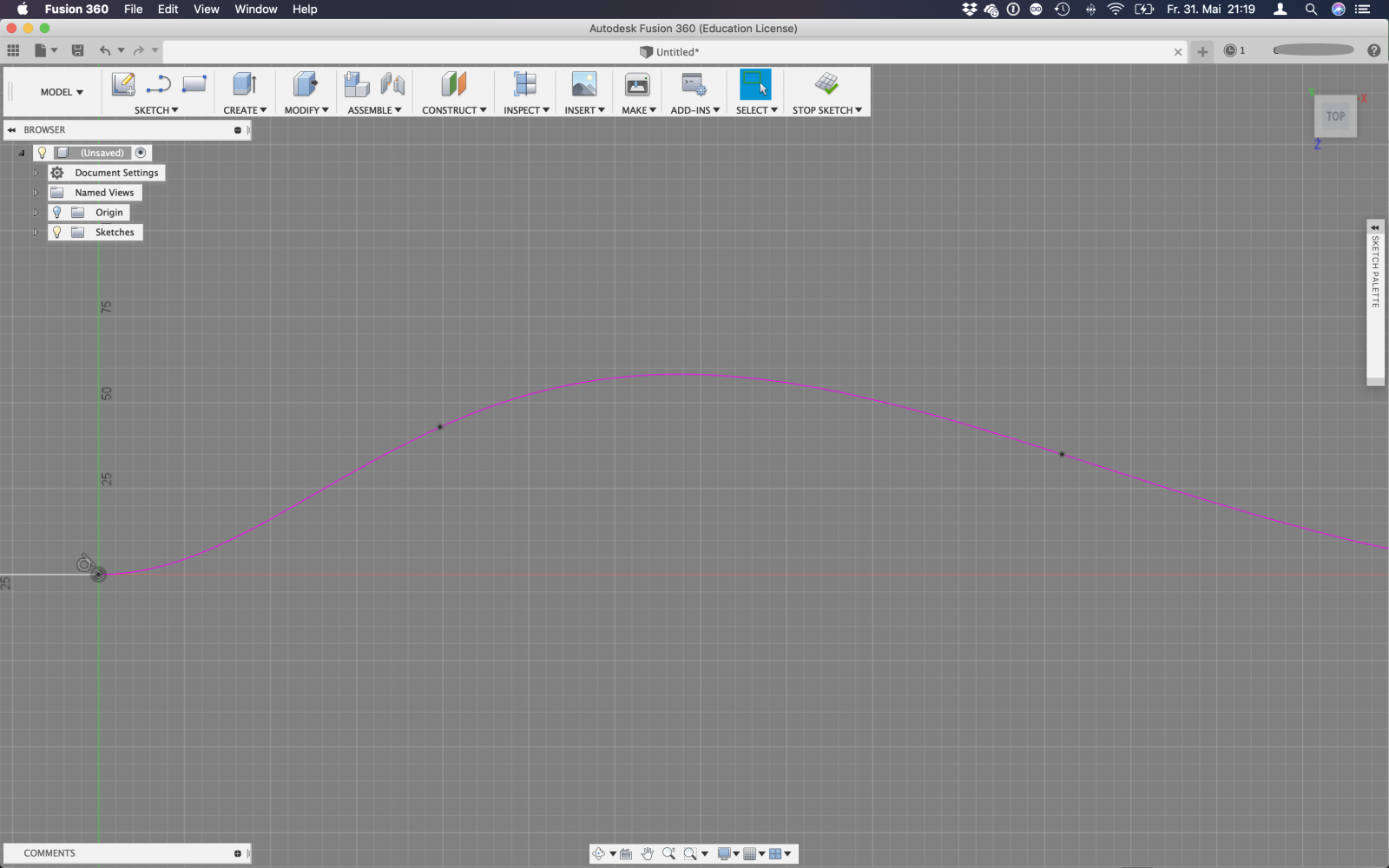

    I played around with different filters a little more, because I wanted to better understand which "dials" allowed me to change the filter in which way.
    If you haven't understood what I meant by "tangency" and "curvature continuity", maybe these picture can illustrate:
    You can see two straight lines connected by a radius (magenta). The curvature of that radius is indicated by the blue "curvature comb" and the red "hull curve". As you can see, the radius is tangential to the two straight lines. But the curvature pops up out of nowhere. The line has zero curvature, the radius has full curvature, and then the next line has zero curvature again. The curvature comb (representing acceleration!) starts and ends very abruptly. This is the step response you want in surge, because when the input (acceleration) makes a "step up", this comb should also "step up".
    On the other hand, here are two similar lines, but they are connected by "G2 continuity".
    They too have a curvature-comb but it does not pop up out of nowhere. It gradually builds and then gradually disappears. Curvature (aka. acceleration) sets on smoothly and goes away smoothly. This profile has a much higher chance of going undetected. This is what you want to use for Tilt coordination, because you don't wanna feel the pitch come and go, you just want to feel it being there. :)
    These curvature combs allow for something else: They can tell you where the graph changes direction. I think the English term would be "infliction points". Those are important, because you wanna make sure that by the time the surge reverses acceleration you have built up a noticeable amount of tilt to take over the job of keeping the illusion "alive". I have modelled the highpass signal for the surge channel in CAD with and without the curvature comb:
    Bildschirmfoto 2019-05-31 um 21.19.15.png Bildschirmfoto 2019-05-31 um 21.20.11.png
    Here it becomes apparent that at some point (before the "peak travel"!) the curvature reverses and thus the acceleration reverses. You want to check where that point lies and tune your filters in a way that by the time this happens you have reached a sufficient tilt angle. This adverse curvature is false cueing and the only way to mitigate it is to try to spread it out over the course of a few seconds to make it "stand out" less.
    To apply this to my filters: Tilt coordination.png
    At roundabout t = 2.3 seconds the orange (surge) reverses curvature (acceleration) and thereby loses effectiveness. By that time the green (tilt) has reached ~50% of its tilt and generates sufficient cues for the occupant to still feel being pushed back into it's seat. As the adverse curvature of the surge inevitably builds up, the false cues coming from this adverse curvature are being compensated for by the proverse cues now coming from the tilt. You may have to imagine the curvature combs in this picture to see the point.
    After playing back and forth with the filter variables in Excel, I noticed that I was most probably wrong back then when I said that I think it makes sense to use a frequency splitter to have one signal as the "complement" to the other. It appears those curves turn out nicer when the HP and LP signals keep a little "overlap". I mean that the LP signal keeps a little bit of the higher frequencies and the HP signal keeps a little bit of the lower frequencies.
    I can't tell you why, but those curves turned out nicer after I tuned them with an overlap in their frequency composition *scratching head*
    Dirty :)
