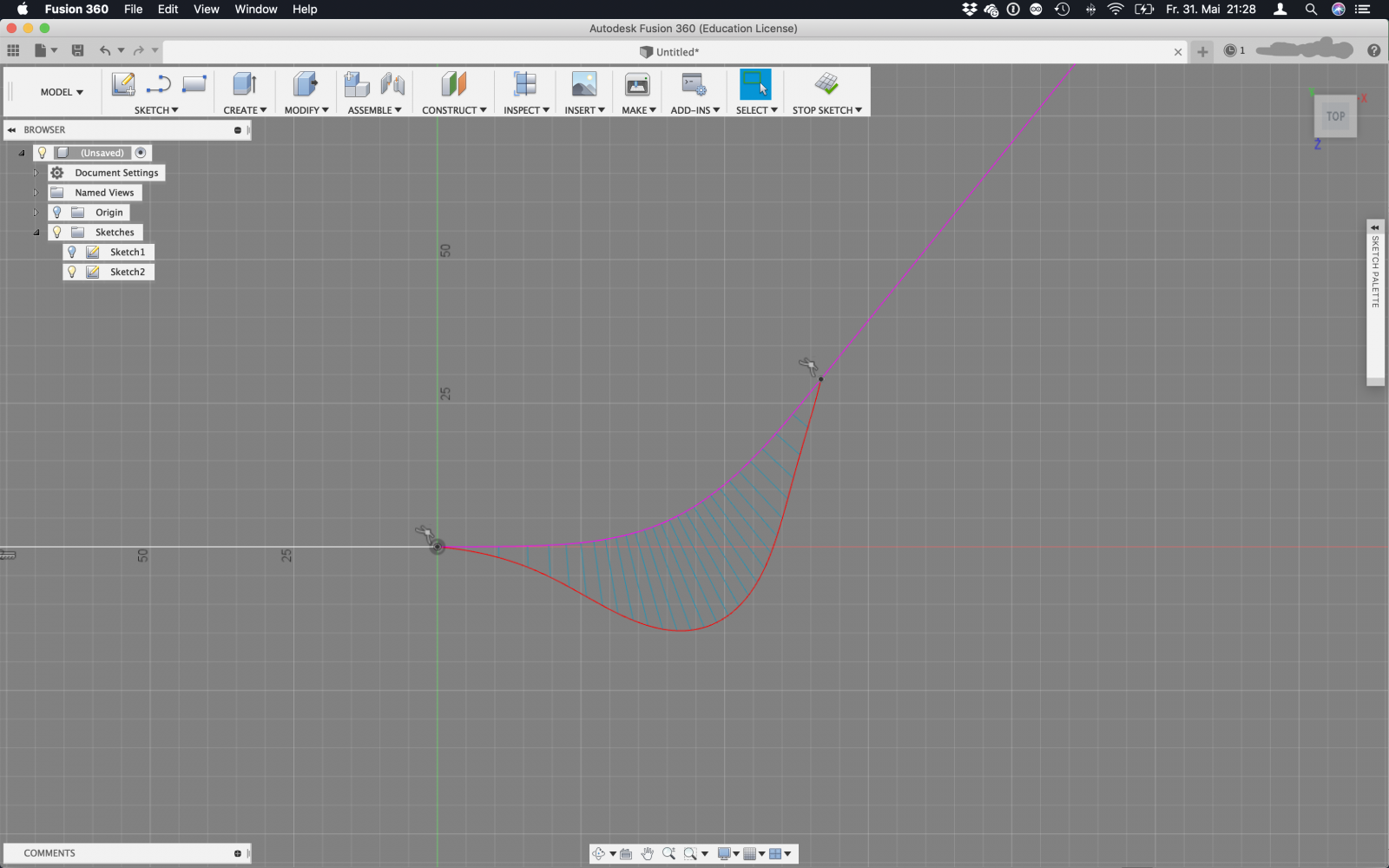

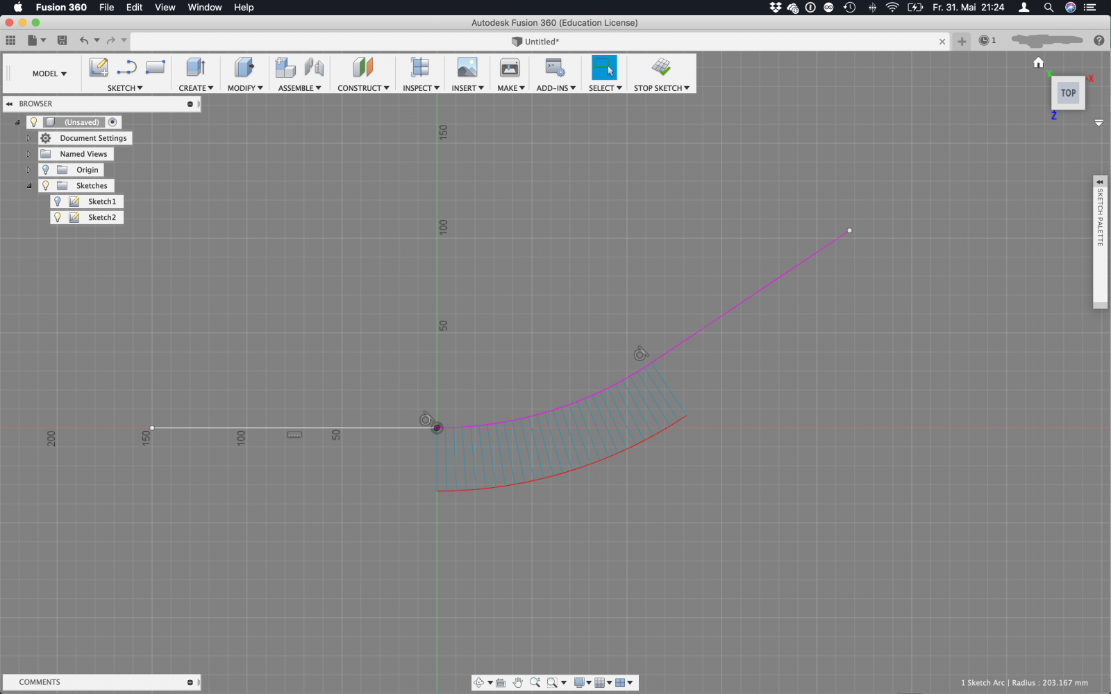

    I can also tell you where your butt out-performs your eyes:
    It's those moments where the "curvature-comb" pops out the graph. Where acceleration sets on. Hence "acceleration ONSET cueing". By choosing the right filters, you make a deliberate decision on exactly what to "show" your butt; In what way you present the onset of acceleration to your butt.
    Bildschirmfoto 2019-05-31 um 21.24.08.png Bildschirmfoto 2019-05-31 um 21.28.31.png
    In these pictures the magenta curve doesn't seem to look too different to the naked eye, does it? It looks just,... well,... curved :) But the curvature comb shows that the curvature onset (=acceleration onset) is very different. Those moments are what your butt notices a lot better than your eyes.

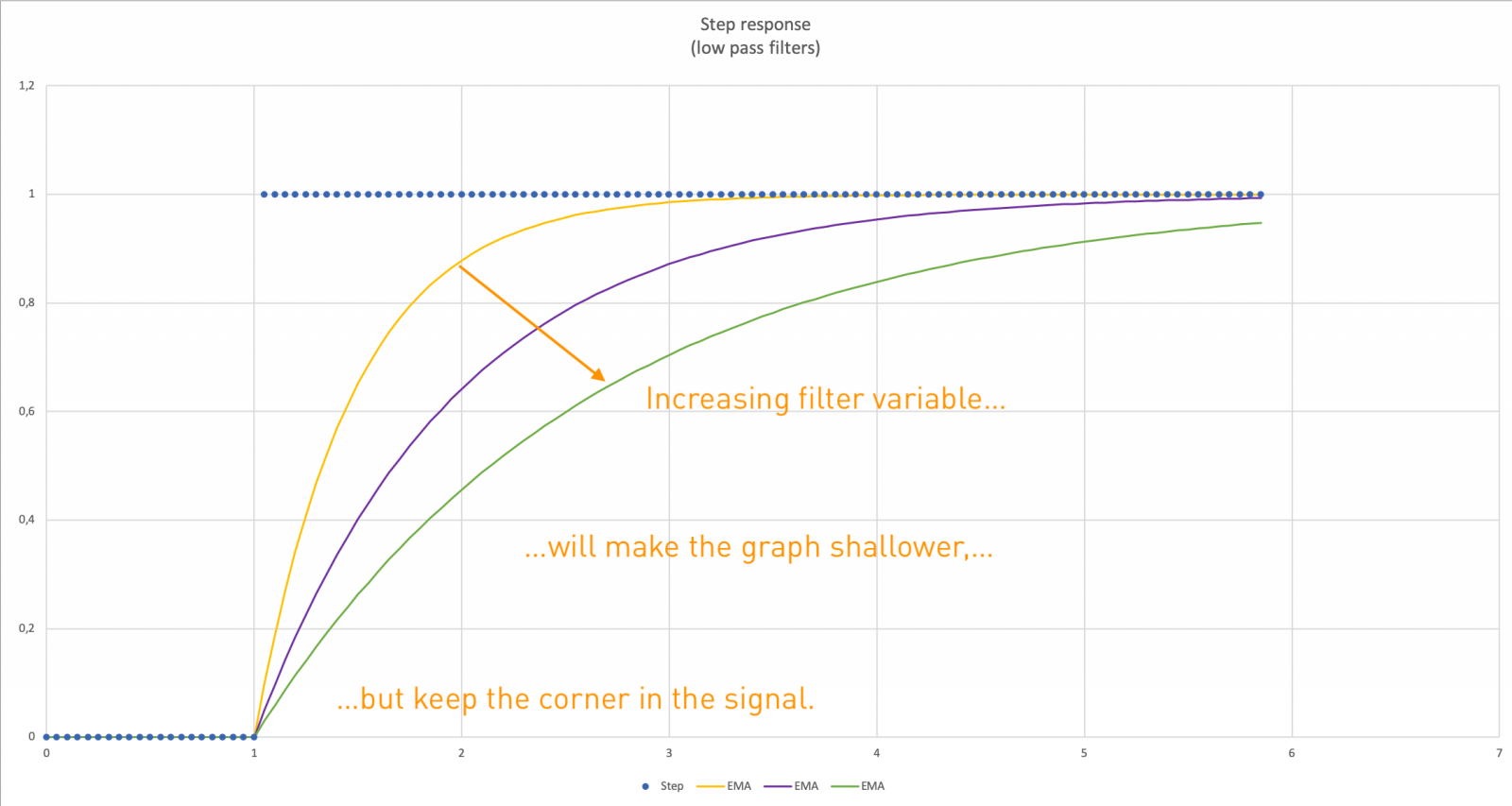

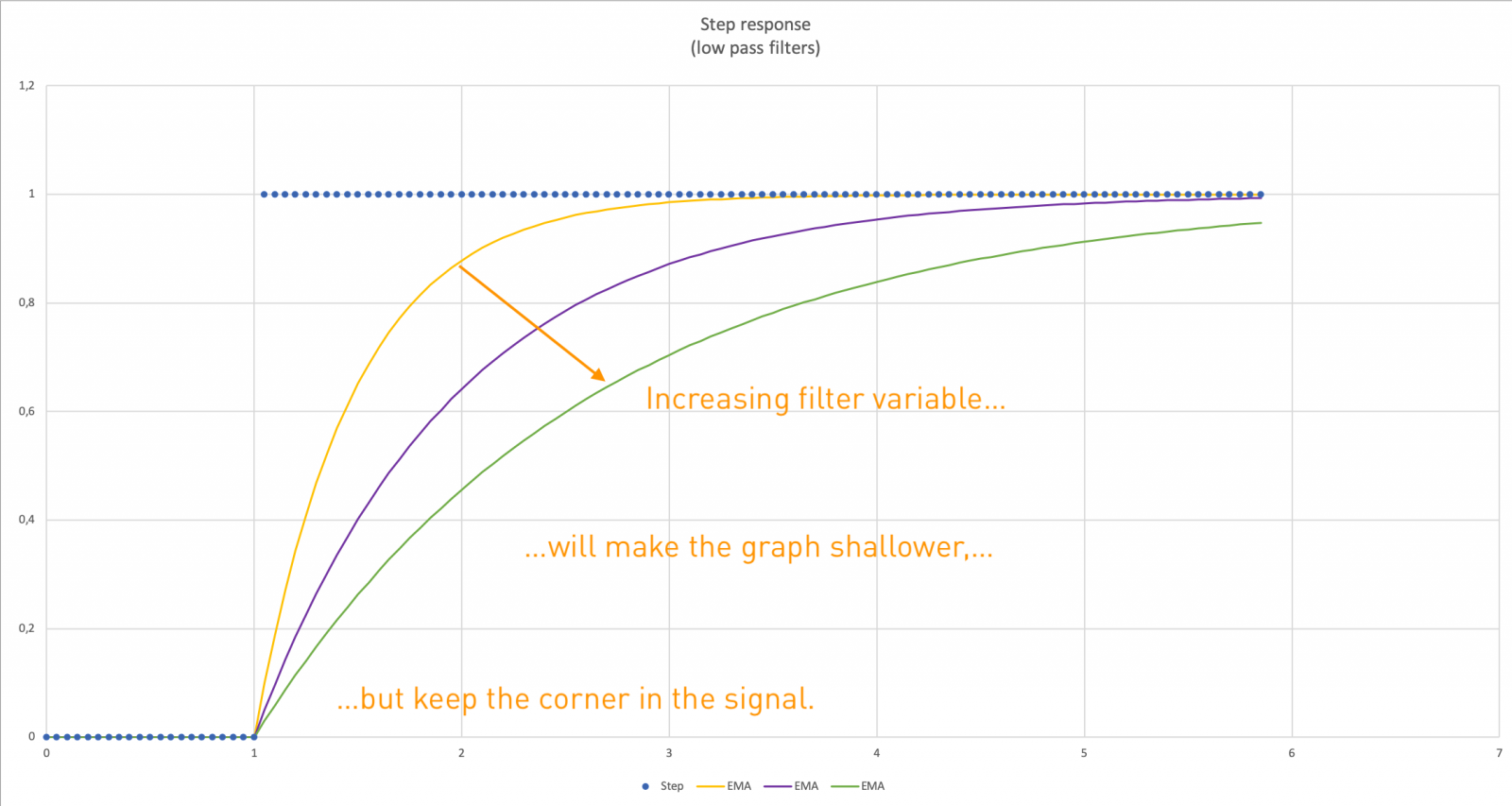

    I know, I'm kinda over-stressing this whole filter thing,.. but just for completeness' sake:
    Dirty :)

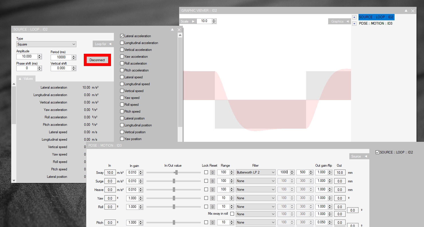

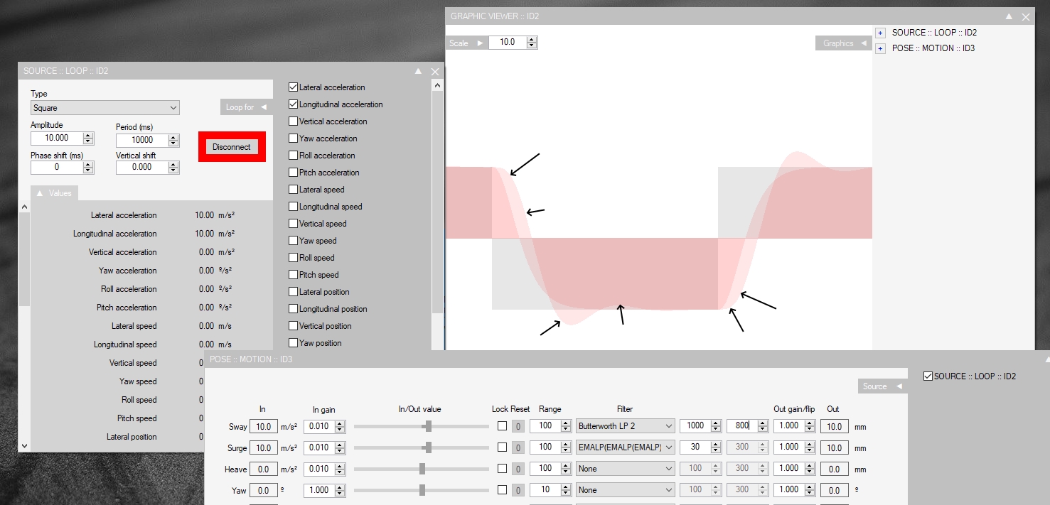

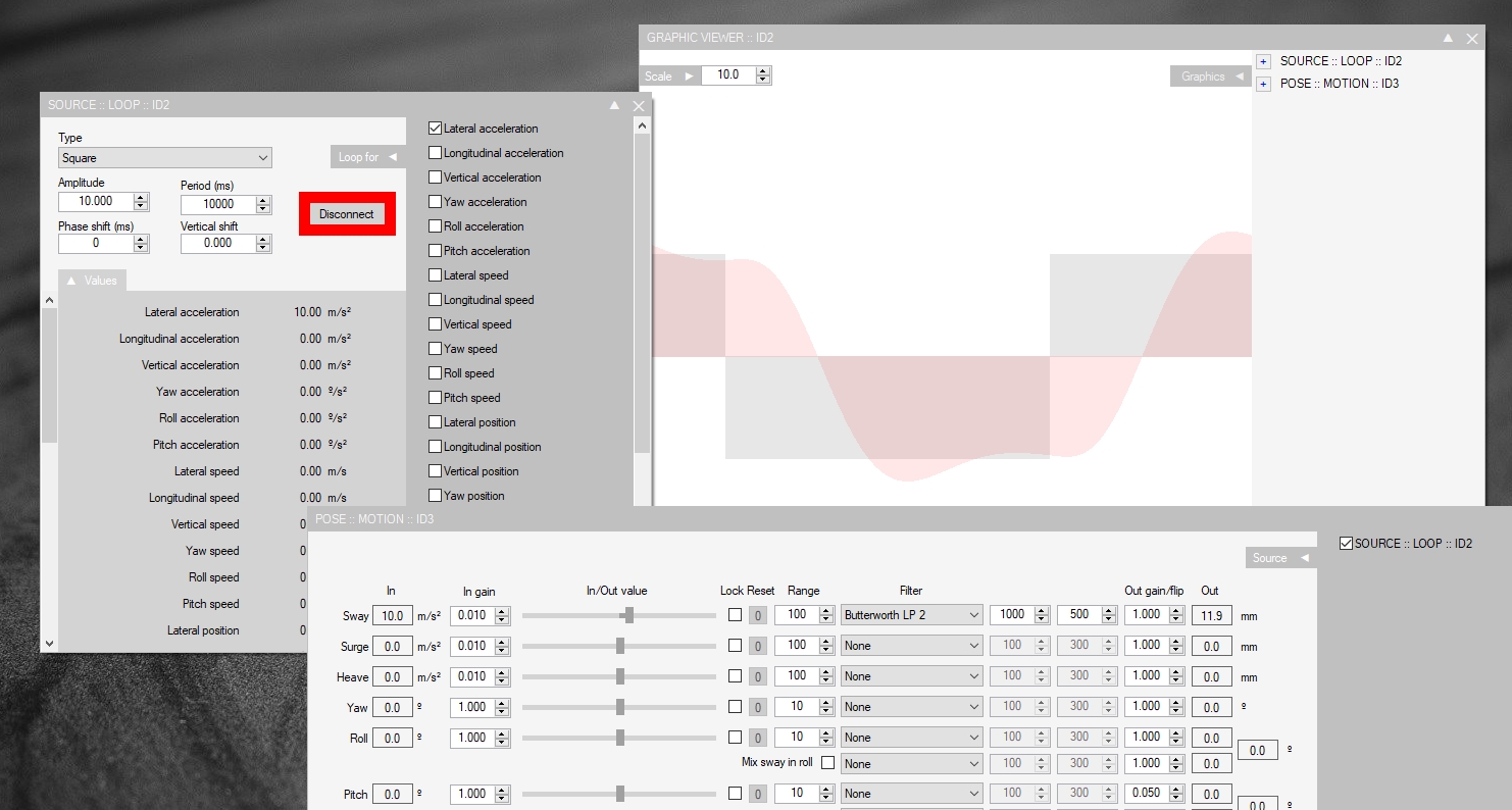

    I'm implementing Butterworth filters, just for testing.
    Not sure if they are better.
    Need to make some speed tests.
    But here's some results in the new program.
    In gray, the signal received. A square wave.
    In red the filtered values.
    Here a result for a 2nd order Butterworth low pass:
    And 4th order Butterworth low pass:
    EMA LP(LP(LP)) vs Butterworth 4th order (arrows for Butterworth):
    Edited: For better clarification...
  11. hexpod
    hexpod http://heXpod.xyz
    Apr 18, 2016
    1,221
    berlin
    7,858Coins
    +377 / 5 / -0
    DC motor, 6DOF
    I am surprised to see the overshoots with your “second order” LPF
    Is it a “simple EMA” or a “double EMA” (DEMA) ?
    Normally, the overshoots comes from a DEMA math. Saying it because I don’t have any overshoots on a “simple EMA” even with second or third order.
    Could you maybe provide a pseudo-code of the math which are in use in your examples ?
  12. pmvcda
    pmvcda aka FlyPT
    Nov 3, 2010
    2,256
    Portugal
    15,806Coins
    +2,701 / 17 / -0
    Overshoot is only for Butterworth, not EMA
    Maybe badly explained.
    Only the last graph has superimposed an EMA LP(LP(LP)) with a 4th order Butterworth.
    And the EMA as no overshoot.

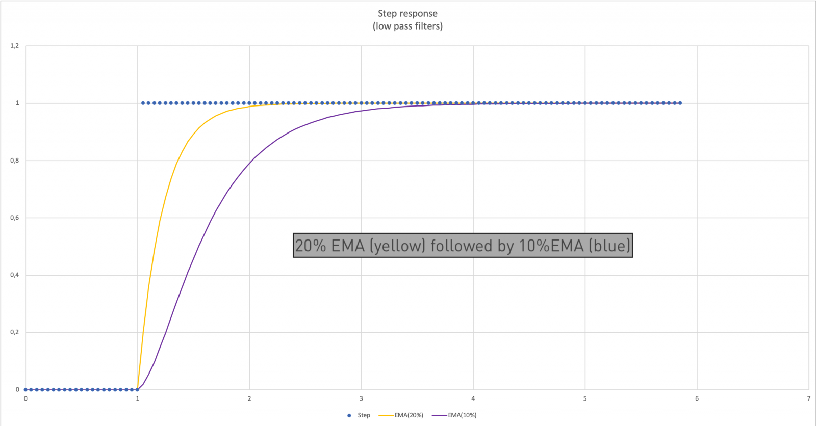

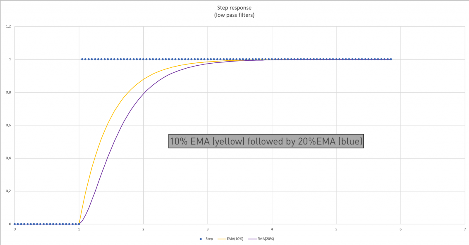

    @Dirty, as you’re very familiar with excel, could you please in your spare time present a graph with two following scenarios:
    1.)
    first order EMA filtered with third order EMA
    2.)
    third order EMA filtered with first order EMA
    I am expecting a quiet different entry and exit curve.
  17. Dirty
    Oct 15, 2017
    746
    All the way up front.
    7,975Coins
    +890 / 3 / -0
    Oh, I am not an expert on filters. Only a "recreational user", so to speak. Maybe @Tim McGuire or @harwoodr can help out here with some background knowledge?
    My arguments:
    I'd be very surprised if there were a difference :). Let's call Ln = Lowpass Filter of n-th order (e.g. L3 = 3rd order Lowpass)
    You want to know if an L1 followed by an L3 is the same as an L3 followed by an L1. So, the question is:
    L1 + L3 = L3 +L1 Is this statement true?
    We already know that... L3 = L1 + L1 + L1 ...because that is how L3 is defined :) So, in the first statement we can substitute the L3 with L1 + L1 + L1 and get...
    L1 + L1 + L1 +L1 + L1 = L1 + L1 + L1 + L1 ...which is obviously true. Therefore...
    L1 + L3 = L3 +L1 must be true as well.
    Or in plain English:
    A third order lowpass filter is the same as three first order lowpass filters in sequence. If you want to add another identical first order lowpass filter, it doesn't make a difference whether you add it before (L1 + L3) or after (L3 + L1).
    Or in plain Math:
    EMAs are commutative! (I think)
    But are they still commutative when they have different filter variables?...
    Let's call L(x) = Lowpass filter with filter variable x (e.g. L(0.2) = 1st order lowpass filter with 20% adoption rate per frame)
    you can switch back and forth between the images to see the difference. The resulting (blue) output line does not only look identical, it actually is the same values. I've done the math, the difference is zero :)
    For all I can say:
    L(a) + L(b) = L(b) + L(a)
    Dirty :)
    Note: In this case "+" is not the addition operator. The filter outputs are not being added. I am not 100% sure, but I think "concatenation" or "convolution" are better terms. Maybe someone can clarify that.

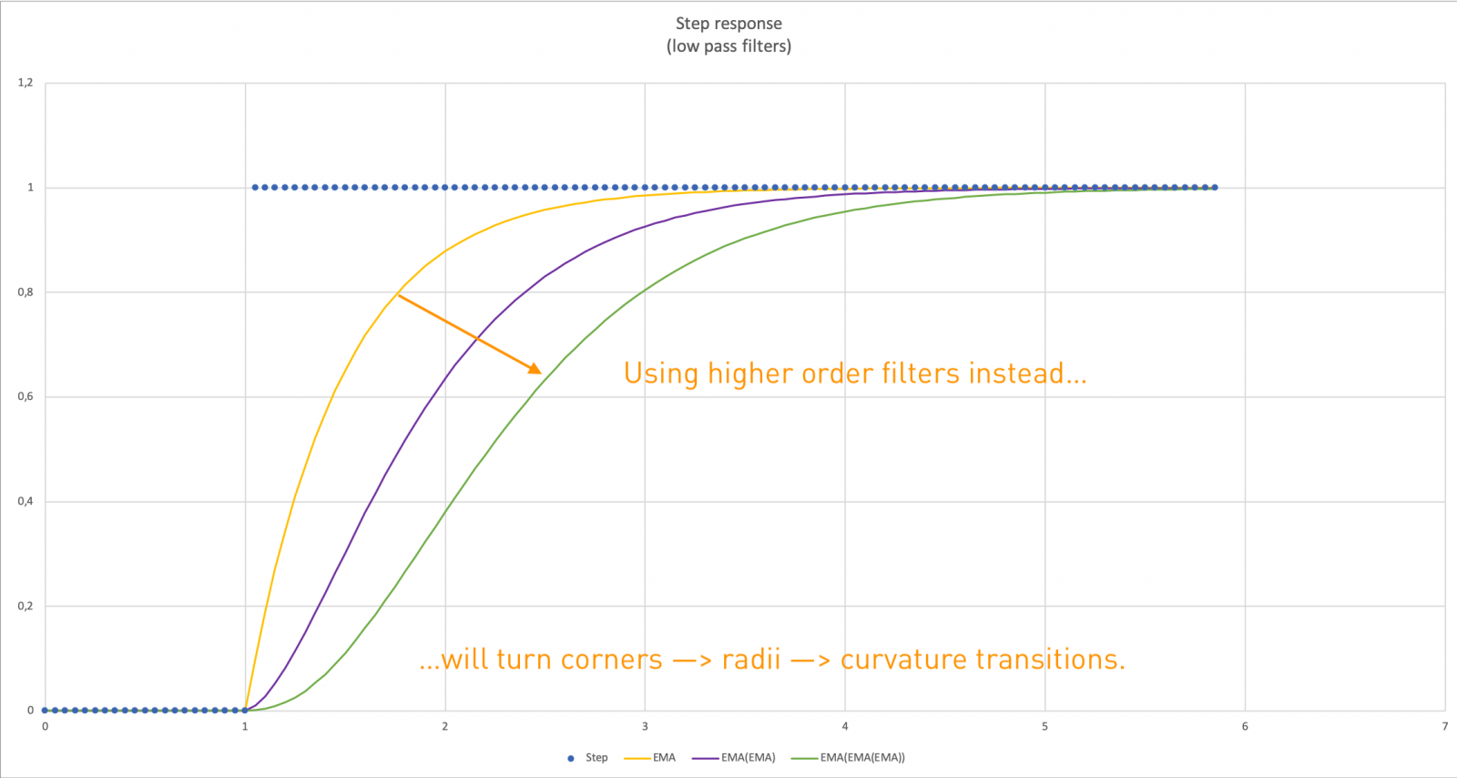

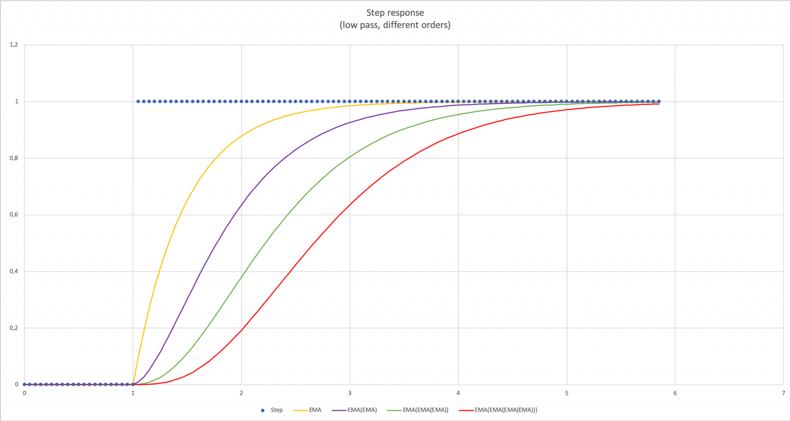

  18. Dirty
    Oct 15, 2017
    746
    7,975Coins
    +890 / 3 / -0
    Oops,....
    You asked for a graph :) Commutativity3.png
    It doesn't make a difference whether you...
    ...take a 1st order filter (yellow) and then three more to reach the 4th order filter (red), or...
    ...take a 3rd order filter (green) and then another 1st order to reach the 4th order filter (red).
    What I learned about filters:
    -You want to turn corners into radii into transitions? --> Increase filter order.
    -You want to "shallow out" the graph and avoid steep gradients? --> Use lower filter variable.
    That pretty much sums it up :)
