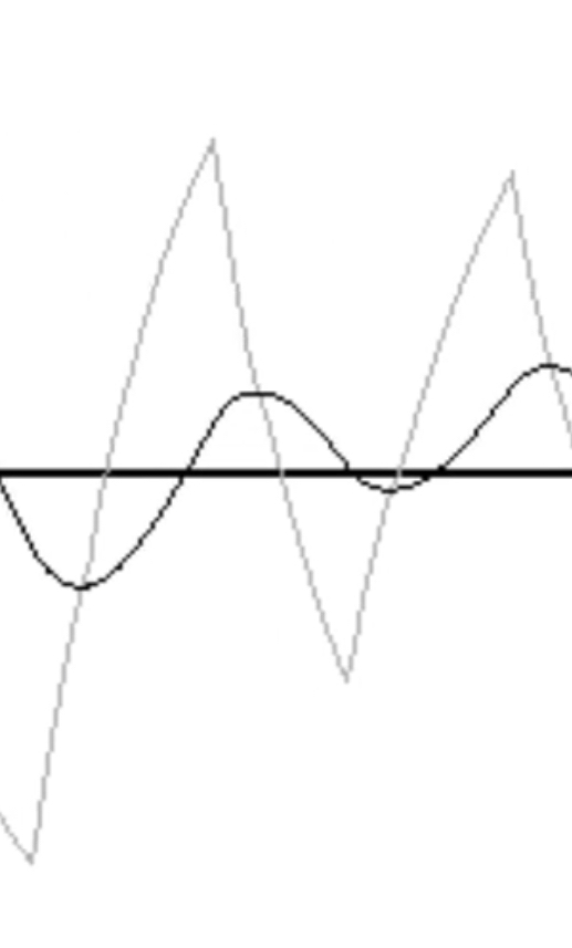

    The previous pictures I posted, are for a situation that doesn't happen while gaming. That sudden change gives those overshoots, but in practice it should not happen that way.
    The Butterworth filter seems to give a "rounder result". But I need time to test.

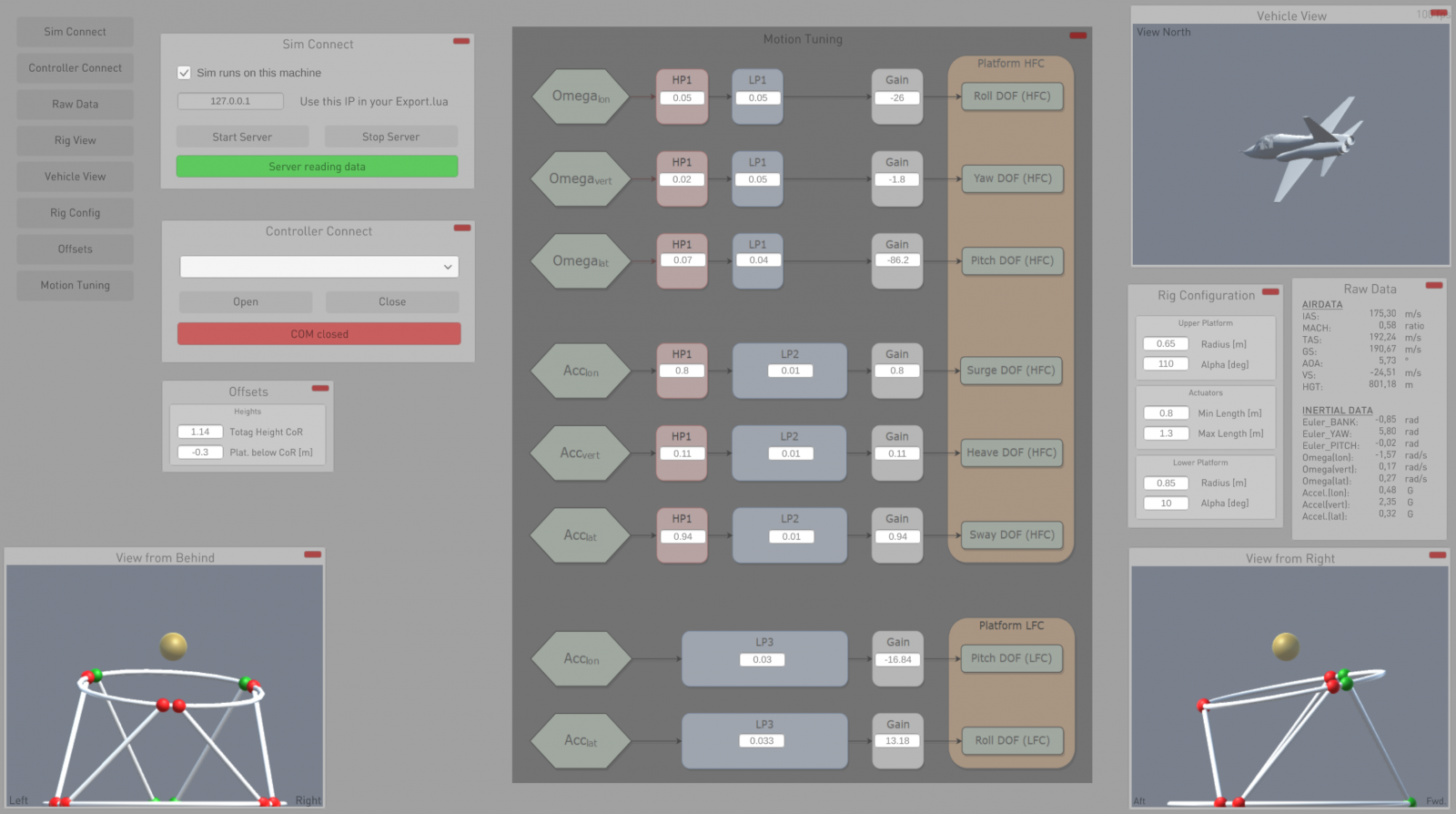

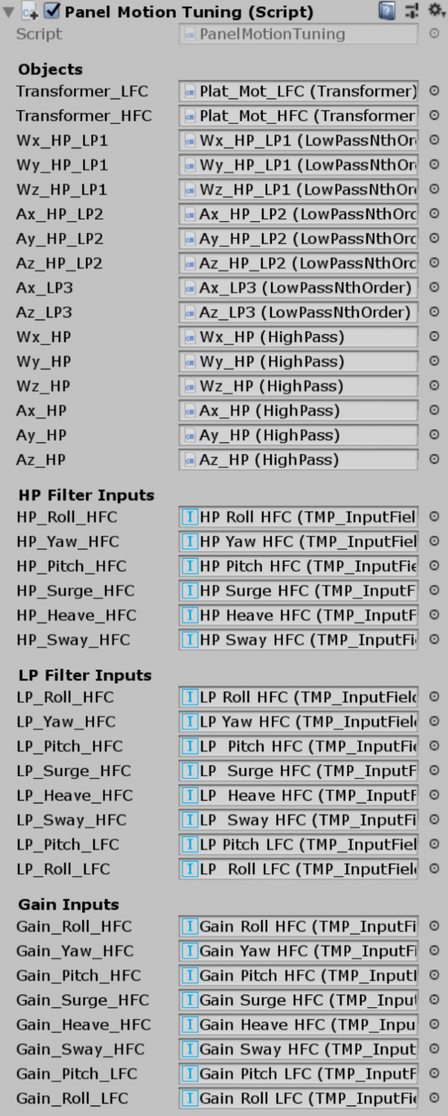

    It gradually starts looking like a software that is actually meant to be used :)
    I wouldn't call it particularly difficult, but it's certainly a challenge to keep track of which signal goes where. With 22 parameters driving 16 objects, there are 352 ways to screw things up:

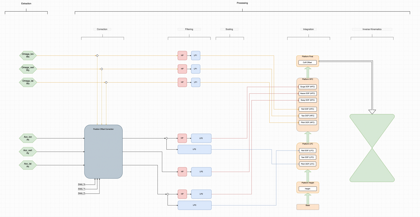

    All in all, just one huge book-keeping task. :)
