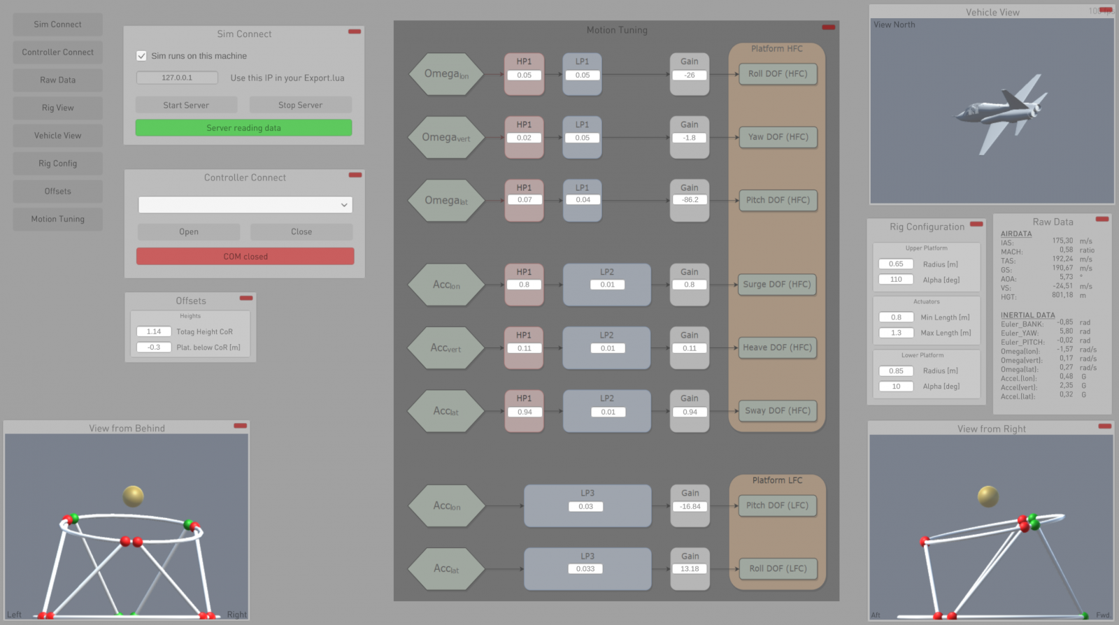

    Sorry - been focused on working on my simulator and writing up a report for it.
    My filters (provided by scipy) let me specify the frequency they operate at - so they expect that any update is within that frequency period. So I have that matching the rate at which simtools sends commands.

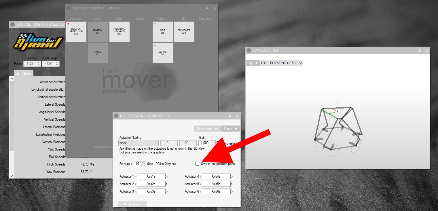

    The FlyPT Interface has it almost from start:
    And the FlyPT Mover already has it. First build almost ready:

    Why I made it?
    In my opinion, normal use should stay inside the limits. But in extreme situations, the ones that happen maybe 10% of the time, it's a shame to suddenly loose any feedback.
    I'm more on the race car sims side.
    We want to keep inside the track. It's smooth. So to feel the small variations, we might want to have a gain that when used outside of the track, goes completely out of limits.
    Now imagine going out of track and the rig stops moving while the car is jumping everywhere.
    That's a simplistic point of view/explanation, but the option is there.
    (note: car sims don't need huge amounts of movement to feel good. They need fast reactions and low lag)
    Another feature I incorporated is the auto gain. What that makes is decrease gain (in actuators) each time the rig goes out of range.
    That's a feature to help adjusting the rig like the above example.
    You start with a gain of 5 and check auto gain (if you make it, you don't need to connect the rig. It's better not, because gain of 5 is huge and with fast dislocations. To use the rig, start with a gain of 1.5 or 2.0).
    The actuators start going out of range and the gain decreases.
    You make some laps on the track, without going out of the track and without collisions.
    After those laps, the gain might be stable at 0.95 for example.
    Now, let's disable auto gain.
    What might happen is that each time you go out of track, the rig can go out of range, but you maximised the feeling while you are in the track, making what really matters.
    Maybe we can compare this to a comercial air plane vs acrobatics. In those cases, gain could be completely different, because the "range" of use is completely different.
    It's like having more or less detail.
    I like to compare this to the wheels FFB. Less range of effects represented, with more strength, but saturating really fast or more range but with less strength.
    In a comercial air plane, I think we want to feel the small details, while in combat/acrobatics, that's a fast action, more violent and less detailed. (apointner is not completely out of reason... It's preferences)
    In my case, I always allow the rig to go outside of range (not actuator outside of range). I'm warned by the interface and if I find it necessary, I can adjust the settings.
    And as I said, auto gain, is a tool to work on it and help define the 10% value I spoke above. Do you want 10%, 50% or 0% of out of range situations? It's up to the user to decide.
    An alert, using just auto gain and no filters, is completely wrong.
    For example, yaw in a car around a track, goes from -180 to 180º. If we don't use a filter for yaw, the rig is out of range most of the time, and you end with a gain of zero and no movement.
    This is a good example of why we need filters. We want to represent full rotations in a rig range of maybe 15º.
