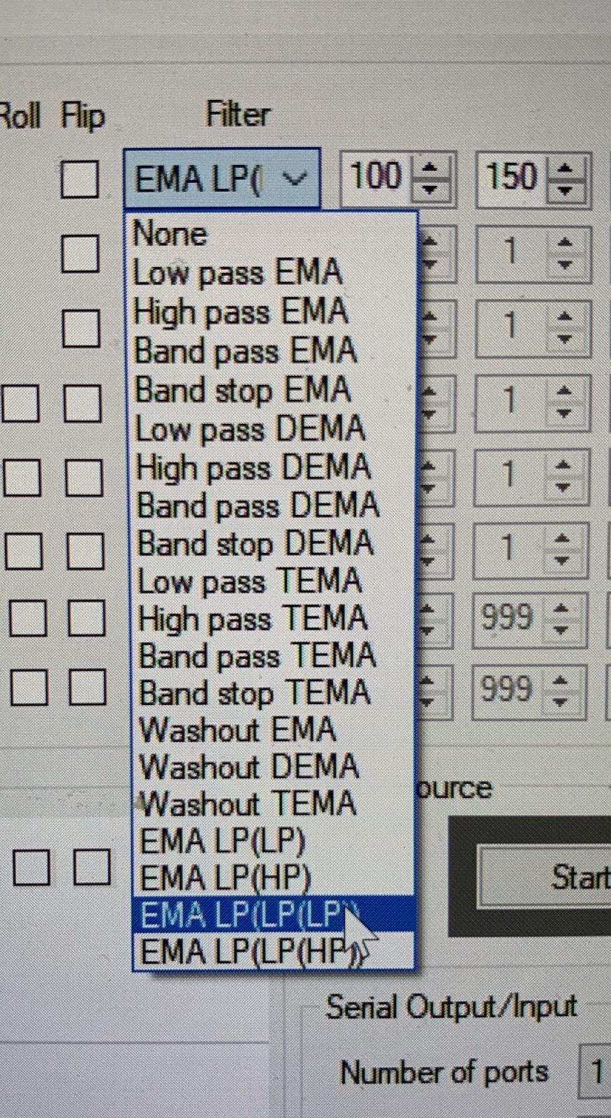

    Ok, I don't know the terminology so when I saw filters like LP(LP)(LP) and LP(LP)(HP) I thought that was the third order filters you guys had been discussing. Anyway those I listed seem like they are going to work very well. I was able to achieve a ramp that looked gradual enough but once it gets going looks like it should still be fast enough. I haven't got far enough yet to know for sure.
    I found I have to use the one that ends in HP in order to have the cue wash out but I'm flying blind her just experimenting to figure out what the different options and values seem to do.

    DC motor, 6DOF
    Ok added on the 1.8.7
    Fourth from the bottom = second order EMA
    Second from the bottom = third order EMA
    I got it. Very good addition !
  5. Trip Rodriguez
    Trip Rodriguez VR Pilot
    May 8, 2016
    683
    Lake Ariel, Pennsylvania
    3,978Coins
    +331 / 7 / -0
    Hey, I was accidentally correct!
    As I said though, as near as I have been able to figure out if I use third order LP(LP(LP)) I can't get the cues to wash out so I have to use the LP(LP(HP))
  6. pmvcda
    pmvcda aka FlyPT
    Nov 3, 2010
    2,280
    Portugal
    15,950Coins
    +2,733 / 18 / -0
    Yes, you need a high pass to generate washout.

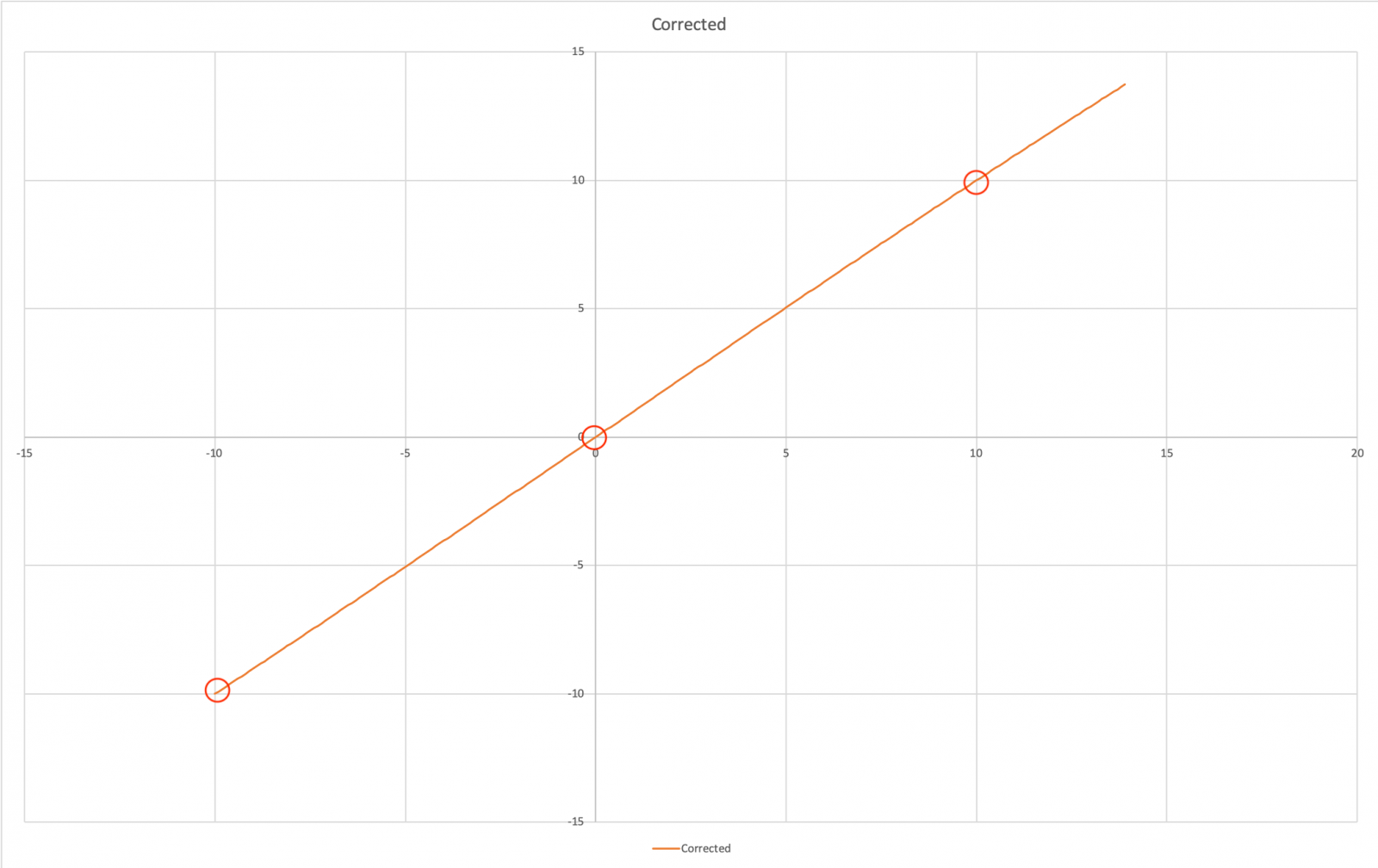

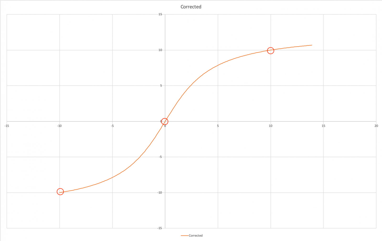

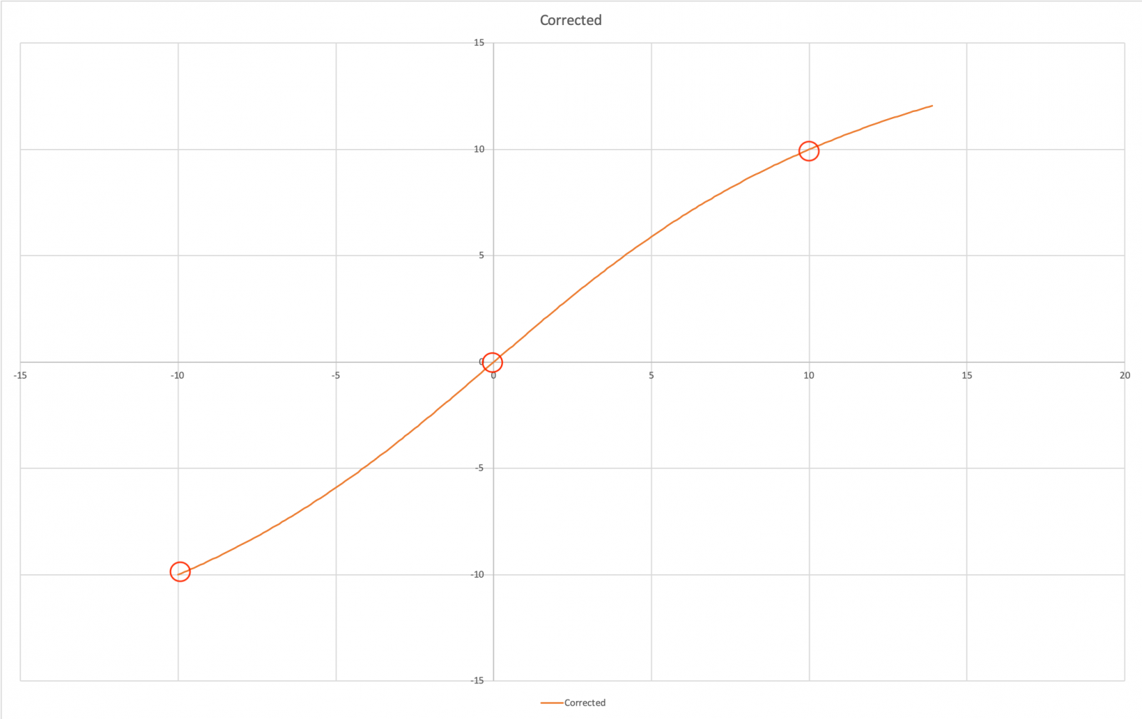

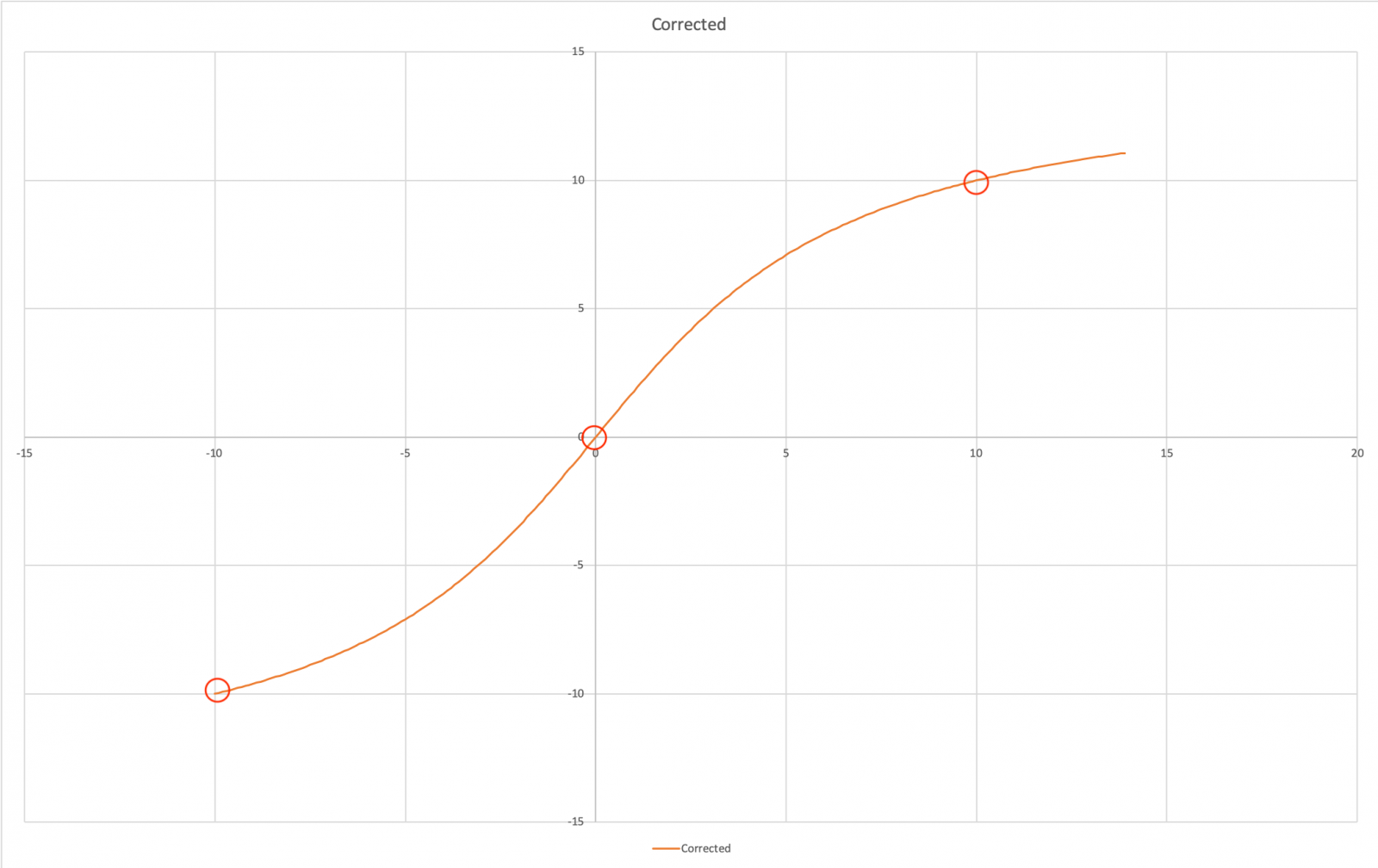

  16. Dirty
    Oct 15, 2017
    746
    All the way up front.
    7,978Coins
    +890 / 3 / -0
    Technically, that would be a somewhat correct approximation as long as we are only talking about small angles. I think up to 10° maybe.
  17. Dirty
    Oct 15, 2017
    746
    7,978Coins
    +890 / 3 / -0
    I am undecided if I will implement something like this. You are right, the response of the rig would be non linear. That's the down side. On the upside you could pretty much get rid of clipping completely. Using the right function, you could keep a little bit of responsiveness no matter how close to the limit you get.
    I have played around with an ArcTAN function and got some nice results.
    ...the interesting point here is that you don't even specify a "limit" in the classical sense, but instead three points that are represented unaltered by the filter, and a compression coefficient (CC). The pictures show...
    CC = 0,1
    CC = 1
    CC = 2
    CC = 3
    Such a filter would increase responsiveness for small input values and decrease responsiveness for bigger values. I has the potential to address the issue that @Trip Rodriguez mentioned where his rig shows very little response in normal flight, and way too much during braking.
    On the question of where in the processing chain to apply those filters (if at all) I am just as clueless as you guys. Input-level, DOF-Level or Actuator-level...? No Idea!
    Dirty :)

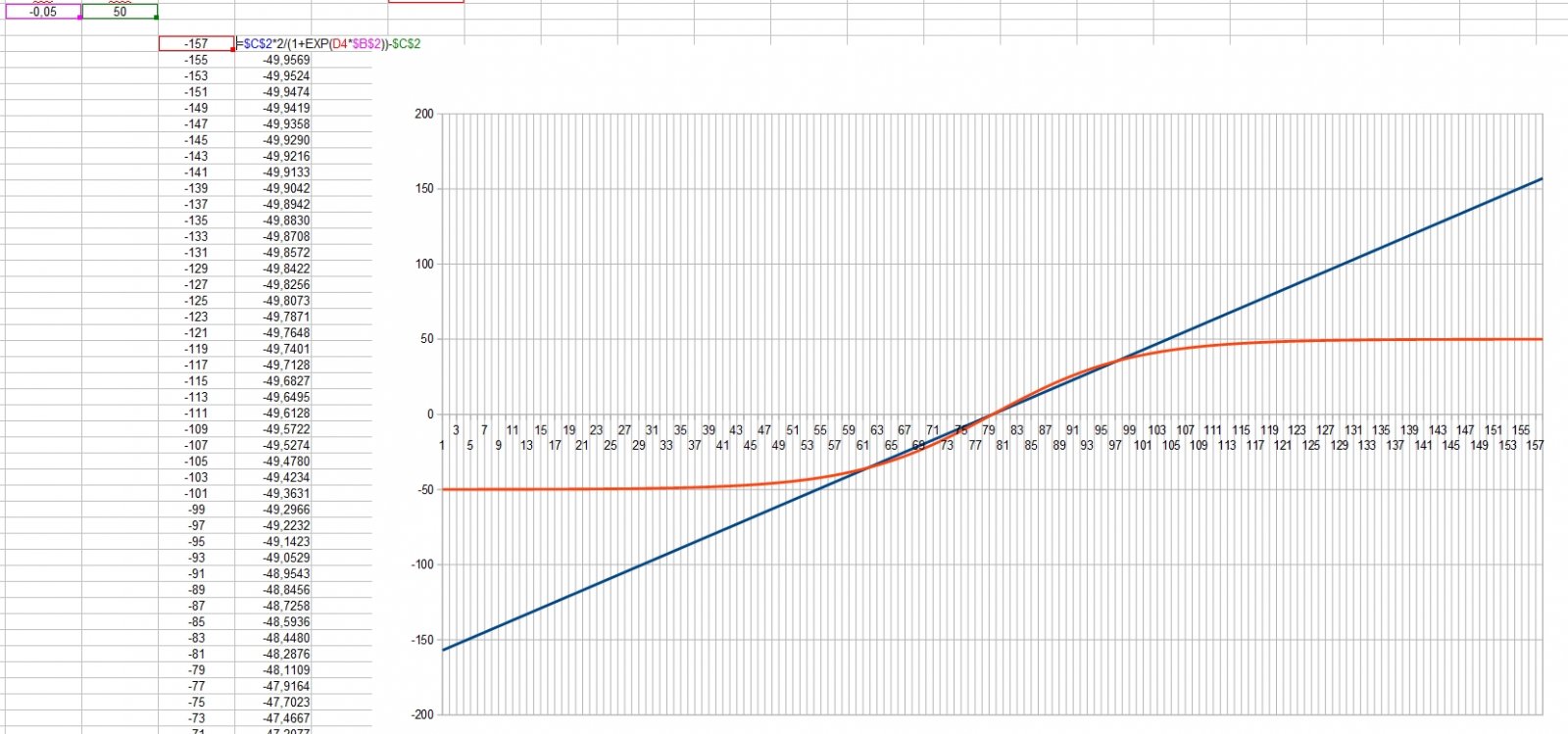

  19. pmvcda
    pmvcda aka FlyPT
    Nov 3, 2010
    2,280
    Portugal
    15,950Coins
    +2,733 / 18 / -0
    I was looking at it with logistic functions.
    Just to avoid the atan.
    But exponents might be equal in speed.
    A test I made in a spreadsheet: (you can see the formula) (between -50 to 50)
