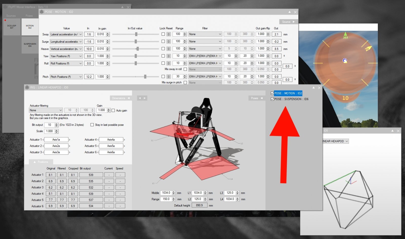

    What I'm doing to solve the flight vs track feel:
    What you see there, is motion generated from one source, but from different data.
    From motion (accelerations/rolls, whatever we have been discussing) and another one from suspension.
    You see 4 wheels there, but two in front are the same.
    Problem now is that some air planes have one wheel at front, others at rear... There's always something.
    And it works. When you lift off, there's no more wheel feedback.
    The two motions are added in the rig (look at right):

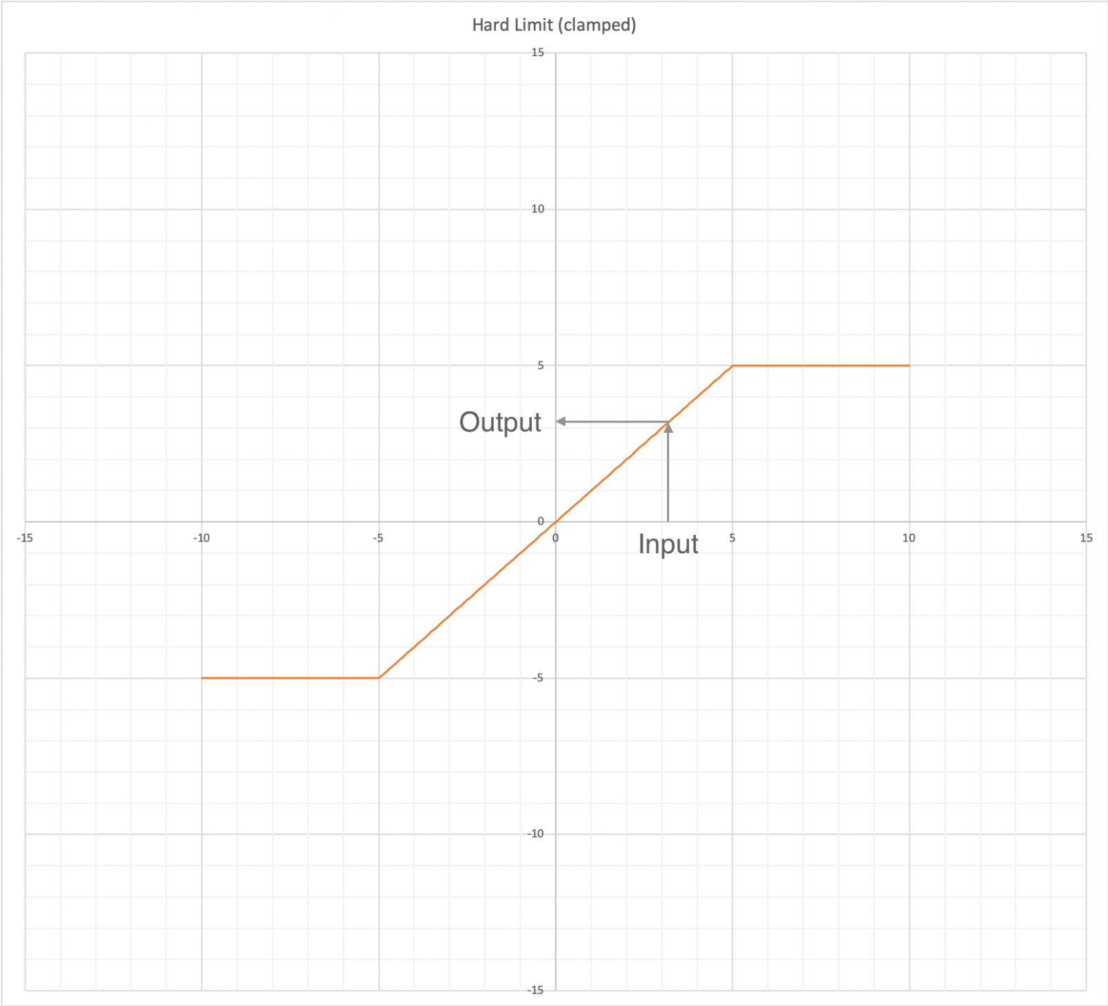

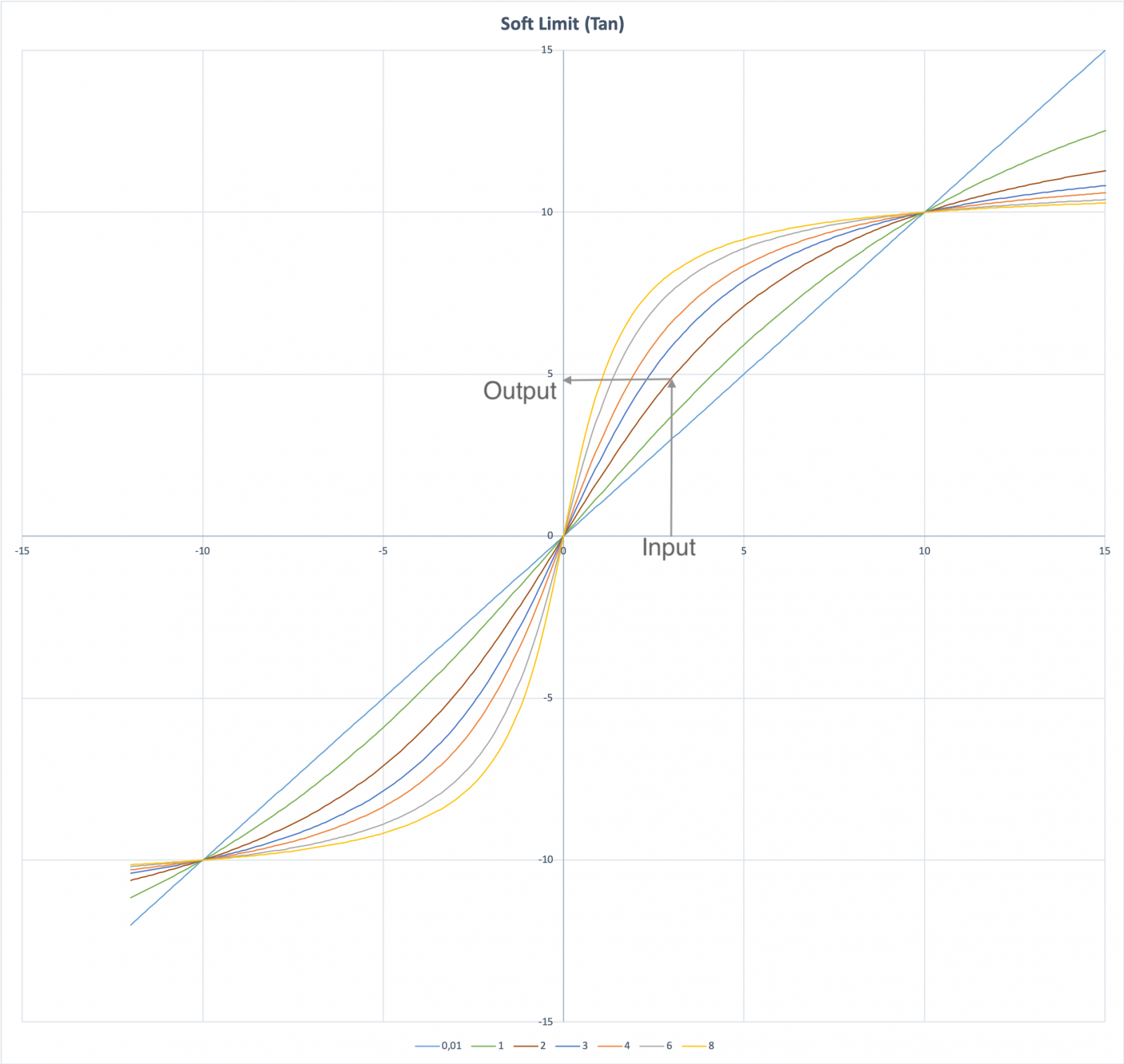

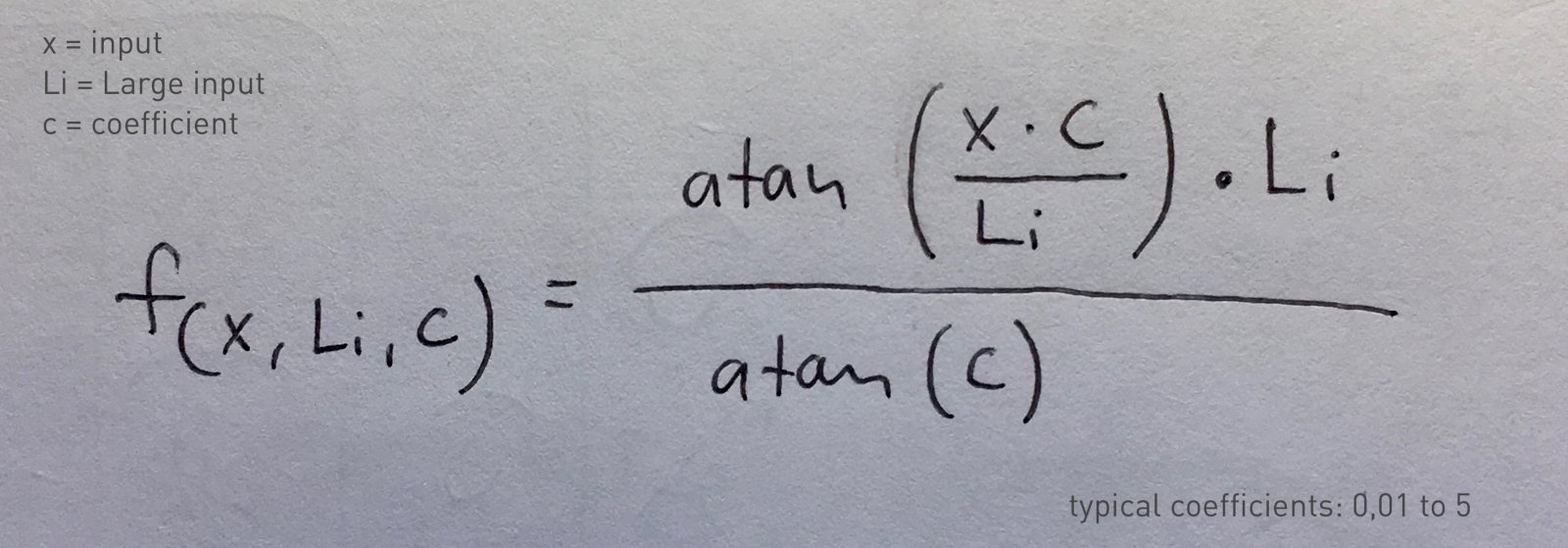

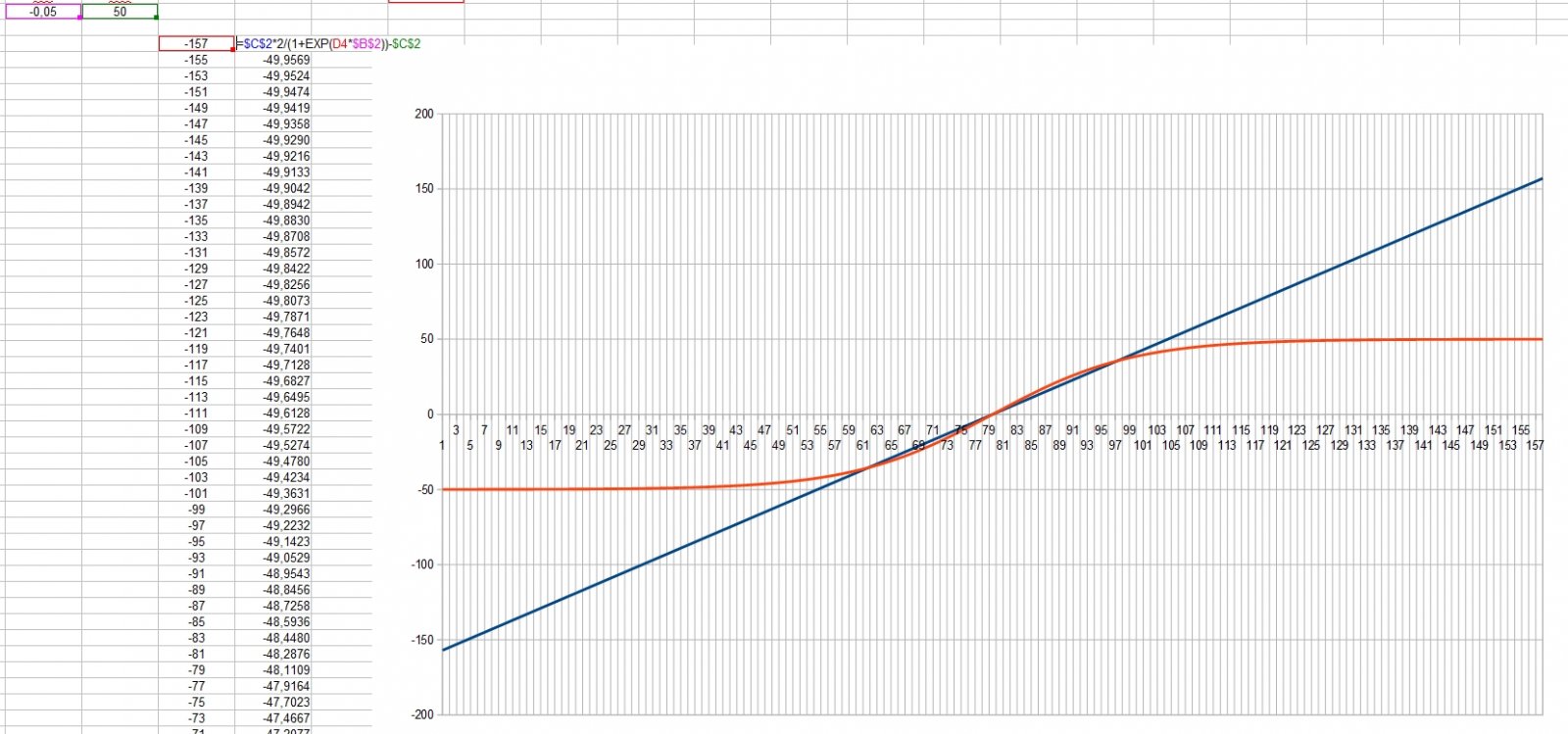

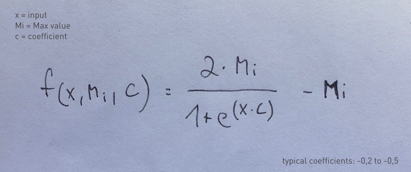

    Took some time to wrap my head around this formula :) but I think I got it. Might not be of high importance to casual users, but for @pmvcda or @yobuddy it might be interesting to understand where the differences lie:
    Hard limit:
    self explanatory, I guess.
    Soft limit using an ArcTan function:
    My choice, mainly because it allows you to use coefficients to blend this behaviour in and out. Small coefficients will fade the curve over to a simple Output = Input shape (unscaled linear, blue line).

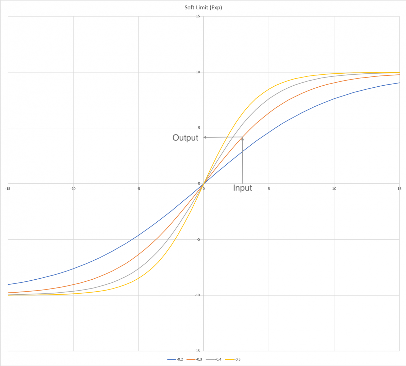

    Soft limit using an exponential function:
    Gives nice curves, for sure. And it has the advantage that in this function the limit is truly a limit: The function will never exceed this value, just get closer and closer to it. There is one downside to it: If you want to have a pretty much linear behaviour and only add a "grain of curviness" to it, this function is a bit problematic :) because small coefficients will blend the curve over to a flat line. I have an idea of how to tweak this into the right shape, but then it would loose it's truly limiting property. :)
    Bottom line:
    Both work when done right :)
    ...would anyone know if an ArcTan or an e-function is computationally more efficient to calculate?

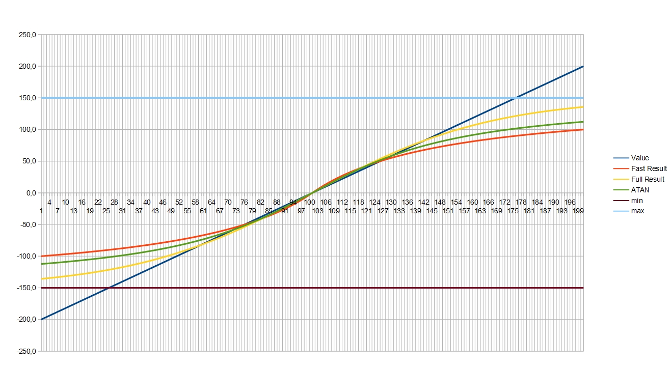

    There's a good approximation to a sigmoid (logistic) that is faster to calculate (red):
    Output = range*Value*alpha/(1+Math.Abs(Value*alpha))
    But the one that is close to the linear values and curves near the extremities is the pure logistic (yellow):
    I don't like them much. I think we can get something better and faster... some more thinking needed

    I am not sure how to call this decreasing curve. Maybe « logistic growth » is the right therminology.
    I am looking forward to try out this math on the dofs.
    It might help us to stay inside the workspace. It definitely worth to be tested.
    Concerning this kind of limiter on the actuator level, maybe I was wrong assuming that it could work.
    As the “out or reach” doesn’t seems to be related to the position of the lever, it might be impossible to predict it you don’t use the lever’s “range” limiter.

    I already though of adding this formula as a filter for testing (on each pose component, see the FlyPT interface thread).
    But you have to take into account that for example the range of sway is not constant, just changing heave changes the sway range and I'm probably (or maybe not) going to use range as a parameter for the logistic function.
    In the actuators, the formula needs to be straight or we are going to have to much variations on the cues.
    Curvature to the limit needs to be close to the limit to reduce the error.
    Honestly, I don't know if it's worth. But we can try.
