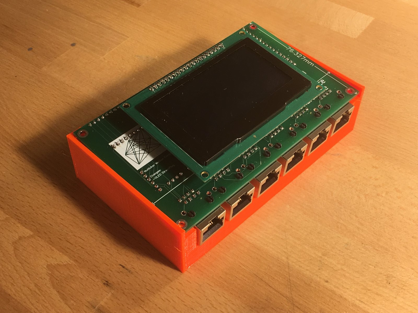

    Hey guys, :)
    maybe someone (@Thanos? @pmvcda? @Trip Rodriguez? ...or anyone else with am AMC1280?) can help me with this. I would like to support the AMC1280 in my software, but I am not sure if the bytes are being transmitted correctly, since this is the first time I am ever sending bytes directly. I own an AMC 1280, but I am not seeing any reaction from it. To be honest I don't even know where to look for one :confused:
    Up until now, I have used my own controller...
    ...made from a custom PCB and cheap components from Adafruit. I will also publish it open source once I got to do some testing. Still I would like to keep it compatible with the AMC1280's data format, because I think I might eventually switch over to the (way more advanced!) AMC1280.

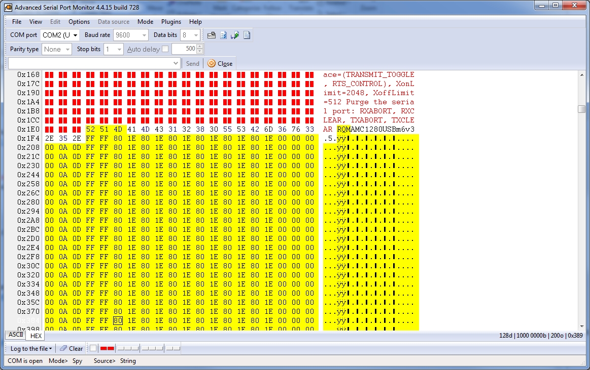

    See a capture of what the normal data the AMC should see...
    (By sending "RQM" to the AMC, you should see it respond with its firmware version "AMC1280USBm6v3.5")

    Ahrggh.... Yes, of course!!!
    God, how could I have been so stupid!?! Sometimes I wonder how they can let me fly planes... :confused:
    I changed the code, rebuilt the executable, but did not push the commit to the Github page! :blush It's updated now.
    I looked at it in a serial monitor and now I see the 20 bytes starting with "FF FF" and ending with "0A 0D".
    Could you try again? Or could you tell me where to look to see if the AMC1280 receives the data properly? I was hoping I'd see some numbers change in the display, or some bar graph dance up and down, but I see nothing.
    Could you check? That would be a tremendous help.

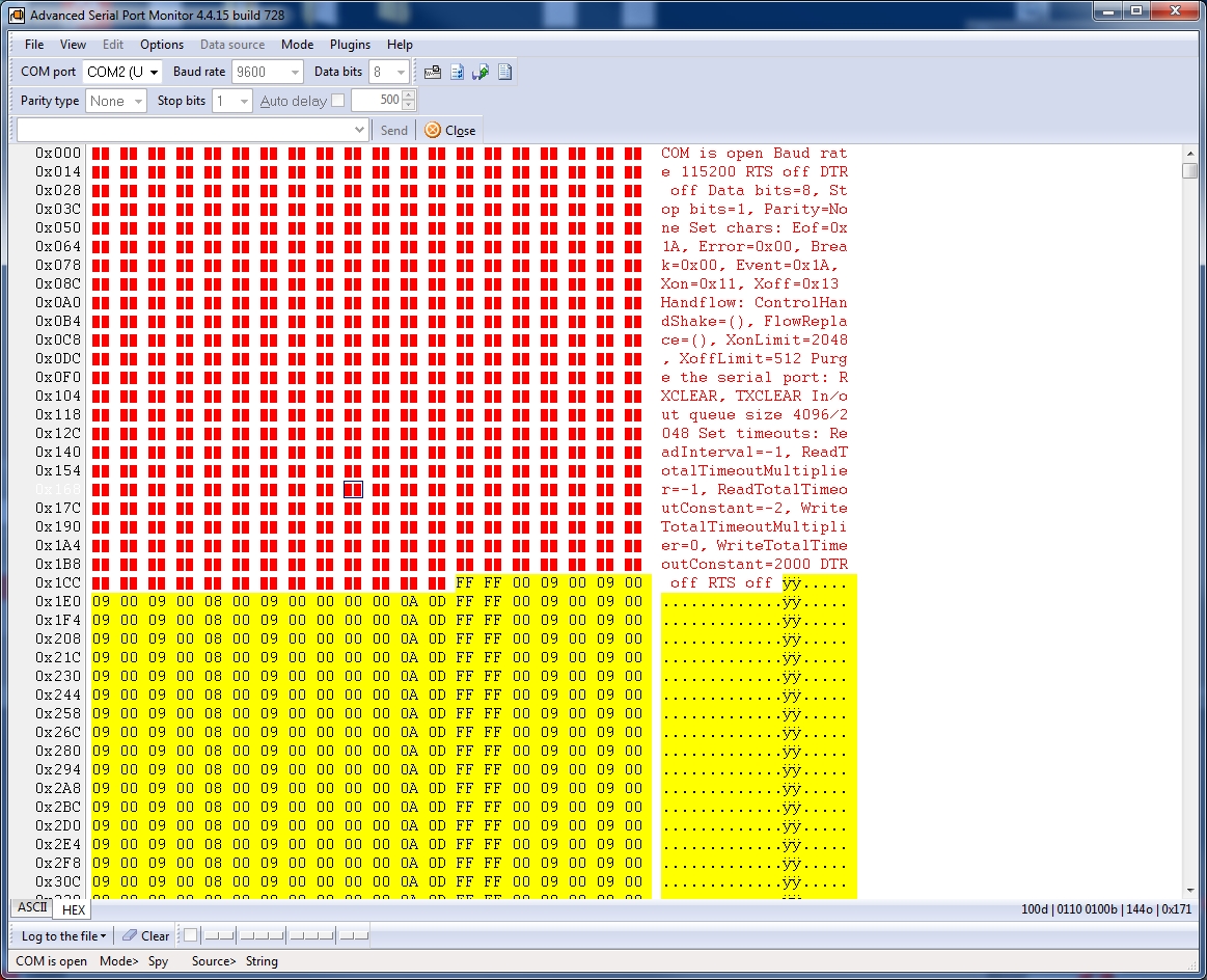

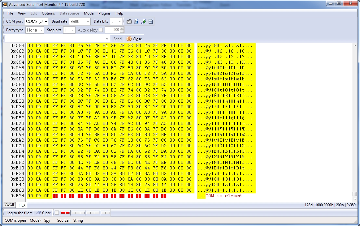

  7. Thanos
    Jul 6, 2017
    1,380
    Electronics Engineer
    United States
    2,925Coins
    +1,080 / 10 / -0
    I checked again. Now the COM port opens partially, See some data going through, but only 115kbps speed... The AMC needs 250000 baud rate.
    "COM is open Baud rate 115200 RTS off DTR off Data bits=8, Stop bits=1, Parity=None "

  8. Dirty
    Oct 15, 2017
    746
    All the way up front.
    7,981Coins
    +890 / 3 / -0
    OK,
    Thanks A LOT. :thumbs
    I will try again tomorrow with 250000 baud. I thought it would work with any baud rate up to 250k. Didn't know it needed exactly that.
    Thanks for the help.

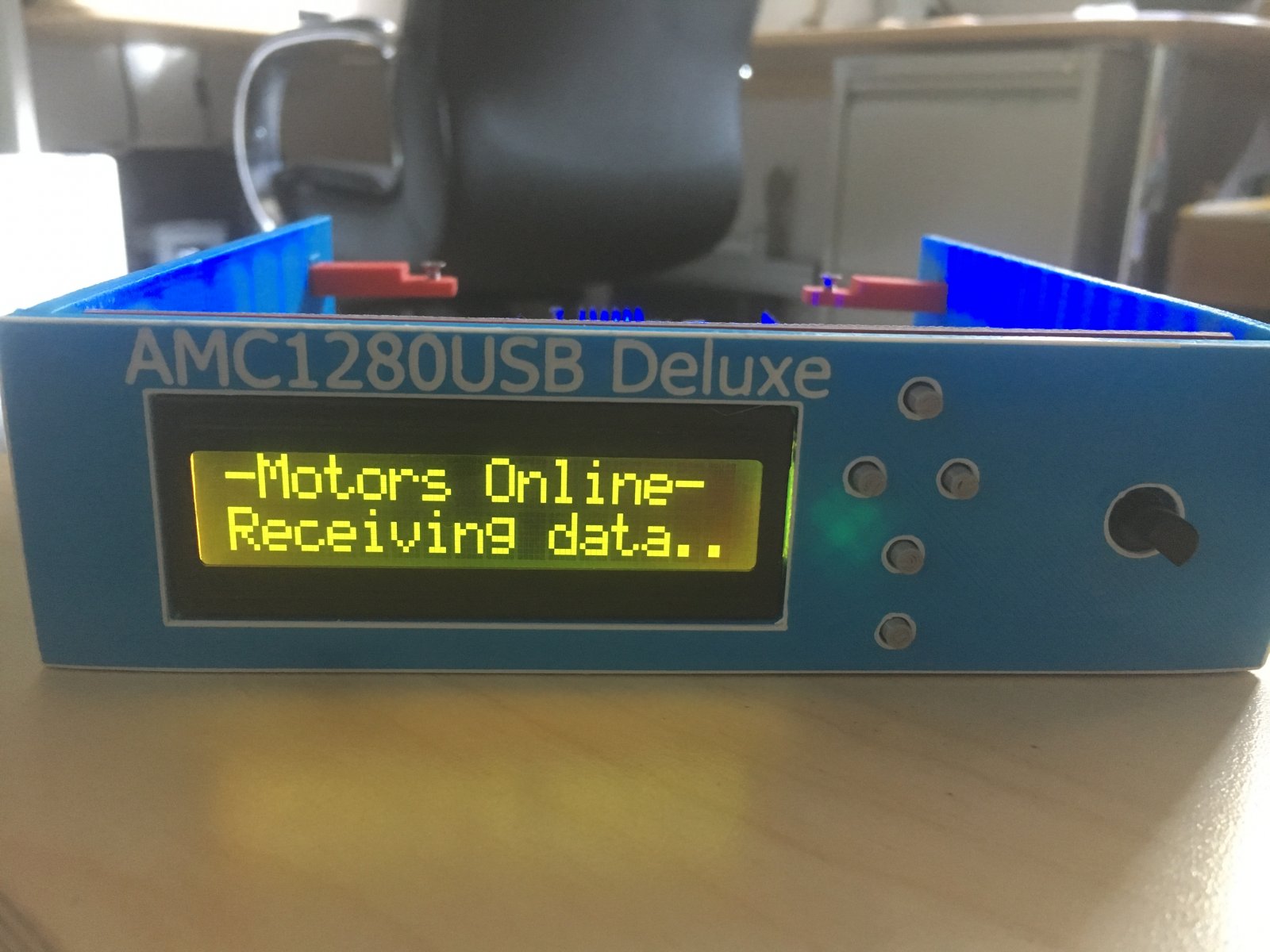

  13. Dirty
    Oct 15, 2017
    746
    7,981Coins
    +890 / 3 / -0
    Thank you very much, @Trip Rodriguez
    in "Park" it should send a value of almost 0% , in "Pause" it should send a value close to 50%
    What I'm getting is this:
    ..so it appears that changing the Baud rate to 250k helped. Does that screen mean everything is OK?
    Strangely I am not getting anything other than that screen. Is that normal? Isn't there supposed to be some numbers representing the target values? If I press some buttons, eventually the screen will go blank. Is that normal too? @Thanos , can you take the time to take another look at this?

  14. Thanos
    Jul 6, 2017
    1,380
    United States
    2,925Coins
    +1,080 / 10 / -0
    Yes, this screen is normal. I disable the LCD updated during normal operation with motion cues, to get the max performance out of the controller.
    I'll try the new version soon. Thanks

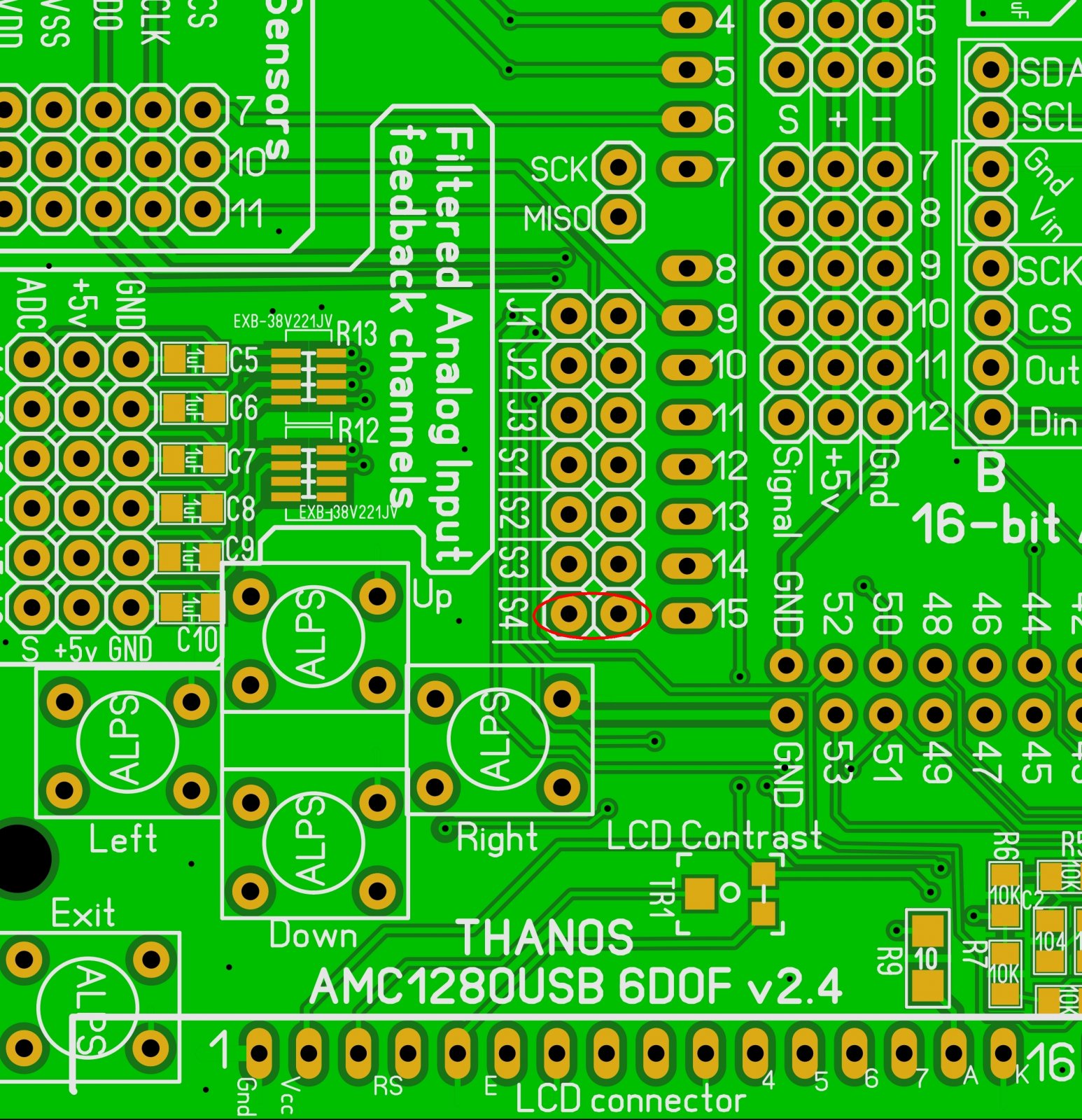

    You can actually place a jumper on the S4 on the AMC board and will force to keep the bars on the screen while connected to motion software. Also you can push the encoder button while on bars screen to switch to display percent numbers on the display for the position of each axis...
