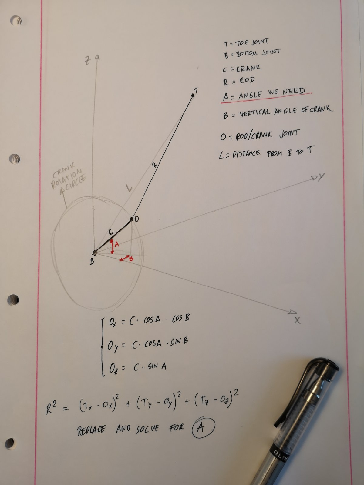

    So how do I make the calculation (this method works when the motor shafts are horizontal):
    This was the image I posted:
    Can't find it also... It's buried somewhere.
    So...
    In black:
    Point B (origin) is the intersection between the crank and the motor shaft. It's a solid connection. Like I said above, it's the bottom joint.
    O is the joint that connects the crank to the rod and she can rotate in any direction.
    T is the joint in the top moving platform.
    C is the crank length.
    R is the rod length.
    In gray:
    The 3 axis (x,y,z) with x and y defining the horizontal plane.
    The circle that represents the rotation of the crank.
    L is the distance between the bottom joint (origin) and the joint on the moving platform (T). That's where we would have a linear actuator.
    In red:
    A is the angle of the crank relative to the horizontal plane (what we want to calculate)
    B is the angle defined by the intersection of the horizontal plane with the plane where we have the crank rotating.
    So to define this we need...
    Fixed values:
    R = Rod length
    C = Crank length
    B = Angle of the motor axis + 90º around the z axis (90º, because crank is perpendicular to the motor axis)
    Constraints:
    Motor axis must belong to the horizontal plane
    Variables:
    L, the distance between the bottom and the top joint
    As we see in the image, we can calculate the point O with the system of equations I show.
    The the distance from O to T would be defined by the equation bellow.
    Replacing Ox, Oy and Oz and solving for A gives you more than one solution.
    Since I'm "lazy", I used this: https://www.wolframalpha.com/input/?i=solve+for+a+{r^2=(x-c*cos(a)cos(b))^2+(y-c+cos(a)sin(b))^2+(z-c+sin(a))^2}
    The solutions can be ignored and we just use the 3rd one.
    I don't remember now, but I took a look at all solutions and concluded that 3rd and 4th can be used without problems if crank and rod are more than zero. (not 100% sure. Would have to look again)

    Holy smoke,...
    Yes, that was the picture I remembered. Thank you very much. Quite a lot to chew on. But I'm sure it will save me a lot of time.
    The first question (of potentially many to follow) would be: Is B the center of the circle/disk described by O? Or better: Does B lay in the plane described by the rotating position O?
    The reason I'm asking is, I think it would make sense if it was, but then the (red) angle B would have to be zero.
    I will need a little time to digest this, I guess. :)
    Thanks a lot! Btw, super cool of you to share code! I really owe you for that.
    Dirty :)

    It was a bad choice of letters... But that was the drawing.
    B is the origin and center of the circle.
    Angle B is the the...
    If we look at the rig from the top, the circle defined by the rotation of the rod/crank joint that has it's center in point B, makes the angle B around axis z
    Hope it's clear...

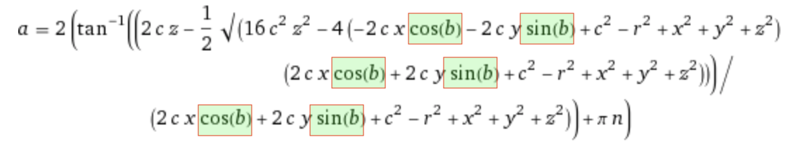

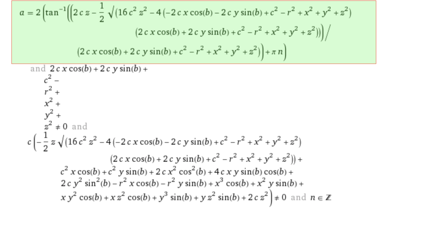

    Hey @pmvcda,

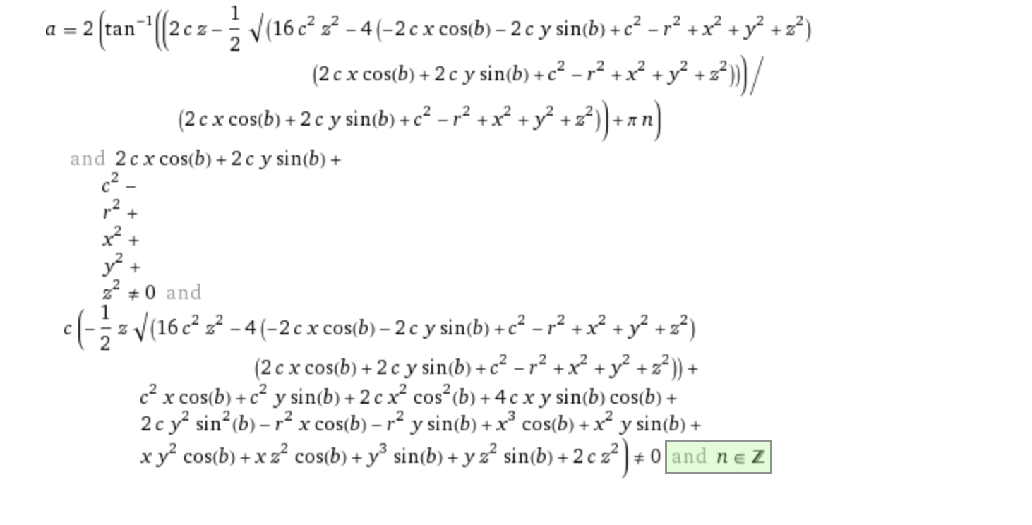

    I think I understood the geometry.
    And I think I understood the math up until here:
    So you can calculate angle "a" (in radians?) with this formula:

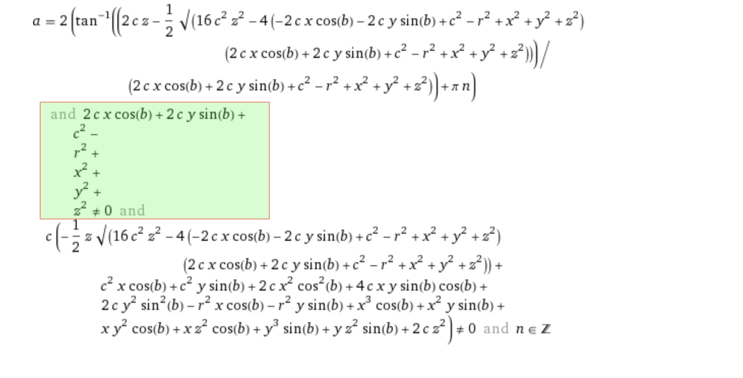

    ...as long as you make sure that this term is not zero:

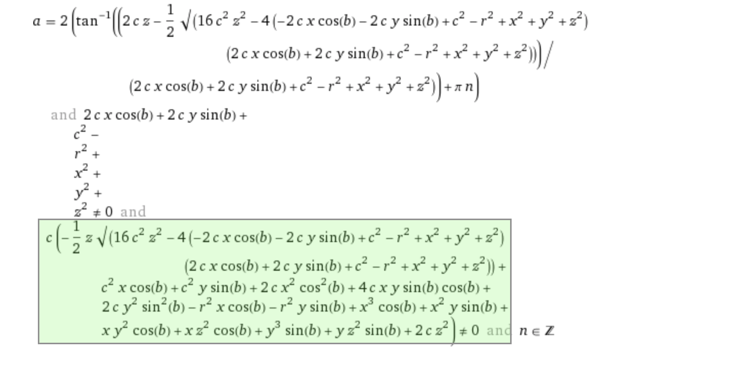

    ...and this term is not zero:
    ...and you plug in any integer for "n".
    Can you tell me if this "n" is important? As far as I can see, I can just ignore the "+ π n" Term at the end, right? I assume it is in there, because the tan function will repeat every π anyways. And the factor of 2 in front of the bracket means that the solutions will repeat for every revolution. Do you agree?
    What IF those two terms become zero? What does it mean for each of the two cases? Do you just stop and hold the last "good" position?
    Thanks for your help!
    Dirty :)

    OK, I think now I understand you code as well.... :thumbs
    Is...
    Code:
    if (!double.IsNaN(angle))
    ...really all the checking you do? Is this sufficient? I mean it's short, and if it covers all cases then it sure is an elegant solution.
    The only thing I am still struggling with is the fact that there should always be two solutions. Two angles "a" that satisfy the equations. Did you ever run into problems with these equations when you use them in your graphical representation in your software?
    Dirty :)
  8. Dirty
    Oct 15, 2017
    746
    All the way up front.
    7,978Coins
    +890 / 3 / -0
    One more thing about the terms "a1" to "a4" in your code:
    Code:
    double a1 = 2.0 * _crank * x * _verticalAngleCOS;
            double a2 = 2.0 * _crank * y * _verticalAngleSIN;
            double a3 = _crank * _crank - _rod * _rod + x * x + y * y + z * z;
            double a4 = a1 + a2 + a3;
    You're using variables called "_verticalAngleCOS" and "_verticalAngleSIN".
    In the equation (from WolframAlpha) it reads... Bildschirmfoto 2019-08-11 um 16.55.40.png cos(b) and sin(b) . With b being the horizontal angle.
    Am I correct to assume that it should definitely be angle "b" in these places? Any reason for calling those variables "_vertical angleCOS/SIN"?
    Dirty :)
  9. pmvcda
    pmvcda aka FlyPT
    Nov 3, 2010
    2,280
    Portugal
    15,950Coins
    +2,733 / 18 / -0
    Sorry, I'm full of work and on the phone..
    Answering fast, but after tomorrow I will take a better look.
    n*PI is turns, so we can ignore n.
    In the code the idea is to calculate only 1x, something we use multiple times. That's the reason for the terms. Same for the vertical Angles, instead of calculating the cosine multiple times in the loop, I calculate it once, when the user changes the vertical angle. From then, it's fixed or pré calculated.
    The multiple solutions, I don't remember, I have to take a look, but I think it was zero, only if the rod or crank was zero, and that doesn't happen by design. (not sure here, but I think it was that)
  10. pmvcda
    pmvcda aka FlyPT
    Nov 3, 2010
    2,280
    Portugal
    15,950Coins
    +2,733 / 18 / -0
    I'm mixing the angles when I talk about them. B is the angle in the horizontal plane, for the vertical axis. Hope I can explain it...
    In the equation c and r are cranck and rod

  12. pmvcda
    pmvcda aka FlyPT
    Nov 3, 2010
    2,280
    Portugal
    15,950Coins
    +2,733 / 18 / -0
    @Dirty
    So, I took a better look.
    The conditions to have zero don't happen, only if you have c or r (crank and rod) zero.
    That could cause the top joint to match the rod/crank joint and make a division by zero.
    By design, this kind of mechanism wont work having those values zero at the same time.
    The n*PI is ignored, that's what gives you multiple results. At each half turn (PI) you have a possible result.
    I ignore it, because we always want the lowest n. We want the closest possible angle near zero or the result could be strange.
    Imagine we are going up and you use the 2nd solution, that would be 1*PI.
    The rig would go up and then start going down to reach that 1*PI, while in the first solution it just goes up and stops. That's the effect of going through all the circle, you need to pass the highest value to reach the next 1*PI.
    Same happens going down. So we want the solution closest to zero. That's 0*PI.
    The way I test the result to know if it's valid is for me the fastest one. You just test to see if you have a number as a result.
    If there's no solution it returns nan (not a number).
    After getting a result I also make other verification's to know if the angle is in the range defined by the user. That is not on the code, but it's simple.
    If angle is not valid, I keep the rig in the last one.
  13. Dirty
    Oct 15, 2017
    746
    7,978Coins
    +890 / 3 / -0
    Hey :)

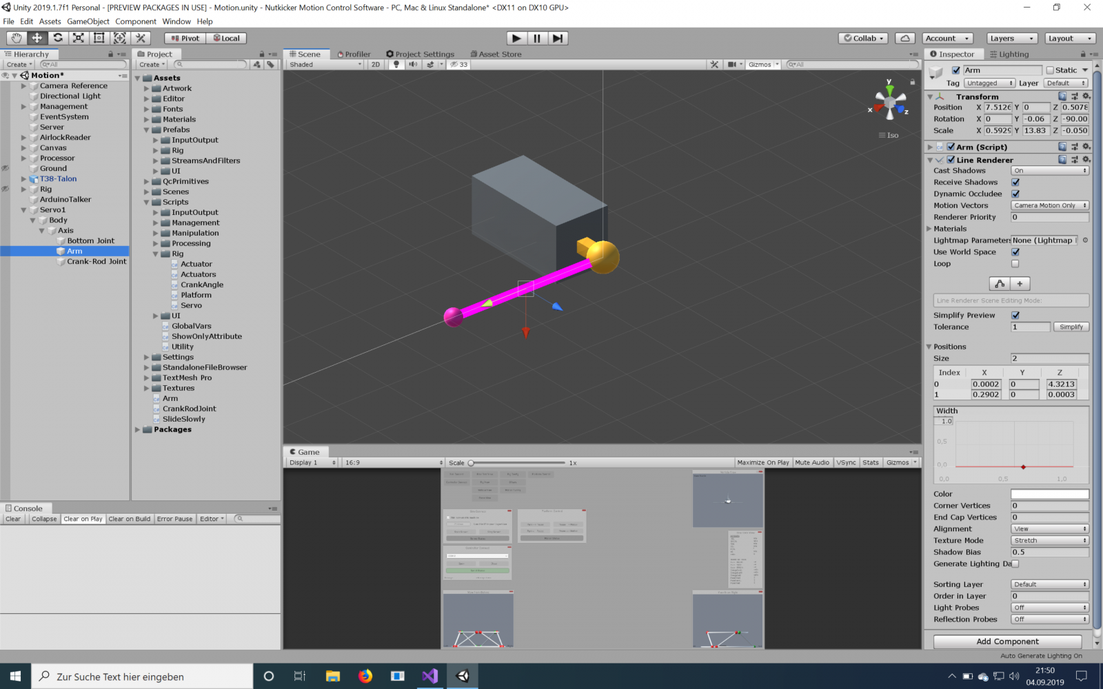

    just a quick sign of life :) I'm back from my vacation and am working on support for the crank arm setup in my software:
    The formula that @pmvcda posted works fine! At least for all the cases that I tested I got perfectly fine results :)
    Two notes to mention in case some future motion sim software writer happens to stumble across this thread:
    1. The "+ π n" Term can indeed be omitted. It creates multiple solutions each 360° apart. So, when there is a valid solution at an angle of 20° then there are automatically more solutions at 380° and 740° and so on.
    2. There is "another" solution to the equation that can be found by flipping the sign in front of the root. So, instead of "-1/2√", technically it should read "±1/2√". If you find the formula to return a non-sensical solution, try flippig that sign.
    Cheers, Dirty :)

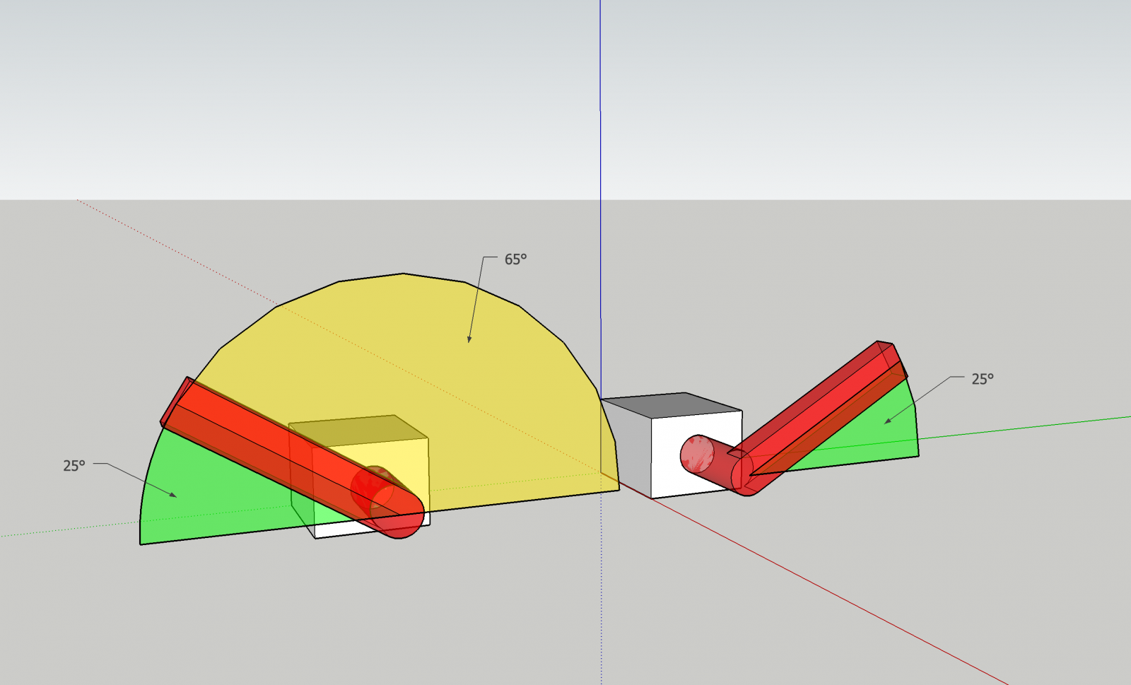

    Maybe someone can help we with this: Something I am unsure about is how to convert the angle of the crank arms into a value to transmit to the AMC1280.
    See this example:
    What would I have to transmit to the controller in this example case? Do I always take the measurement from the horizontal (in this example 25° and 25°)? Or the angle from a common reference direction (here 65° and 25°)?
    I guess I will have to calculate where the servo position is on a scale from 0-100% of it's possible travel, but what does "possible travel" even mean in this case? What is 0% and what is 100%? Are those limits (0 and 100%) angles that the user has to specify?
    How do you guys (@pmvcda , @hexpod ) do it in your software?
    Thanks in advance.... :)

  19. Zed
    Apr 4, 2017
    1,040
    USA
    5,847Coins
    +1,043 / 4 / -0

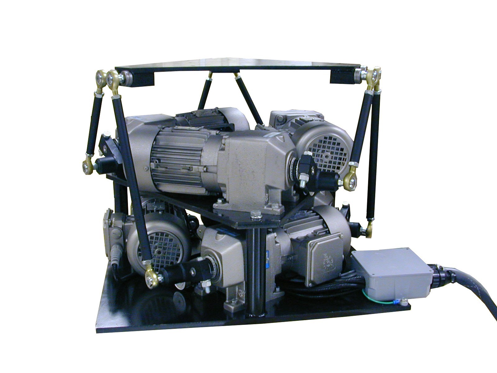

    Hey Dirty, looks good and I need to reread the whole thing but just to bend things, can your software support unequal rod lengths like this? I have been considering this arrangement as an example since it keeps footprint small with bigger motors but changes the geometry. Just asking. I need to do the simulation myself to see how it changes things but was curious if yours already allows for this kind of arrangement or if you gurus already see issues with this?
    Cheers!
  20. Dirty
    Oct 15, 2017
    746
    7,978Coins
    +890 / 3 / -0
    Holy smoke...! That's an interesting configuration :)
    But if space constraints are tight, one that might very well save quite a lot of space while sacrificing platform travel only minimally, if at all.
    I never thought of such a configuration, so my software as it is now does not support this kind of setup. It is however not as complicated as it looks. I'm sure it could be implemented with a few evenings time. If you (or anyone else) wants such a setup, you can download the project from GitHub and add it. It's all open source.
    The asymmetric rods shouldn't be a problem, because the math will take care of that. I don't see any "categorical" issues with such a geometry per se, but two aspects I think are worth considering:
    1. Crankarm setups have one more joint than a linear actuator, so for the same size I'd expect them to have a tendency to be a little bit more shaky.
    2. Shrinking the footprint while keeping the payload the same will add additional shakiness.
    ...but those are considerations about crank arm setups in general. I think this stacked layout can deliver a performance equal to any other crank arm setup.
    Dirty :)
