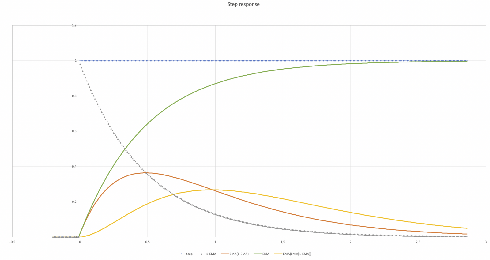

    OK,.... brace yourself! This is gonna be a trip for an unprepared mind, but I have the impression your mind is not totally unprepared. :)
    Take a look at these graphs:
    I have inserted them as full image for you to have them open all the time. If you don't dream of those graphs tonight, come back here and stare at them until you do! The key is to know that the vertical axis has two distinct meanings:
    • For the blue input signal it is an acceleration. This is the vertical acceleration we're getting from the plugin. It makes a step from 0 to 1.
    ...whereas for all other output signals...
    • ...it represents the vertical displacement of our platform.
    The response of the filter to this exemplary "step input" can be applied to any other step as well.
    Here's the recipe:
    1. We apply a low pass filter to the input signal to get the green line.
    2. We subtract this signal from the original signal and we get the grey dotted line. This is what people call "washout". We could use that signal to drive the rig in heave, but the signal still represents an acceleration, but we need a position command for our rig.
    3. We send that signal through a low pass, to convert an acceleration into a velocity.
    4. We send that signal through a low pass again, to convert a velocity into a Position.
    ...then we use this signal to drive our platform in heave.
    Now take a good look (again) at those graphs. If the vertical axis represents the displacement, then the...
    • ...height of the graph represents the position of the platform.
    • ...slope of the graph represents how fast it is moving. (1st derivative)
    • ...curvature of the graph represents how strong it is accelerating. (2nd derivative). Yes, I know, technically it is not the curvature directly, but for shallow gradients "curvature" is good enough.

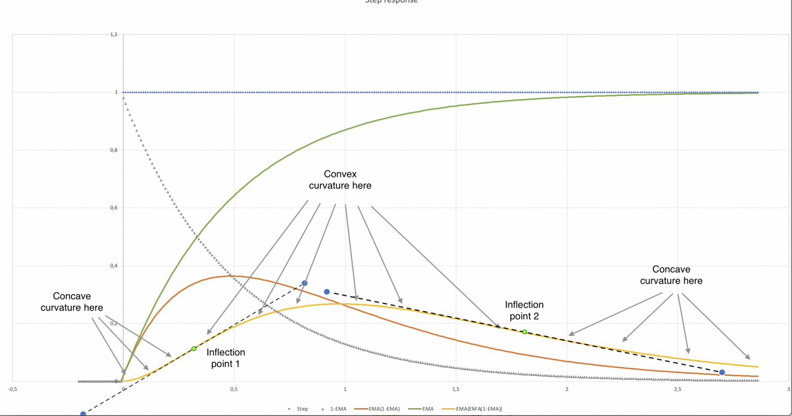

    Now take a good look (yet again) at the yellow graph. As the input signal jumps up, the yellow graph jumps to a certain concave curvature. THIS curvature represents the acceleration the user feels on the rig.
    But if you look even closer, you will see that the graph has two inflection points:
    The curvature changes from concave to convex and back to concave. That means that from the first inflection point on, the user experiences an acceleration adverse to those on the vehicle and then from the second on the acceleration on the rig goes back to being provers!
    But if you look closer still, you see that the adverse part is not curved as strong as the initial provers part!
    And this is where the magic happens: If the filters are tuned right, those curvatures are just above and just below the human threshold of detection, so you can feel the first, but not the second part. :thumbs
    Now, it will probably also become clear why with grossly mis-tuend filters, potentially both directions can feel somewhat OK: Both cues are present at certain times and if you learned to ignore the quick (but still wrong) initial jolt, then you will be able to enjoy a loooong provers cue above the threshold of detection, when instead there should have been an even loooooooooonger adverse cue hidden below the threshold of detection.
    Congratulations! If you made it this far without falling asleep or throwing up, you're now ready for the tragic end of the story:
    Unless you have A LOT of heave travel, like 1000mm or so, you can almost ignore vertical acceleration completely :(. The vertical axis is the one that we're least sensitive for and the only one on which we cannot use gravity for help (as opposed to lateral and longitudinal acc. through the tilt coordination channel).
    Long answer,... sorry :)
    Cheers,... Dirty :)

    Thank you so much for this.
    I read it over and over today and I looked at these graphs.
    I was doing it wrong apparently....
    The way I understand it now is, when I pull the stick I will feel positive G's, my rig has to move up.
    The curvature of the yellow line from 0 to the 1st inflection point shows me that if the rig moves up fast enough I will feel an increasing pressure of the seat on my butt, similar to being on a lift the moment it starts going up.
    This is the initial Jolt you are talking about right?
    Passing the 1st inflection point the rig is still going up but not accelerating anymore and will continue up till the axis limit.
    I hope I got it right.
    Thanks a lot for taking the time to explain this, I am sure many forum users will find it very useful
