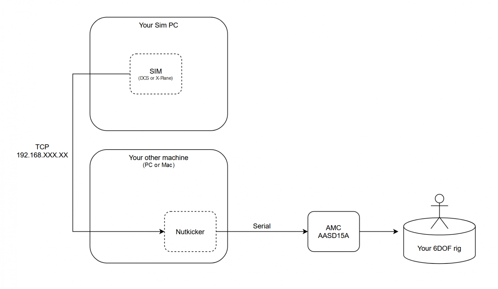

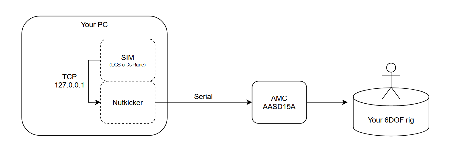

    Read the topic and basically I understand what you are doing, great. Since I am quite fresh in the simulator world I have a few questions (hopefully correct topic):
    1. Can I use the Nutkicker from @Dirty for any simulation software, or do I need different interfaces (software)? Now only coupling with DCS is discussed.
    2. Can someone perhaps indicate in a block diagram how things connect. For example, do I need simtools as an interface, or is this only needed with FlyPT Mover from @pmvcda.
    In other words, this beginner doesn't quite understand the connection between the different software options and the hardware yet. ( I plan to use the AMC-AASD15A from @Thanos to control servo motors) :sos
    Hope you can help me understand.

    Hey, :)
    Nutkicker is a standalone software. I have closed the source on it a few months ago, but you can have a copy anytime (let me know if this link ever breaks). Also, if you are really interested, I'd be happy to open it for anyone willing to help out. I just don't want it to be uncontained in the public domain. Just a little C# programming knowledge required, that's all. This is the first program I ever wrote and am learnig through it everyday :)
    So far, I support DCS and X-Plane. FS2020 does not yet provide the required data :confused:, but I am hopeful that it will at some point. In general, it can suppport any sim as long as you can get that sim to talk to a TCP connection. Or are willing to write a little program that does that.
    Run right on you Sim PC and get data via TCP localhost.
    Run on another PC or Mac and get data via TCP network.
