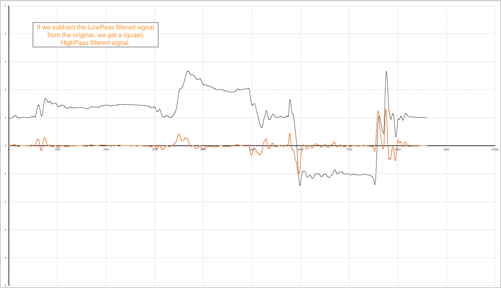

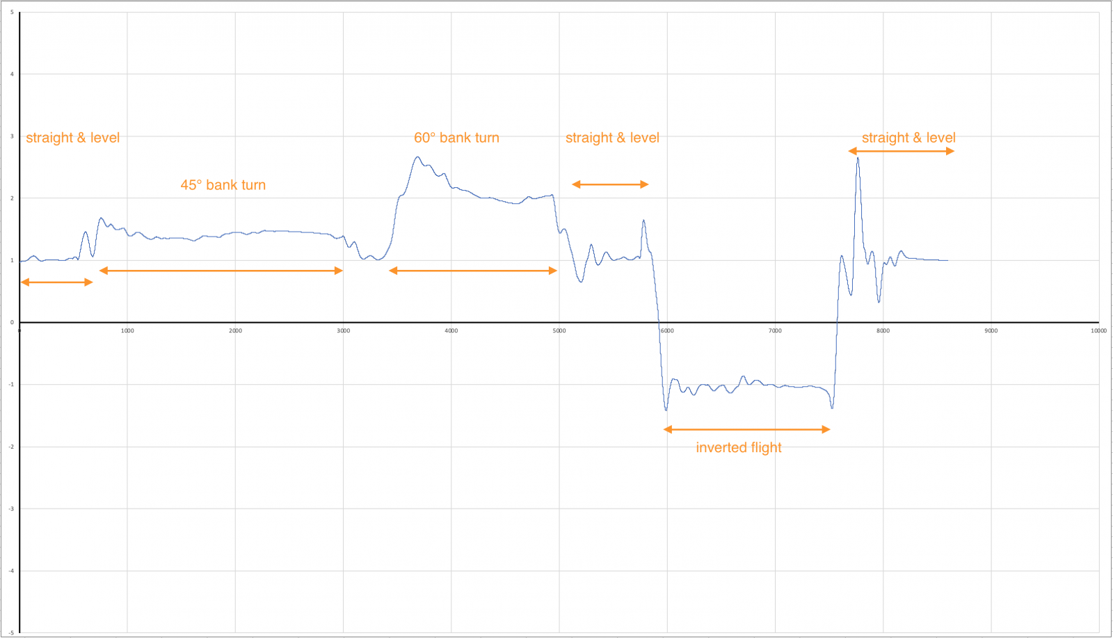

    I think you should use a highpass filter on that accel_vert signal. That will eliminate all "long lasting" components. The steady 1 G will simply disappear as it is very low frequency content.

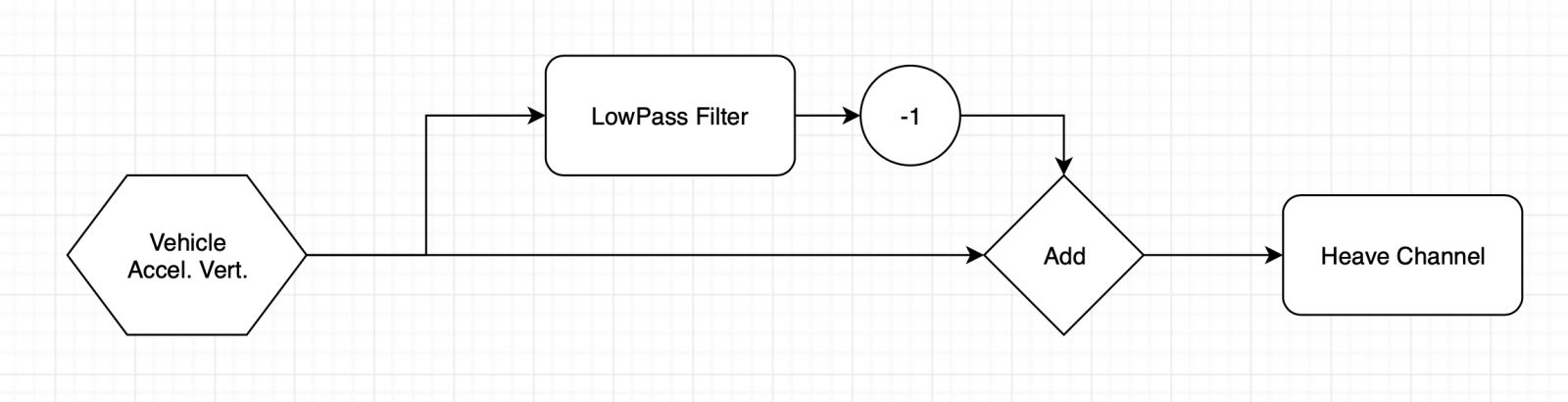

    In more detail: subtract the lowpass filtered signal from the original signal. It is quasi equivalent:
    Is that what you're working on @yobuddy?:thumbs
    It also explains why subtracting 1 (kinda) worked :) That "1" is the lowest frequency content imaginable. At least in straight and level flight ;)
    I suspect however, you will run into problems in inverted flight :) when this subtraction will bite you in the butt by taking away 2 units of heave from your operating space! I think using a highpass filter will make sure that you always subtract only what's necessary.
    Does that make sense?

    I am not sure xplane takes any units in inverted flight. can you double check it?
    In this example you see the platform with LPF only:
    Ill try your approach as soon as the filters will be disponible.

    I checked and X-Plane indeed gives -1G vertical acceleration (G-Load_normal) in straight-level-inverted flight. Anything else would've been an atrocity. All other flight sims I ever came across do as well and I'm 99.99% sure modern driving sims do as well. Yes, Yes,... you will not be driving upside down, but having the physics right matters even if you will not encounter edge cases like this :)
    I'm trying to make everyone understand why I think using a HighPass filter is more suitable for the task then subtracting 1:

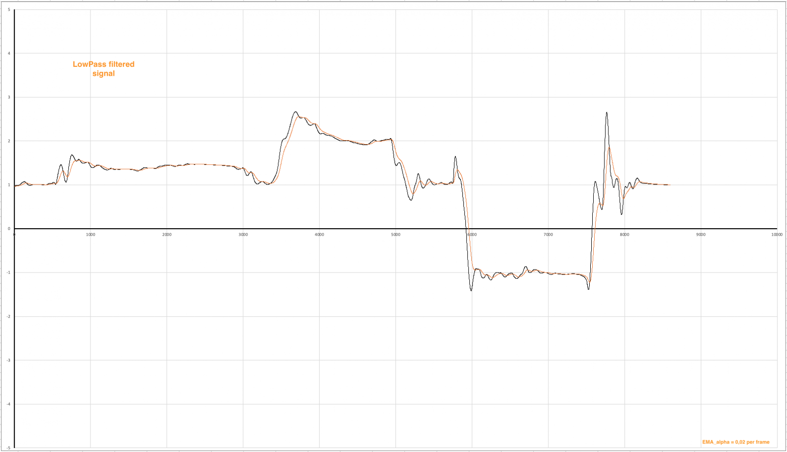

    Here's a quick test flight showing the vertical acceleration over the 8615 frames duration (97 seconds)

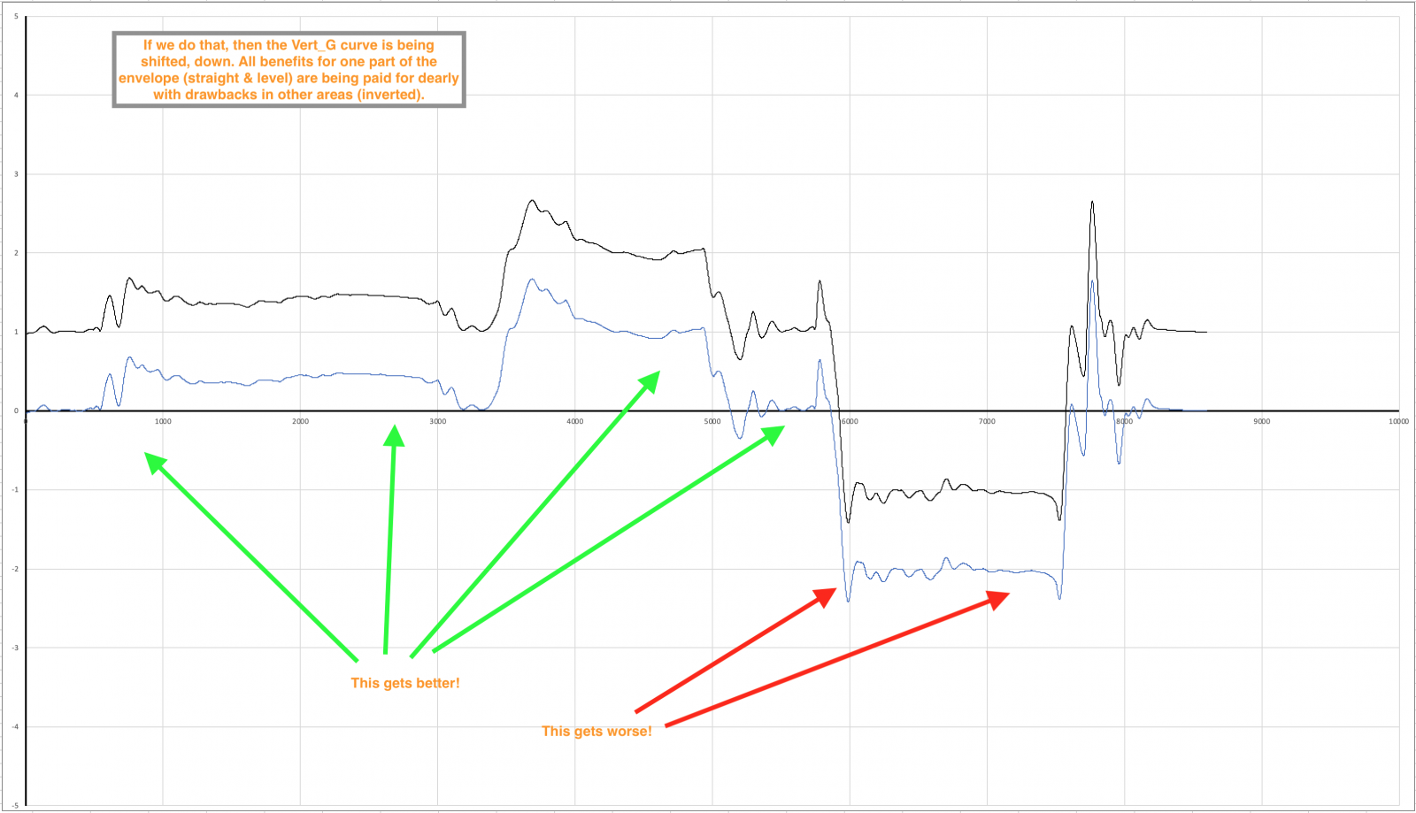

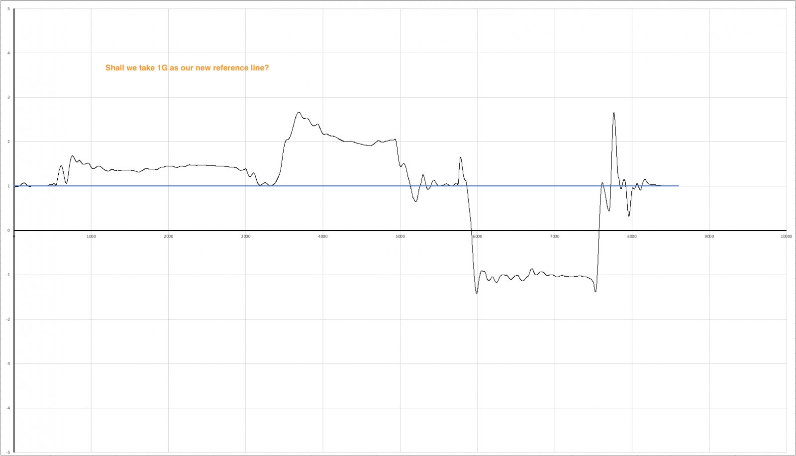

    It might be tempting to subtract 1 from the data, because in the long run we will have values around 1 most of the time. The flight I did is not representative for most airliners :) ...or even military flight ops.
    If we simply subtract 1 from the signal we manage to get the curve closer to zero for much of the flight. Other regions however suffer from this, as they get shifted farther away from zero :-(
    If only there was a way for us to subtract exactly what we don't need from the signal,...
    hmmmm...
    well,... "exactly what we don't need" is the low frequency content of the signal! Every G-load that persists over a reasonably long time (few seconds max) is not useful for motion simulation. This statement applies only to vertical acceleration! I will give you a much closer look into this topic and a nice mental tool as well pretty soon.
    So let's simply subtract "...every G-load that persists over a reasonably long time"! And that is what we get if we send the signal through a LowPass filter.
    The result is this HighPass filtered Signal:
    as you can see, it replicates the original signal whenever there are rapid changes, but smoothes out (HINT: You might as well say: it "washes out" ;)) if there is not much going on.

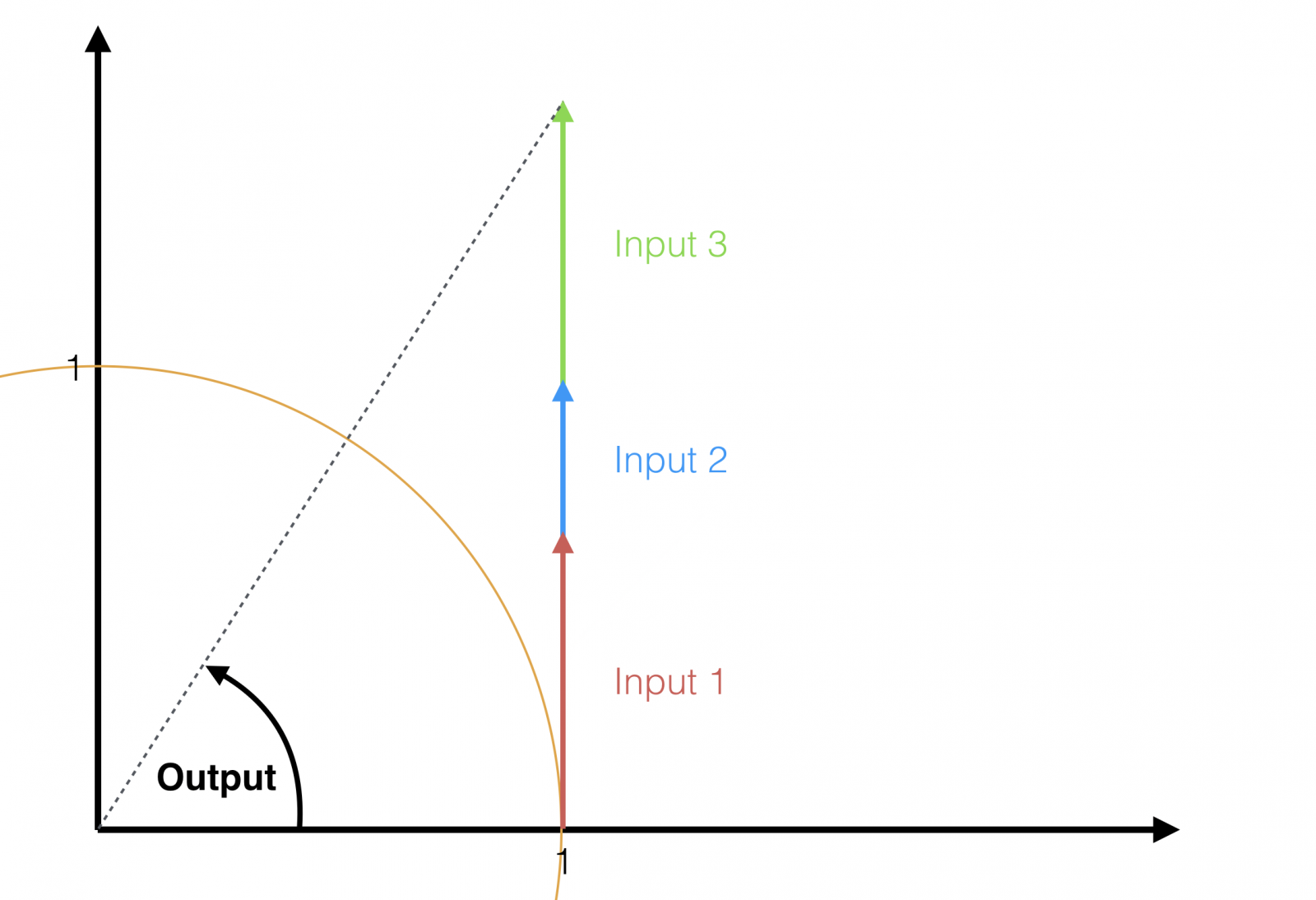

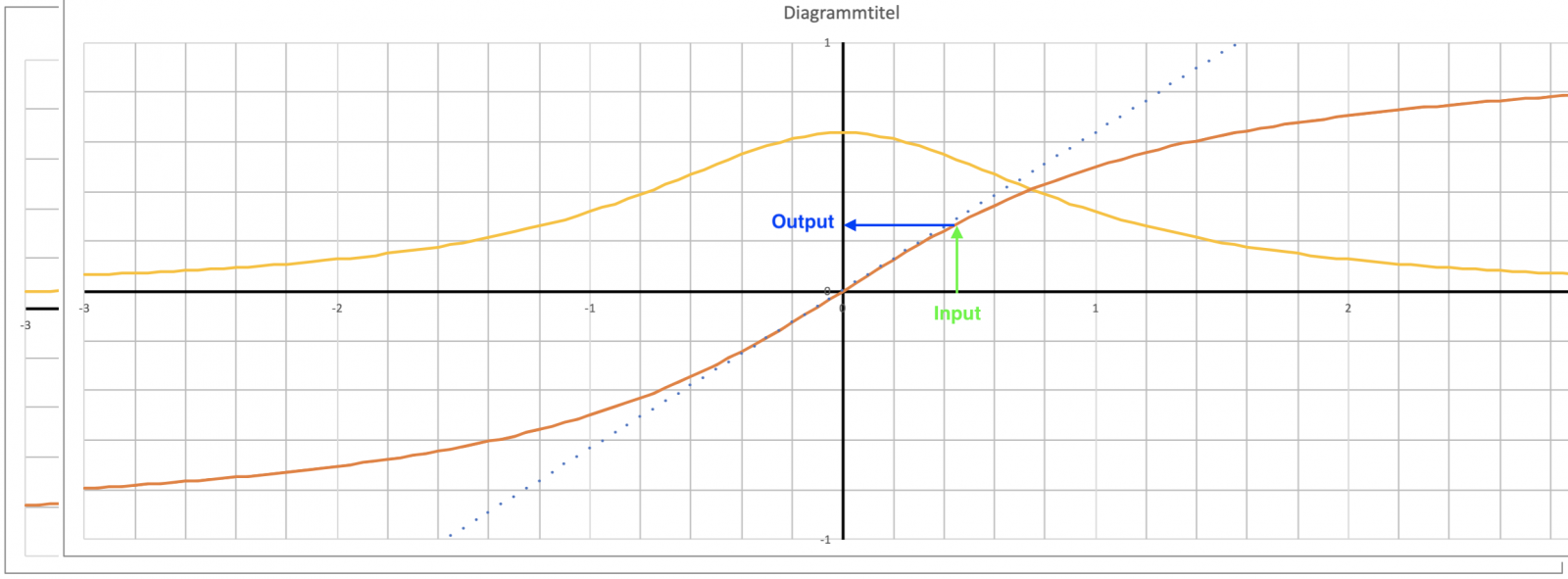

    I thought of another way:
    Use a filter element that outputs the ArcTan of the value you put in. (Then scale that down to suit your needs).
    A picture might illustrate better:
    No matter how many signals you add up, the angle inside the unit circle will never exceed 90° (π/2) :thumbs
    Then you cut that output down to whatever maxValue you allow . Output = (2*ARCTAN(Input)/π) * maxValue
    This picture illustrates that you'd need an infinite input to reach an output of maxValue. The orange line is the relationship between input and output.
    The yellow line is the 1st derivative. Responsiveness = 2/(π*(1+Input^2))
    - So you would still get to keep the signal 63% responsive around the center.
    - And you'd literally never be able to reach an end stop
    - And your DOF would always keep a little rest-responsiveness.

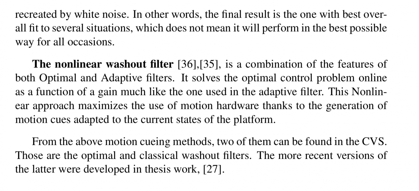

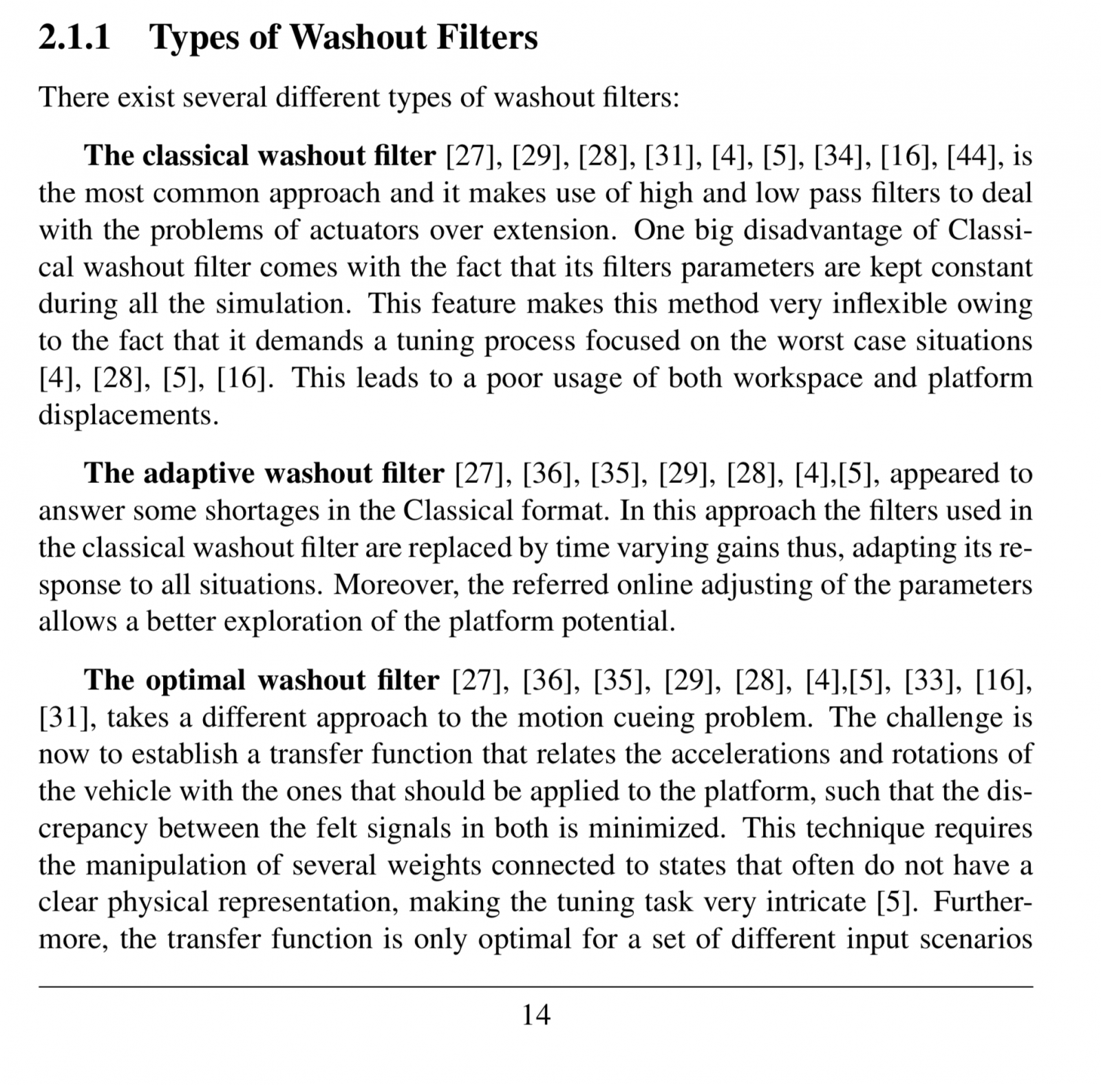

    These guys have...
    http://publications.lib.chalmers.se/records/fulltext/98871.pdf
  14. Dirty
    Oct 15, 2017
    746
    All the way up front.
    7,980Coins
    +890 / 3 / -0
    That's an interesting paper! I'm not through yet, but I already saw some interesting points:
    It's nice to see someone else formulate these thoughts in clear and technically precise words:). I wouldn't even have the vocabulary available!
    btw, I'm not advocating that SimTools must be turned into a research tool for Ph.D. students! Basically, think of this thread as my way of saying: "This stuff is interesting! And it's not TOO hard to understand either! So let me see if I can implement some of this in my program."
    Dirty :D

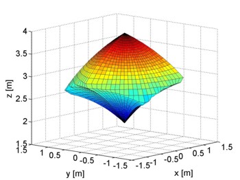

    This is the translatoric operating room of a Stewart platform:
    I don't know if there is a catchy English name for it, but in German I'd call this a "Hüllkörper". Maybe "hull-body" or "bounding-body" would be an appropriate translation. In a nutshell, it answers the question: "How far can the platform move in x/y/z direction while yaw/pitch/roll are zero?" , because it is only the translatoric operating room. And since we are talking about 3 dimensions (x/y/z) the answer is a 3-dimensional shape.
    The even more interesting question would be "Can we extend this to all 6 dimensions?" And the answer is: YES!
    ...well,... "Yes, if you know how to define n-dimensional shapes". Which in my case is pretty much "No!".
    My two approaches to that problem:
    1. Brute force :) I could simply let my program try out all possible values in 10mm and 5° intervals until one of the actuators reaches its limit. And then I could refine those 10mm/5° 6D-cubes further to 1mm/1°. If I can process 100 combinations a second, I might be done overnight. Not really what you'd call an analytic approach, but it might give usable results.
    2. Applying a non linear filter on actuator-travel level :) like I talked about above. So, this would be kinda like saying: The motion cueing algorithm can do whatever it wants. We don't care for endstops. We just send the signal to the controllers which ensures through a non linear filter that the actuators cannot hit an endstop.
    This is getting way over my head here, but it would sure be nice if I could know how much range any of the DOFs have left.

    Instead separately limiting dofs, limit the “workspace”
    First one should calculate the edges of your workspace according to the platform size and geometry, than monitor how far we are from “out of reach” state than apply a adaptive washout on it.
