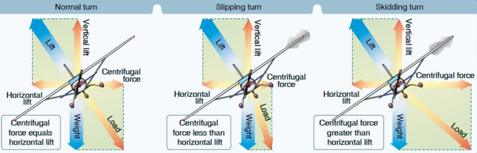

    To answer your question, during coordinated turns, the pilot does not feel the tilt, but he does feel the turn. In other words, during a coordinated turn (ball centered), he does get pushed into the seat (perpendicular to the seat), but he does not feel any forces pushing him to either side of the seat. The moment he feels the onset of a tilt (being pushed to either side of the seat), his instincts gained from hundreds of hours of training/practice kick in. Instinctively, he then uses the rudder to get the ball back to the center again.
    All of these forces can be felt easily. In fact most experienced pilots react to whatever forces they are feeling at the moment, and correct/compensate for them appropriately, without even having to look at the turn coordinator (or other instruments).

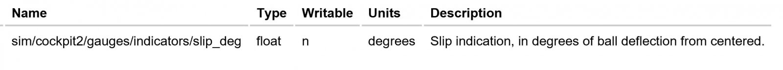

    It could be possible to simulate skidding and slipping so actually, instead of positions one should map the coordinator ball datarefs on the roll axis.
    @value1 what's the procedure to output this through the plugin?

    You will feel lateral forces during both slips and skids. Note that slips and skids are two faces of the same coin. In other words, they are the same thing, only their directions are different. During an uncoordinated turn, we call it a “slip” when the ball deflects in the direction of the low wing (“slipping down the wing” is how I remember it), and when the ball deflects in the direction of the high wing, we call it a “skid” (“skidding up the wing”).
    In a coordinated turn, roll need not be zero. For instance, a pilot might roll 30 degrees and start the turn. Half way into the turn, he might roll another 15 degrees and all along keep the ball perfectly centered. He would do this by compensating for the extra forces (both horizontal and vertical forces - please refer to the pictures you've pasted above) generated while rolling the additional 15 degrees by applying more “back pressure” (pulling on the yoke).
    Assuming coordinated flight, when rolling the initial 30 degrees, you will feel yourself being pushed into the seat (perpendicular to the seat). During the additional 15 degrees of roll, you will feel even more of a push into the seat (once again, perpendicular to the seat). Of course all along, working the rudder would be very important as well, but given the scope of your question, to keep things simple, let me skip that portion.
    Please let me know if you have any other questions.

    Motion platform stats from Laminar Research does not output the angular positions. Maybe it’s intentional maybe not.
    Anyway it is scratching me a bit to try the relevance of the “slip indicator” in practice
