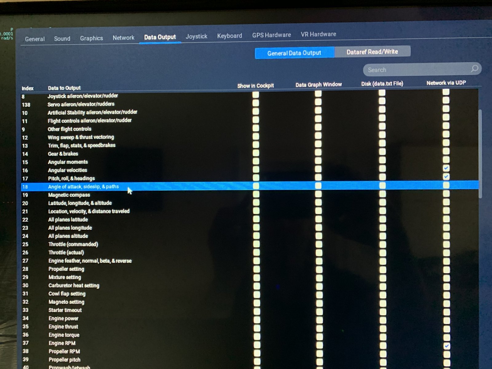

    Haha :) I know there's more data available in xplane than what the plugin outputs ;)

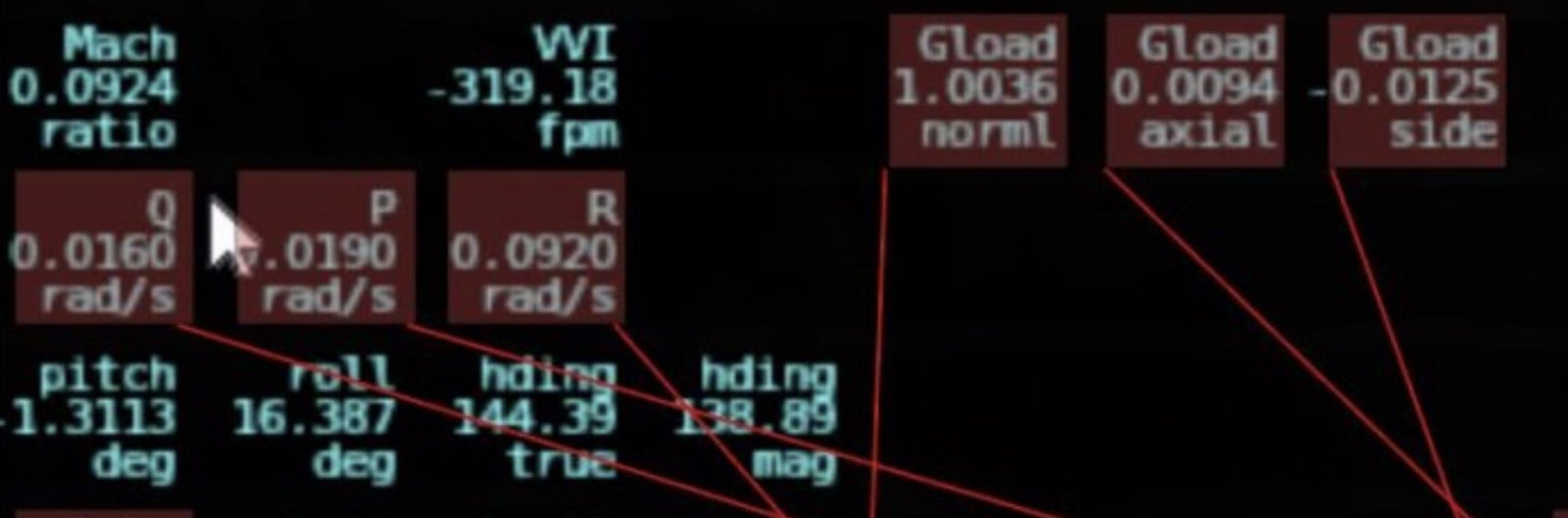

  10. Dirty
    Oct 15, 2017
    746
    All the way up front.
    7,981Coins
    +890 / 3 / -0
    WOW!!!! So many great points brought up here!!!
    First of all, THIS....
    ...is the post to read! Period! There is not a single unclear/vague/ambiguous statement in there. There aren't enough positive tags to click to allow me to describe just how RIGHT every single word in this post is.
    ...except this one point :)
    "...What you will feel is a change of the angles = rotation, ("pitch/sec")...."
    You will not even be able to feel rotation! But what you will feel is a change of the change of the angles = angular acceleration (rad/s^2). Yes, that's two changes :) The "meta-change" so to speak :) I don't know if that's what you meant, but in case you didn't, here's an explanation:
    Any continuous unaccelerated rotation (rad/s or °/s) can not be felt directly. You might notice that your left arm feels a different force vector than your right arm, and your brain might be able to interpret that as rotation (more likely you will develop vertigo), but you will not be able to sense rotation directly. At this very moment everyone reading this is actually spinning at a rate of 7.29×10−5 radians/s (~15°/hr) and there is just no way for you to tell. We don't have Foucaults pendulum in our vestibular system.
    What you WILL however be able to sense directly (vestibular system) is an angular acceleration. Because the fluid in our vestibular system has inertia, you can sense angular acceleration: The change of the rotation rate over time.

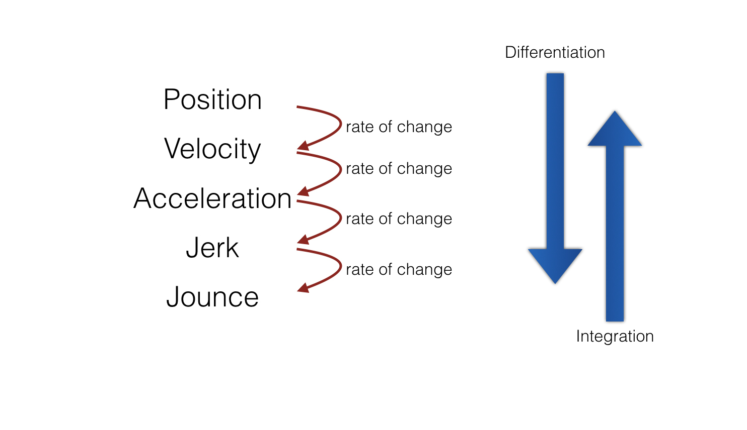

  11. Dirty
    Oct 15, 2017
    746
    7,981Coins
    +890 / 3 / -0
    I think to be able to have an intelligent discussion we should all be using the same terminology. And while there can be some terms used interchangeably (angular rate/ angular speed / rotation rate) it would help us A LOT if we could minimise misunderstandings by agreeing on terminology.
    I’m gonna start with translation
    Try to get these terms into your head:
    • Position [m]
    • Velocity or Speed [m/s]
    • Acceleration [m/s^2]
    • Jerk [m/s^3]
    • Jounce or Snap [m/s^4]
    OK, OK, Jounce will most likely not play a role in motion simulation for us, but you won’t have fully understood the whole concept of it if jounce is still unclear to you. I’d even go one step further and say: You will only have understood the concept once you catch yourself with the question „Why isn’t there anything after jounce?“ (Btw. there is: It’s called „Crackle“ and „Pop“).
    What you should take away from this, is that each term describes the rate of change (over time) of the previous.
    Velocity [m/s] is the rate of change of your Position [m].
    Acceleration [m/s^2] is the rate of change of your Velocity [m/s].
    Jerk [m/s^3] is the rate of change of your Acceleration [m^2].
    Jounce [m/s^4] is the rate of change of your Jerk [m^3].
    …and so on.
    So, it does matter whether you’re talking about speed or acceleration :)
    In translation that is pretty much self evident. After all, terms like position, speed and acceleration are common everyday English.

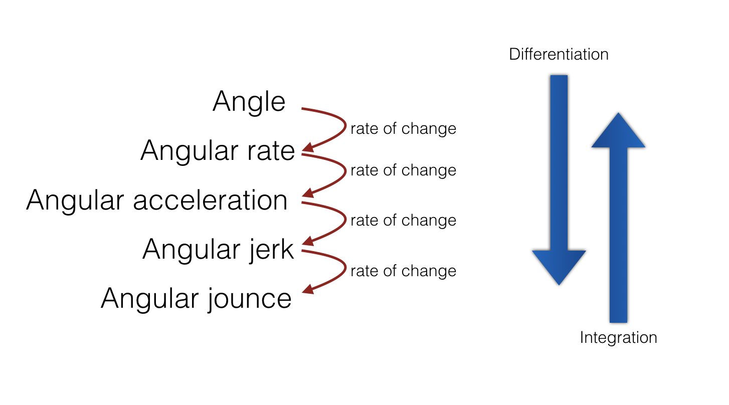

    Here’s the same for rotation:
    • Angle or angular position [°]
    • Angular rate (Omega) [°/s]
    • Angular acceleration[°/s^2]
    • Angular jerk[°/s^3]
    • Angular jounce [°/s^4]
    …got the idea? If not:
    Angular rate [°/s] is the rate of change of your Angle [°].
    Angular acceleration [°/s^2] is the rate of change of your Angular rate [°/s].
    Angular jerk [°/s^3] is the rate of change of your Angular acceleration [°/s^2].
    Angular jounce [°/s^4] is the rate of change of your Jerk [°/s^3].
    ...and so on.

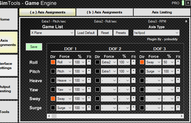

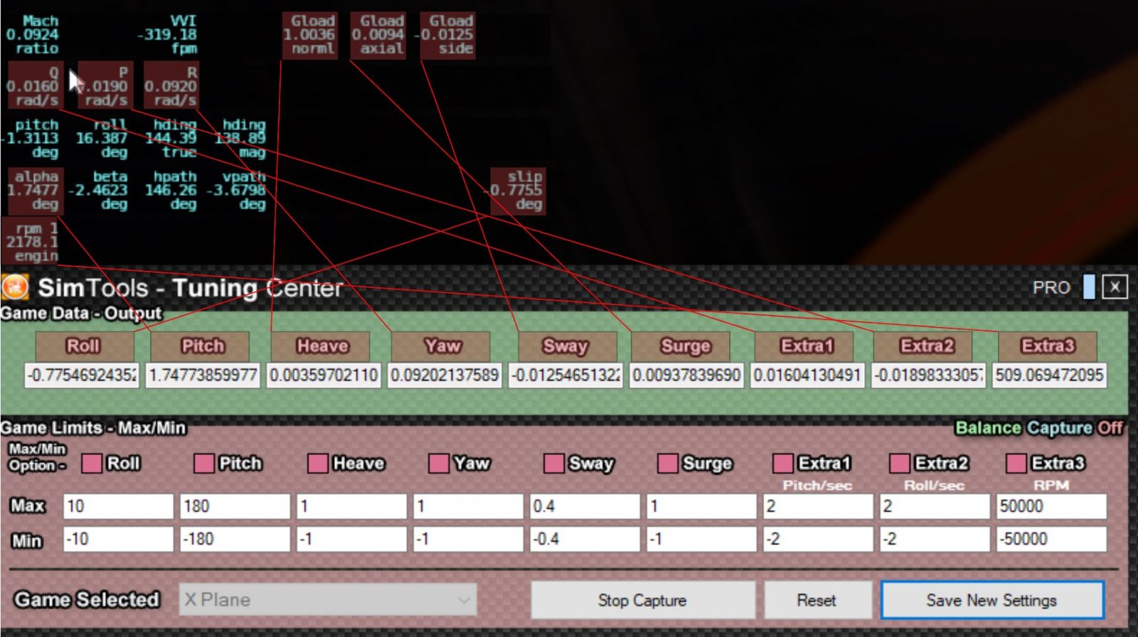

  16. hexpod
    hexpod http://heXpod.xyz
    Apr 18, 2016
    1,228
    berlin
    7,900Coins
    +381 / 5 / -0
    DC motor, 6DOF
    I am mapping the slip indicator to the roll axis (not the sway) ino order simulate “exaggerate” the sustained tilt feel.
    Of course, I am mixing it with angular accelerations rad/s. (Extra2)
    Can you see it in this matrix?

  18. hexpod
    Apr 18, 2016
    1,228
    berlin
    7,900Coins
    +381 / 5 / -0
    DC motor, 6DOF
    If you only use angular rates (in rad/s) your platform will remain flat even with strong incidence angles.
    Yaw Euler is useless, roll can lead into erroneous positions (infamous coordinated flight) but Pitch (in deg.) is more than crucial!!!
    Otherwise you fly vertical and your platform is flat.
    That’s bullshit
    You understand what I mean?

  20. hexpod
    Apr 18, 2016
    1,228
    berlin
    7,900Coins
    +381 / 5 / -0
    DC motor, 6DOF
    OMG
    „Why not using G_Lateral for that?„”
    Can you see it in the matrix?
    I am mixing three of them.
    I feel with my platform both are quite different and gives you a different feeling.
