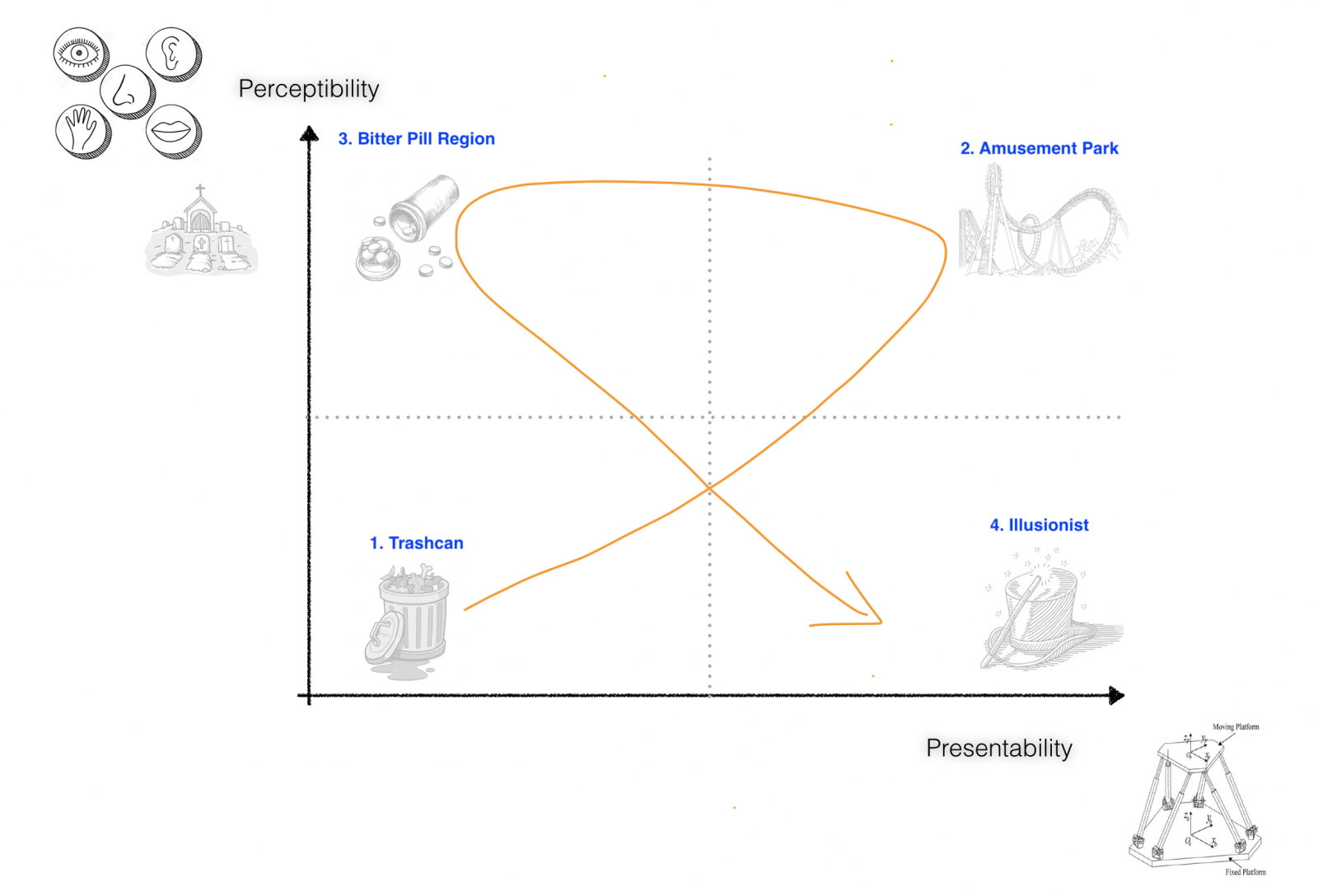

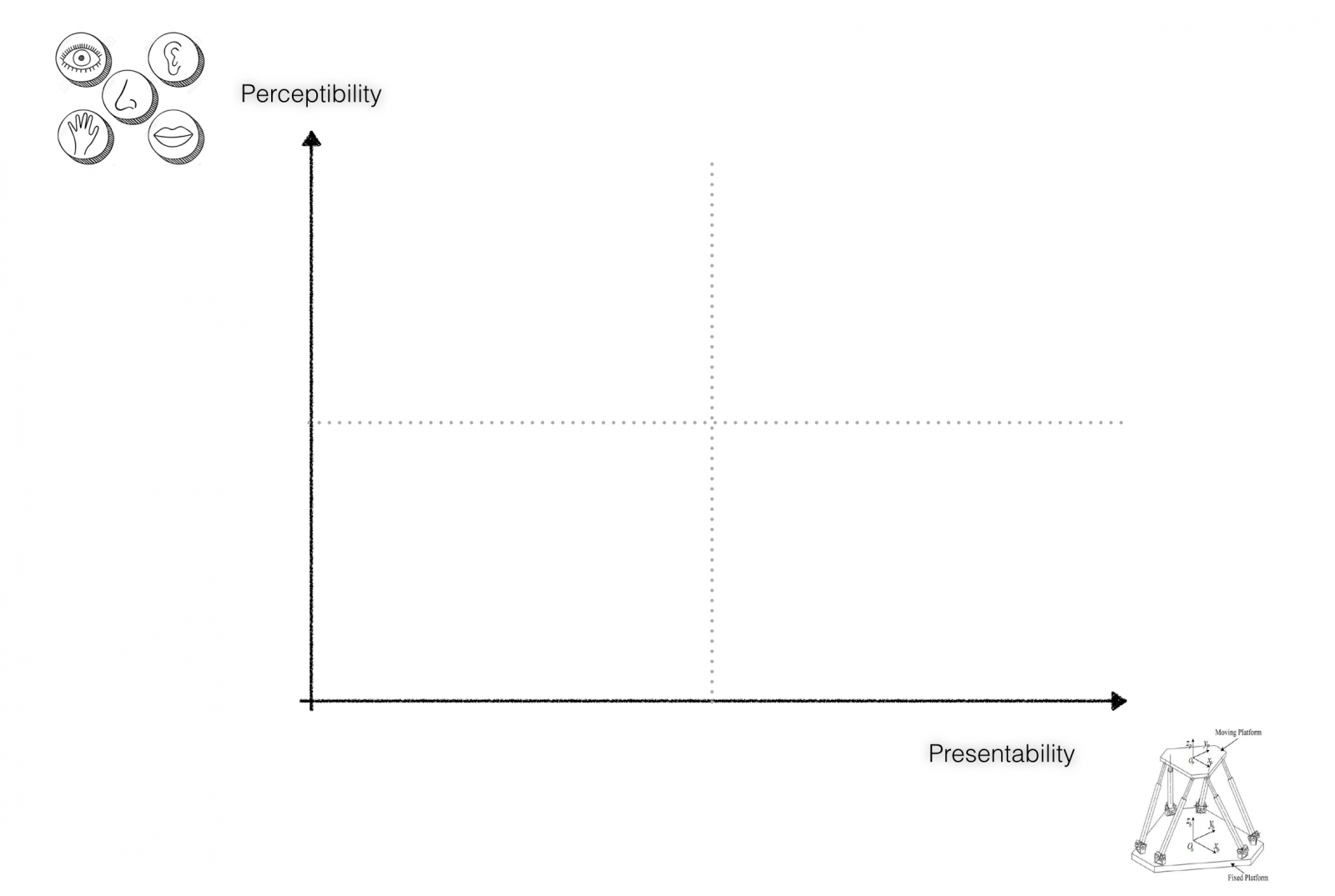

    The Presentability-Perceptibility-Diagram :)
    For every motion element, every acceleration, every roll rate - or every change of acceleration (jerk) and every change in any of the angular rates of the vehicle you can ask yourself the question:
    Where would I locate this element on the Presentability-Perceptibility-Diagram?
    Yea, yea,… I know ‚unconventional approach‘ and all… I can literally hear people shout „WITCH!!!!“ …but bear with me here :)
    <Disclaimer> This is NOT standard first semester curriculum in Motionsimulatorology. I don’t know if someone already gave a catchy name to this method but for me personally plotting out stuff in two dimensions (that are somewhat descriptive of the subject you are thinking about) is a great tool to bring my thoughts into order. </Disclaimer>
    Whenever I thought about how I would implement a motion cueing algorithm, two major considerations dominated:
    1. Can a human feel this motion element in the vehicle?
    2. Can a Stewart platform present this motion element to the user?

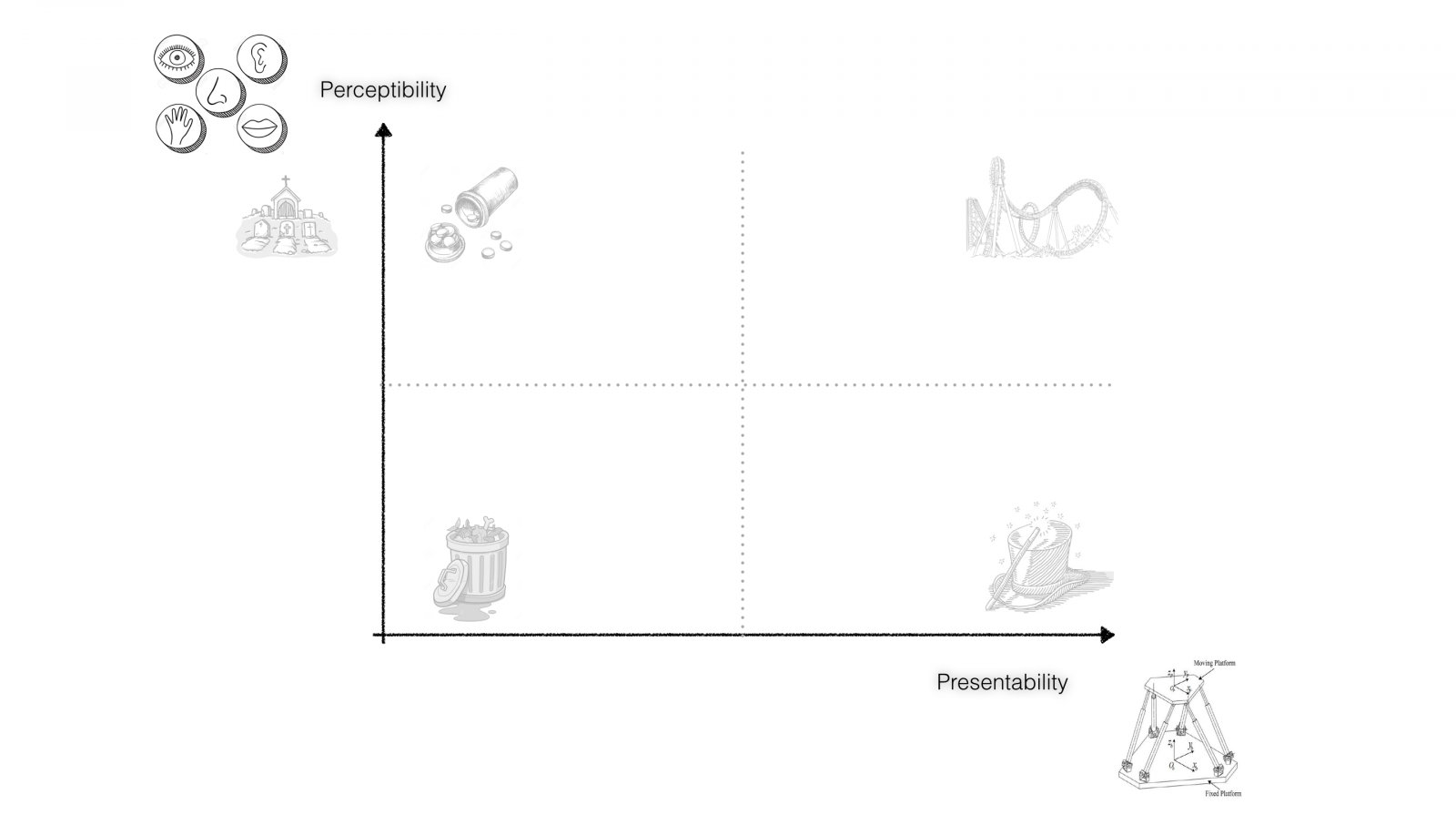

    It greatly clarified my mental image of the problem when I drew this diagram. Just the coordinate system alone gave structure to my thought process, because it immediately showed me, if what I thought made any sense at all.
    I divided it up into four major regions:
    • The Trashcan: Motion elements that cannot be felt and cannot be displayed live here. Actually a lot more than you think will live here.
    • The Bitter-Pill region: Motion elements that can be felt, but the platform is unable to display (properly) go here.
    • The Amusement Park: That’s where the fun stuff happens! The motion elements that humans can feel in the vehicle and the platform can display :)
    • The Illusionist: There are motion elements that the platform can perform, but humans are unable to perceive. We can use those to fool the user or prepare the rig for future action. Gently returning the platform towards the center for example is happening here.
    …and then there is the :eek: Graveyard!!! That’s the motion elements that the platform displays opposite to the real thing! That’s a first class immersion breaker! There should be pretty much nothing in here as it will ruin your simulation experience. I’d rather have a motion element not represented at all, than have it represented opposite.
    Now, if you think that you should cramp as much as possible into the amusement park, you’re wrong. Motion simulation is at least as much about avoiding false cues as it is about creating correct cues. Here’s a path I took for pretty much every motion element:

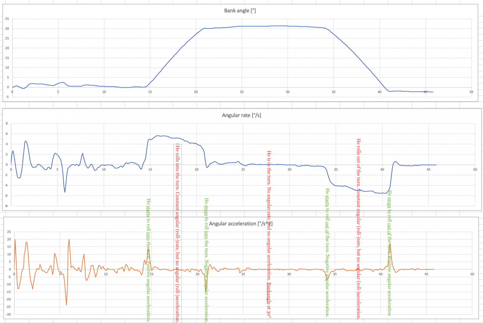

    I said I would try to illustrate. :)
    Here are bank angle, angular rate, and angular acceleration for the situation described by @hexpod above: Aircraft rolls into a 30° bank turn. Holds the turn and then rolls out to wings level. (The first 10 seconds are just for stabilisation, trimming and setting thrust)
    Dirty :)

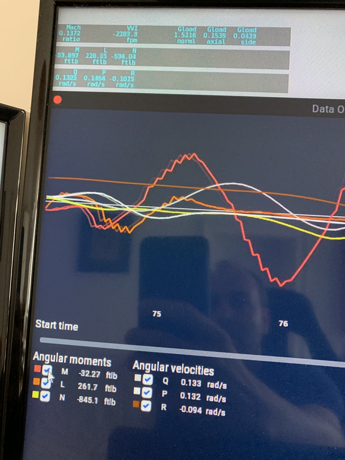

    The graph comes from xplane or its a real flight recorder?

    It comes out of DCS World. But X-plane is no different. In fact every simulator I know gives the same results. :)

    Did you saw the amount and the aggresivity of those?
    You have to put a ridiculous amount of smoothing to attenuate it. It’s not a solution.
    P-factor so big and so abrupt? It cannot be I think
    That’s the last second before the Cessna stops with a very little amount of braking. 0.8G longitudinal and 0.6G side. Ridiculous.
    You can see the Cessna compas shaking accordingly.
    The compas shakes but not the aircraft body
    On the top of it it’s a bit erratic.
    Austin have sent me already a custom build which is a bit better but we are not yet there.
    If you could reproduce it with the last 11.32r2 it would be cool

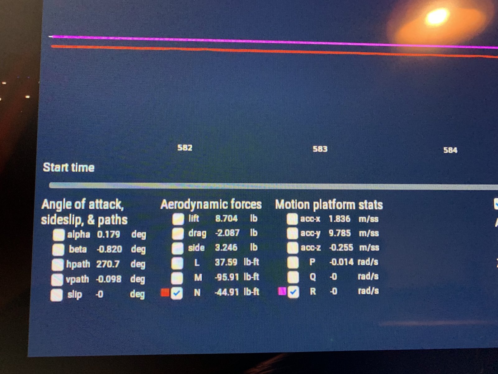

    I was able to reproduce it. Similar jitter, similar spikes.
    I tried increasing the flight model cycles per frame but that didn't help. I think it is neither a bug nor a feature. It's just an artefact of how X-Plane handles friction. I saw it only below ~5kt groundspeed. I will do more testing tomorrow.
    ....oh, and I see that Austin has this "Motion platform stats" section. Thats what you need!
    Use Q, P or R on Yaw. If possible with a highpass filter. Thats the angular rotation rates.
    M, L or N are the angular moments. Those need to be divided by the rotational moments of inertia to get angular accelerations. Then if you integrate those over time you will get Q P R. The sim does all that for you. Just use what you find under motion platform stats. Trust Austin,... and me :)
    In a nutshell: M will work, but different planes will react very differently. Using Q will make the values independent of vehicle type. Thats why MLN are flight-model relevant, QPR are motion-relevant.
    ...I know it sounds confusing, but the key here is imagination!
