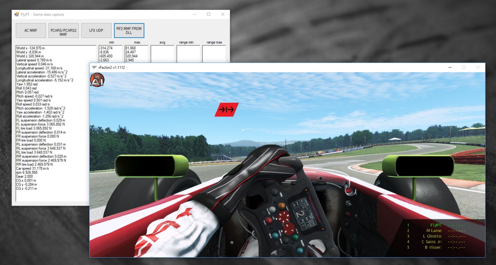

    Since I mainly use car games, I have no idea where is the CG of the car in most if not all of the games.
    For air planes, there's way more data in the games (the community is more aware of those problems and CG is way more important for airplanes).
    I'm trying to bring data inside my interface without any treatment (only mine).
    Right now, I want to add RFactor2 to the list and CG we receive is relative to graphical center!??????
    What is that?
    And we are speaking of RFactor2, a reference for many.
    You can see the value here (last 3):
    In conclusion, I'm not sure if it's worth the trouble.
    Well it is, let's just allow the user to change it.

    Yes, thats what I mean :) If you correct the rotational center of the platform it will create a nice effect, but it will limit your translational operating space.
    Yes, aircraft sims depend on CG a lot more then cars do, but still CG is important for cars as well. Any high quality driving sim should handle shifts in CG.
    I don't know about RFactor2 in particular, but I know that the telemetry must be computed for SOME point on the vehicle. If you apply the corrections I postet, then you can "move" the point of reference. Wherever this point was, after the correction the acceleration data will feel like it came from a point offset in XYZ.
    I guess that the developers
    1. use the CG as reference point or they
    2. define a reference point that somehow tries to be close to the center of the vehicle
    3. they use the camera position as reference point
    The last three lines in the telemetry look like they are giving CG information relative to the camera position. THATS MY GUESS!
    Since they calculate the CG, I assume the telemetry comes from there.
    IF that is the case(!) then you can correct the drivers offset by applying the formulae I postet (untested).
    Again:
    Not a big thing in a car. A huge deal in an airliner!
    I described to @hexpod the feeling of a crosswind landing in a 65m aircraft. If those offsets were not corrected, a FullFlightSim could not be certified for zero flight time training. In fact it couldn't even be called FULL flight sim.

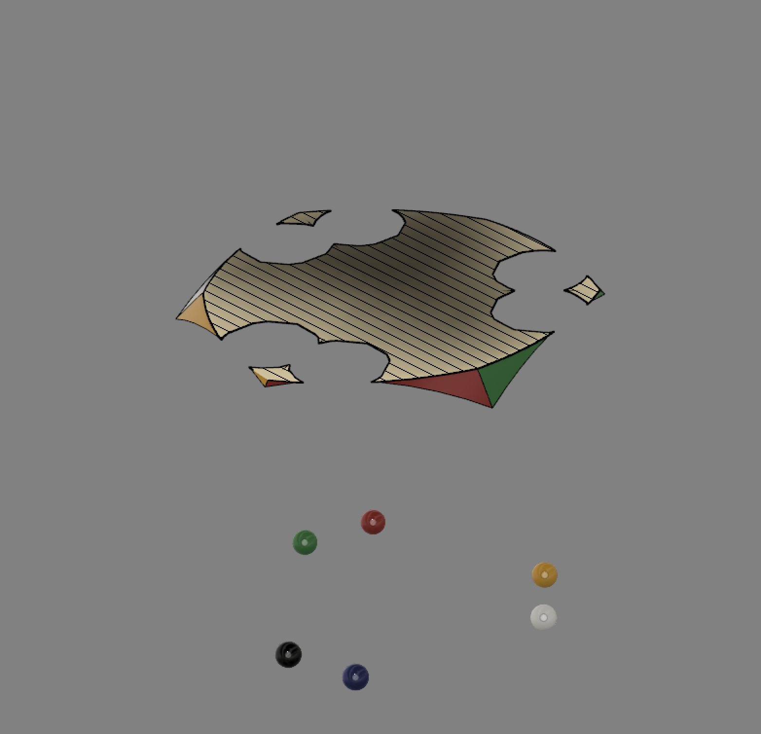

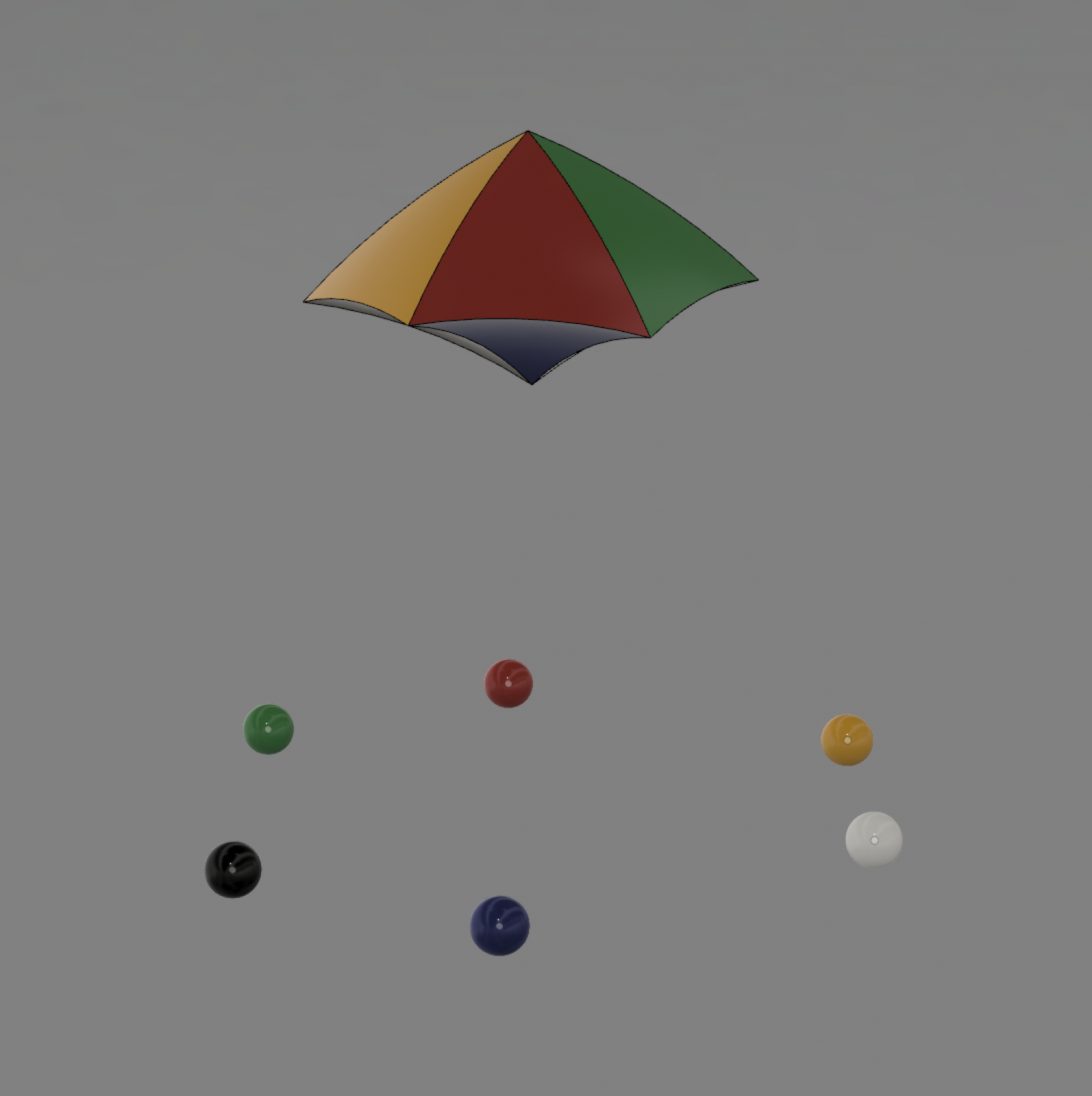

    We could better utilise our rigs if we knew in advance where the limits of the DOFs (as opposed to the actuator limits) are at any given point in time.
    I found a way to describe the translatoric operating space of a 6DOF Stewart type platform with linear actuators. Translatoric means that yaw, pitch and roll are all zero for those considerations.
    So far, I only have a graphical approach and I am unsure if I will develop it further. An analytical solution sure would be nice to have,... so, if YOU, yes YOU! :grin ...like a good Math puzzle, PM me. I can point you off in the right direction :)
    Each actuator is represented by a color. The colours of the surface indicate which actuator is most limiting if the platform approaches that respective surface. The body represents all possible positions THE CENTER of the platform can have.

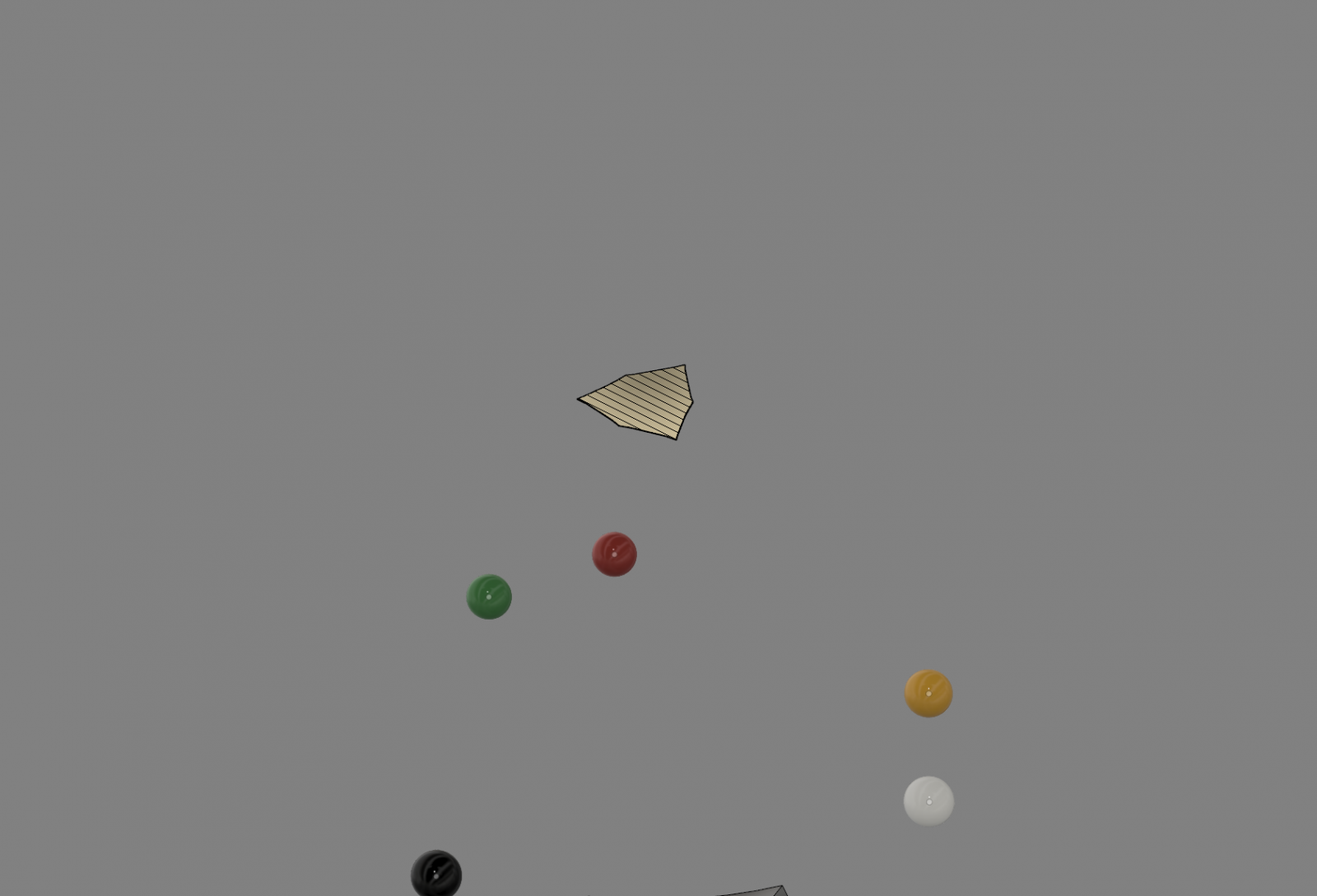

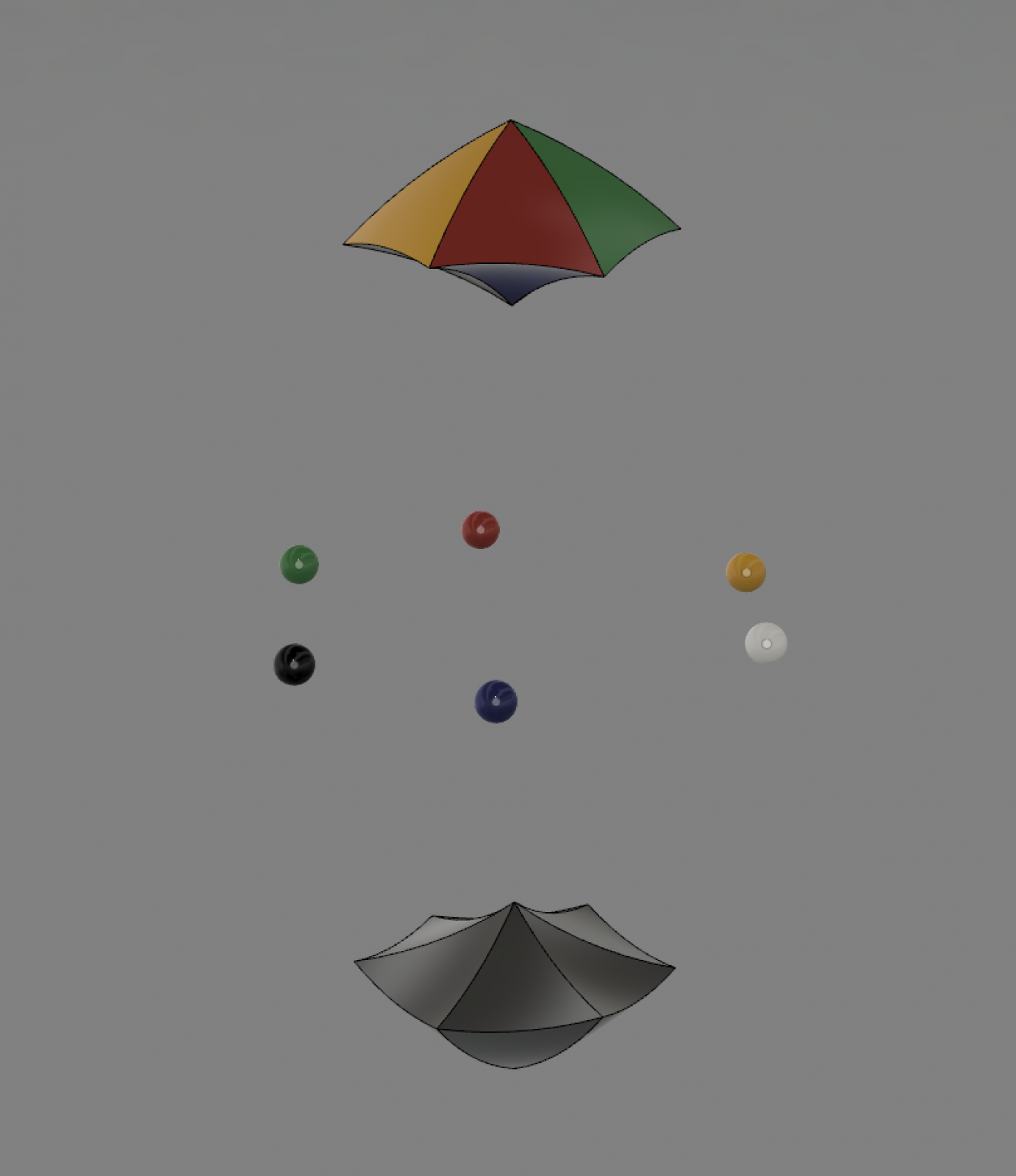

    There is another set of possible solutions below the ground. I'm mentioning this, because I am cautiously evaluating the option of mounting the actuators to the ceiling. With "real" actuators, I think these two bodies are the only sensible solutions:

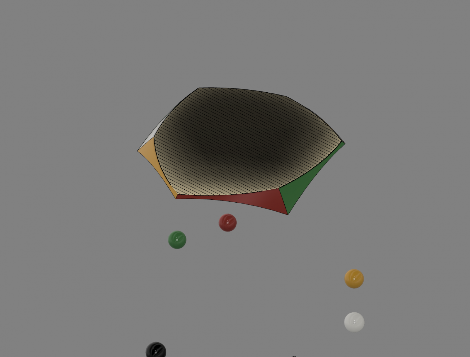

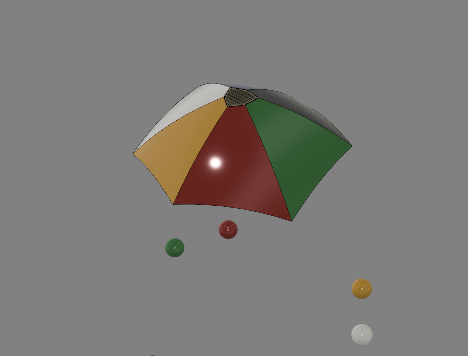

    Slicing the body from the top...
    ...starts with an almost round hexagon-ish shape.
    It will reach its maximum lateral and longitudinal expansion around a height slightly above the midpoint between top- and bottom-most tips.

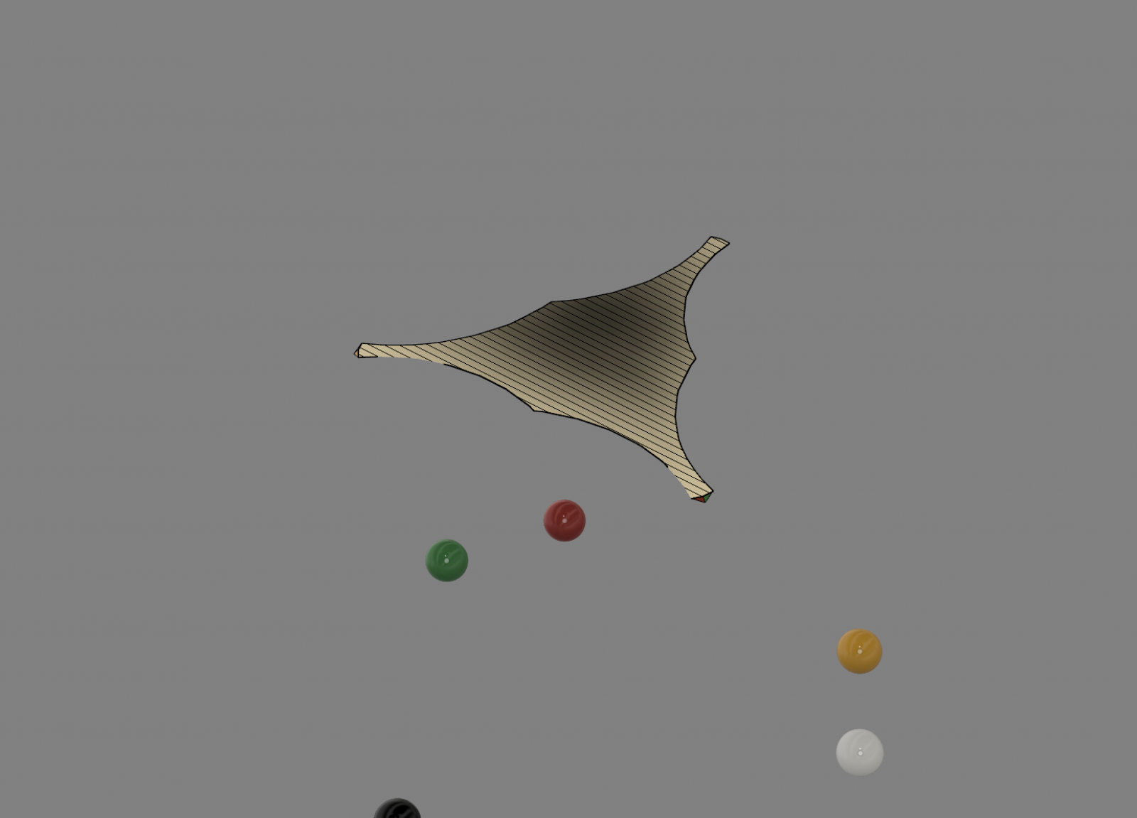

    The lower half has a lot less volume and turns into a star-ish shape...
    ...that ends in a triangular tip.

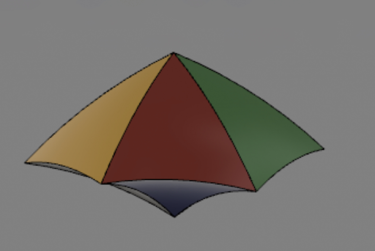

    There are combinations of parameters that lead to somewhat strange shapes. As far as I could tell those are not within the limits of what a normal actuator would be able to achieve range-wise. So, no need to worry about getting stuck on an "island" with the rig.

    I like your borderline ideas. It stimulates the imagination.
    I do intuitively limit the heave of my rig by limiting its travel. Although my capabilities are over 350 mm for the heave only, I use 200 because the heave is what eats the most of other resources.
    The washout and travel limiter on heave is the step number one on the practical side.
    I guess it crops the workspace in similar way like in the picture above.
    This workspace representation:
    is when you use full possible travel for each dof which in reality is not a good solution.

    As test, could you please limit your degrees of freedom in a way that every combination is possible? (No out of reach state)
    How would it appear on the graph?
