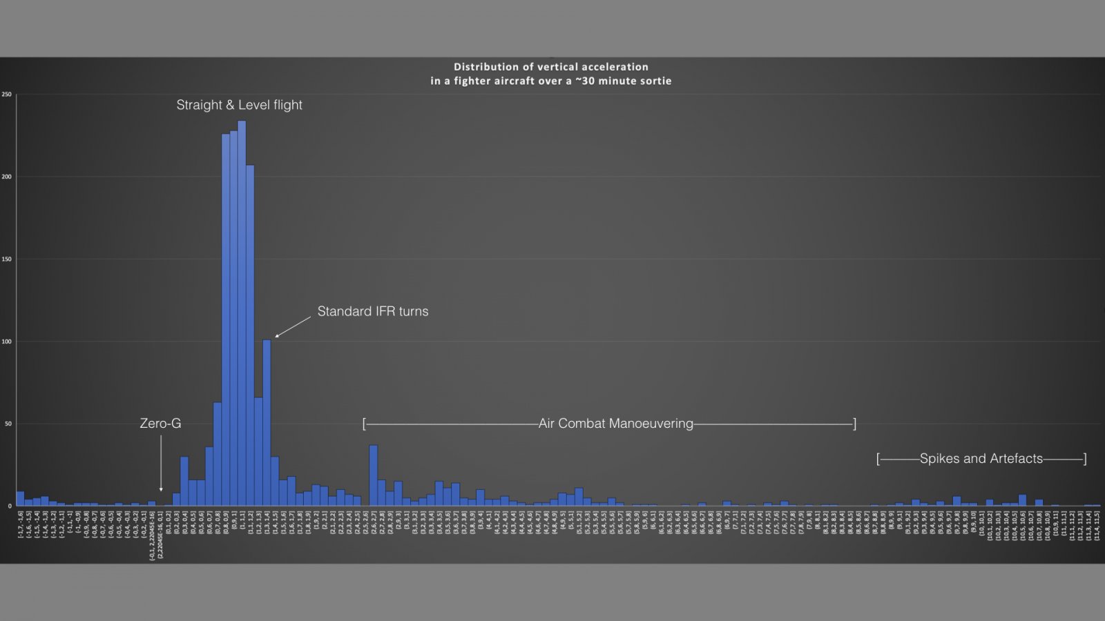

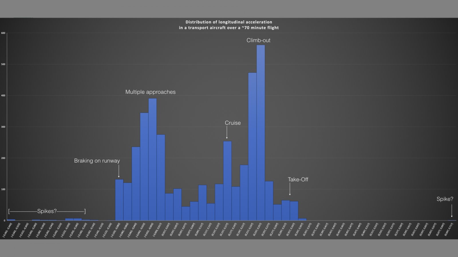

    I thought about what I would want to do to the signal before it even enters the motion cueing algorithm. Simply guessing the Min/Max values to take into consideration didn't satisfy me. Even using Min/Max from a recorded exemplary lap or flight didn't yield the results I wanted.
    In the end I looked at data recordings, displayed them in a histogram and it allowed me to make a somewhat informed decision about where I wanted my Min/Max values to be.

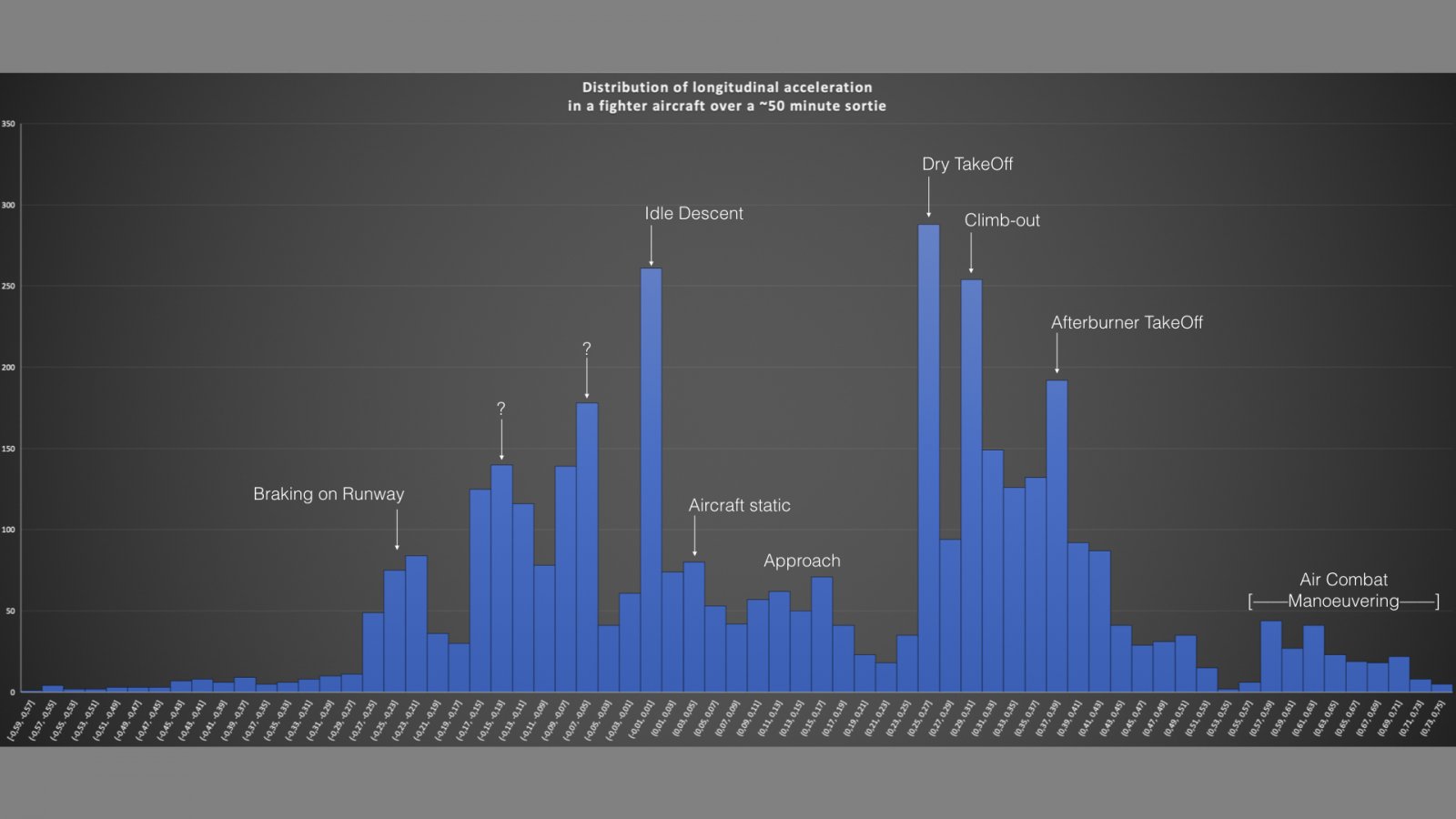

    Here's the vertical acceleration data from a flight with a little bit of interpretation added:
    As you can see, even though the aircraft experiences a wide range of accelerations, the lion share of the flying takes place in a very narrow band. I found this to be quite interesting, but since I'm using the Acc_vert only after a high pass filter, this particular data set isn't really all that relevant.
    Since the longitudinal acceleration is being used for high and low frequency content, it is much more relevant for motion cueing: Here's the longitudinal acceleration of another flight (same aircraft type):
    Decelerations below -0.3G are present, but occur so rarely that I would be willing to simply ignore them and have the rig tuned for the cues that actually show up frequently.
    This is similar data from a transport aircraft:
    It covers a very different range of possible inputs. Occasional spikes show up that I assume to be artefacts from measurement. Again, I wouldn't want to simply use the Min/Max values but instead make a decision based on the distribution.

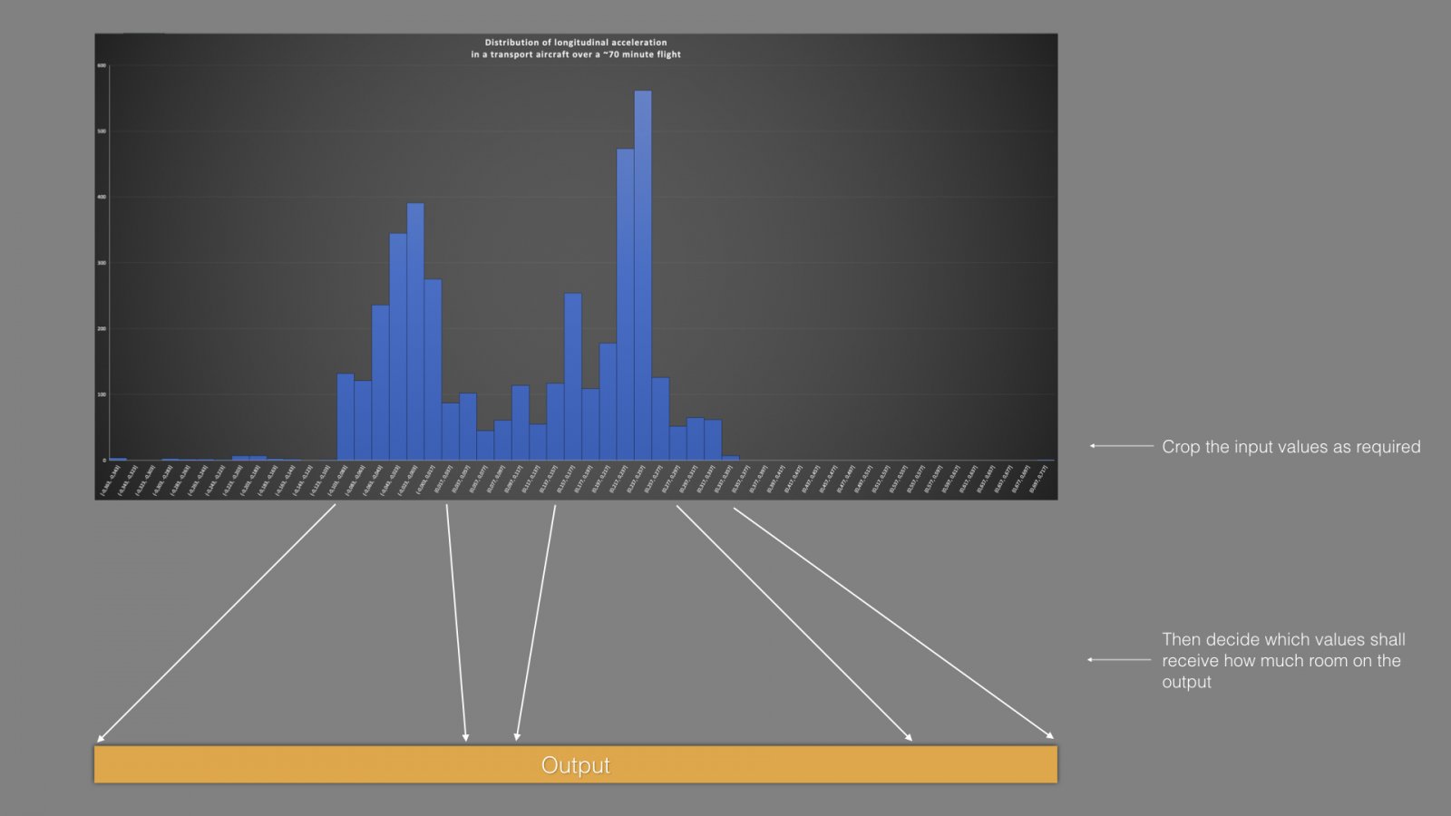

    Once I cropped the un-useful data from the signal, in a second step I am considering "skewing" the signal in a way to give the most frequent accelerations more "room" on the signal that then goes to the motion cueing algorithm:
    I know that this will introduce non-linearities, but as long as this is done cautiously, I think it will benefit the quality of motion for most of the operation with marginal side effects in very few occasions.

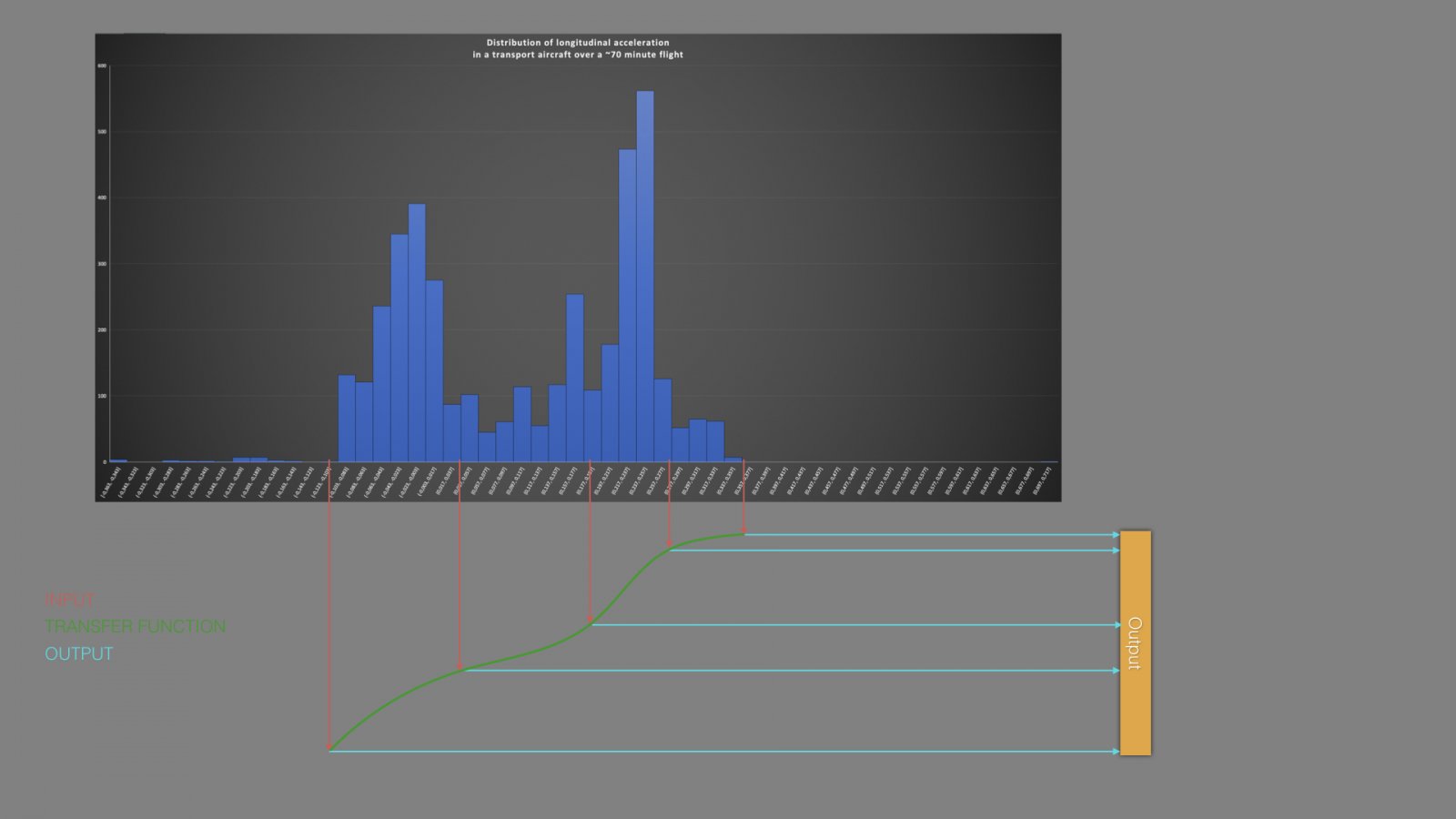

    I'm not 100% sure if "transfer function" is a term that is technically correct in this context, but I hope it brings the point across that you will have to find a function that transfers the inputs over to the outputs in a way to stretch the data in the right places.
    ...the resulting signal will then be processed by the motion cueing algorithm.
    I expect, the results to make the motion felt on the rig less "general" and more "specific". It will benefit only a specific type of operation on a specific type of vehicle. Wether or not that is an overall benefit will only become evident after testing.
    Cheers, Dirty :)

    So what are the most demanded vectors in your scenarios and what are you planning to favorise?

    I'm not sure. I'd probably just look at the distribution and try to judge how much of the signal range I can leave out without missing parts that are typical for the operation of the vehicle.
    Maybe a more systematic approach would make sense, where I don't even specify any min/max values at all, but instead only enter the top and bottom percentiles that I want cropped...

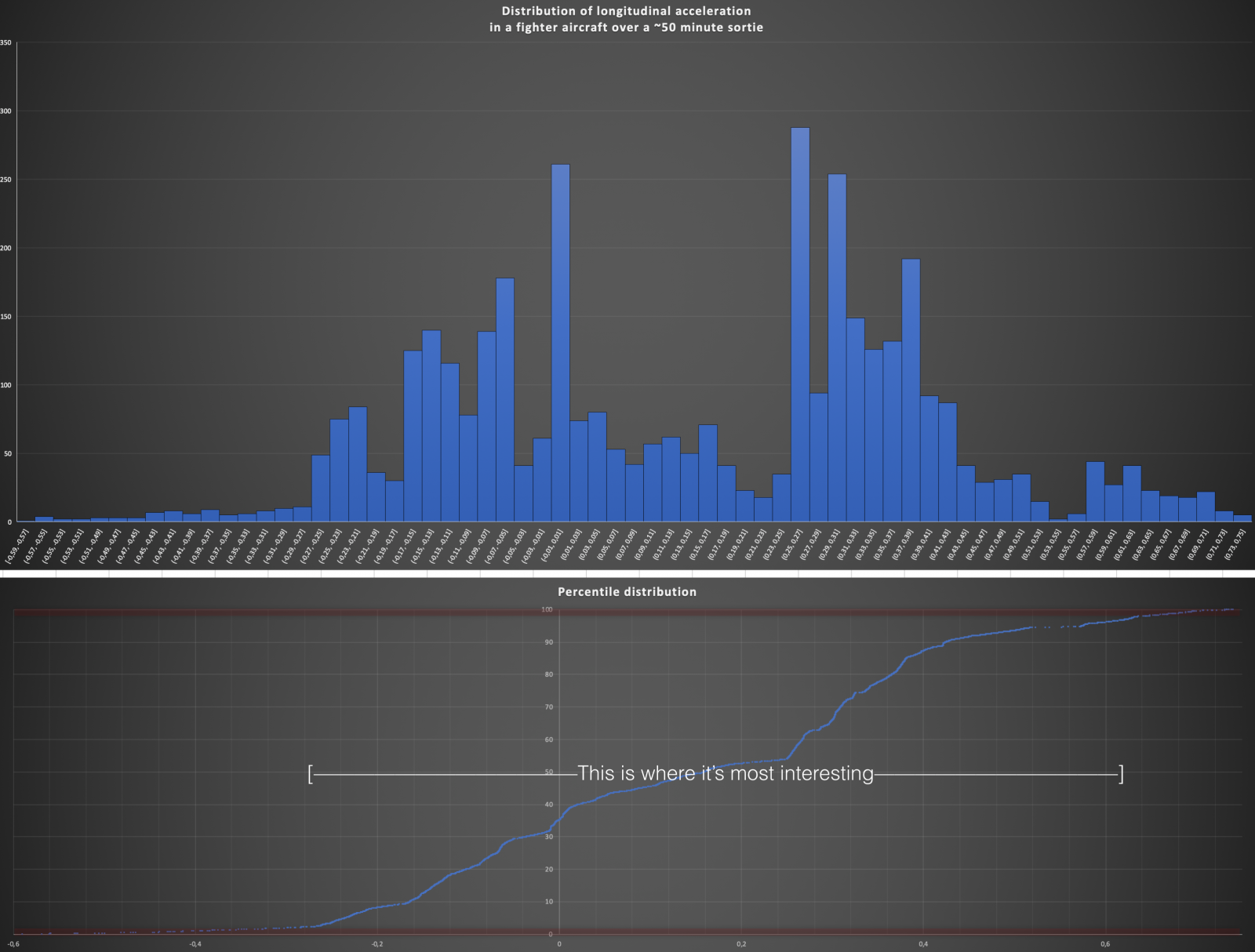

    The bottom graph shows all measured values in ascending order with percentile lines. I think it becomes apparent that the top and bottom 3% can easily be left out.
    Something else becomes apparent as well: The distribution is not symmetrical. Wether or not it makes sense to account for that by using an offset on the center position is something I am undecided on.

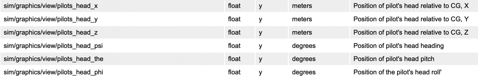

    Just for shi#s 'n giggles I tried the software in VR and it was pretty impressive to see the platform alive and breathing in 3D, in full scale, right in front of my eyes. You get a pretty good idea of what the motion is like and where to make changes when you see it in 3D.
    Something else I played around with while I was at it: I implemented some very generic motion compensation. But before you open the Champagne bottles,... I did this from the perspective of a (novice!) simulator developer. I mean, I asked myself the question: What would a sim developer have to do to be able to implement native motion compensation in his software? And the answer is: Surprisingly little! It took me all of 10 minutes to get the compensation for rotations done - and translations should be even simpler, I figure. But again: This was ME in MY OWN simulator! I have full access to the source code, and it is a tiny piece of software (basically just a horizon). Doing this for the VR runtime is a different story! Certainly beyond my abilities for now.
    I have then talked to Austin Meyer of X-Plane (or as @hexpod would call him: "God himself" ;-) about my approach and it felt like kicking-in an open door! Austin was very (quote)"intrigued", talked to Ben Supnik, who got back to me within two hours saying (quote)"...we are definitely gonna do this, just not ASAP."
    So, aside from developing a solution like the VR input emulator, there is still a good chance that a sim developer might support this feature when properly sold to him.
    And up until that solution comes along, I even have another idea on how to do motion compensation in X-Plane by writing to the following datarefs:
    Depends a lot on how X-Plane handles cameras in VR, but I am hopeful. Certainly an option too tempting to ignore!
