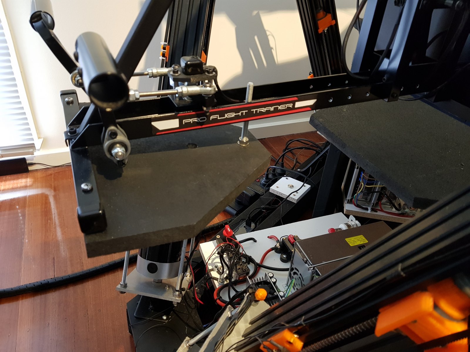

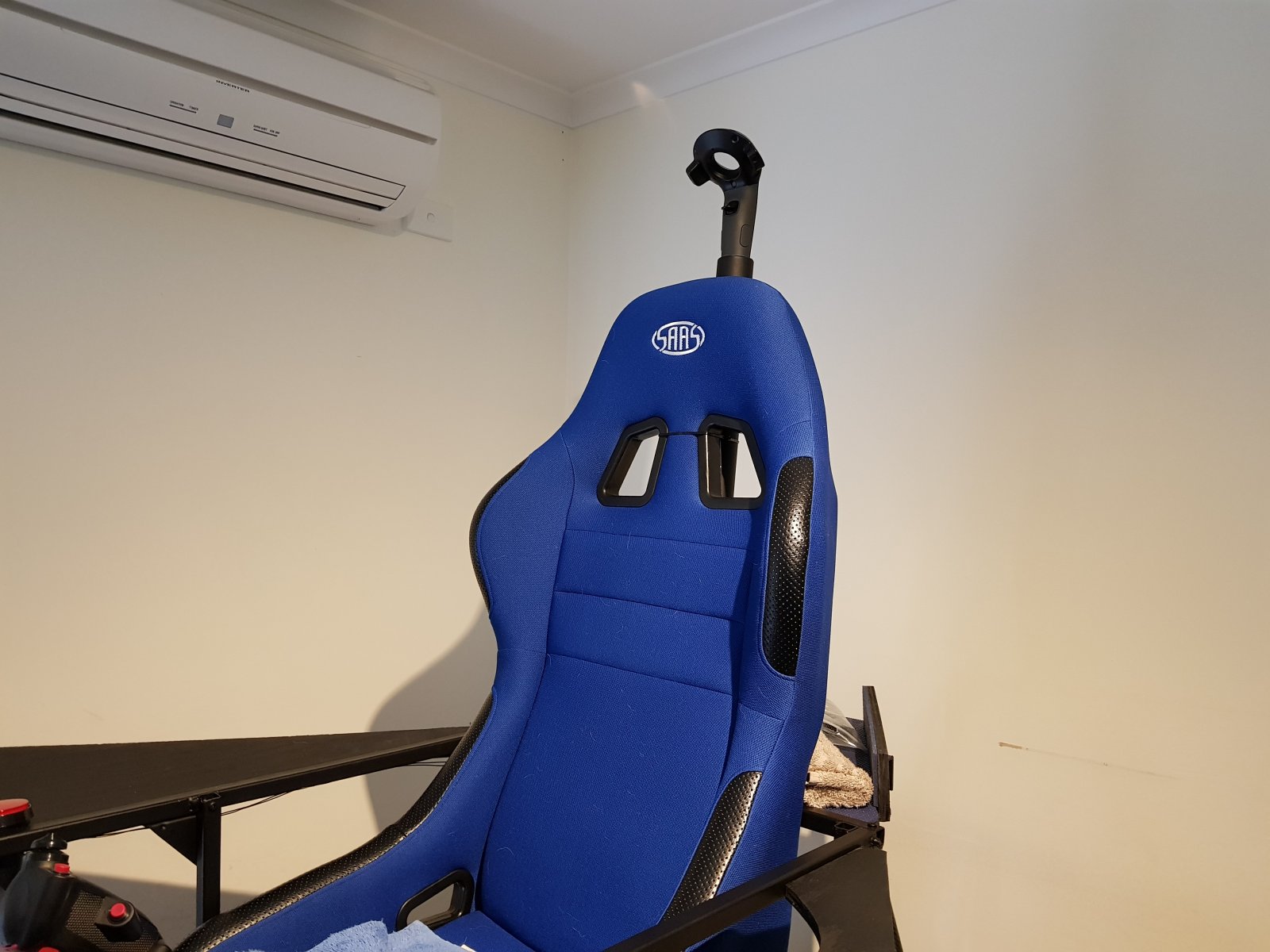

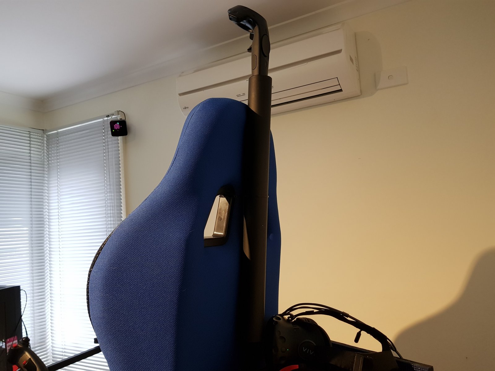

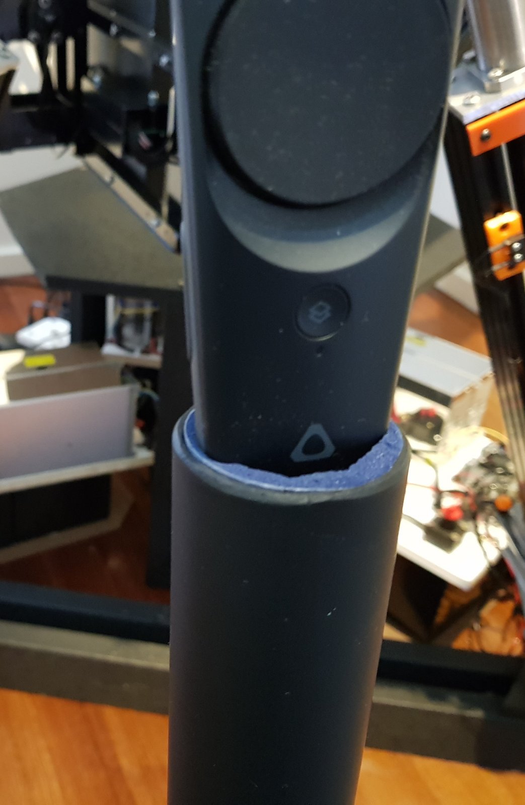

    A small update...
    1. The solution to the angle of my foot to the helicopter pedals was solved with a simple section of M8 thread and some nuts.
    2. Preparing for the VR motion cancellation software using 50mm PVC pipe, a short length of anti-slip mat with double sided tape and a cable tie. I'll wait to see if it shifts
    I am still tuning the SimTools settings. So far I have found that reducing the PWM down from 220 to 150 has brought the feeling of flight into the ball park. Helicopter movements are rarely rapid. I have also increased the values in the Tuning Center to further smooth out the reactions. However, I am finding that I can't have large amounts of roll & pitch while at the same time getting a smooth fluid sensation with the VR headset on. This is going to take some time. ;)

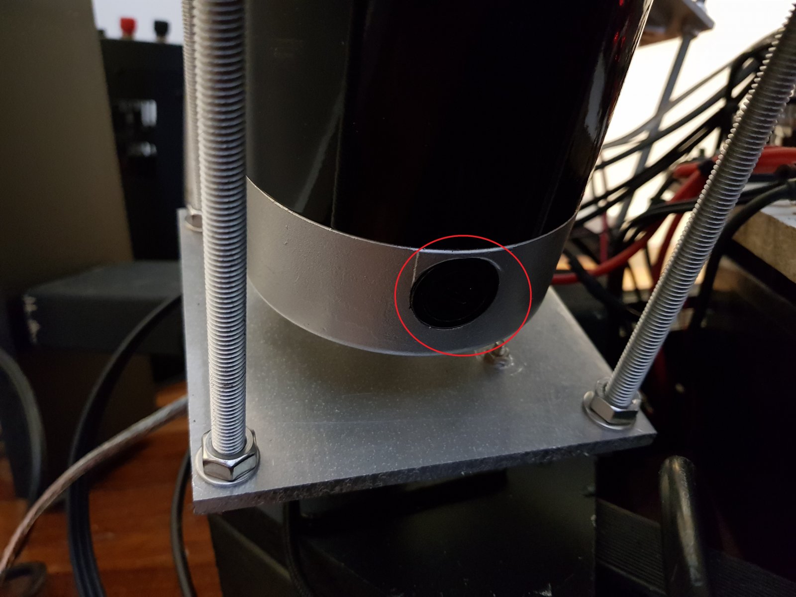

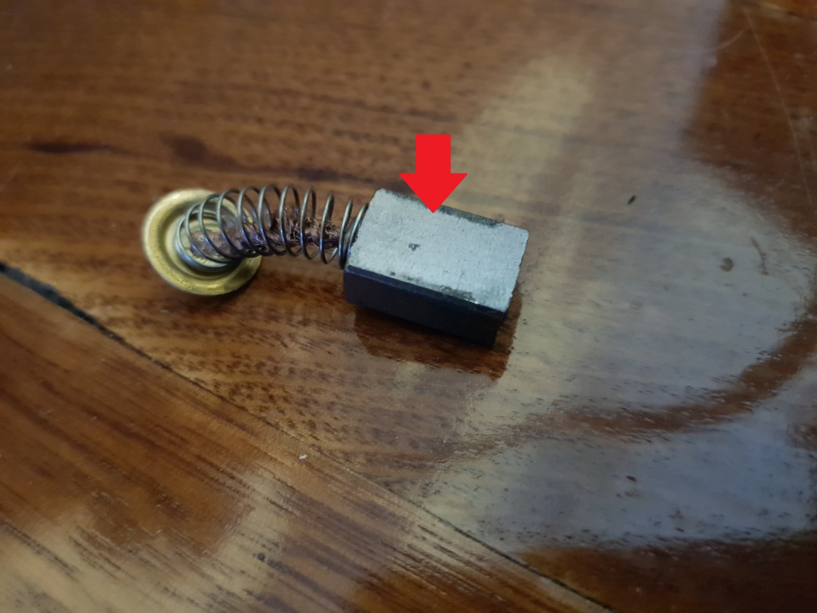

    Still having fun testing ;) Last night I had one of the 'doh' moments. The motion has been everything but 'realisitic' and it has taken a few hours for the 'penny' to finally drop. In the SimTools axis allocation, I had roll, pitch, yaw and heave all set at 80%. In other words each actuator had a total allocation of 4x80 = 320% :eek: It seems so obvious now but after setting roll and pitch to 30% and yaw and heave to 20% each it all started to come together. However, there were two other 'gotchas'.
    I updated X-Plane to 11.10b7 and deleted my preference file and couldn't figure out why I wasn't getting any motion - I had to re-patch the new version AND go to the data output window and put the data I wanted sent to SimTools back in again.
    The second one was little more tricky. While I was testing last night, actuator #1, seemed to be falling asleepo_O It would gradually sink about 100mm then quickly shoot up to where it was supposed to be. It was almost as if it was loosing power or the PWM was like 10. After a bit of thinking the most efficient test would be to swap the motor outputs on the Sabertooth and the two inputs on the Arduino. It took about 5 mins. At switch on - both actuators #1 and #2 shot off towards the ceiling going right through the limit switches. No damage was done principally because it was still in the 'soft start' period. Grrr - I had to switch the pot pos and neg as well. After doing that actuator #1 was still exhibiting the same behaviour. That left one thing - the motor.
    I got out my variable power supply and attached it directly to the motor wires and sure enough it looked at times like an open circuit. :( OMG I am going to have to replace the motor. OK lets have a look a the brushes maybe one of them is cracked or worn. The first one I unscrewed - the plastic case was tight. The brush sloped a little but otherwise seemed OK. The plastic case of the second brush was loose and the brush had quite a lot of dust (graphite?) on it which I rubbed off with my thumb. Once I had put it back in - hey presto - it was fixed. The image shows after I rubbed most of it off. The red arrow shows a little that was still left. It still leaves the possibility that it simply needed to be tightened up so that the connecting plate (at the end of the spring) made better contact.
