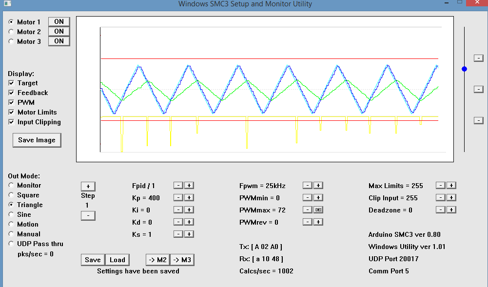

    I wired up another actuator to test and it still squeaks a bit but not as bad as the one in the video I posted yesterday. When I started the SMC3 utility it was pretty obvious that the 'throw' of the actuator rod increases because it is related to the PWM setting. As the PWM increases the actuator is able to get closer to the desired set point faster hence it travels further (rather than trying to find what looks like an average). In addition, I don't think you can adjust either the frequency of the triangular, sine or square wave or the amplitude.
    If someone is familiar with the SMC3 utility could you comment on the yellow line (PWM) spikes in the attached image. I still don't have the battery connected to deal with the regenerative current. The spikes occur when the motor changes direction so it might be related to the regenerative current? No sure how though as the Arduino isn't monitoring the motor side of the Sabertooth.
    Edit: I think the PWM line behaviour is normal. As the PWM value is increased the yellow line moves up towards the top of the screen. When changing direction, a PWM of 0 (or PWM min) is sent to the controller before it changes direction. The spike height varies because of the sampling frequency. Anyway that is how it appears to me.

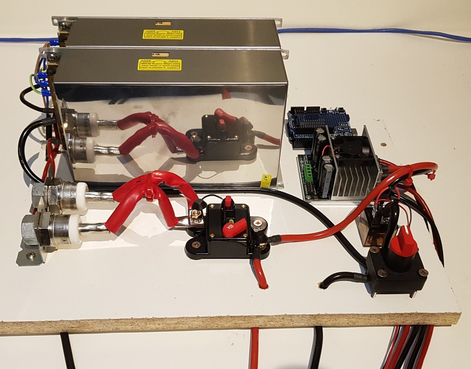

    I have stopped further testing until the power supply modules are finished because when the pulse width modulation was increased in the SMC utility to greater than 150 the error led started flashing on the 2x60 Sabertooth and the actuator lost tracking. I am guessing this is because it needed the batteries(?). I am hoping it isn't the pots :eek:
    I had a conversation with @Grizus (thank you :thumbs) about noise on the feedback pot line so I removed the twisted cable and replaced it with shielded wire and added a 0.1uF capacitor from the Arduino analog input to ground to help with noise filtering. However, this didn't stop the problem of the error led flashing or the loss of tracking.

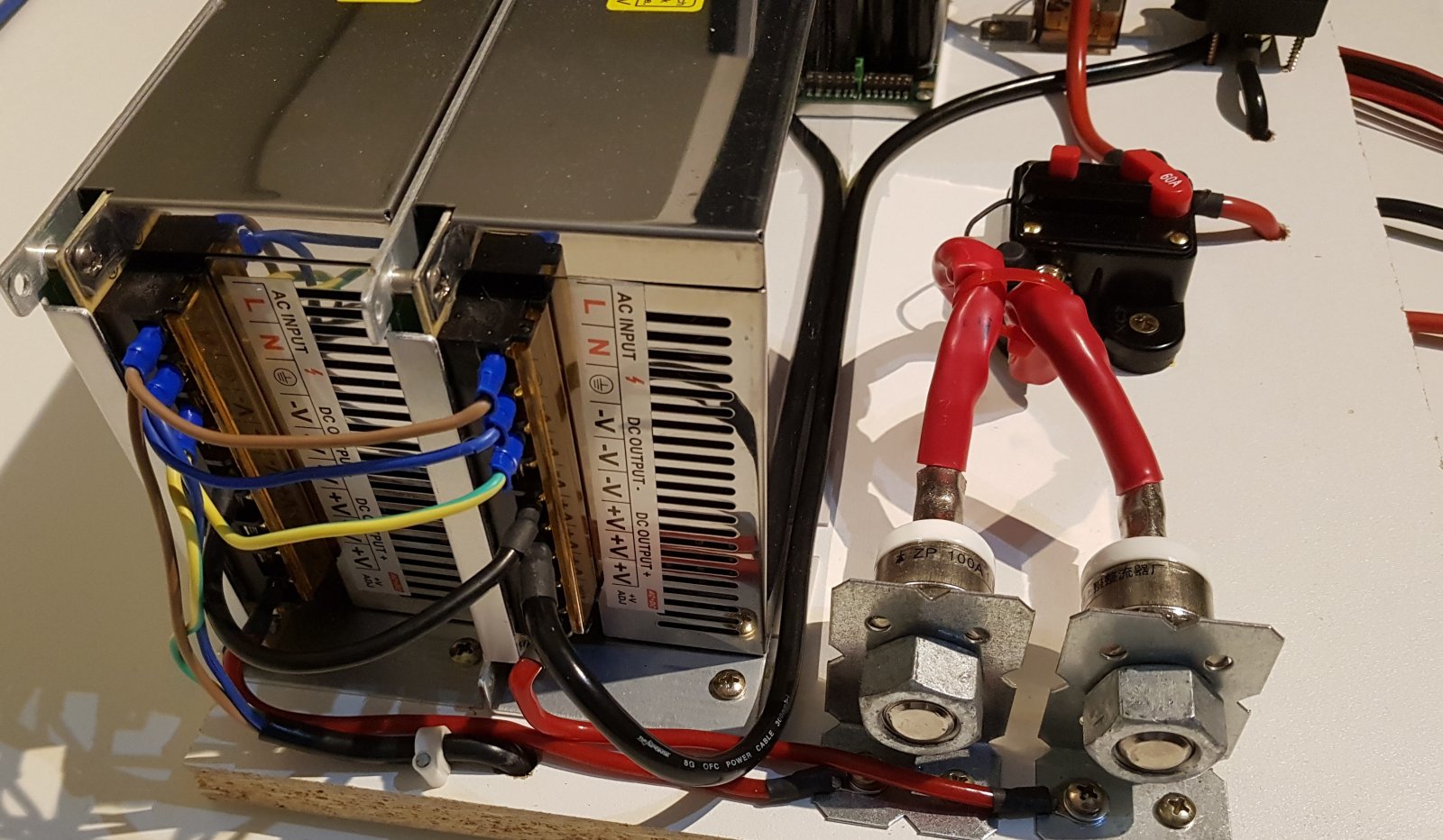

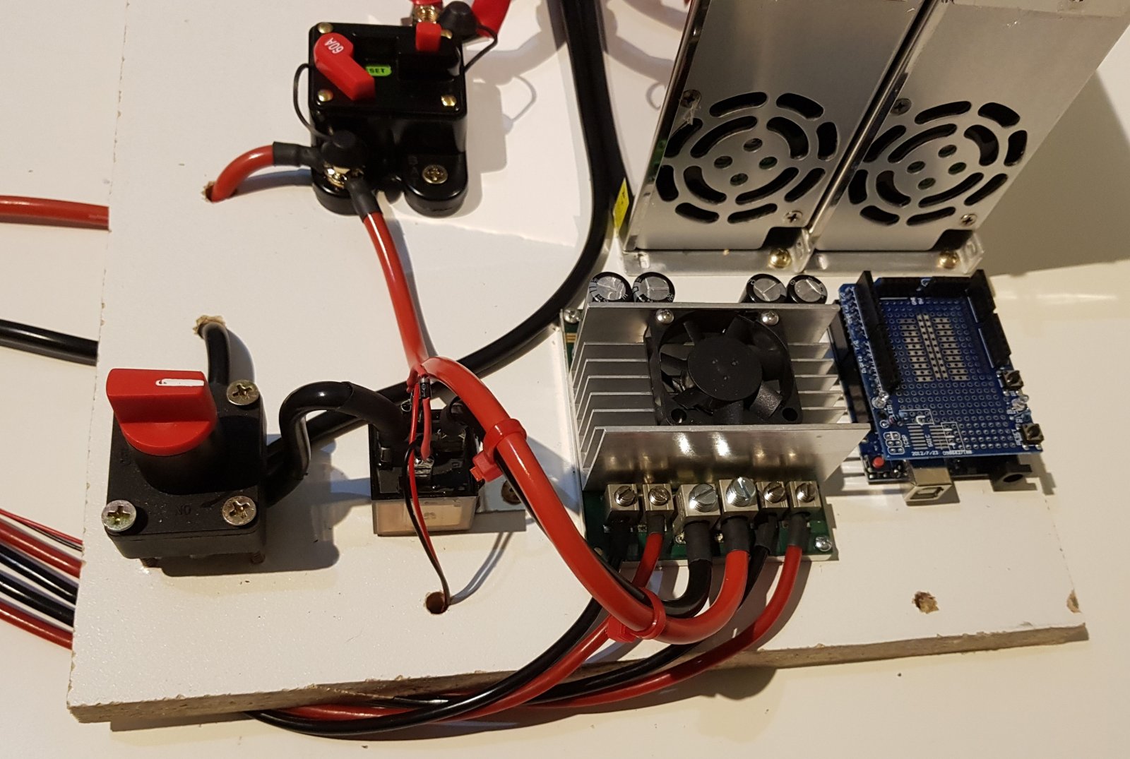

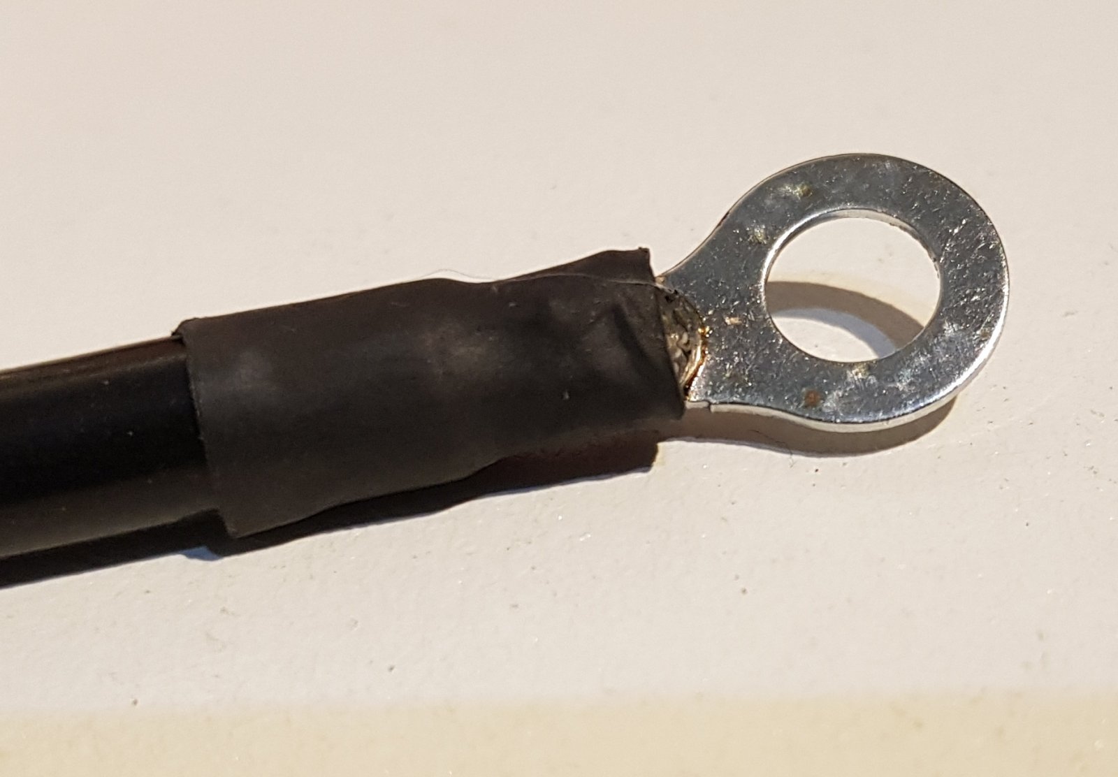

    Anyway, I got started on one of the power modules this morning. It took waaaay longer than I expected - probably 4 hours+. A lot of time was spent stripping wire and soldering to the crimp lugs. I wasn't happy with strength of the crimps so I removed the plastic sleeve, soldered it and finished it off with heat shrink. The 8G wire didn't fit into the crimp lugs anyway. These are the first two images.

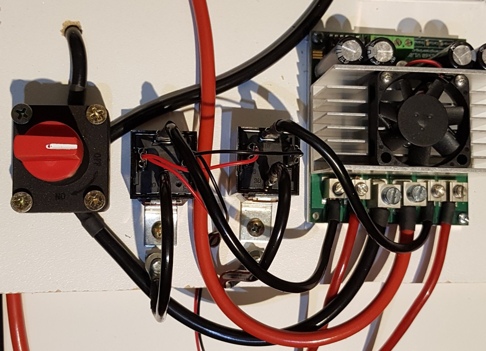

    I mounted the power components on a 400x300mm particle board. - image 3 - it will eventually sit on top of the batteries. This is wired up according to the schematic I posted some weeks ago. The thick wire is 8G and the thinner wire is 12G. According to wiring specs I should have used 8G everywhere because 12G is only rated to 20A. The 8G is rated up to 48A. Now the motors are rated at 24A each so this will work fine but the 12G is a bit under spec. I will have to see how it goes. The red / black 8G wire running through the holes in the foreground go to the batteries.
    The 60A breaker isolates the power supplies while the red rotary switch on the lower right isolates the batteries. The relay isolates all power to the Sabertooth / motors if the panic switch is activated. Edit: I have since moved the relay to be in series with each motor - see posts a few down.
    The last two images show a closer view. The prototype board on top of the Arduino Uno will be used to anchor the shielded wire for the pots and the serial wires for the Sabertooth. The small hole near the Arduino is for the 12V supply into the input jack. If you look closely you will see the reverse bias clamp diode on the relay coil (1N4004).

    Consider whether the relay is in the right place - when it disconnects the power from sabertooth in fact they will no longer be receiving electricity but sabertooth have very large capacitors that collect it. When the relay goes on, the actuator will continue moving by few centimeters - this can cause damage ! I think the better solution would be to make six relays on the line sabertooth --------------- motor.
    It's just my thoughts, please check my theory :)

    Is that small relay even man enough to carry that much current?
    I'd have thought an automotive starter solenoid would be more suitable, or even an industrial contactor .
    Theoretically if you went the contactor route, a three-pole contactor would be able to directly cut the power to three motors, so you'd only need two..
    Something like this, or if you're using a 24V setup some of these (which are half the price).
    ...Although I'm not sure how well an AC current rated contactor will handle DC current.
    It's relatively low voltage we're talking though, so I'd imagine arcing shouldn't be a problem.

    That might be a consideration as well. I have only made one at this stage so I can test it. In my original design I had the relays in series with each motor - so I did buy enough to go back to that idea. I hope to do some testing this week. At this stage the power module is a 'proof of concept'.
    @DEADBEEF
    The relays are automotive (supposedly) with the contacts rated at 100A. Time will tell if their stated rating and their real world performance correlate ;) Thank you for taking time to find those alternatives - it might well come to that.

    The seed of doubt was sown ... so I moved the relay from powering the Sabertooth to be in series with the -ive of each motor. This will mean the panic circuit will act quicker and lower the current through the relay contacts. The motor -ive will connect to the relay contact via a shared bolt which you can see on the lower part of the image. I could have connected the motor +ive as well using a bolt but I want to minimise the number of cable breaks in favour of direct soldered connections where practical. Edit: it now matches the schematic I posted towards the beginning of the build

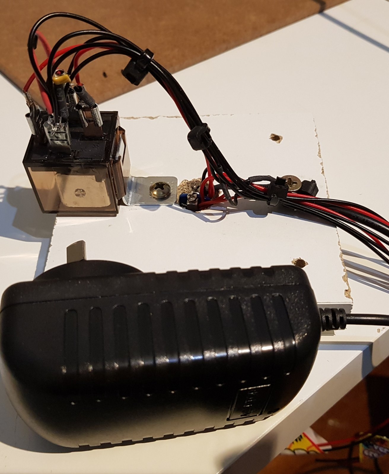

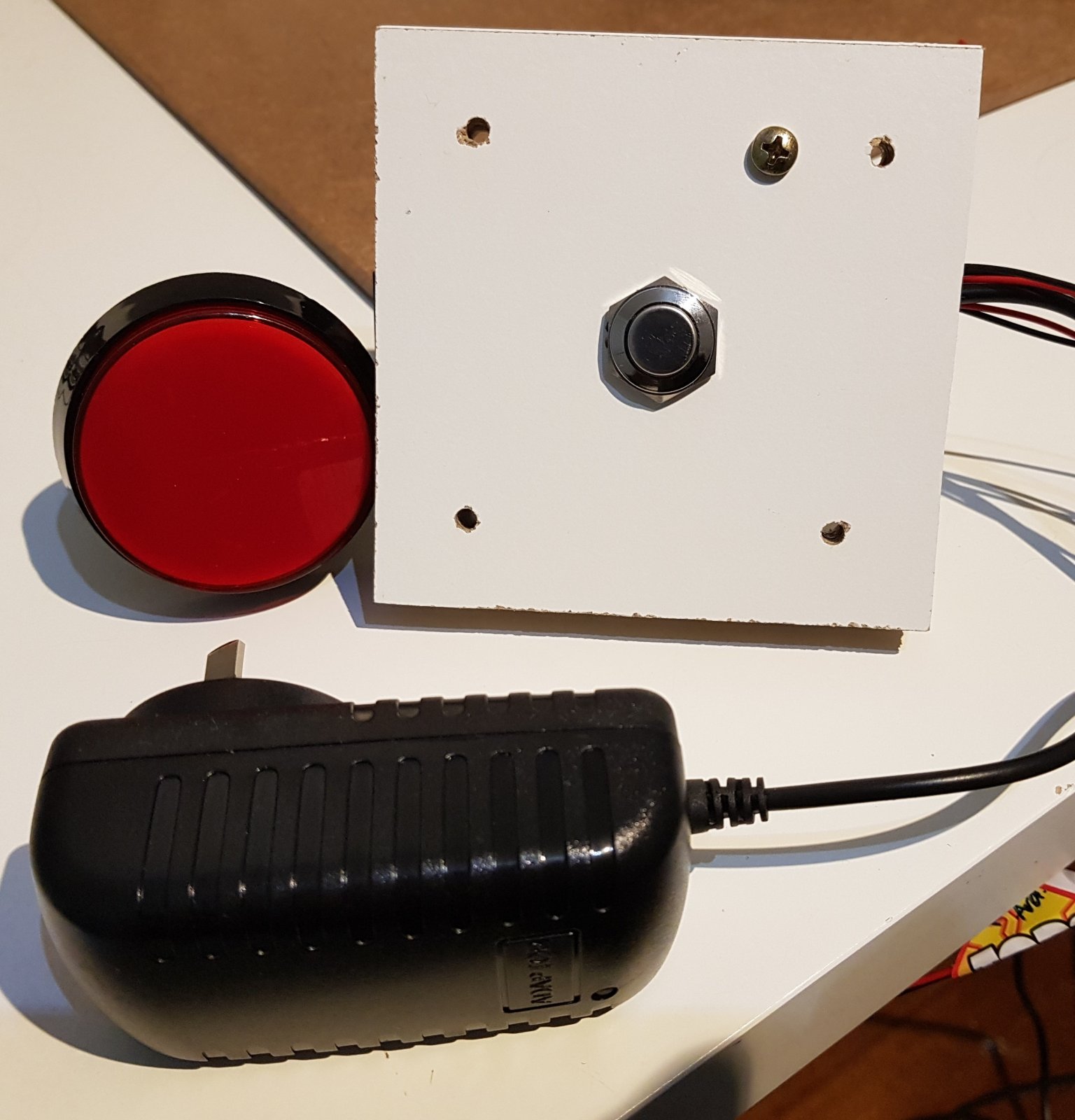

    ...some progress. I have finished one of the power supply modules and connected the batteries. I also wired up the panic circuit and tested that as well.

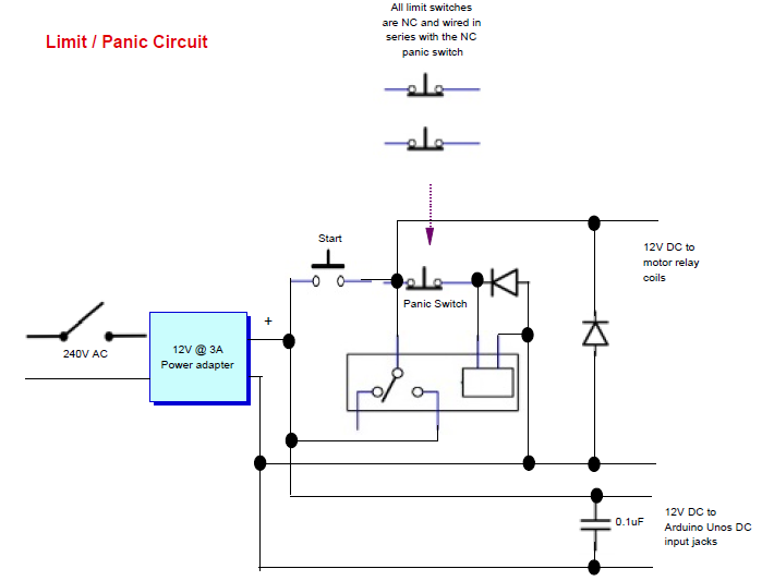

    The panic/limit circuit ended up to be quite compact. Basically, when the system is powered up, the relay remains off cutting the power to all the isolating relays on the motors. Once the 'start' button is pressed it latches the relay which holds itself on. Any break in the limit switch series circuit (which includes the emergency stop button) unlatches the relay and cuts the power to all the motors.

    The way you recover from limit switch trip is dodgy as hell....
    When you reset the relay the motor powers up, real dangerous. Nothing but the relay knows you hit limits.
    Contactor would be better choice than automotive horn relay. If your in SE Melb rockby electronics in Clayton has some cheap contactors and other electronic components.

    My thinking was that if the limit switch was hit all the motor relays drop out. The next step I guess would be to wind the motor down by hand from whatever switch was activated then investigate what happened. At that point once the problem had been solved, the start switch would be pressed. How would you see contactors being better? Thanks for your input :thumbs

    Contactors or more correctly motor contactor have much heavier contacts, solenoid and springs. There is much less chance of the contacts welding together. You could even use a 3 phase motor contactor and wire each phase output to 3 separate motors or loads.
    You do need to know what kind of solenoid you want as they come in different flavors, ac or dc and multitude of voltages.
    You seem to have a lot of relays in your system, do they have a function? maybe list them and remove the redundant ones.
    Also, I guess any switches or relays that interrupt the motors is going to cause a dangerous condition as the simtools continues sending data.
    Maybe simtools needs a keystroke where you can pause data output, currently simtools only sends data and doesn't listen to com port.
