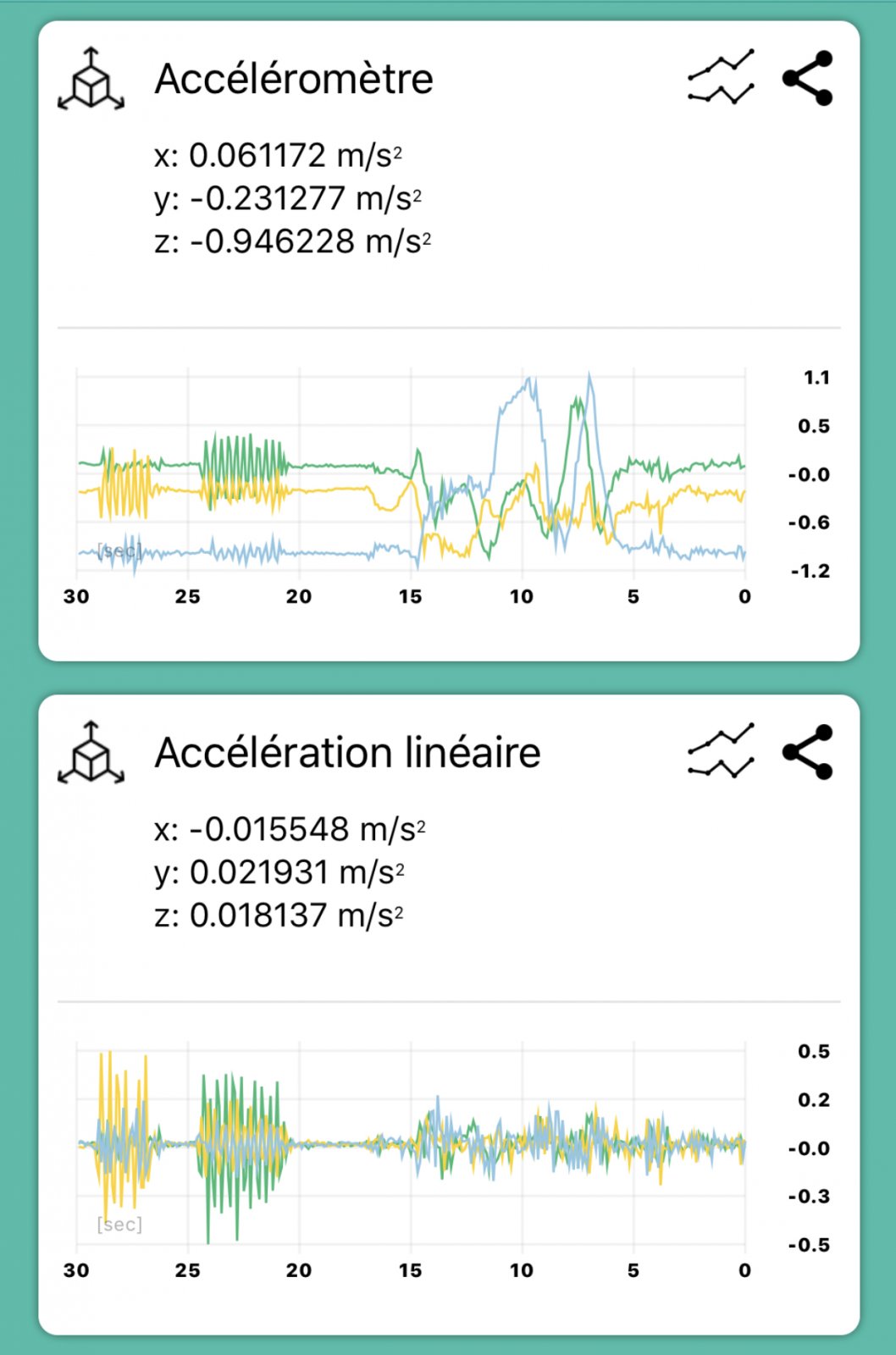

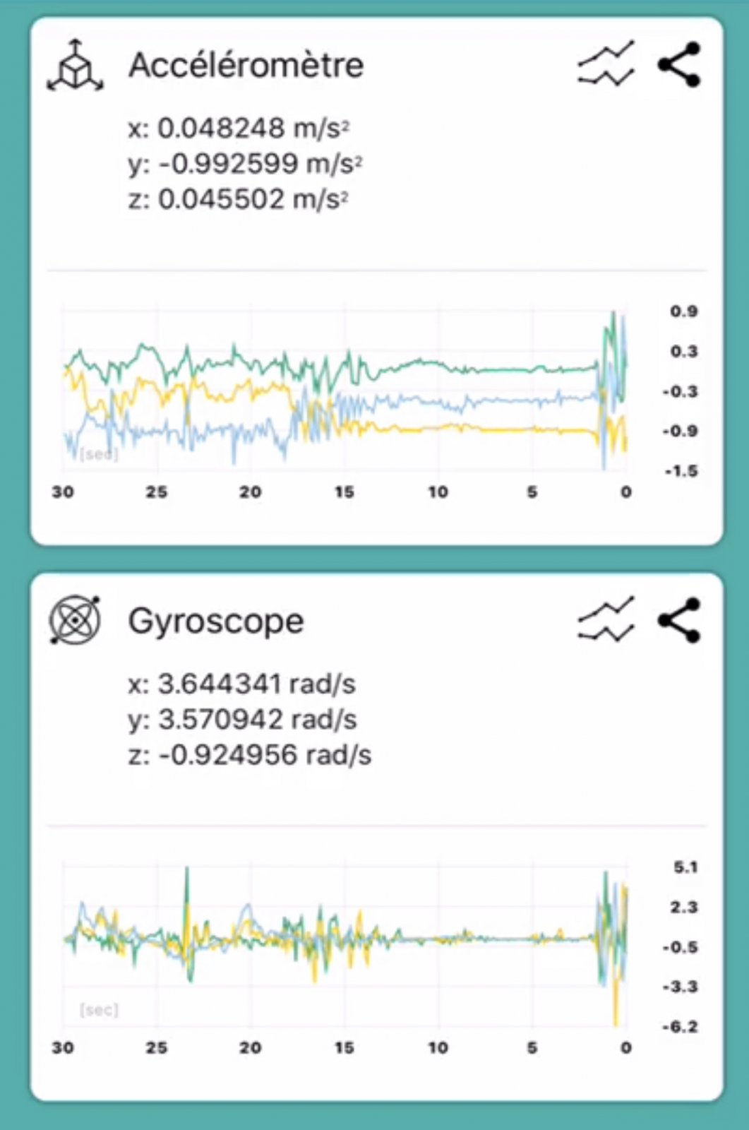

  7. hexpod
    hexpod http://heXpod.xyz
    Apr 18, 2016
    1,228
    berlin
    7,900Coins
    +381 / 5 / -0
    DC motor, 6DOF
    Yes, I think I understand what you say.
    The reason for that is pretty simple.
    Xplane displays the accelerations in a similar way to the accelerometer which you have in your smartphone. It is conteining the gravity component.
    If you have an iPhone you can download a cool app which displays the gyro and accelerometer on your screen. I believe this is a complete 6-dof telemetry your senses can perceive and that’s what we need for our platforms. You can rotate your phone and observe how the gravity moves from one axis to another.
    https://itunes.apple.com/us/app/sensor-toolbox-multitool/id1383687190?ls=1&mt=8
    Once you rotate your plane (without any motion) this 9,8m/ss will “move” over 3 axis adding and subtracting this value and the total of it will always be 9.8m/ss. I think one call it the gravity component.
    So... if in the Tuning Center your min/max is 20, you will see your heave slider in simtools above the center. It’s logical.
    The washout will not bring this value down it will bring down your axis value and your platform should be centered.
    One has to know one thing: as far as your axis is not topping the plugin value, you will get your motion as you need it with simtools washout.
    Have fun playing with it.
