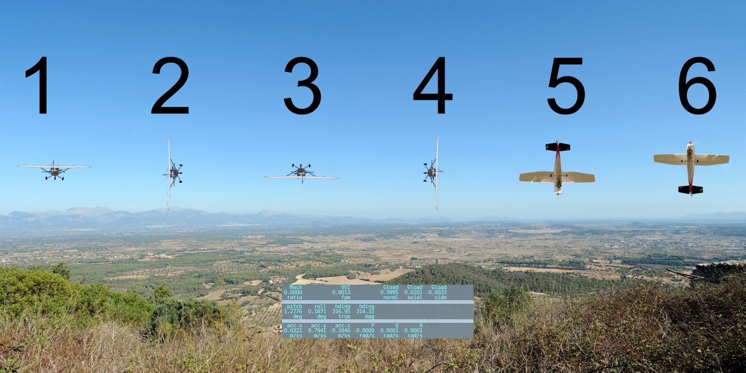

    If someone would be capable and willing to fly the following positions (as stable as possible for a few seconds) and record the acc-x, acc-y, acc-z and Gloads normal, axial and side, that would be great and clarify a lot!
    1: normal
    2: rotated sideways
    3: headlong
    4: rotated sideways (other side)
    5: vertically down
    6: vertically up

    Sure ! Tell me what is supposed to keep the platform tilted when the aircraft is flying on the side in the scenario you propose ? Euler without washout I guess. Right ?

    I assume you want all this with a maintained straight line flight at constant speed. right ?
    Even for a good pilot it’s not so easy. Maybe with a delta wing aircraft with supermaneuverability
    characteristics it will be easier....

    :) Pragmatic approach! Me Like! :thumbs
    acc-x = Gload_lateral
    acc-y = Gload_vertical
    acc-z = Gload_longitudinal
    ...it's just that Gload is given in G while acc-x/y/z is given in m/s^2. Other than that, they're the same. Conversion factor is 9.81
    Scenario 1:
    acc-x = 0.00
    acc-y = 9.81
    acc-z = 0.00
    Scenario 2:
    acc-x = 9.81
    acc-y = 0.00
    acc-z = 0.00
    Scenario 3:
    acc-x = 0.00
    acc-y = -9.81
    acc-z = 0.00
    Scenario 4:
    acc-x = -9.81
    acc-y = 0.00
    acc-z = 0.00
    Scenario 5: (Only valid if terminal velocity is reached)
    acc-x = 0.00
    acc-y = 0.00
    acc-z = -9.81
    Scenario 6: (depends a lot on weight, thrust and speed)
    acc-x = 0.00
    acc-y = 0.00
    acc-z = 2.54 (my best guess)
    Dirty :)
