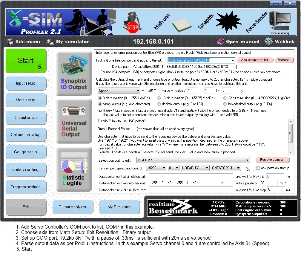

    I am new here and have a 3Dof Sim Rig with the very similar Fan System. Splendidd supported me in past to set up this fan System. After Installation of some new features I lost all my adjustments and I was not able to bring the settings back. I used the same settings like here described without any success.
    I assume there is a problem in the set up of the Pololu Mastro 6 Channel Board.
    Seams that Pololu does not communicate with Xsim and if I used for instance the Dual Com on the Maestro Control Centre I have got the error 0x010
    I really hope someone here in the Forum has the same system, because it was a lomg time a projetct on Xsim and can help me.
