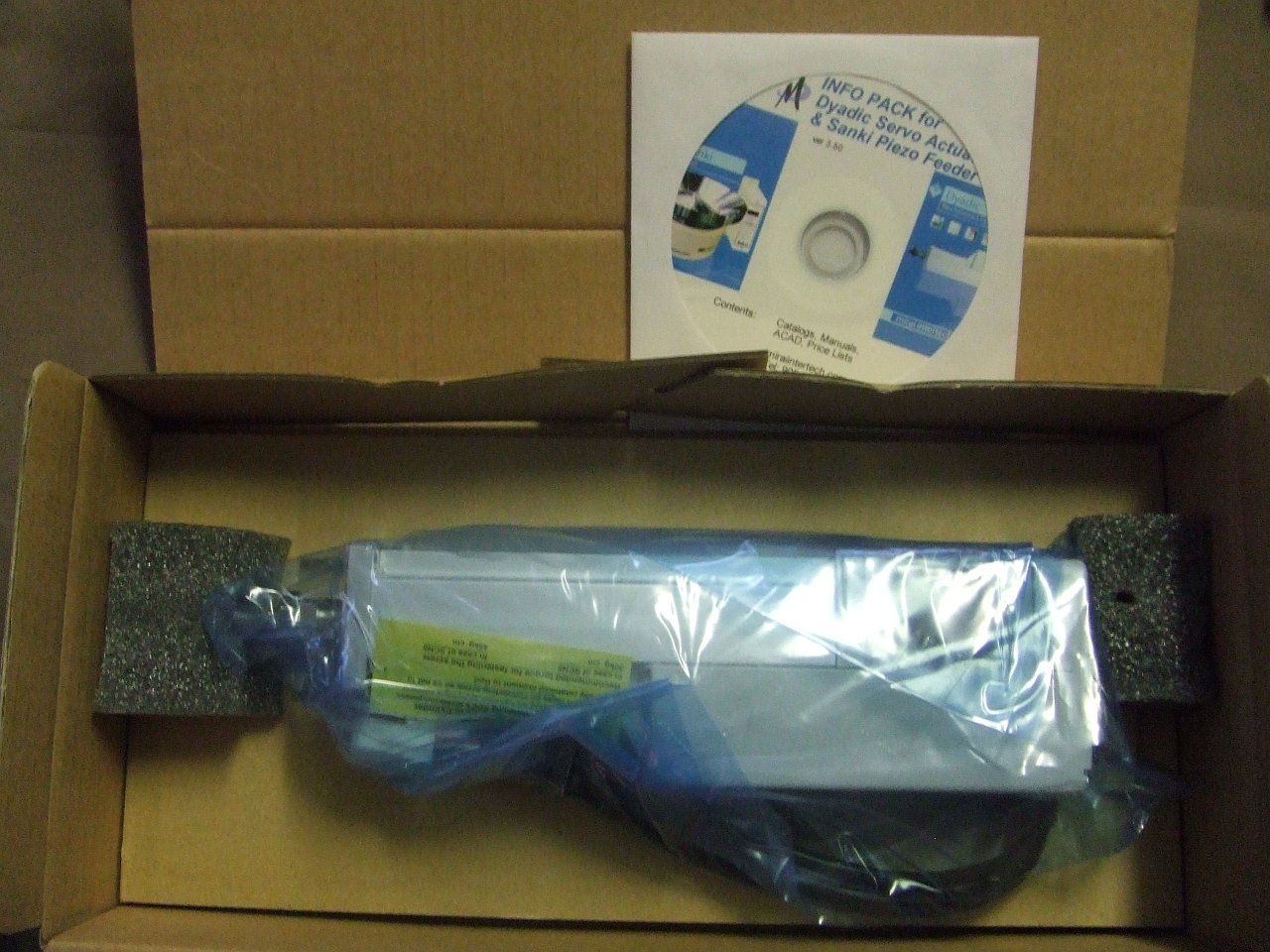

    Heres a pic of the SCN5:
    Tomorrow it'll go on its journey to Sirnoname :thbup:
