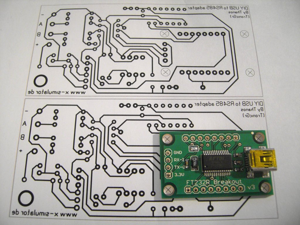

  8. tronicgr
    tronicgr
    This is awesome news!!!! The video is great too! Congrats! :cheers: :dance1: :dance2: :yourock:
    About the RS485 converter... I used all of its features of the converter you mention on my USB_to_RS485 converter:
    post9152.html#p9152
    So I guess it will work too. I'll prepare a prototype of this USB converter and send it over to you to test it! :thbup:
    Best Regards, Thanos

    BTW, I need some help to understand which USB-485 interface to use, I want a shelf solution...
    Let me ask again, after all you learned so far, will this converter work with x-Sim?

  13. tronicgr
    tronicgr
    I'm not sure if their circuits include auto RS485 switching, like Sinoname said: These converter are half duplex and can send OR receive, this is the SCN5 Termibus RS485.
    But I guess for 10 bucks for the simple serial port version its worth to try. In worst case you will have no communication between the SCN5 and the computer, no other harm can be happen... :headfullofmath:
    Thanos

  17. egoexpress
    egoexpress Active Member
    Dec 13, 2006
    3,839
    Germany - Frankfurt/M
    422Coins
    +10 / 1 / -0
    Yes, you did. The limitation is the max SCN5 update rate of 5-10ms. That means that the acutator is able to change direction just in a 5-10ms loop (rumble).
    The speed and accelleration will be adjustable the same way, as you are used from your current setup.
    Dont worry, it will be as fast as your SCM :D
    Regards
    Christian
  18. egoexpress
    Dec 13, 2006
    3,839
    422Coins
    +10 / 1 / -0
    I've ordered some of Thanos DIY usb>RS485 converter layouts from Heinz. I will assemble some for you guys, as soon as Thanos gives green light.
    Regards
    Christian

  20. tronicgr
    tronicgr
    Yes, I will give the green light as soon Sirnoname test it with SCN5 motor, and assure us that it works like the simple serial_to_RS485 converter he uses right now.
    Just to mention, that apart from the DIY_USB_to_RS485 PCB you will need to purchase a small FT232R breakout board from Sparkfun.
    I ordered two such FT232R breakout boards, and paid 22euro (including shipping expenses from USA). :thbup:
    Regards, Thanos
