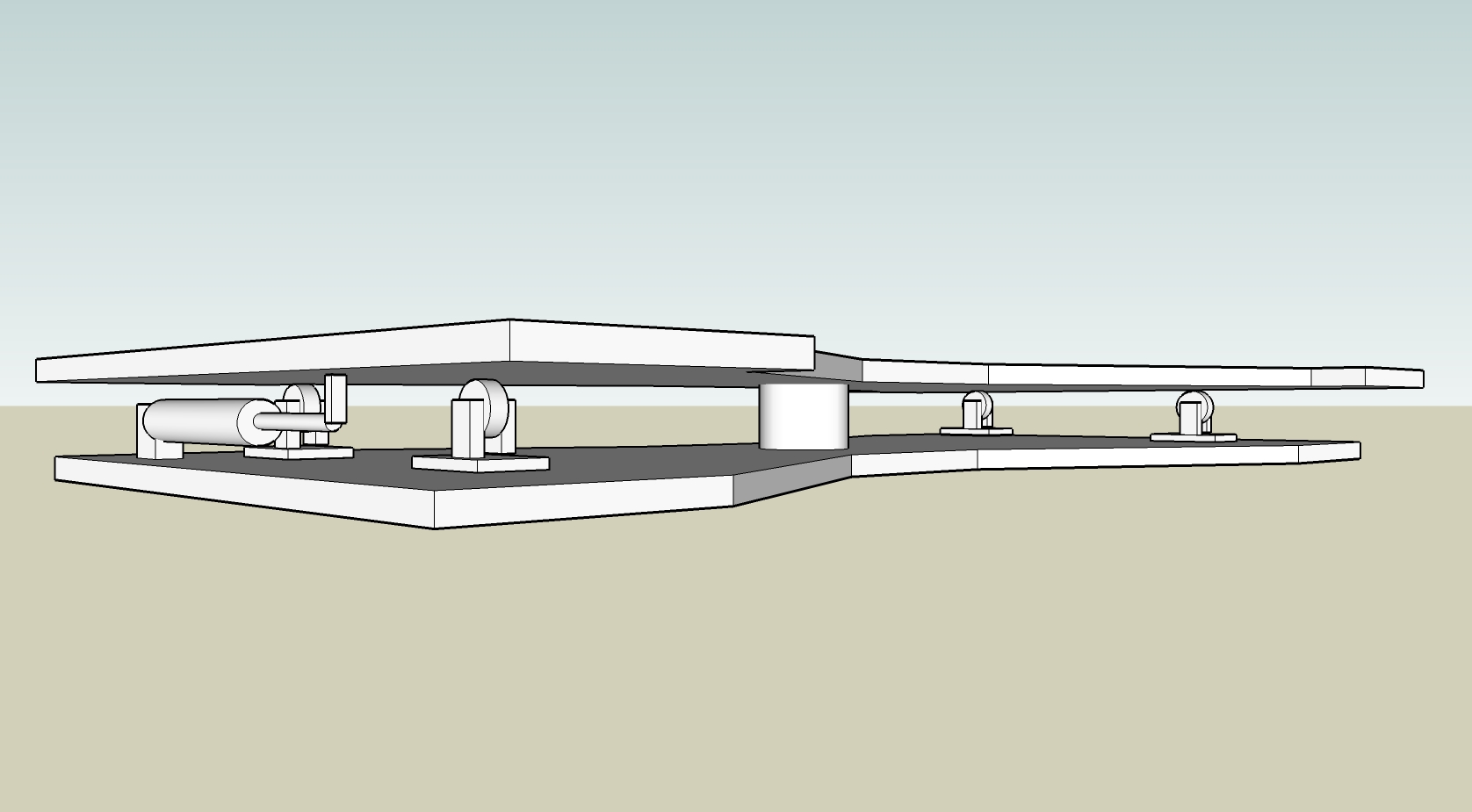

    Ok, I know I’m getting ahead of myself with this one. But I think we should have a solution that will enable us to add more DOF’s in the future. For example, a simple platform could be built to add YAW to any SimForceGT platform.
    Anyway, it’s just a thought.

    Cool Buddy... But, would any SCN5 be able to deal with the weight of such rig?

    +48 / 1 / -0
    Should work if you mount it on ball bearings or ? So the weight is not that much, it has just to pull and push

    It is not so simple, it is huge mass to move around, accelerating and braking will be hard on the 10Kgf actuator, we are talking about 150-200Kg here... :(
