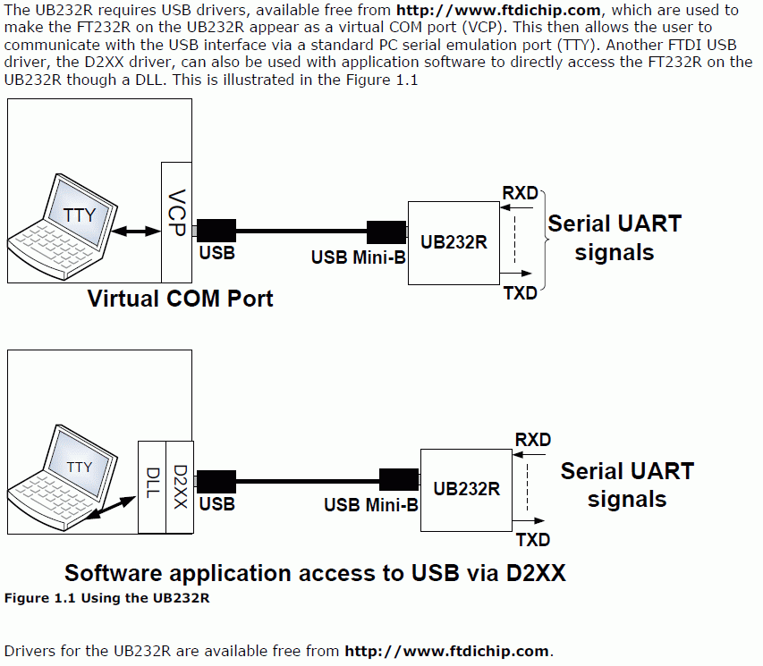

  6. tronicgr
    tronicgr
    @ Sirnoname
    Ok, I have already put much of the parts on the layout, but there is one thing that concerns me about. Should I power it from the USB port or add external power input with +5v voltage regulator? The power consumption would be around 20mA but I'd like to have it isolated from the USB in case something goes wrong! What do you think is the best?
    And have in mind, that the preferred way of driving each adapter is through direct access to the FT232R chip, using the D2XX driver DLL (NOT VIRTUAL COM PORT!!!!)
    Regards, Thanos

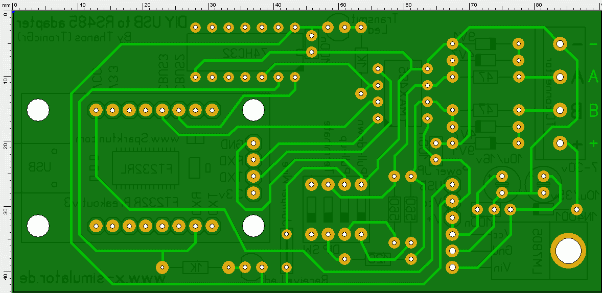

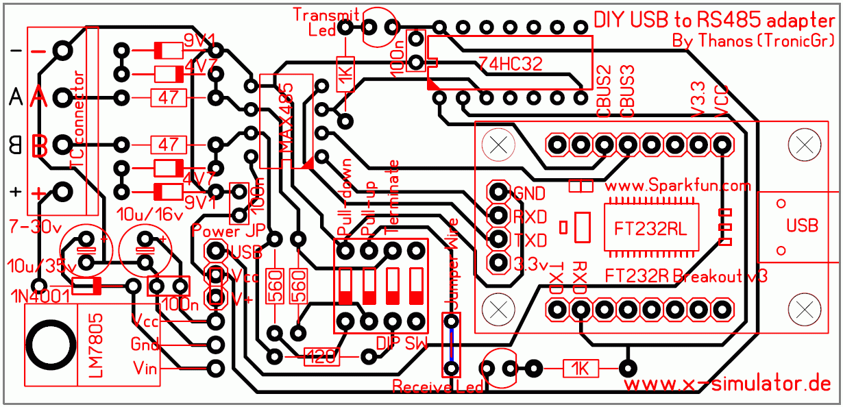

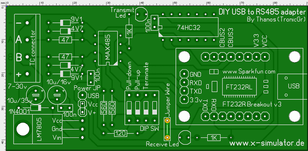

  8. tronicgr
    tronicgr
    Ok, the DIY USB_to_RS485 adapter is ready!!! Take a look on the next photos:
    As you can see, the Sparkfun's breakout board sits on the bigger board that I designed!
    -Added selectable power source between USB and external power source (7v-30v input in TC connector).
    -Added optional pull-up and pull-down resistors to ensure high transmission speed.
    -Added protection from voltage surges, EMI noise etc.
    -And last, added status Leds to verify the receive/transmit function!!!
    PCB layout, as well list of the components, will be available the next days...
    Regards, Thanos

  9. yobuddy
    51,748Coins
    +5,205 / 19 / -0
    Looks great Thanos!
    And with all those options, we are sure to find what works best! :thbup:
    Thanks!

  12. tronicgr
    tronicgr
    Hi njracer,
    I just design these interfaces. I don't have the resources or the time to build them for others (thats why its called DIY!!!). And its pretty easy to assemble it once you have the PCB board. So you can request from an etching service to make the PCB board for you, and then solder yourself the components on it. All components are thru-hole and easy to find.
    Perhaps some of the members could arrange a small production of this adapter for a small fee (10%). Or maybe we could ask Sparkfun to make it as a product so it is available to all ;)
    Regards, Thanos
  13. tronicgr
    tronicgr
  14. tronicgr
    tronicgr
    But if you use D2XX driver DLL to control it directly from x-sim software (bypassing the virtual comport issue) and assign different VID/PID to each using FTDI tools, there is no need to change each SCN5 ID!!!!!
