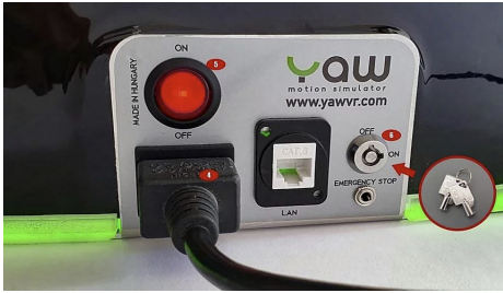

    I have a 3DoF VR Motion Simulator 1 and lost the Simulator Key as image attached to turn "ON".
    Is it possible to switch on the simulator without key or can you send one if you have?
    Can you please send me some purchasing links such that i can buy it and i am willing to pay for it as well.Because i need the keys for a project in urgent need,
    Please help me to solve the problem and waiting for your kind reply.
    Wiating for a reply with some purchasing links or i can buy if you have a spare one

    Probably the best thing is to take the cover off and bypass the key internally. Should be easy to do. You can then install a switch instead. Ask someone with a bit of technical knowledge, if you don't know how. Can be done in 30 minutes probably. Or, to get a key, contact the people from Yaw VR, they will be the only ones that can get you a key

    I agree, it looks to be a 2 position isolator switch, so being 12v should be easy to replace with the likes of a toggle switch, just ask at the local electronic store.

    Yes. I will actually do this also when I open the shell up next time, as the key is annoying and keeps falling out. If there are no kids around or not being in a public place, there is no need for the key really for personal use.

    Alternatively you should be able to get a 2 position proper key switch, that would not fall out, but I agree simplicity is the way to go, have you considered replacing it with traditional kill switch?

    I thought it was 24v.

    It may be 24v, but a suitably rated traditional kill or toggle switch should do as a replacement.

    That would work also, but I have enough switches lying around to just use one of those. A kill switch could also be a very good idea. But if the dish goes crazy and keeps spinning with you in it, I am not sure if it would be much easier to reach a kill switch versus a normal one in the same spot
