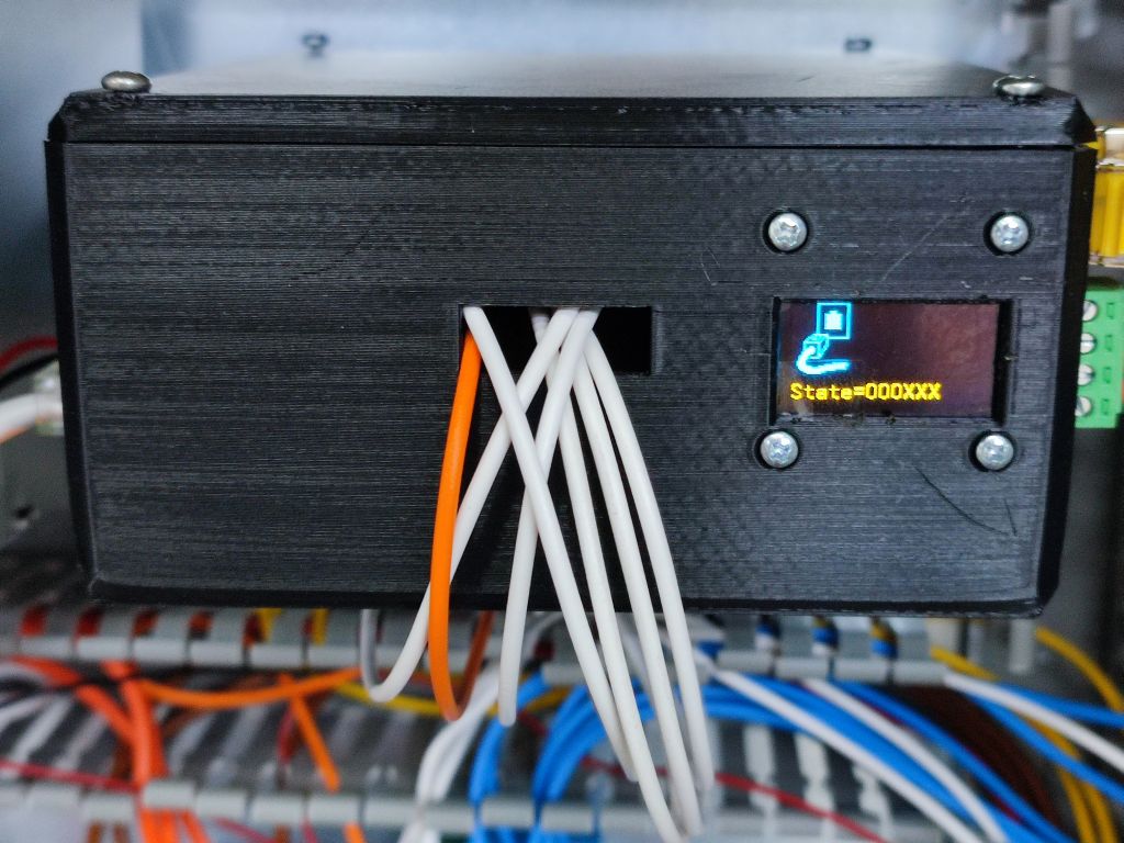

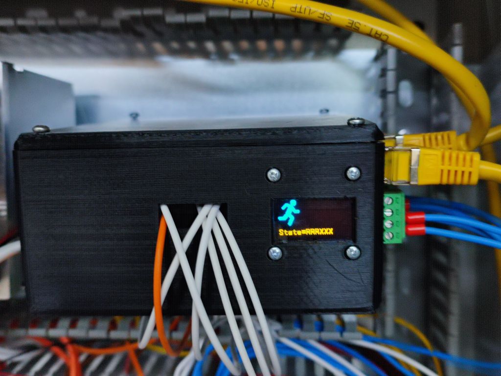

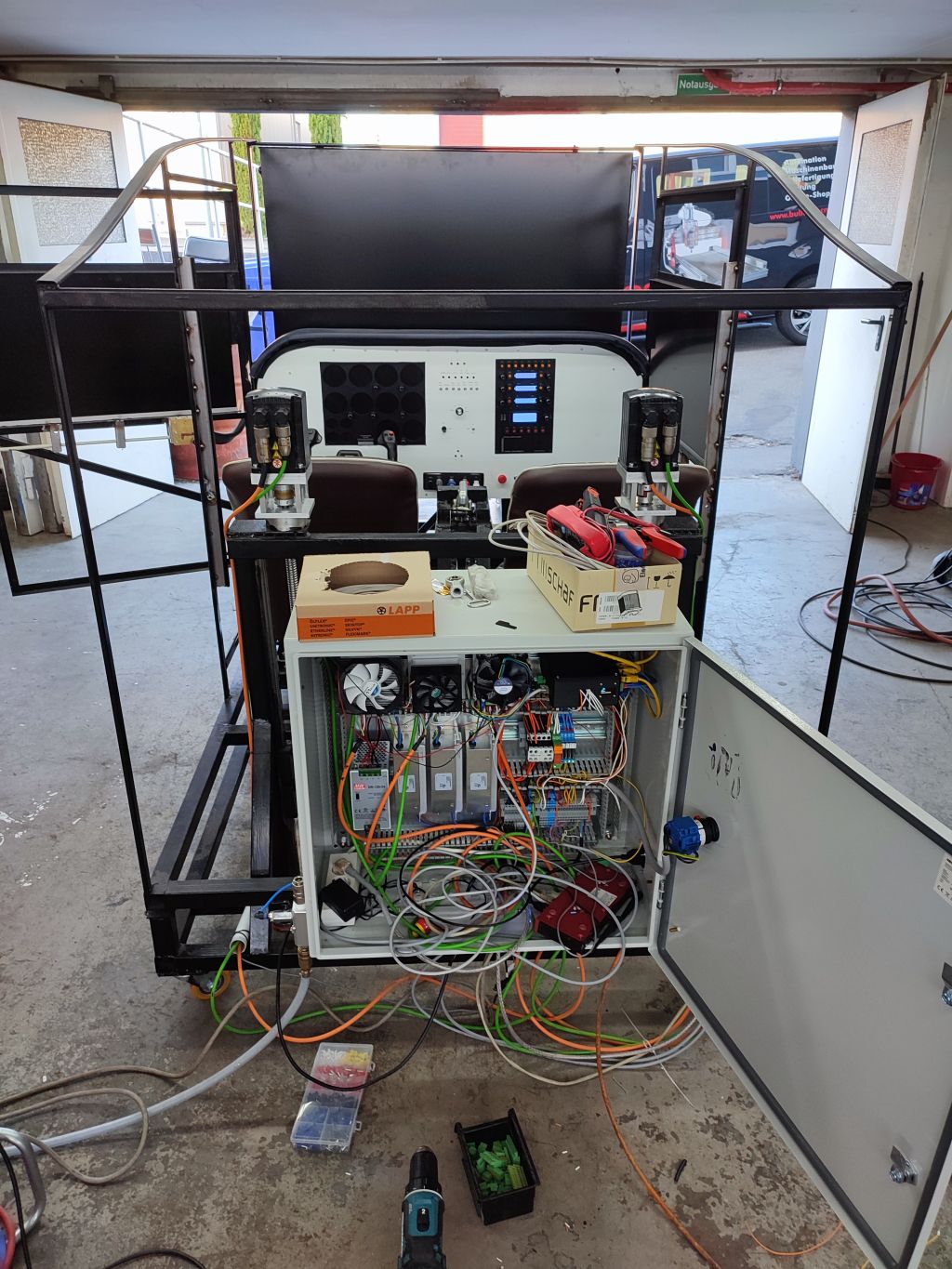

    Yesterday, we installed the controller with the new 3D printed casing. The ratsnest of wires hasn't got much better but it looks a bit cleaner and is at least safe to operate.
    The improved homing procedure also works quite well. The controller currently has no online/offline switch but instead cross fades the position automatically from the parking position to the center position when FlyPT Mover connects. This folows the rule "make it as simple as possible". But probably a door switch would be even better. The rig would then go down to the parking position automatically when the door is opened without the need to flip a sepearte switch or to disconnect the Movoer output.

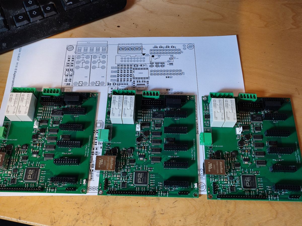

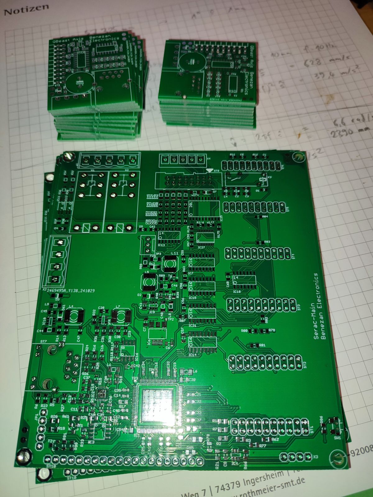

    Update: I've made a new PCB layout which has 6 instead of 5 outputs for servo axes. The boards have just arrived. I'll assemble at least two for my own 6DOF rig and Sven's next heli sim. But if anyone else is interested I could make up to 5.
  6. Aerosmith
    Aerosmith Active Member
    May 30, 2024
    513
    self employed
    3,005Coins
    +312 / 1 / -0
    3DOF, AC motor
    I've just assembled 3 boards.
